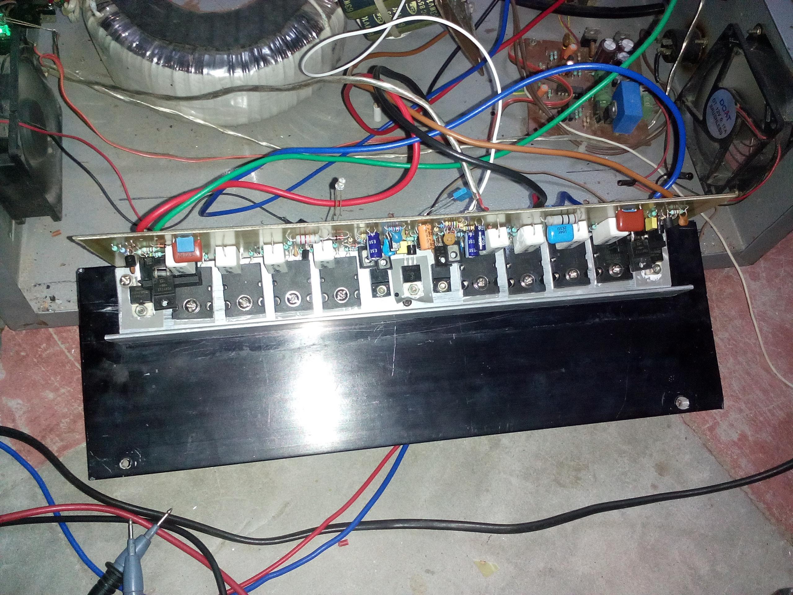

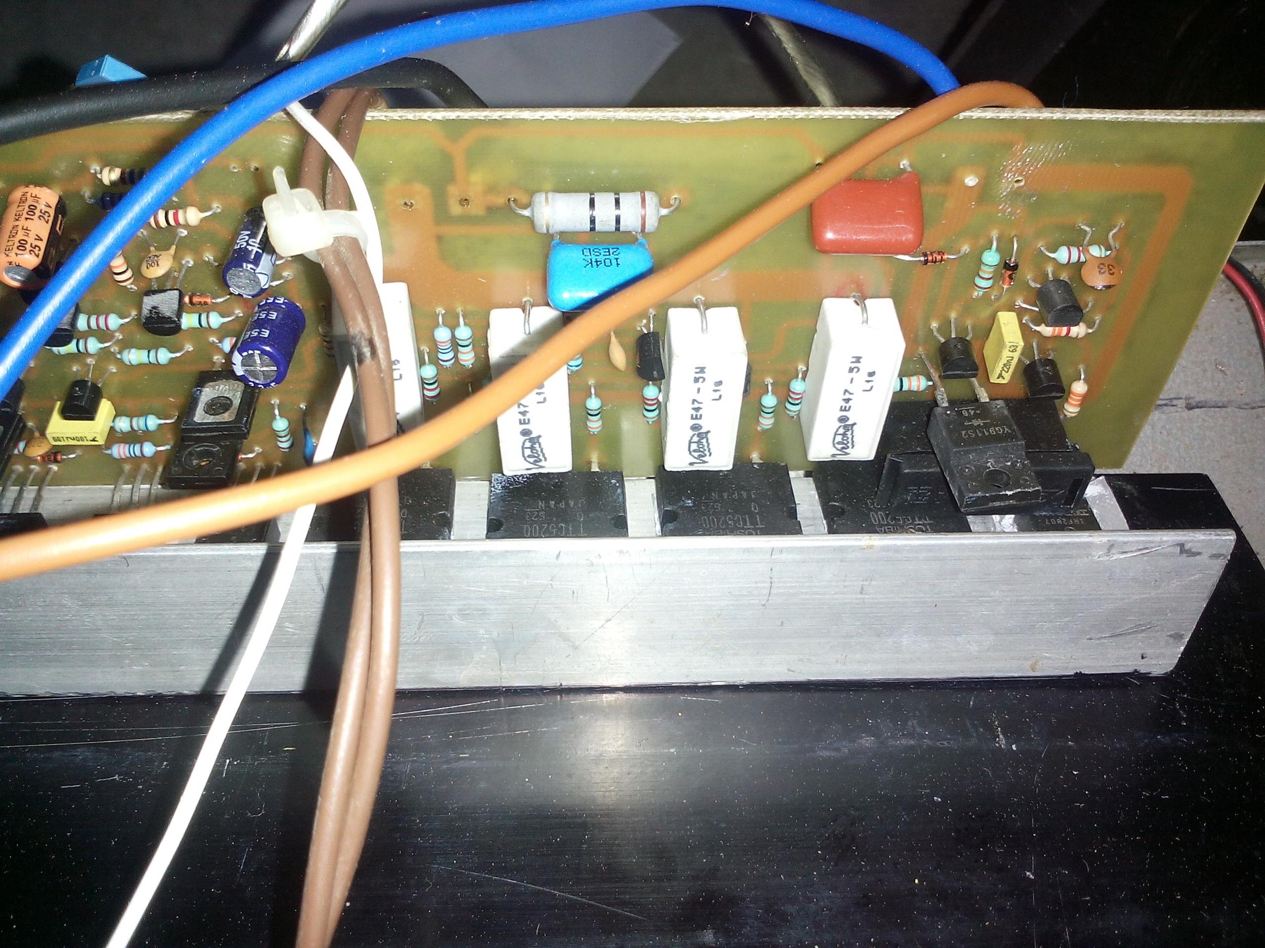

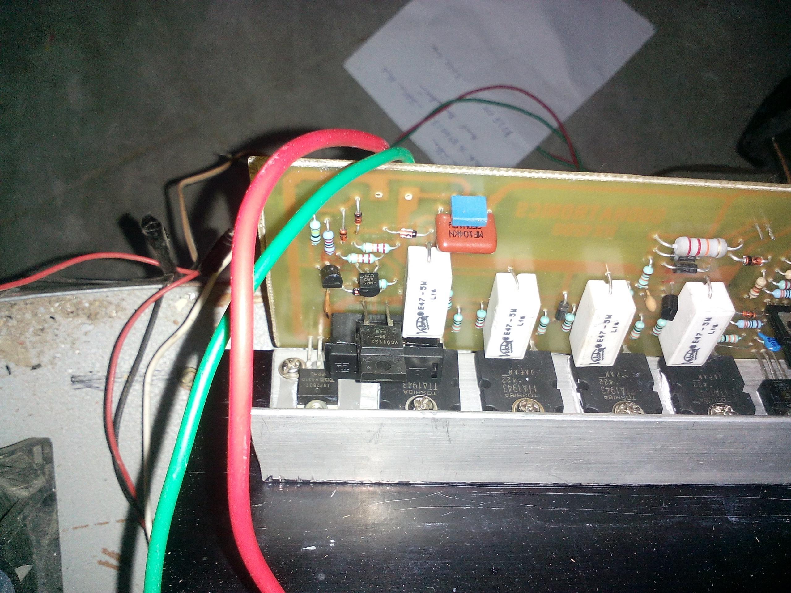

this apex discrete stepper is not working properly,negative side suddenly increased rail
on which pcb file you made this ? please share that file so we can see if something wrong on pcb layout.

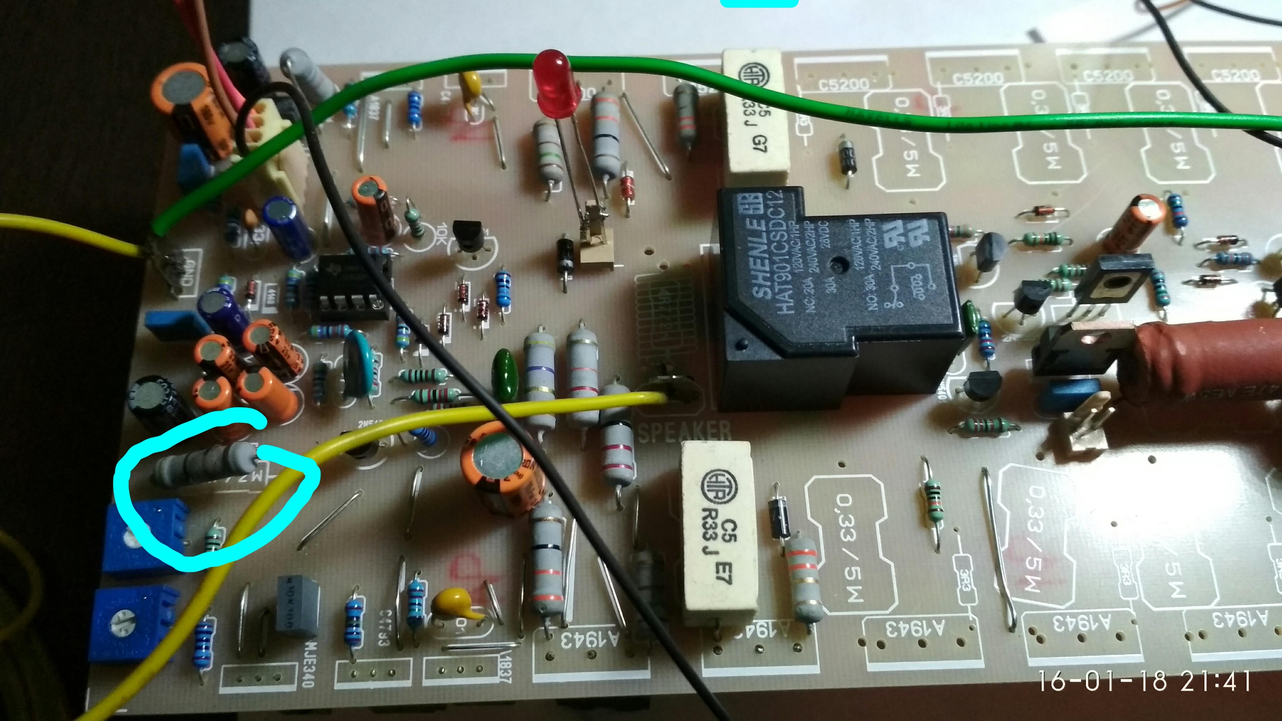

If I have on the power supply then start the burning resistance 100ohms marked as blue suggest me what can I do.
check resistance value are you sure there is 100 ohm 2w resistance?

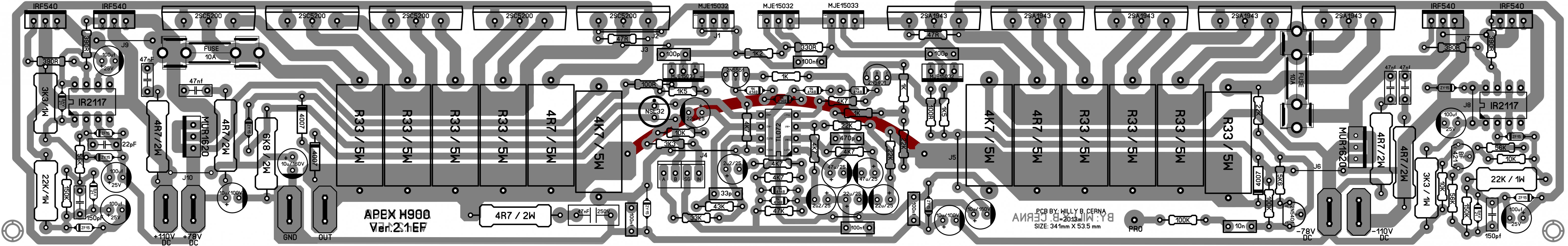

Please check the pcb is this OK or something went wrong please confirm
pcb may be not good .
Thanks rohin for your reply. if you have corrected pcb layout so, please share with me my mail ID is gunjaudio@gmail.com/ 08318685681 whatsapp me.

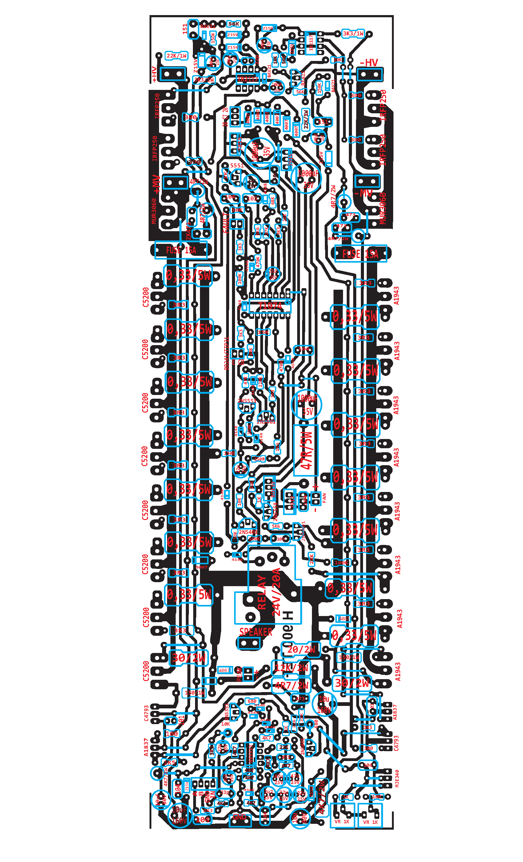

Dear Apex Sir please check and confirm this layout is correct or need any rectification.
