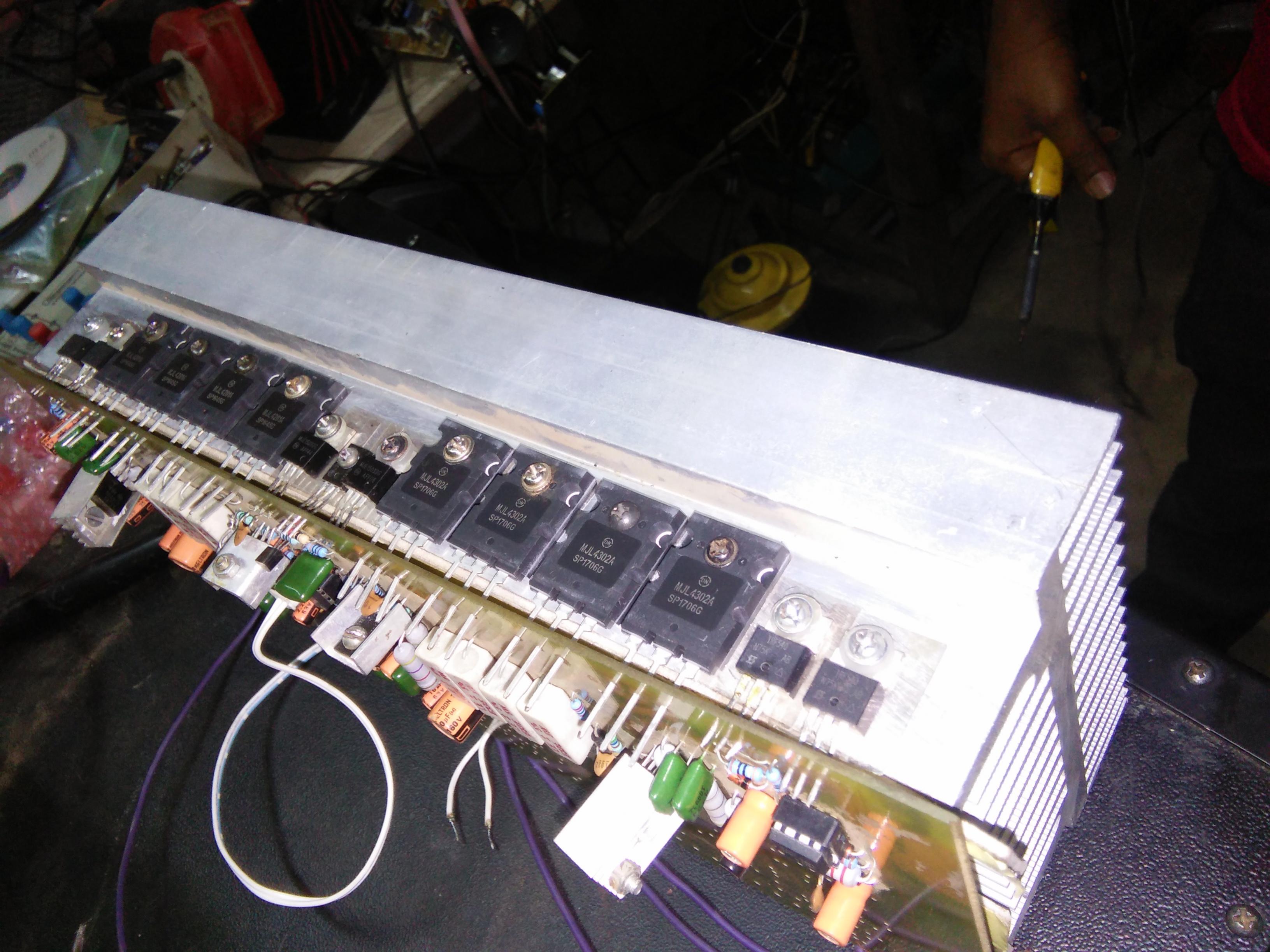

thanks but i think this is mirror of pcb if not then how you attach with heat sink?
[/QUOTE]just need to use the holes on the board to fasten the screws on the heatsink,,,
just need to use the holes on the board to fasten the screws on the heatsink,,,[/QUOTE]

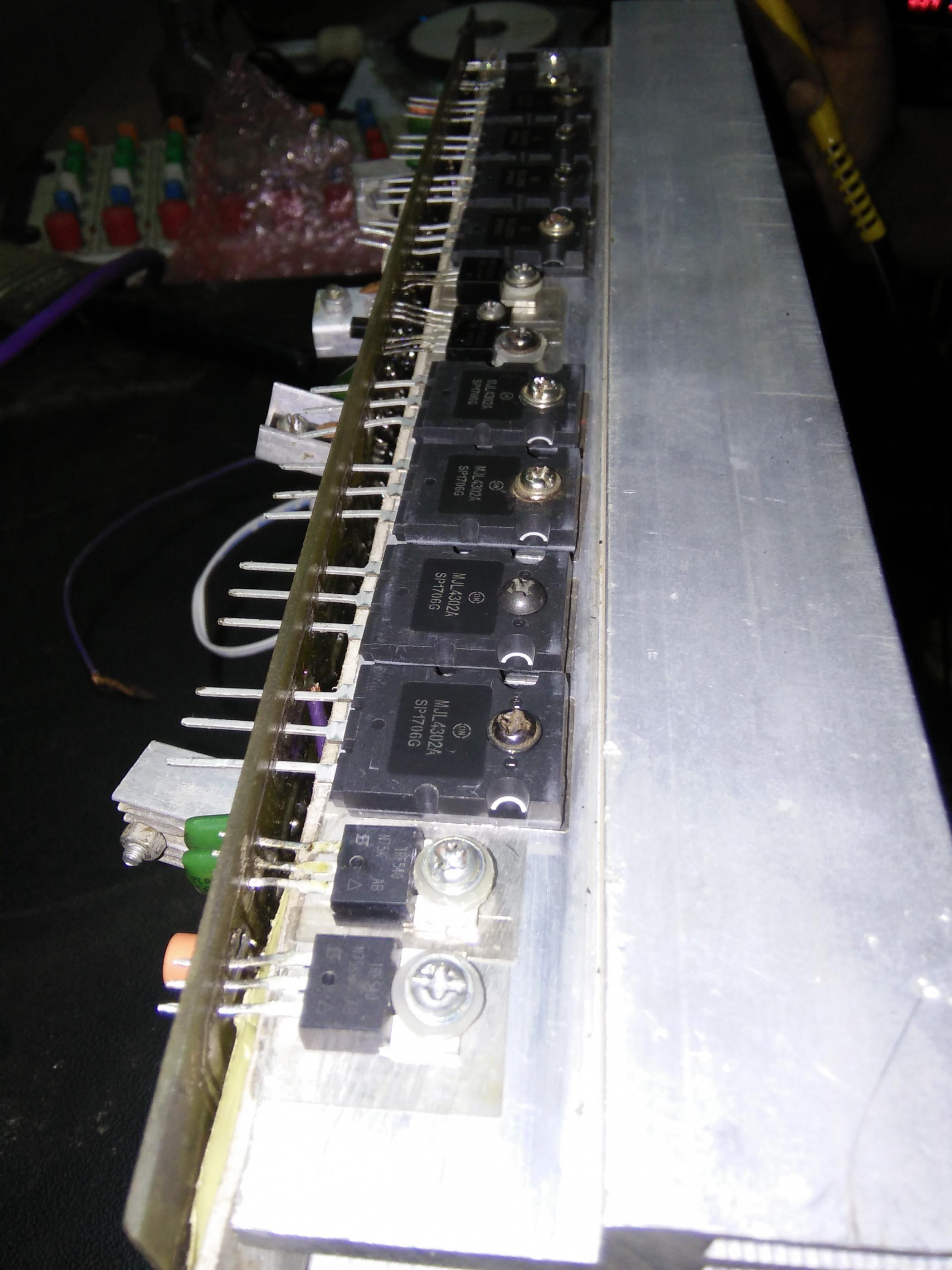

H900 with MJL4281/4302 .Test voltage 0 40 80 dc.sound good .I have test with 2ohms .
don't be crazy young man we respect your skill but don't try these amp in 2ohm in field .
I have tested it in high volume in 2ohms load .My DC voltage was +80 +40 0 -40 -80 sir.

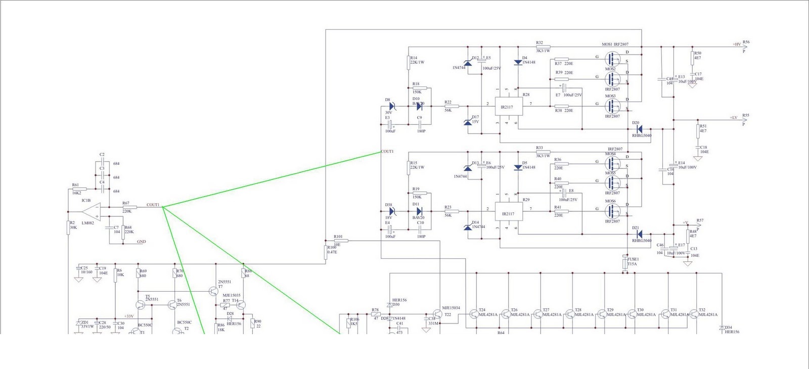

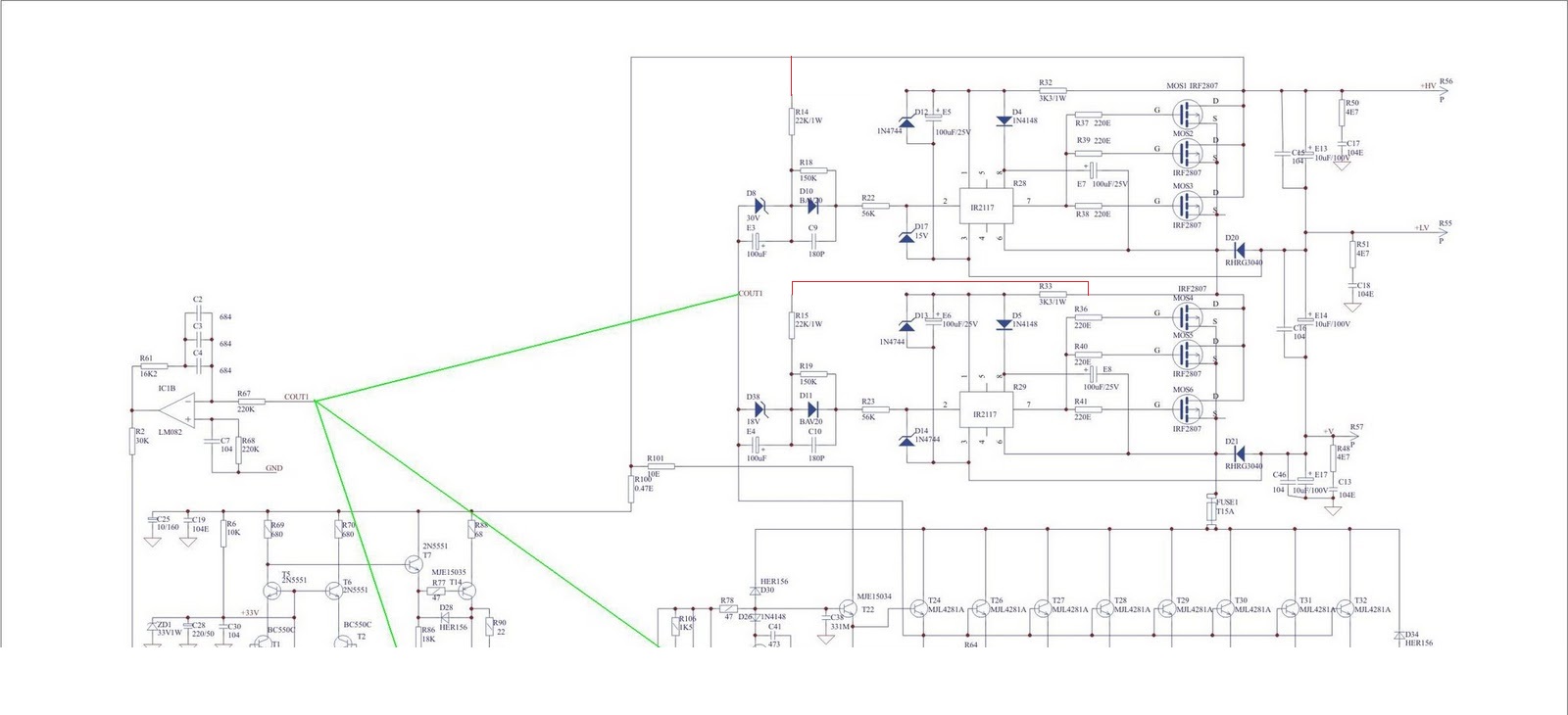

Hello Sir Mile... how are you? Hoping you can help me out for the 3 step tier. I am planning to try and use this option. With the schematic... which is the proper one for the R14 & R15 connection? thanks and regards
