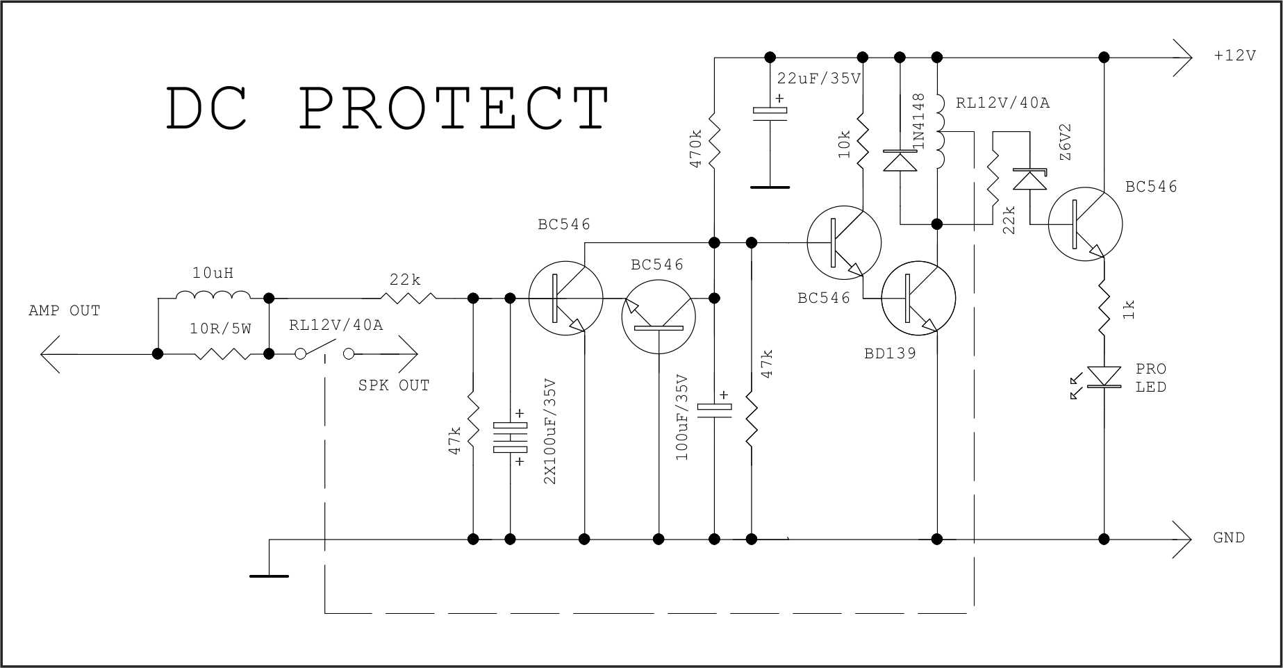

hi apex sir ,this protect not suitable for h900 at 45 v ac rms relay automatic off then on please tell me how to modify this protect circuit but dc sense is very good.i made four all have same problems. plz tell me how to fix.thanks.

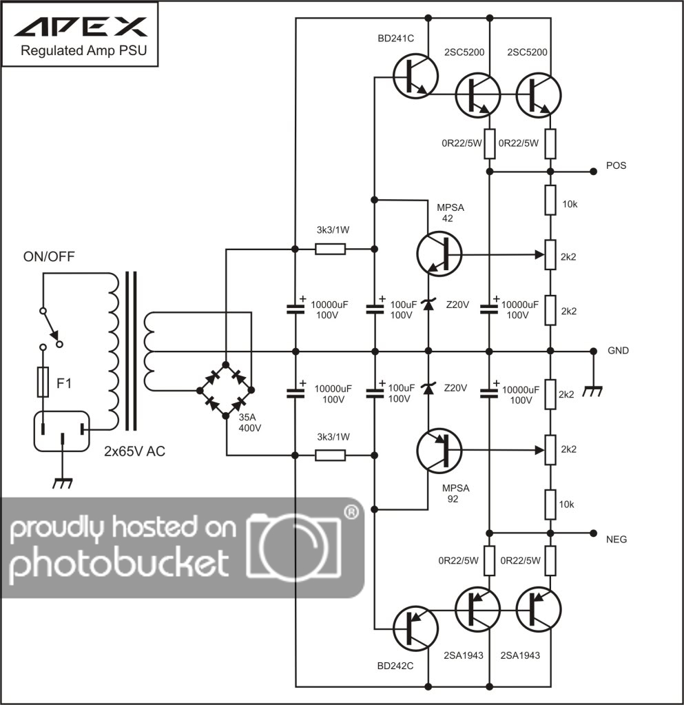

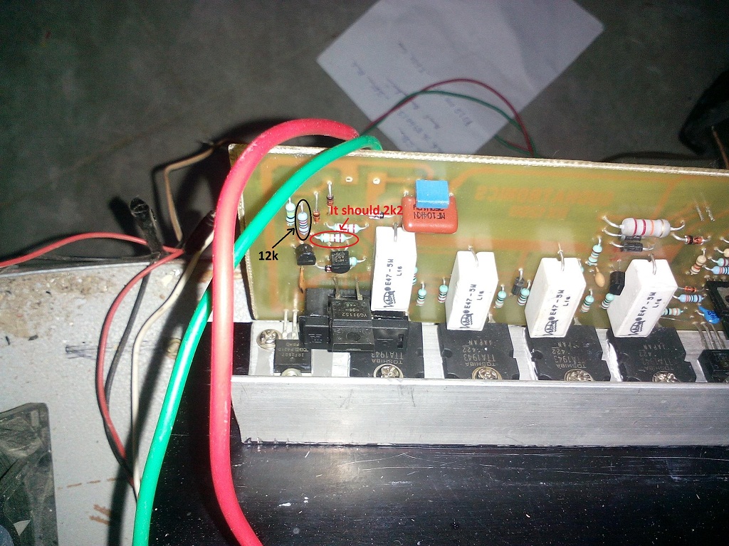

Hi sir,rohin
this apex discrete stepper is not working properly,negative side suddenly increased rail
I think you put wrong resistor on negative side. 22k must be replace with 2k2 and 12k instead 1k2.

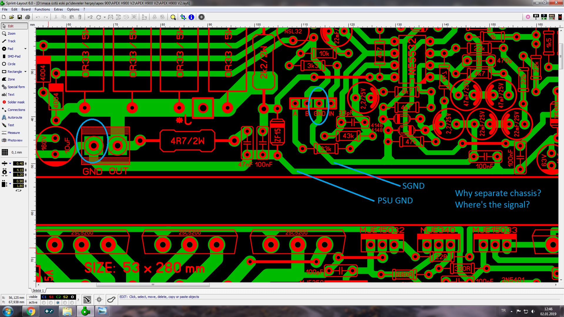

Why does the signal gnd and power supply gnd separate?
that reduces hum at the output,preventing dividing gnd current flow through input cables. leave it as it is.

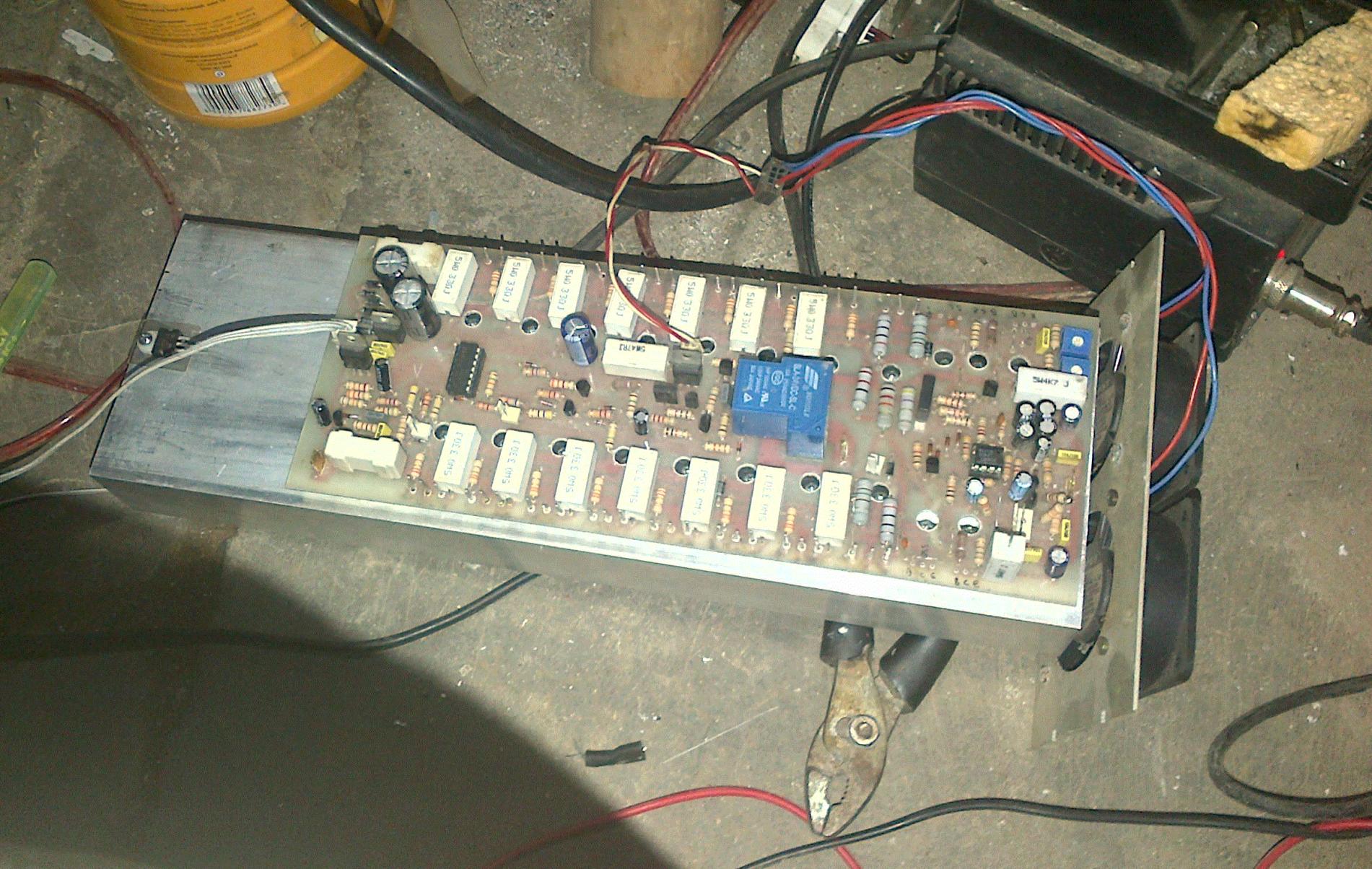

apex h900 amplifier speaker panelica output transistors and on the way burns instantly when bursting. Does this design really work? Irf540 Vds 100 volts. My power sopply + 113 +57 0 -57 -113 IRF540 direct on fire boom
