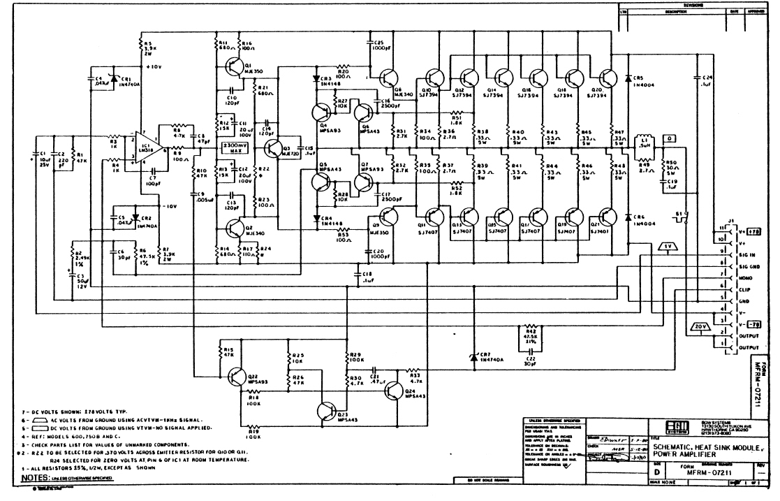

BGW 750B Bass Amp similar Apex B500
selected costumized 12 x SJxxx Motorola / RCA TO3 output devices very reliable PA Amp design
working 23 years 1978 - 2001 in High End PA Installation Frankfirt Airport Germany Disco Club Dorian Gray
To reduce heat I think can add TD1800 step down converter

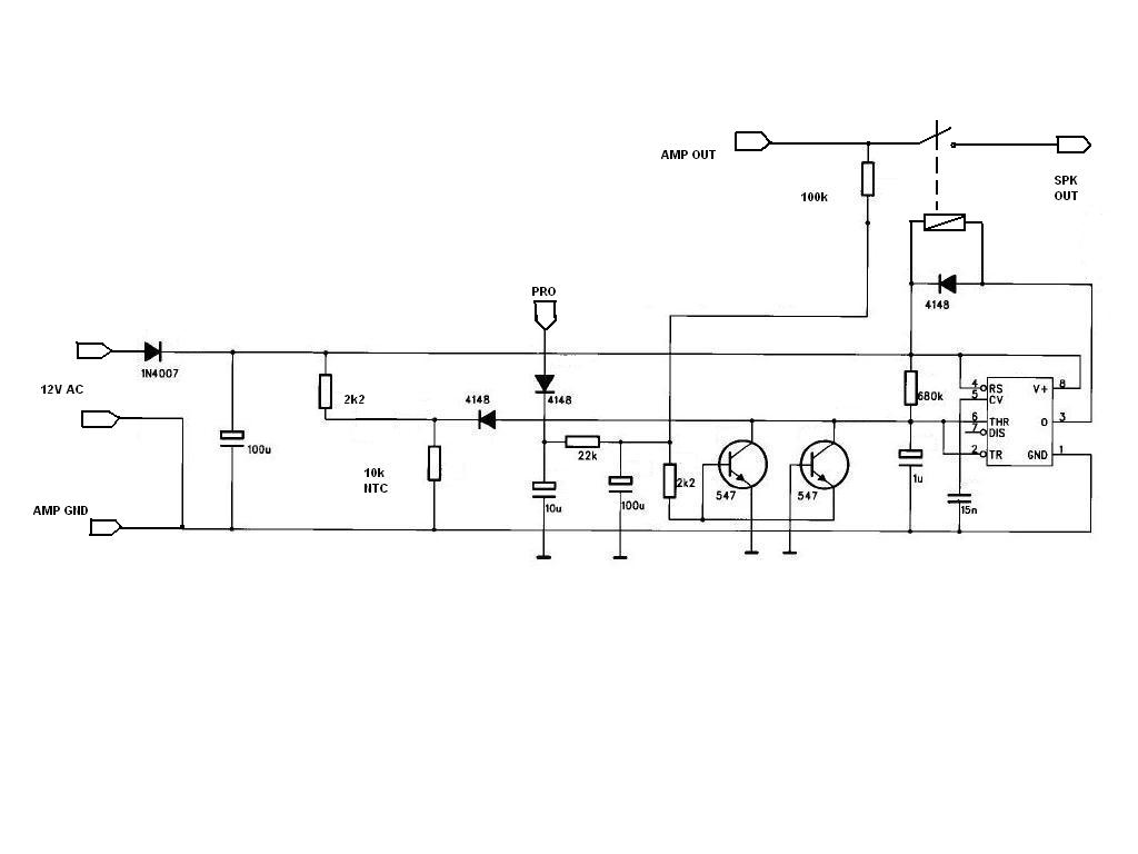

replace original VI Limiter with Apex VI Limiter, amp should work stable
BGW 750B Bass Amp is not similar Apex B500. B500 is CFA amplifier use OP amp as DC servo, BGW is VFA amp use OP amp for gain and NF fedback....

If I design new BGW 750B PCB with small changes ( VI limter )
and add TD1800 step down converter,
can BGW 750B work ?
In this case compare to 500W before, now can get 1800 W
I remember some diy people add class H Stepdriver to old BGW, it works and heat decrease.
