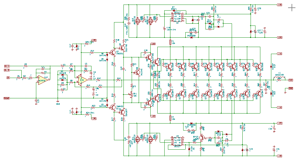

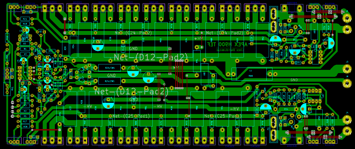

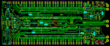

Hello Everyone!
I think this is my 1st ever post here.... I just wanted to share my Apex H900TEF... Hope someone who built this Amplifier will be able to review this so others may be able to build using my layout. Once someone confirms that the schematic is correct I will share my gerber file or pcb layout....

Nice work, I like your idea to use car fuses,

Thank you Sir.
I found some discrepancies on my schematic/layout and I'm rectifying it.

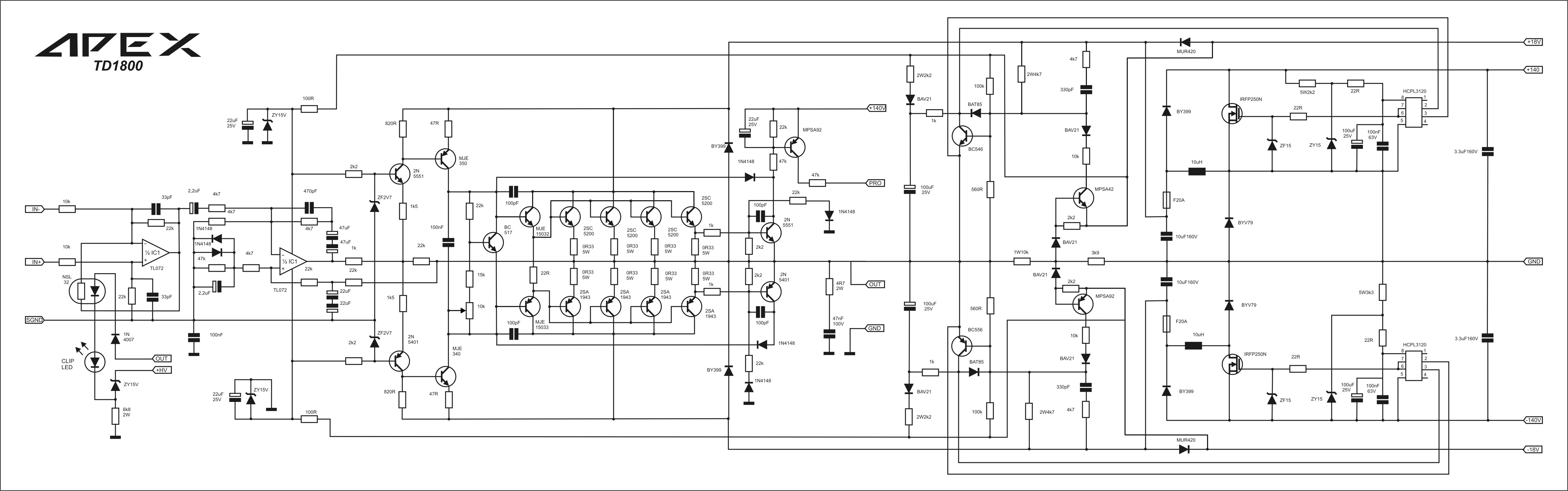

APEX TD1800
Wow another ONE! This well make me busy again. Thank you Sir Mile.
Mackie SWA1801?(TD part).
TD1800 use HCPL3120 igbt mosfet gate driver.
hi sir mile..was the schem tested?this is another great project to build..thank you sir..

HCPL3130 can be use but you must use 200V mosfets.

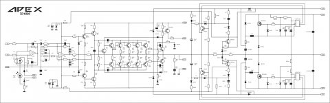

Dear Sir,
is circuit description available ?
1...only 5 (10) Toshiba 2 Sc 5200 / 2 SA 1943 Output devices Rail 140 V +/- ?
.. 140 V rail with Toshiba 2 Sc 5200 / 2 SA 1943
how can this amp work stable if Vceo max. 230 V for this ttransistors ?
Vceo is 230 V for this transistors, rail should be max 115 V
How is it possibile this amp can work stable and not violate SOA from output devices and not get second breakdown?
sorry, for this question, but long time before have import from China 50 pcs. PA Amp with similar rail +/- 145 V
60% amplifier fail within few weeks after sold. second breakdown
I see 2 Rail
18V
and 140V
Is is correct to say.... in standby mode amp running with separate 18 V Rail protect with MUR 420 from High Voltage Rail ?
if outpower required HCPL Mosfet driver add Voltage after MUR 420 ?
Is it corrcet, .....this amp need only 1 big Rail to work ,
the 18V standby Rail can be small PSU
In this case 18V standby rail,...the amp have very high efficiency
but can this design work stable with only 5 output devices and drive big 18 inch subwoofer @ 140 V rail ?
I remeber, old classic class AB have already 5 output devices for 400 W RMS @ 4 Ohm 80V Rail and 50 % energy convert to heat
