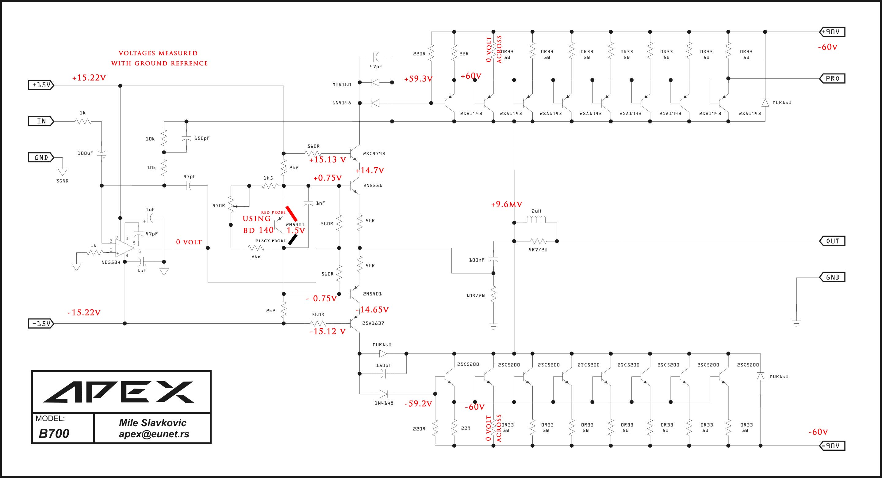

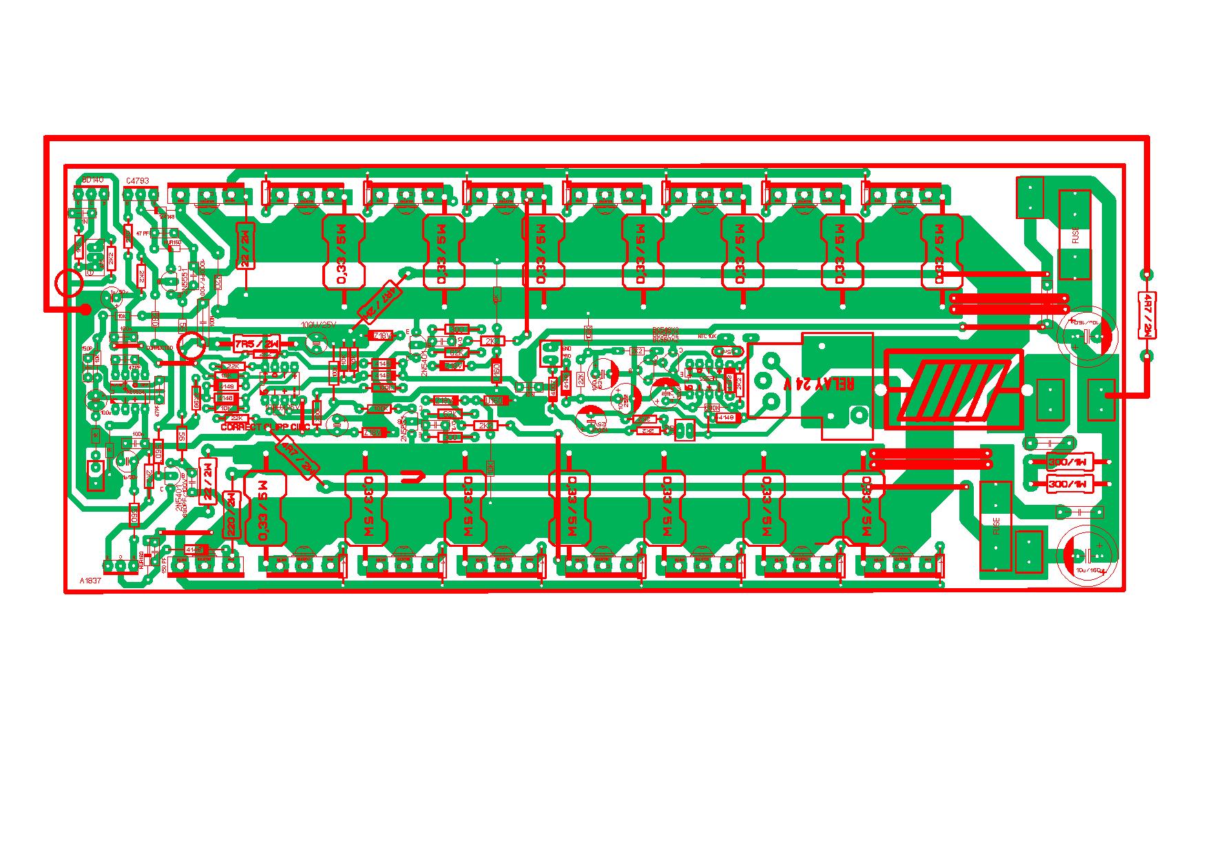

Hi sirInput GND missing! Amplifier can't work without connect input GND. I can't see wire jumper (red line on component layout) on botom side of pcb, somethimes I forget connect that wire.

Good evening i have completed h900
before 2years but now i have time to check it.i have problem my dc voltages are at without load is 66v dc and 115 v dc after load voltages becomes 37v dc and 77 v dc what the problem please solve me.thanking you.
Finally i success in making h900 after changing 2n5401 and its 100 ohm resistance.But how can i know that my stepper is working.please help me.thanks
At ab class mode across 100ohm volts are o.25 and at mje340 collector emitter 1.6volts just half as mentioned in apex circuit.thanking you

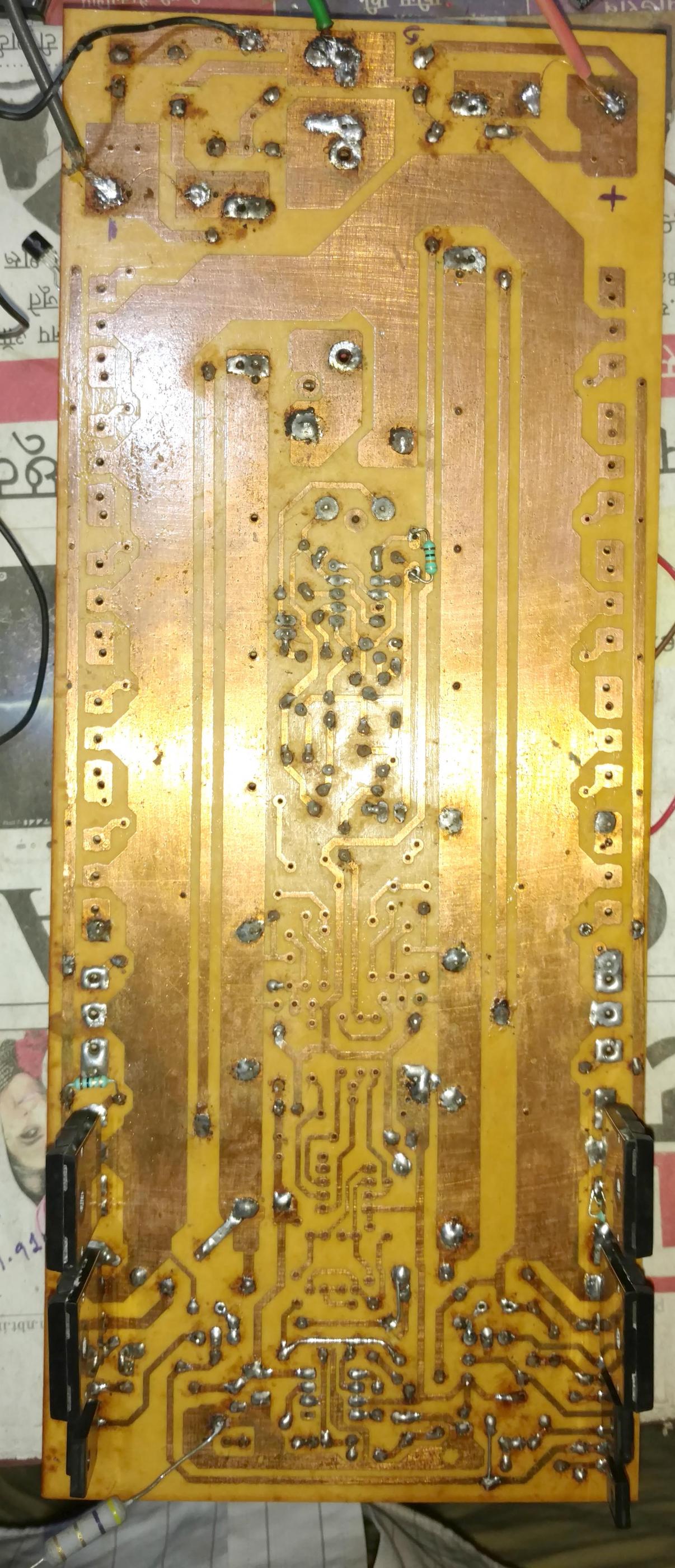

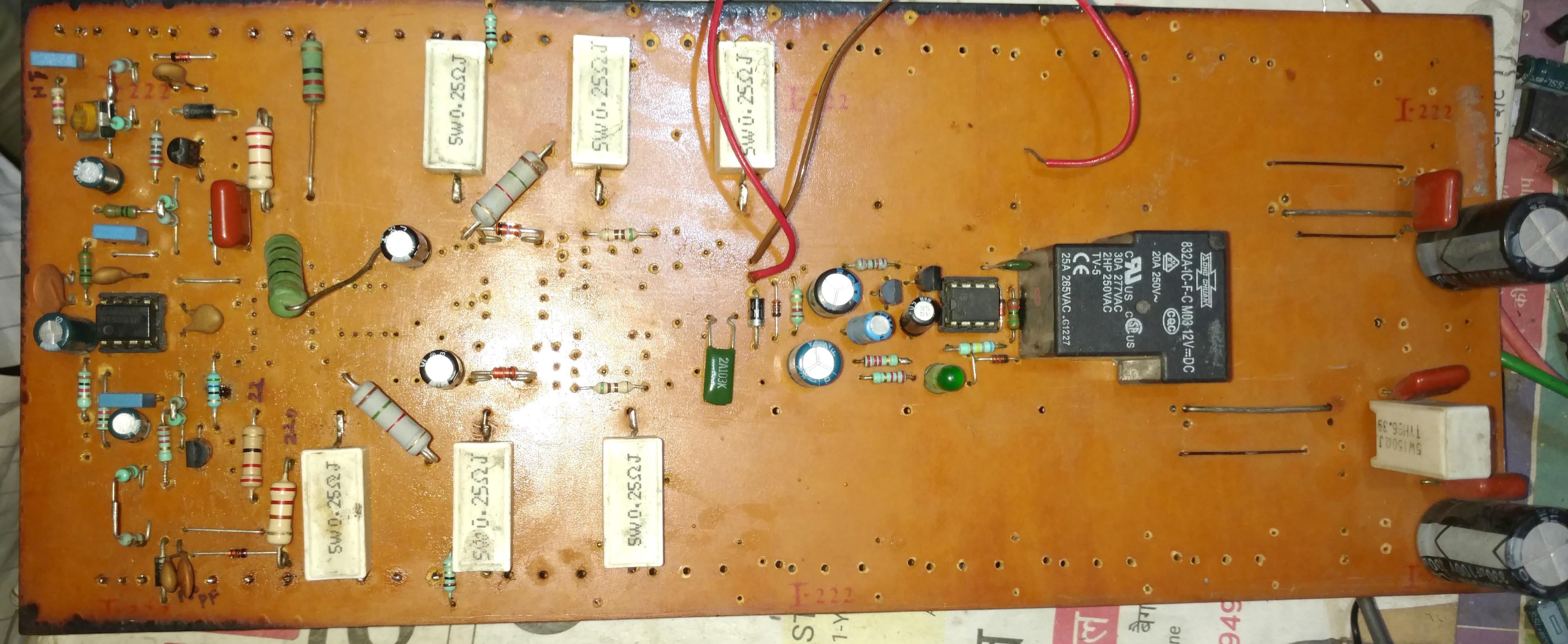

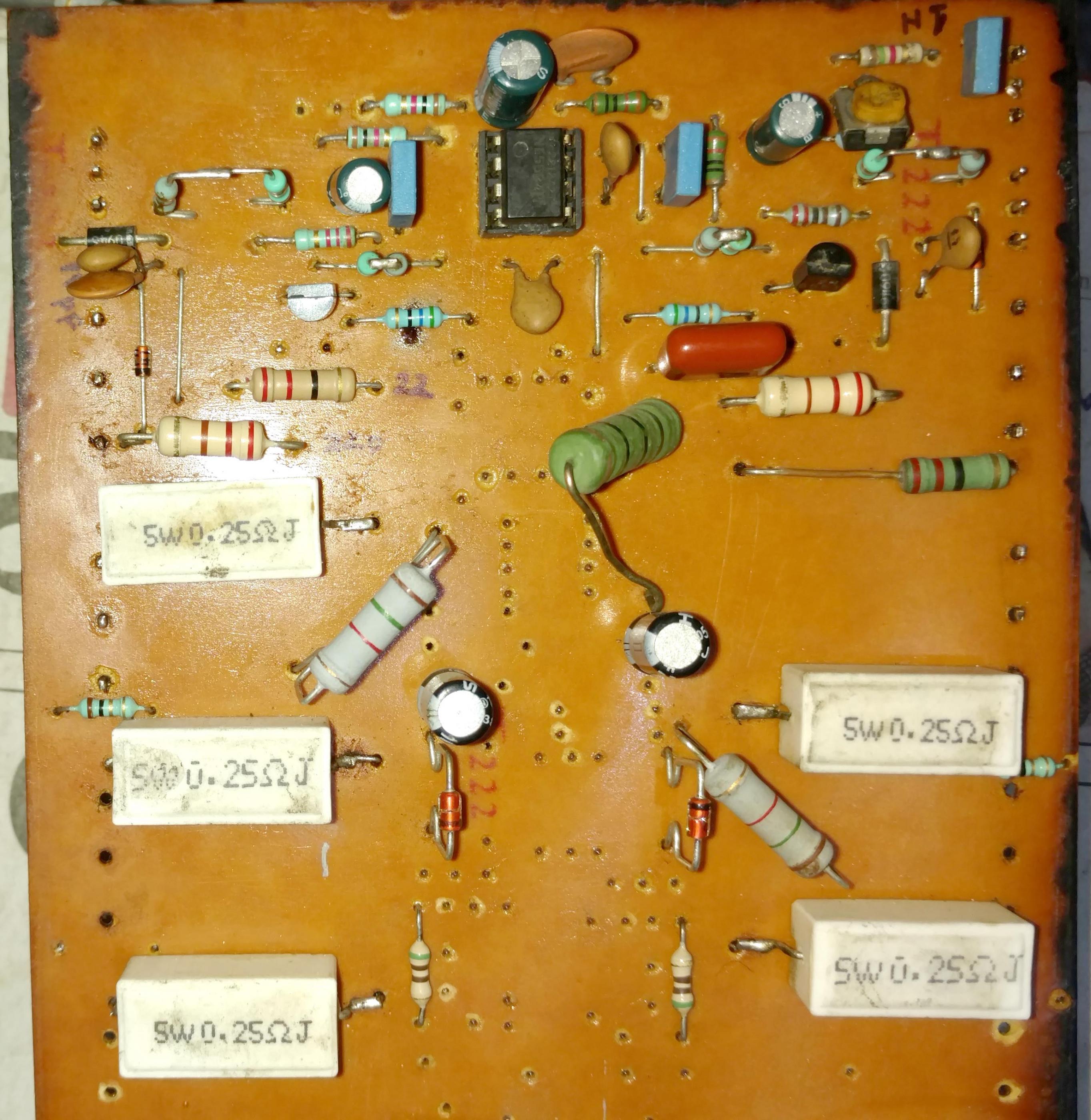

hi apex,
i cannot set the bias of h700
iam attaching pics and the layout of the board. i can vary the voltage across
collector and emitter of bd140 (2n5401) from 1.23 to 1.51 volts but there is no voltage across emitter (0r33) resistors.also attaching the measurements pic.
votage used 60-0-60v dc and 15-0-15v

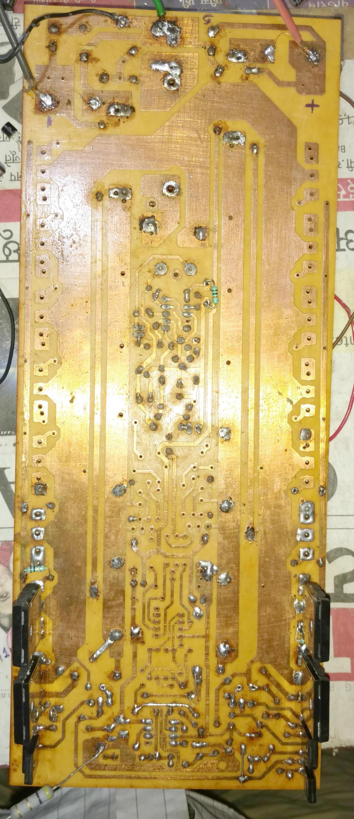

hi apex,

Replace 1k5 resistor in series with 470R trimer with 1k...

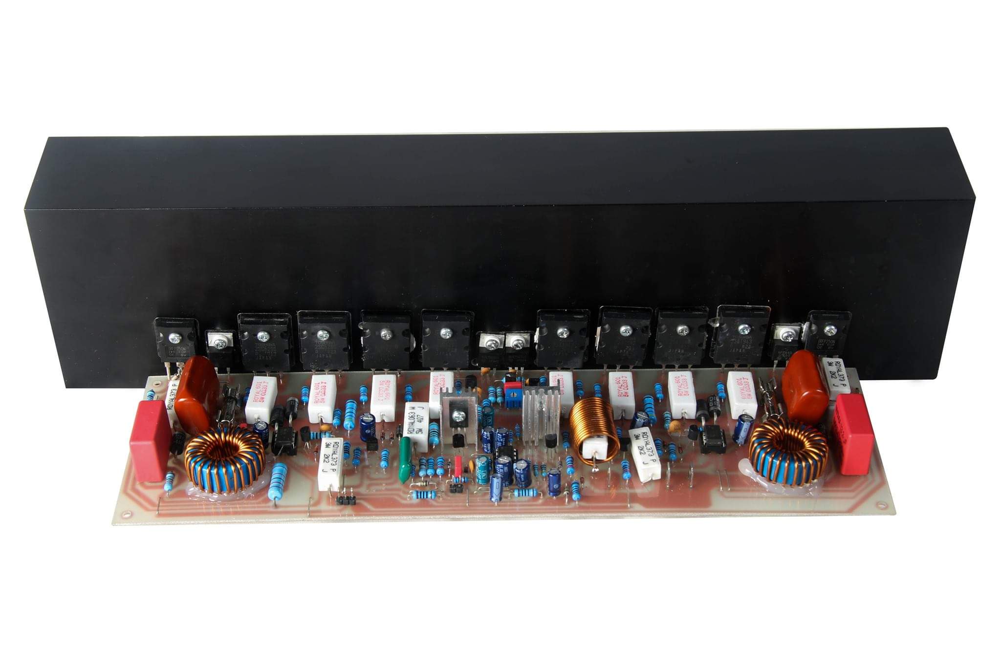

In these days, I will build a class H amplifier based on SD-5 of Apex. I will be posting photos here or in another single thread. I wanted to ask Mile: Can I use this step driver with +/-140 +/-70V? I think of placing 16 transistors in the output stage.
