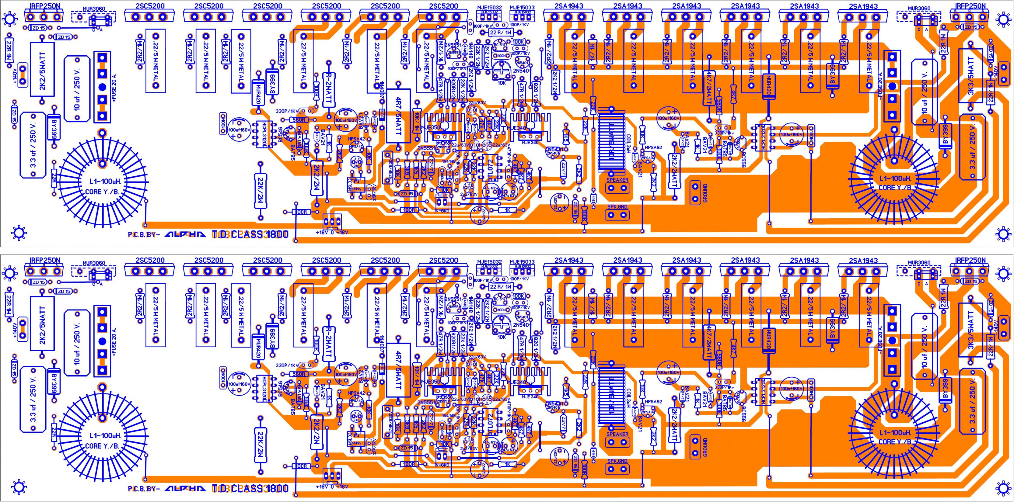

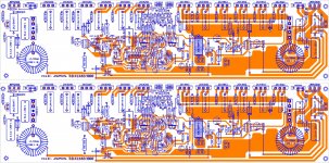

TD CLASS 1800 MY WORK now corrected
there were some small faults in earlier posted designs, now corrected

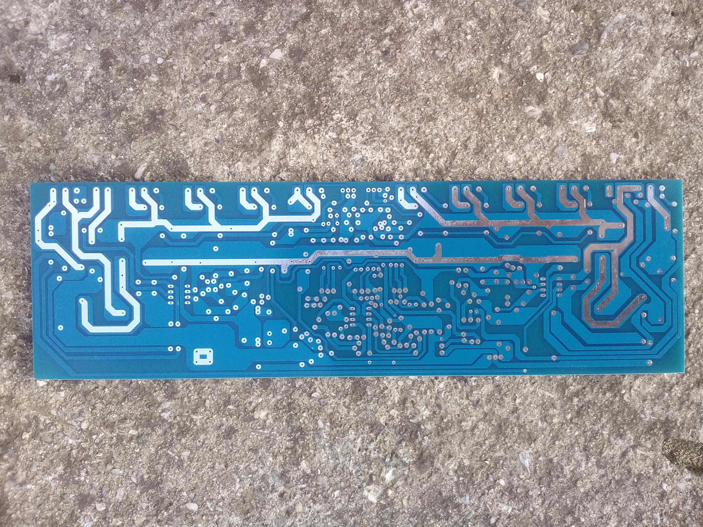

Both PCBS ready😉😉
Hi Andrewlebon; good work... I will be following your advances with that amplifier. I am also building a class H for my brother and I would like to have several choices. Thank you.

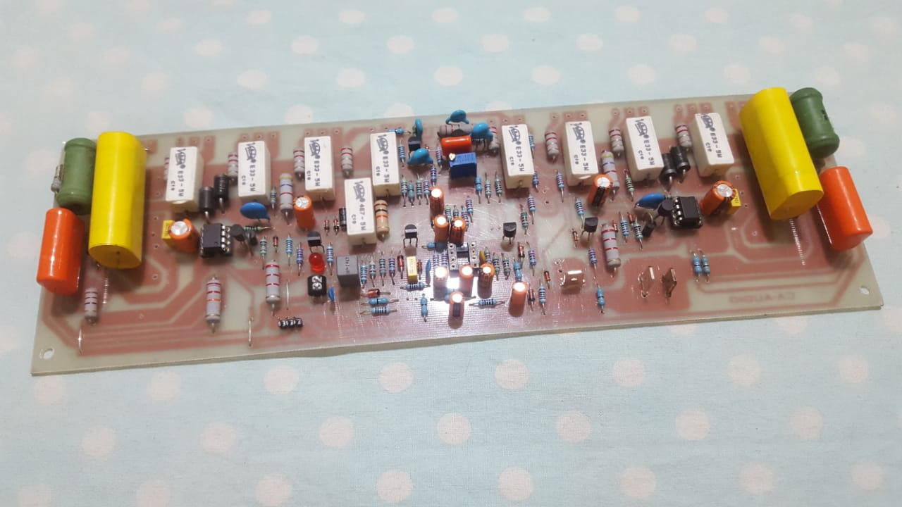

TD CLASS WITH 6 PAIRS OUTPUT ,70% WORK DONE ,WILL COMPLETE SOON.
Class TD have 2 Rails 18V and 140V
+/- 18 V - Do you how much max. current is required fpr 18V?
Could be 1A ok ?

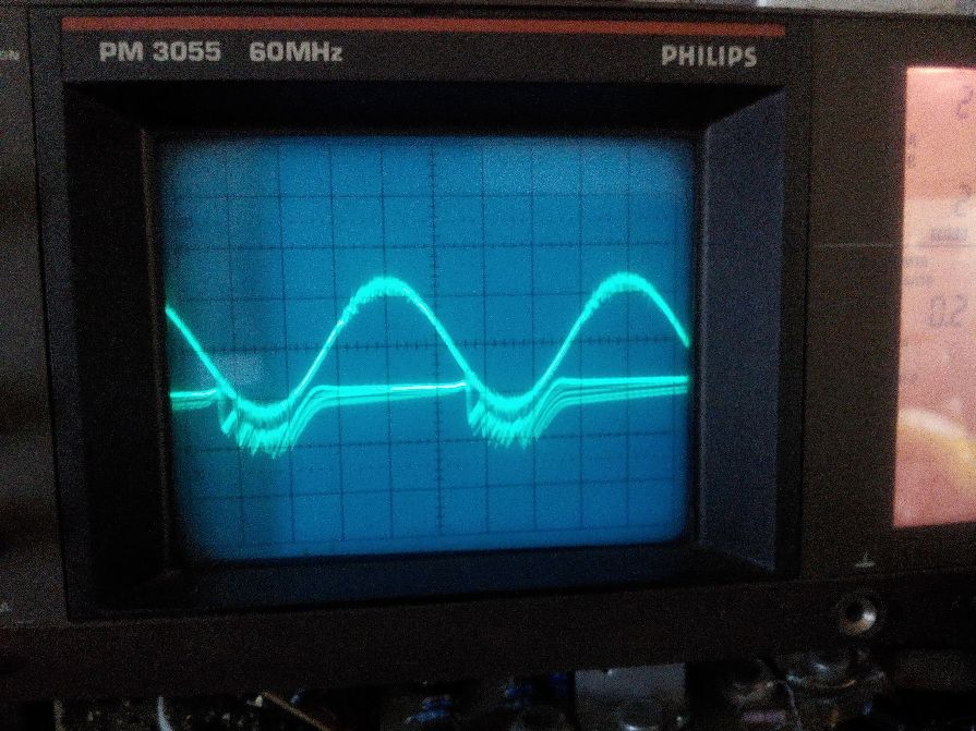

It does not work properly.The oscillation frequency is too low (about 50 kHz) and I tried to raise it up but not successfully.I've changed different values to coils from 5uh to 200-300uh without success.Has anyone done it to show us the conclusions he came to?

You can use it for fullrange but THD will be high on 20kHz. It is PA not hi-fi amplifier THD is as class D amps about 1%.
You can reduce the distortion, if you run Q1-Q4 stage (VAS) directly from +/-140V, istead of the switched voltage. Heatsink for Q3, and Q4 will be necessary, and may change Q1, Q2 to higher voltage transistors.

THD on TD1800 is very low up to 25W. If you want over 1000W class TD is compromise.
Yes, sure. But You can improve more with my modification, and it costs nothing practically.

Q1 and Q2 change with MPSA 92 / MPSA 42 300V TO92 small signal Transistor should work
