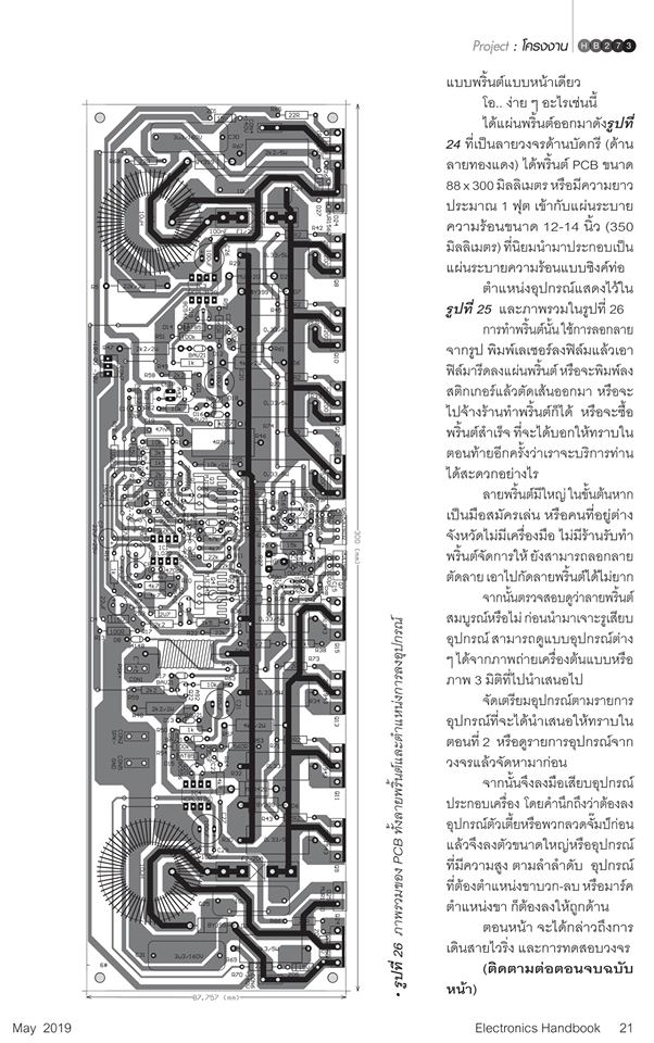

td1800 component layout
Hi andrewlebon
can you upload all pages from this project in Thai language ?
easy to translate, my friend is married with Thai wife
APEX TD1800 clone from Thai

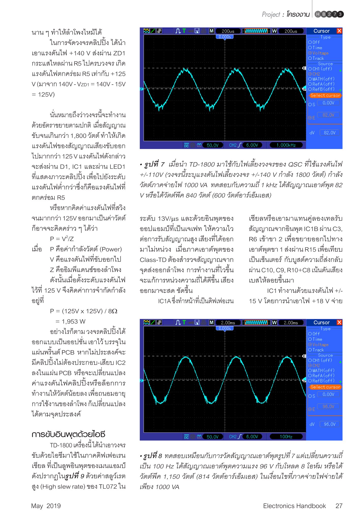

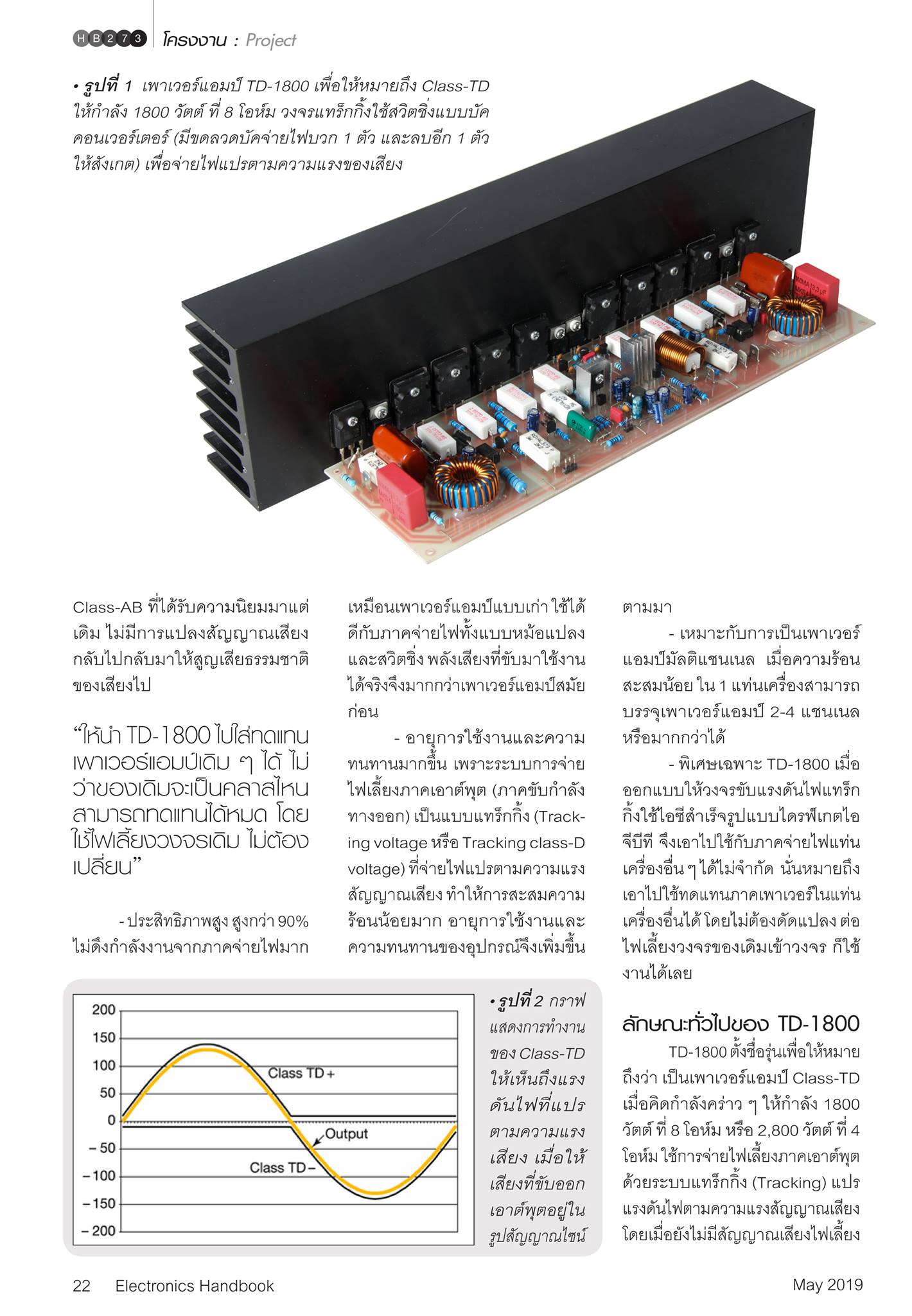

TD1800
electronics handbook mai 2019
only in Thai ?
Is there english version available ?
Otherwise my wife is Thai, she can translate in english or german
but translation from Thai in technical englisch or german makes big big headache ......
Shes not a technican, she work in office, ......

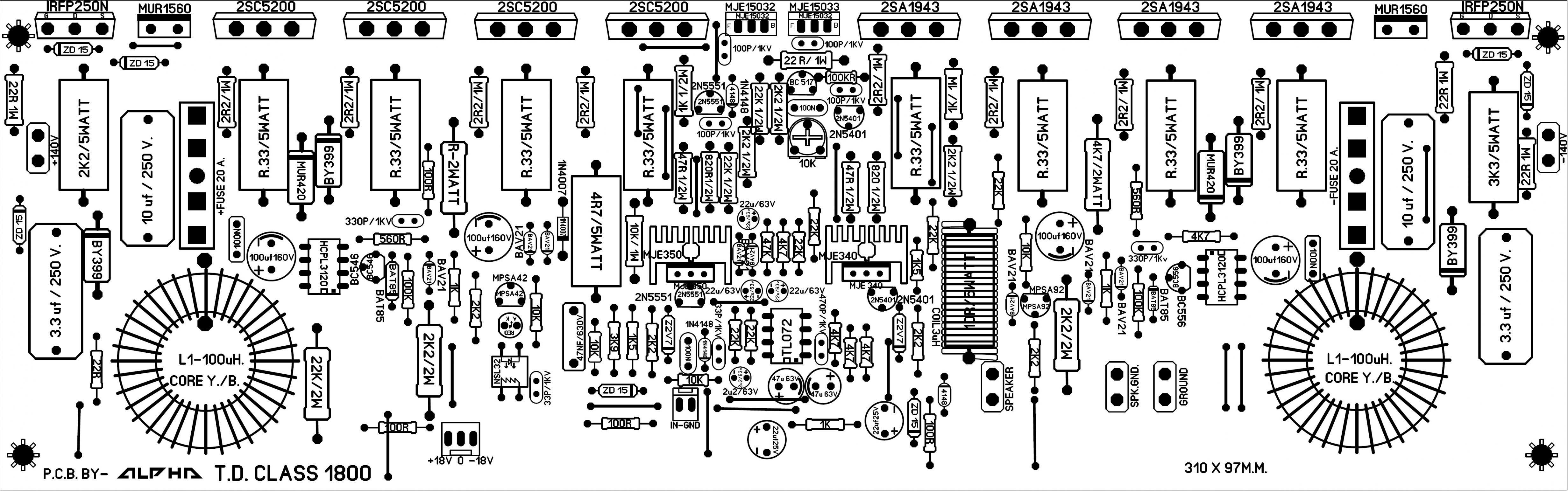

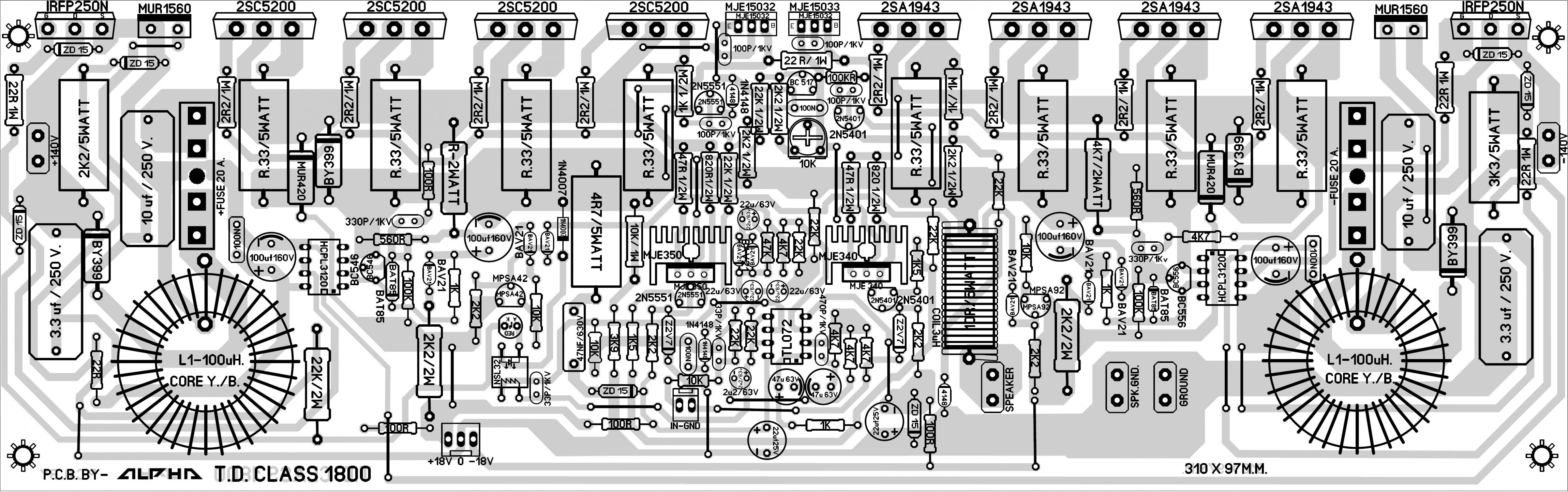

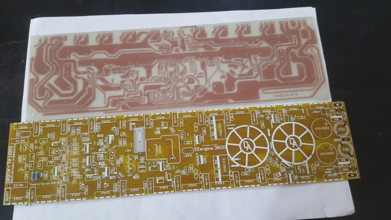

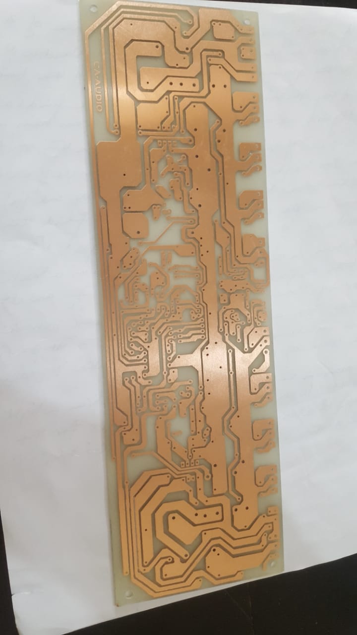

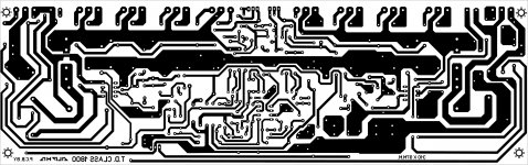

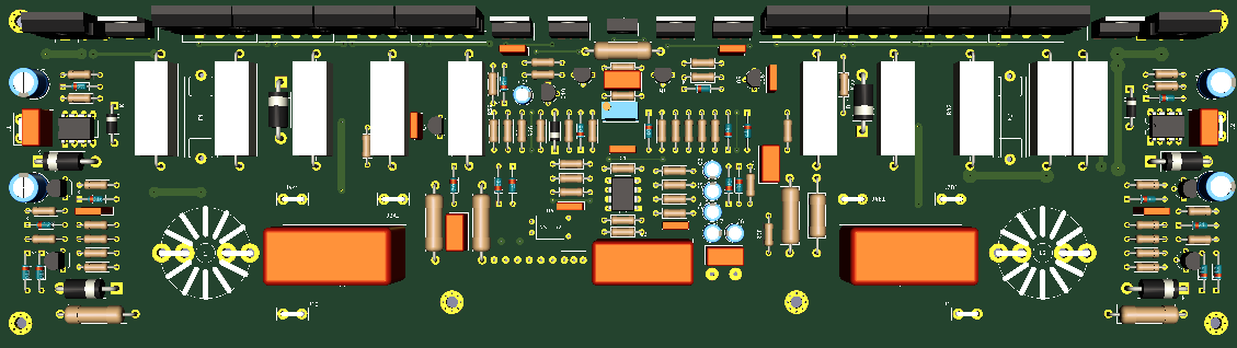

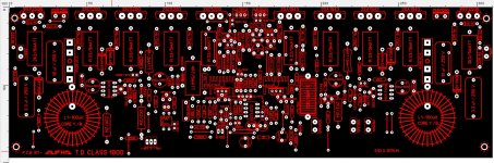

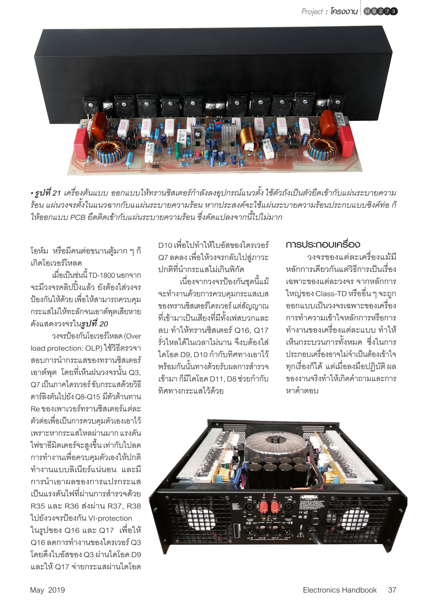

CLASS TD 1800 MY DONE WORK
TD CLASS 1800 MY WORK PDF
TD CLASS 1800 PDF
TD CLASS 1800 PDF

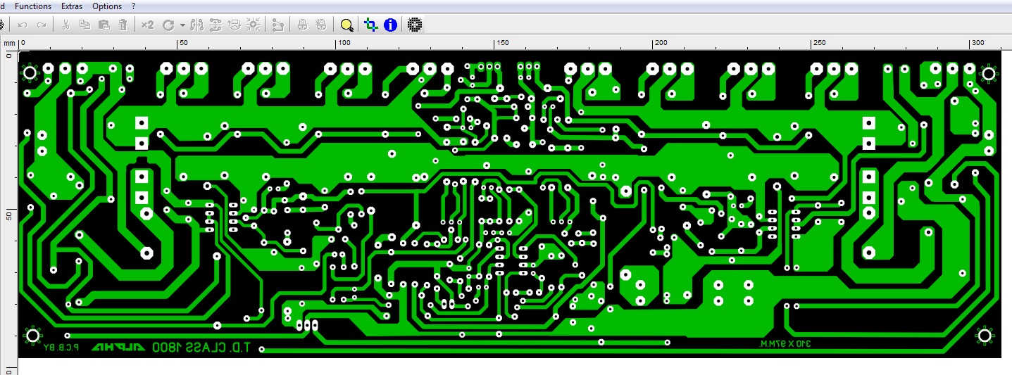

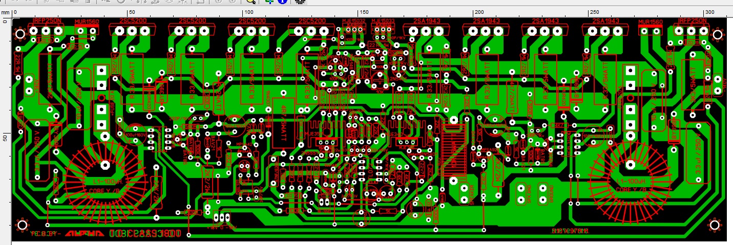

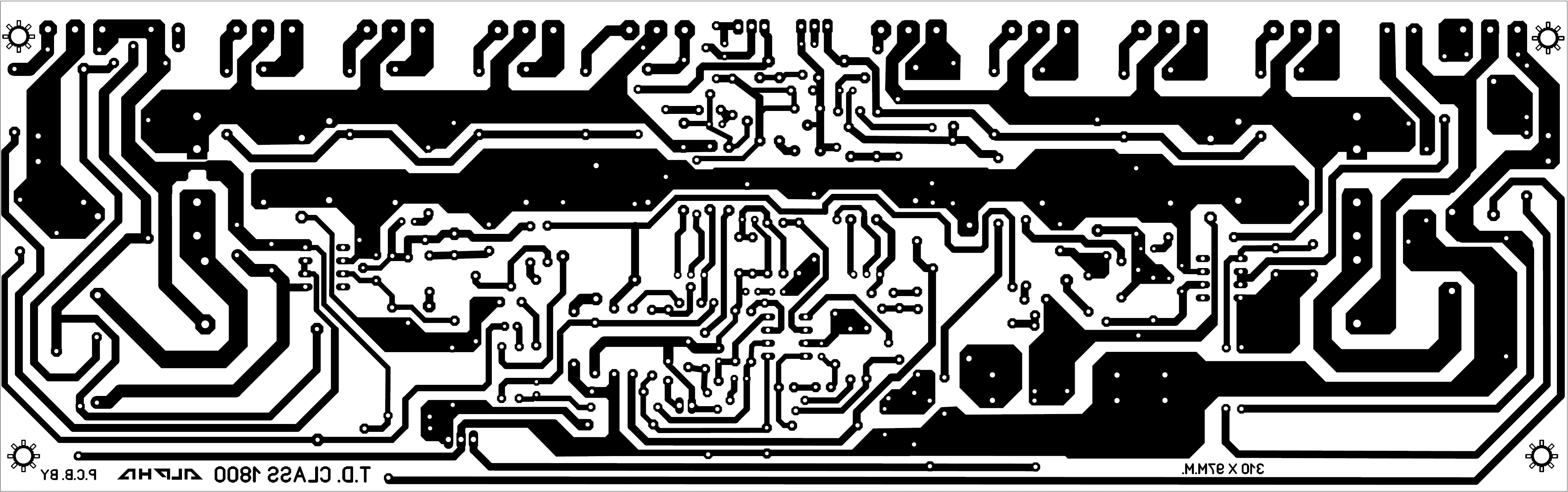

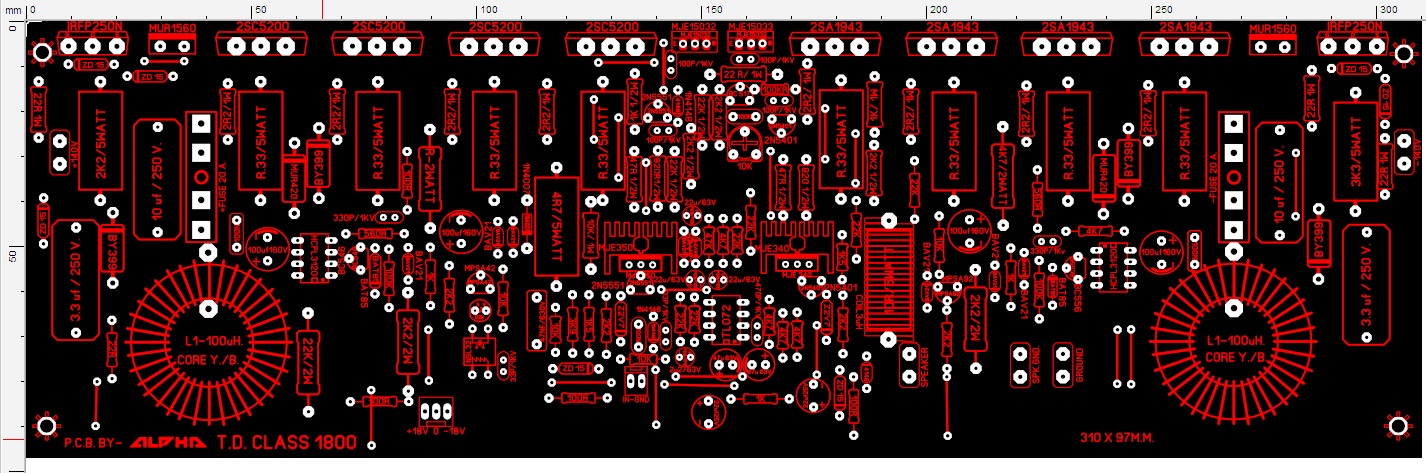

TD 1800 SCREEN SHOTS
Gerber Files available ?
if yes please send to phoonpool@googlemail.com

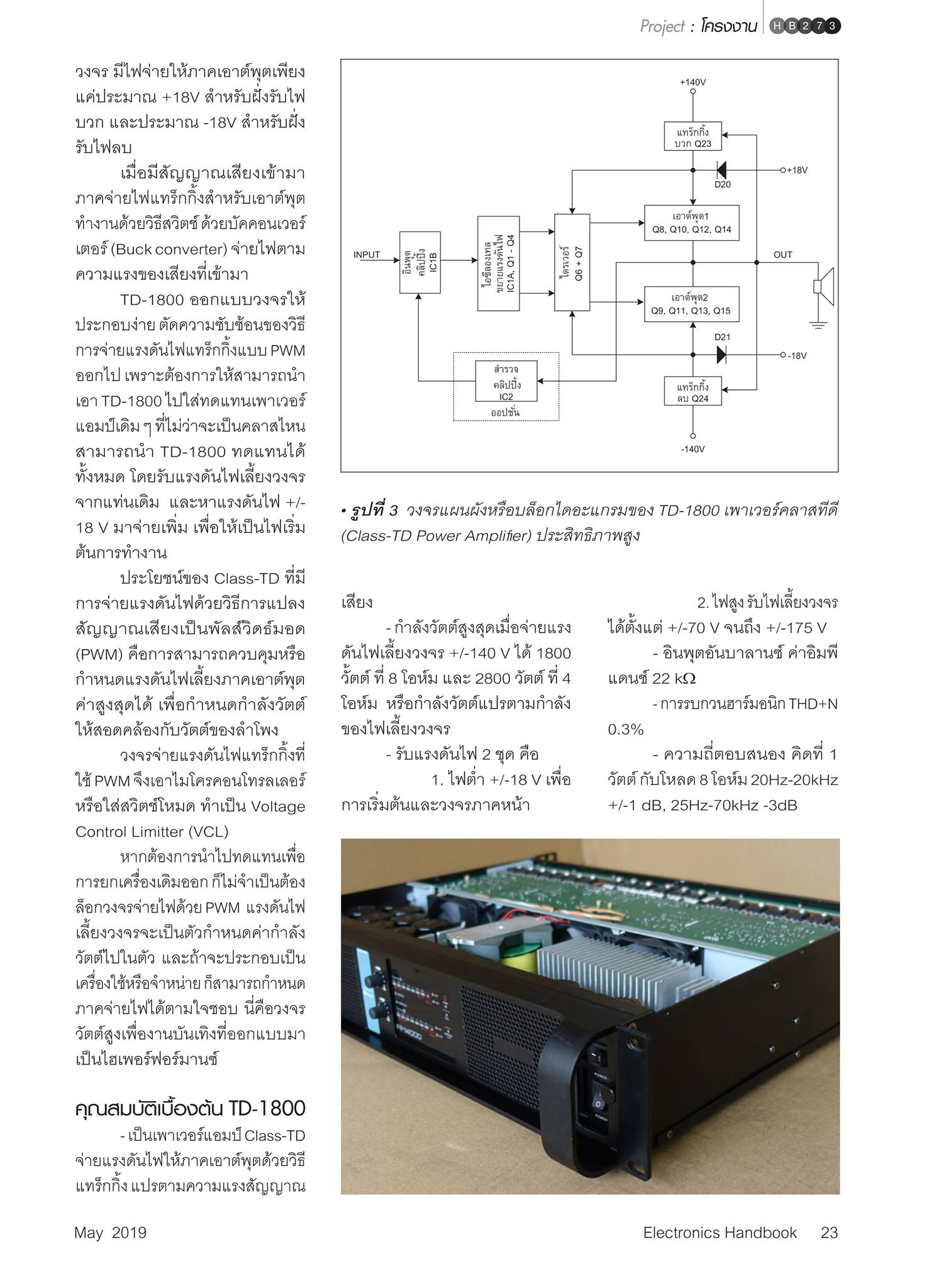

What inductor do you use ?
Turns copper ?
regards
hi vedimitra nice work and thanks for sharing .
what is the minimum impedance that this amp can handle for long time ?
and what is the value of the inductor ,is it 10uh or 100uh ??

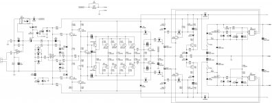

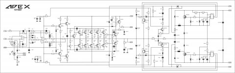

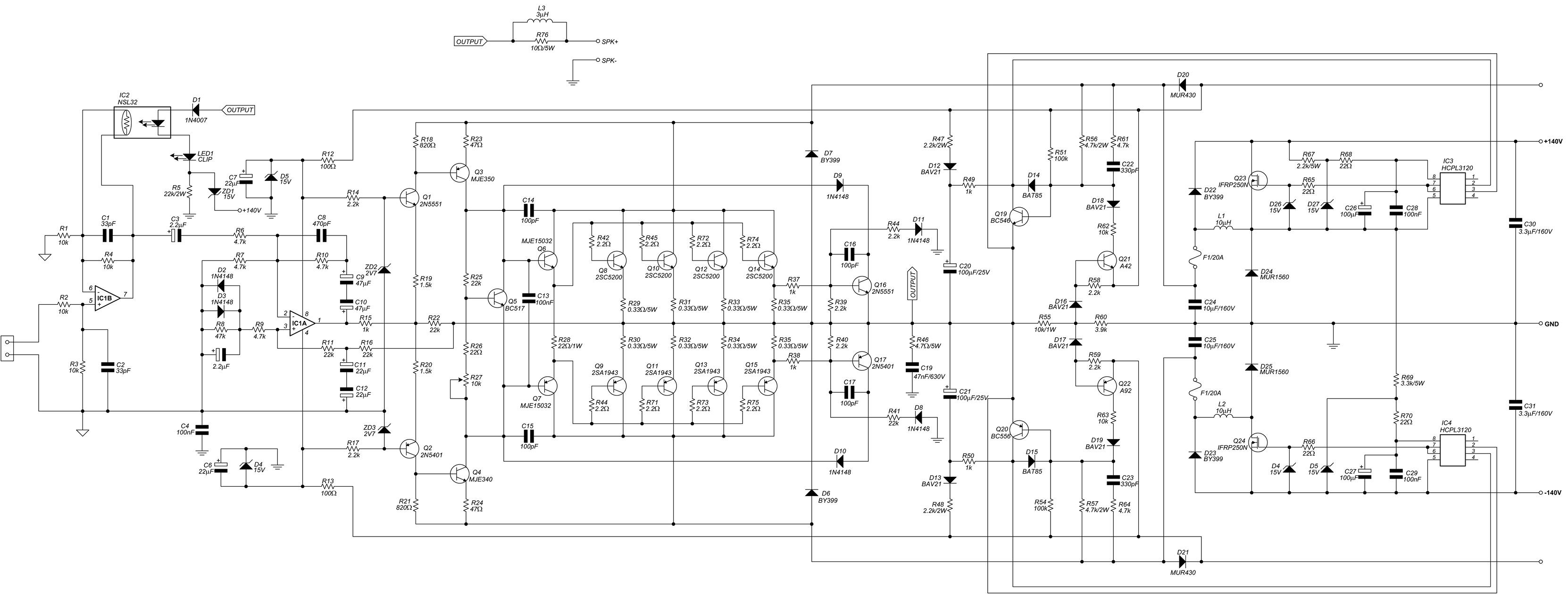

Apex schematic show 10 uh
but what Inductor ? T-157-2
That's an RF toroid core:Apex schematic show 10 uh
T157-2 Micrometals Iron Powder Toroid
Both PCBS ready😉😉
do you share Gerber Files ?
or PCB layout Files ?
