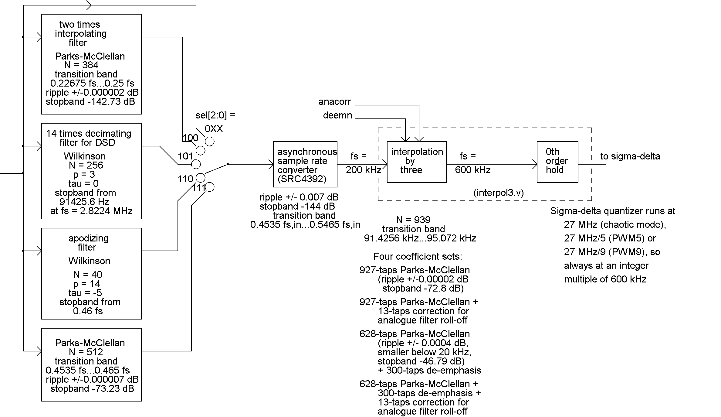

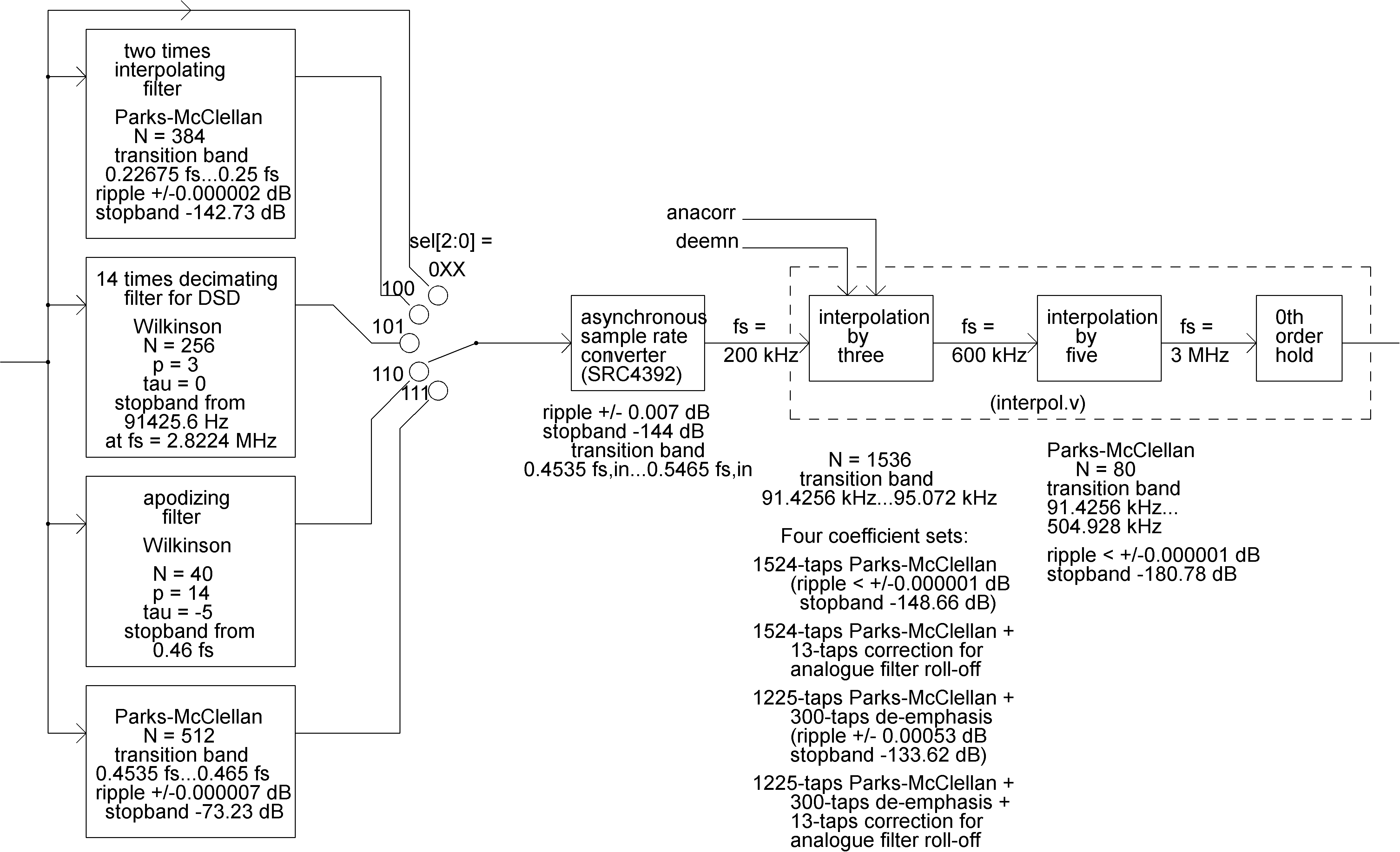

74AHC02 and 74AHC08 DAC with 97 dB(A) dynamic range
The LX75 versions (latest is 2.1) have more and longer FIR filters in the interpolation chain, but they also need more and longer filters because of a stupid choice of the quantizer sample rates in the PWM modes.
The LX45 version (version 3) has a shorter FIR filter and one less interpolation stage, but it also has a better choice of the quantizer sample rates in the PWM modes.
In either case, passband ripple is dominated by the SRC4392's interpolation chain (its decimation chain is not used). I have workarounds in place for its intersample issues and transition band that extends above Nyquist, but not for the ripples.
See the attachments for details.

The FIR filters inside the FPGA have no rounding of intermediate results, like hardware FIR filters often have. The filter calculations are done in full precision and when wordlength reduction is needed, it is done by dithered rounding stages between the filters. No idea what exactly is done inside the SRC4392, though. (This is additional information, not a reply to post #103.)
