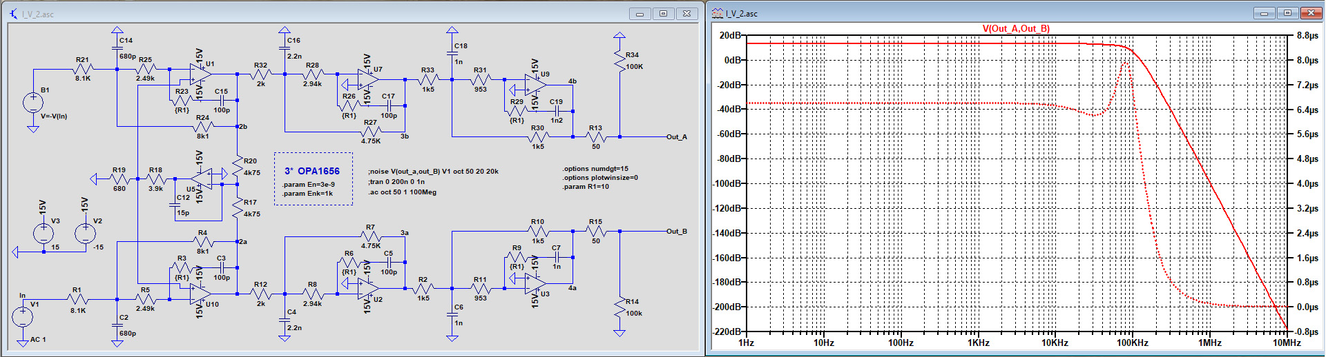

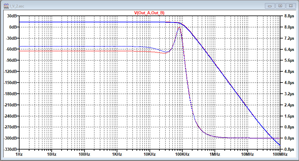

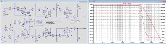

Here is the output filter that I have planned to use.
Four OPA2134 being replaced by three OPA1656 because of using DC coupling, making the last opamp acting as a buffer obsolete.
The servo remained the OPA134.
All 220nF 5%, 100nF 5%, 2,2uF audio grade and 3n3 2% are removed.
The 10nF 2% being replaced by 1nF 2%.
Hans

I just noticed a silly mistake that I overlooked before: the decoupling capacitors for the op-amps are specified to be 25 V types, but the ones between the positive and the negative supply rail actually have 30 V across them. Considering the non-linearity of X5R capacitors, they have to have at least 50 V nominal working voltage. Apologies for the inconvenience!
