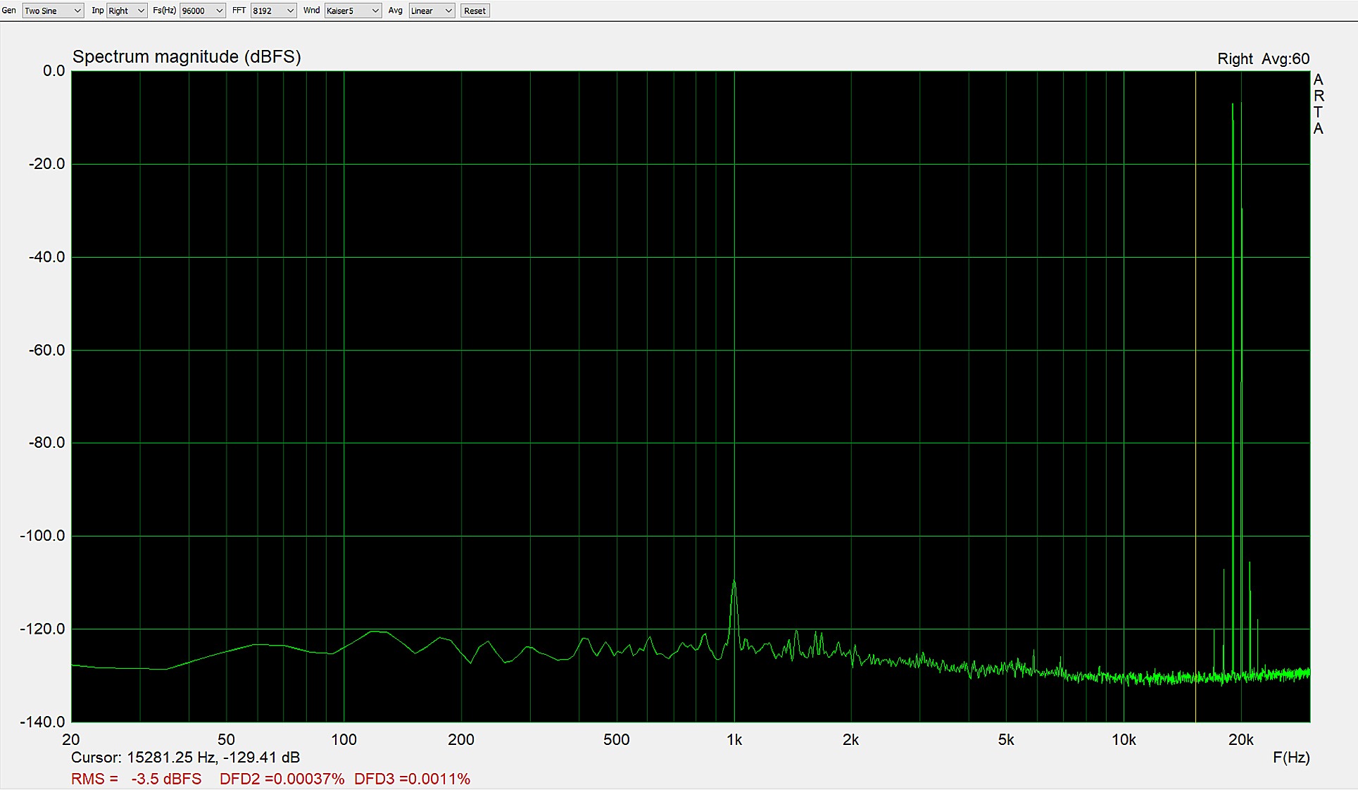

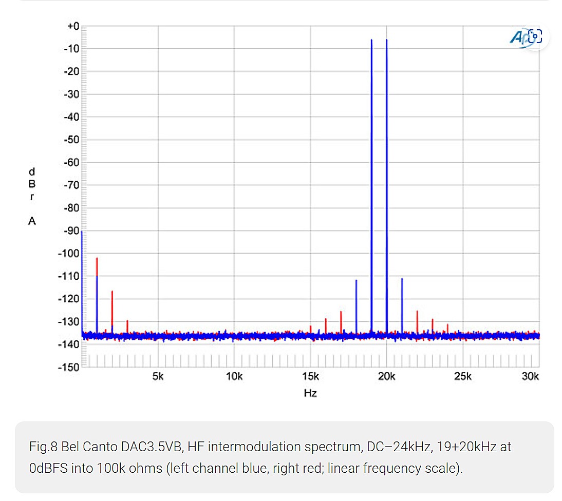

Hi Marcel,
IMD at 0dBFS with the modified filter is shown in the attachment.
There´s little to worry about with second order at 3.7ppm and third order at 11ppm.
And to show things in perspective, I´ve also added the IMD from my Bel Canto 3.5VB, as measured by Stereophile and being at similar levels.
But with the original noisy filter, IMD was not measurable at any level, so the right filter could be less noisy and without IMD.

Hi Jesper,
Yes, all I did was trying to reduce the reconstruction´s filter noise, reduce 50Hz AM with a stabilized supply, change the ceramic cap on the LT3042´s set pin into a electrolytic cap and modify the output buffer into a straightforward buffer without caps.
But, this was all with the PCM Dac described in this thread, which includes indeed a RTZ Firdac with 74AHC02 and 74AHC08 gates, but has not to be confused with Marcel´s Shift Register RTZ Firdac using a 74LV574A, to be used for DSD only.
And all Kudos are for Marcel, I didn´t change anything to the perfect basic concept.

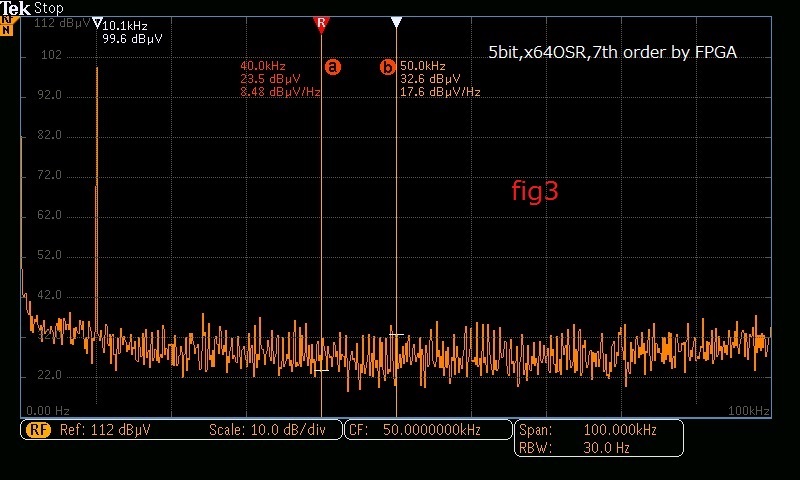

It was a big surprise that Hans measured a far lower noise floor than I did. I knew the filter noise contributed substantially to the total noise, but now that the total noise turns out to be lower than expected, it actually dominates the total noise entirely. I will check what went wrong with my measurements. One hypothesis is limited alias suppression combined with the out-of-band noise of the DAC, but whether that is the true explanation remains to be seen.
It can't be aliasing, actually. I measured about the same audio noise floor in all three sigma-delta modulator modes, while the out-of-band quantization noise is very different. I should have measured far worse audio noise in PWM8 mode than in chaotic mode if my measurements had been affected by aliasing of out-of-band noise inside the FR2-LE field memory recorder that I used for measuring.
When seeing the noise spectrum, it may become more clear why you were experiencing this issue.
How did you store the recording, as a .wav file ?
If so, I could analyze the spectrum when you make this .wav file available.
Hans
