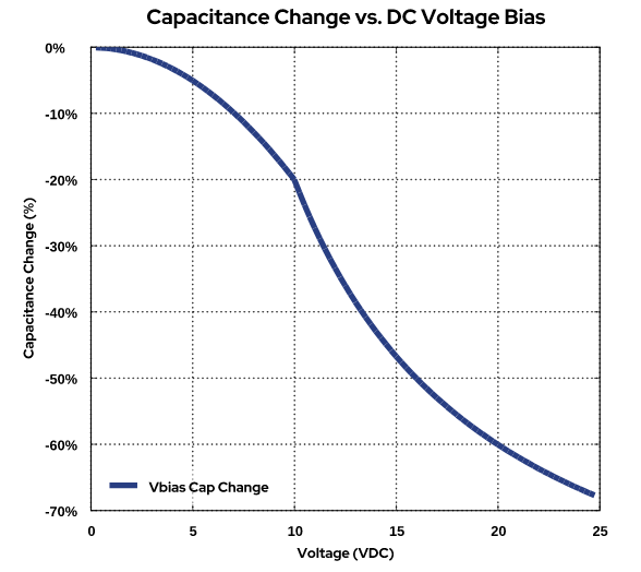

X5R SMD capacitors are often so non-linear that there is only 20 % of the capacitance left at the nominal working voltage. It could be that these are better than that, though, as it are mainly the small physical size SMDs that are so grossly non-linear.
I used 10 uF capacitors. Those are usually X5R. The smaller ones are indeed X7R, which is also quite non-linear but not as bad as X5R.
As far as I know, the first common ceramic capacitor working voltage above 30 V + 5 % is 50 V anyway, so 50 V it has to be.
Forget what I wrote about small physical size capacitors, 1206 X5R capacitors can also be quite non-linear.
To be precise, I used these:

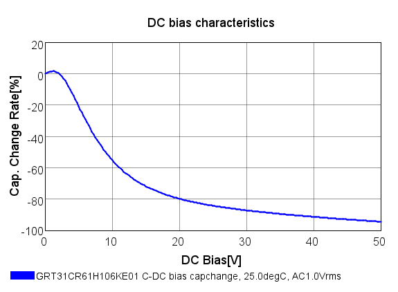

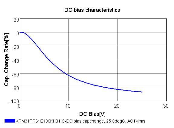

The non-linearity is as shown in the first attached picture; pretty bad, although not as bad as a similar Murata part (second attachment). The dielectric withstanding voltage is 2.5 times the rated working voltage, which probably explains why they haven't blown up yet.
The third graph is for a Murata capacitor meant for 50 V, as I should have used. It has actually only 12.8 % of its nominal value at 30 V.

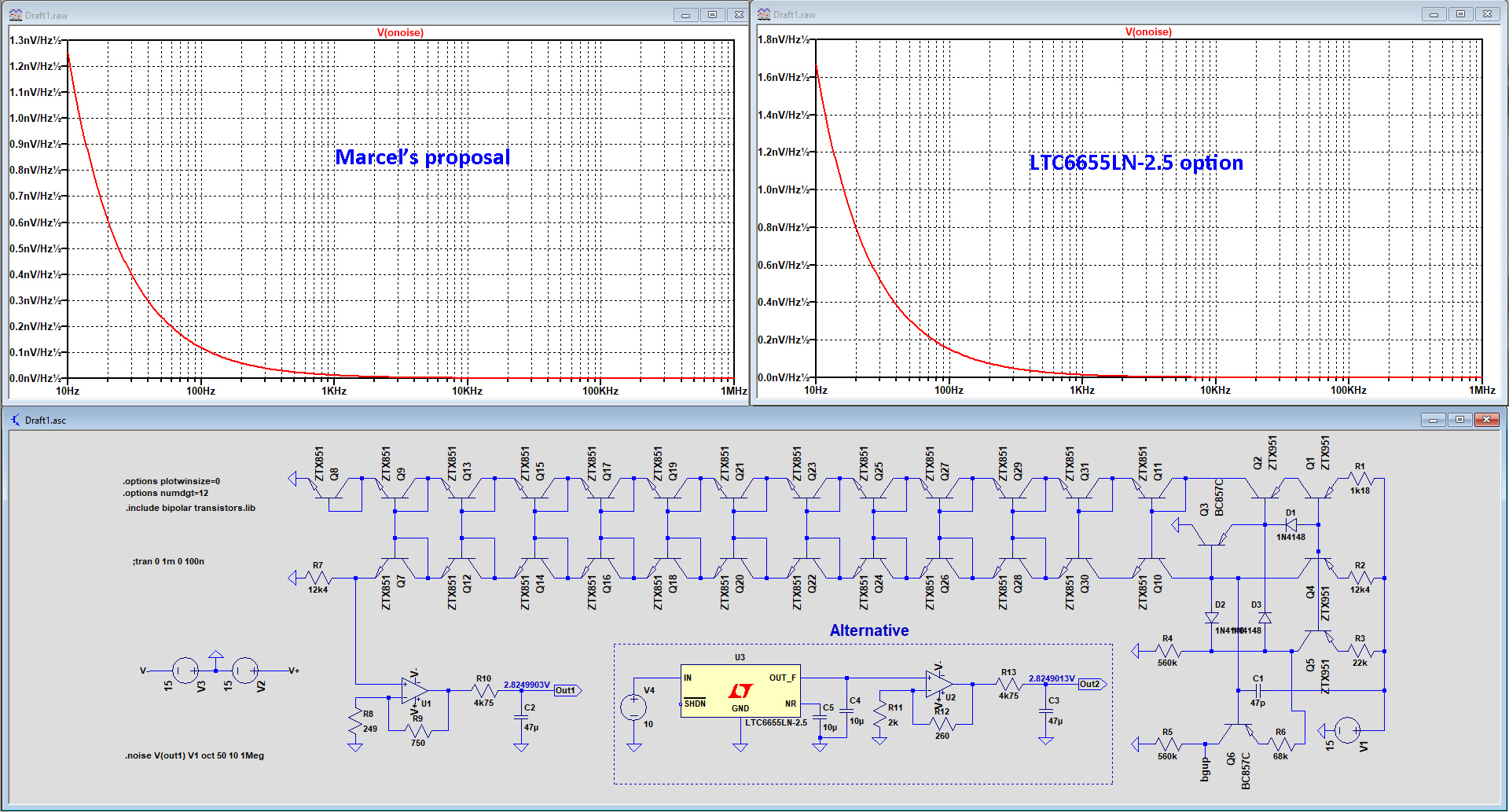

I know you don't like to cut corners, but your voltage reference is rather voluminous.
The used dual transistors have no specified noise figure, that's why I simmed with the lowest available noise transistors, resp the ZTX851 and ZTX951.
I used the exact En, Enk, In and Ink figures for the used op-amp to match those from the OPA2210.
So what I have is as low as it gets, probably below the noise with the NXP duals.
To compare I used the LTC6655LN-2.5, and what you can see in both graphs that they are absolutely comparable, with just one op-amp and to 10uF caps.
An idea for you to use ?
Hans

I would really like to try the Electronics Letters reference, just for the hell of it, but I'll see if I can come up with a variant that uses the LTsomething instead.

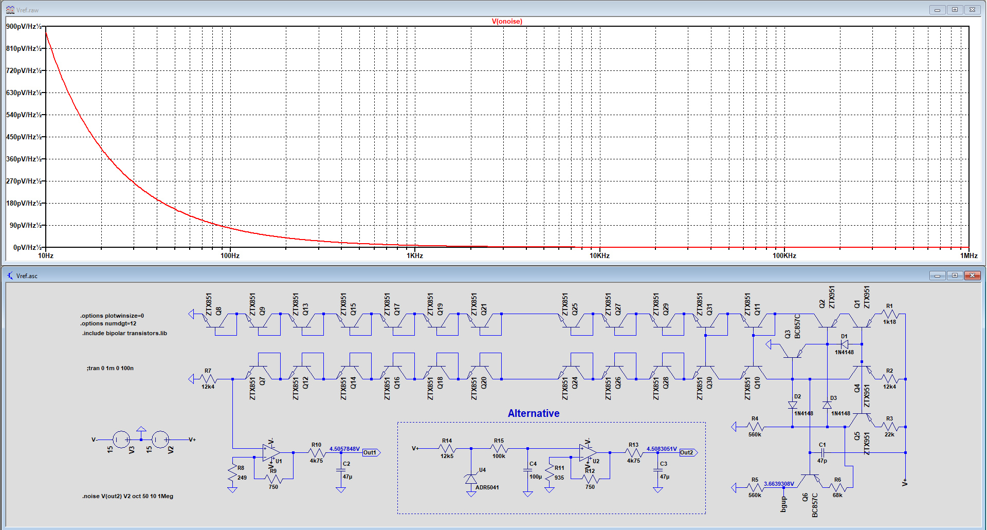

There are ten shorts between the left and right transistor stacks in your schematic. Without those, the amplified reference voltage should be about 5 V. Any differences in noise should show up at deep subsonic frequencies where the filter capacitors haven't kicked in. The DAC will convert those to sidebands right next to the signal.
I corrected the shorts and removed one set of transistors in the chain to hopefully match your circuit this time and have now:
3.66 Volt for bgup and 4.51 Volt at the output of the OPA2210, see image below.
But forget the previous version with the LTC6655, because the one shown here is even simpler and uses the available 15Volt as input.
This ADR5041 may not be readily available but there are many replacements.
Hans

With the 100k and 100uF, output noise is under 1nV/rtHz from 10Hz and upwards, or are there other factors to consider.
