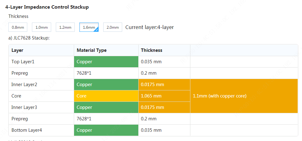

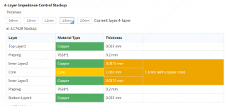

Using the same type of quite approximate calculation I used for the 360 um prepreg case, I find these values:
R124 = 33 ohm for 200 um prepreg thickness
R95 = 4.7 ohm for 200 um prepreg thickness
R96 = 4.7 ohm for 200 um prepreg thickness
Everything else stays as is.

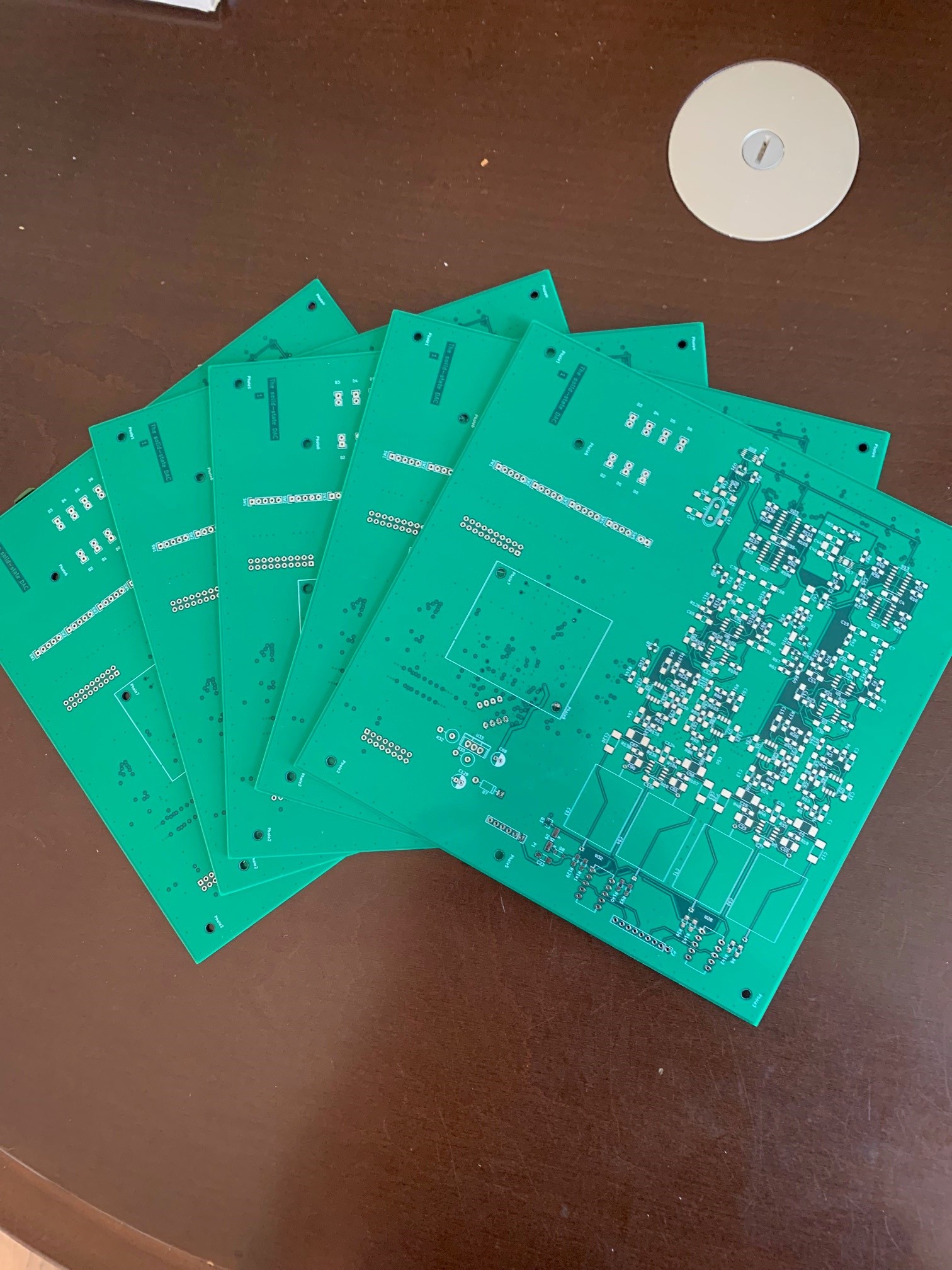

Complete build of the PCB.
Hans

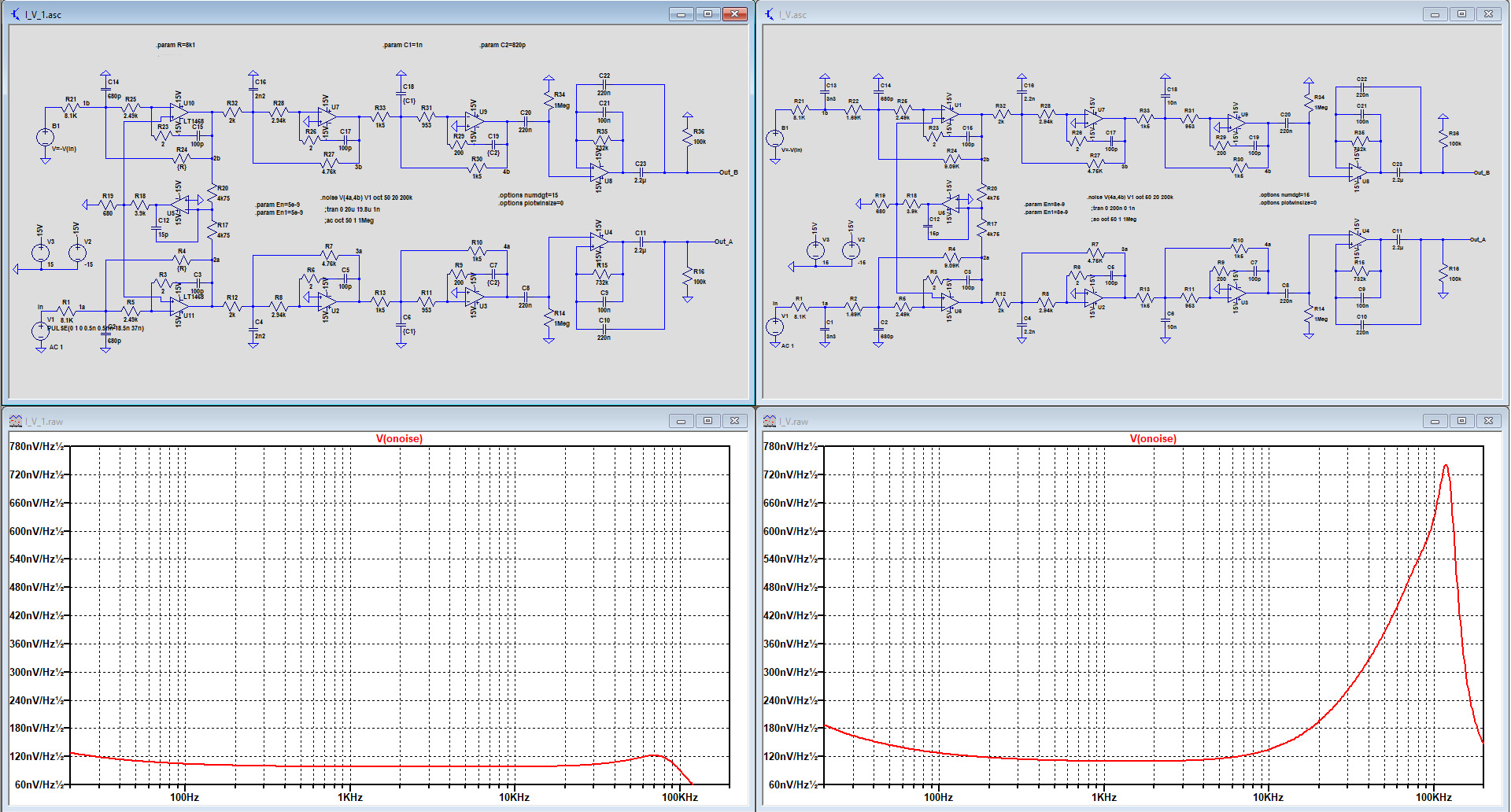

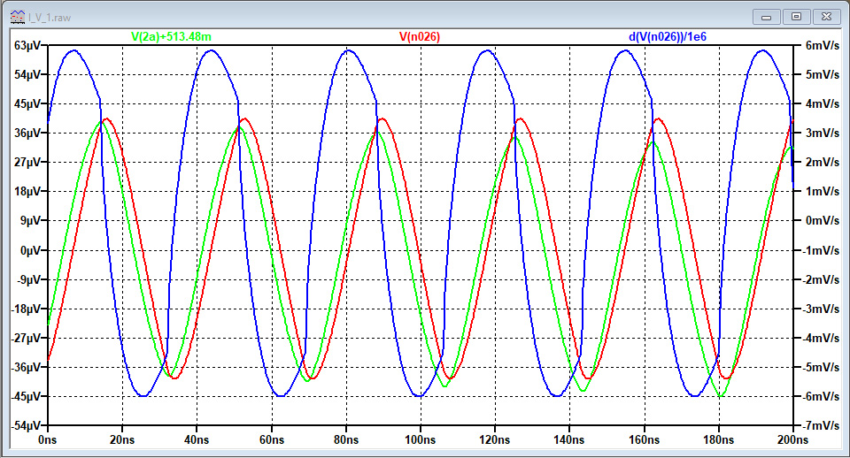

Waiting for the parts to come, I played a bit with the 7th order analogue filter and would appreciate to get your opinion on what I tried below.
I examined the effect of removing the first filter, and changed the first op-amp for a LT1486 with almost 100Meg GBW, thereby turning the whole filter into a 6th order one, and because of that a few other components had to be changed as well to keep the FR and gain the same as before.
Knowing that you used the first filter with 3.3nF to prevent the first op-amp from overloading the input, the LT1486 still in the MFB setup that you used faces no problem at all, as shown in the first image below, where a 1V@27Mhz signal with rise and fall time of 0.5nsec were offered.
In Red you see the input signal at the minus input of the LT1486, in Blue the slew rate of this input signal, not exceeding 6mV/usec and finally in Green the op-amp's output signal.
With this 6th order filter I compared resp. the FR + GD and the noise production, see second and third image below, with in each picture at the left the 6th order and at the right the original 7th order filter are shown, all on the same scale.
Hans

Hi Hans, the digital part has a droop compensation built in, so for the flattest possible response, the analogue filter has to roll off a bit or the digital part has to be changed (FPGA code resynthesized with one different coefficient file). The digital droop correction filter has a magnitude response
1 + 13/256 - (19/512) cos(2 pi f T) - (7/512) cos(4 pi f T) with T = 5 us.
This is only a small correction: 1.009680428 or +0.083678759 dB at 15 kHz, 1.016534293 or +0.142440687 dB at 20 kHz, peak of about +0.644660534 dB at 73.5 kHz.
Apart from that, I don't see any problems with your alternative filter. You will get a bit less noise in band and a bit more ultrasonic quantization noise than I had.
Indeed. Any filter of any order that approximates a Gaussian response over its passband comes close: Gaussian-to-6 dB, 0.05 degree linear phase, Bessel and so on. There are other options as well, for example a cascade of a Bessel and a steeper filter.

I paid less then $10,- per PCB, so if you want one let me know.
Hans
