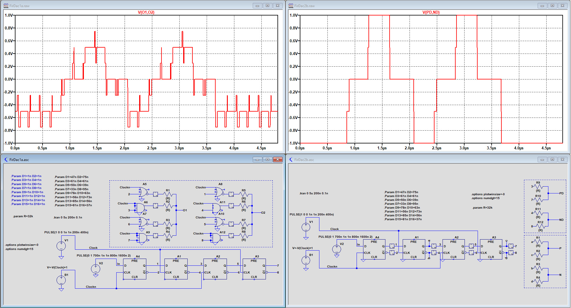

Yes of course does delay have it's impact on the Resistor Only version.
But you have take into account also that those differences are compensated by the spikes in between, the same what happens with the gated versions, but for them to a lesser degree.
See the waveforms for 01010 and 01100 with the aggressive delay.
That's not something you can easily draw with pen and paper.
Hans

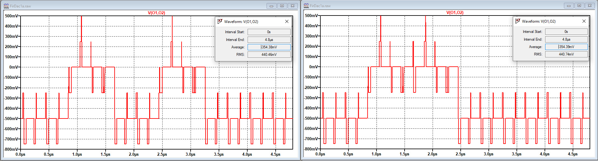

Compare those relatively "acceptable" waveforms for the Resistor Only version in the above posting to those produced by the 2*4 gated version with the aggressive delay scheme.
Their average values between 01010 and 01100 are still close, but with much more glitches in the signal.
Hans

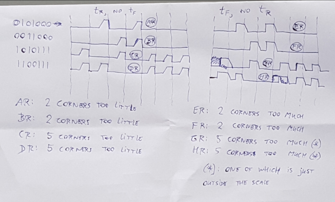

Attached are sketches of the eight basic waveforms for the non-return-to-zero case (resistor only case, as you call it). These are single-ended waveforms at a flip-flop output for the two bit patterns and their inverses. For clatity, I've chosen zero propagation delay and either a nonzero rise or a nonzero fall time.
The differential output voltage of the differential two-tap FIRDAC is a linear combination of waveforms like this:
For a 0101000 pattern: half an A or E plus half a delayed A or E minus half a C or G minus half a delayed C or G
For a 0011000 pattern: half a B or F plus half a delayed B or F minus half a D or H minus half a delayed D or H
Hence, the error is also a linear combination of the errors on these waveforms. For example, when the positive and the negative outputs have a rise and no fall time:
010100: 2/2 corners too little + 2/2 corners too little - 2/2 corners toi little -2/2 corners too little = 0 error
0011000: 1/2 corner too little + 1/2 corner too little - 1/2 corner too little - 1/2 corner too little = 0 error
Clearly, when the corners are different in size, they will in general not cancel perfectly and to what extent they do cancel may become pattern-dependent.
An extreme (though somewhat unrealistic) example is when the positive sides have a rise time and the negative a fall time:
0101000: 2/2 corners too little + 2/2 corners too little - 2/2 corners too much - 2/2 corners too much = 4 corners too little
0011000: 1/2 corner too little + 1/2 corner too little - 1/2 corner too much - 1/2 corner too much = 2 corners too little
In reality there will be some, but no perfect matching between the positive and negative sides, so you should get some pattern-dependent error.

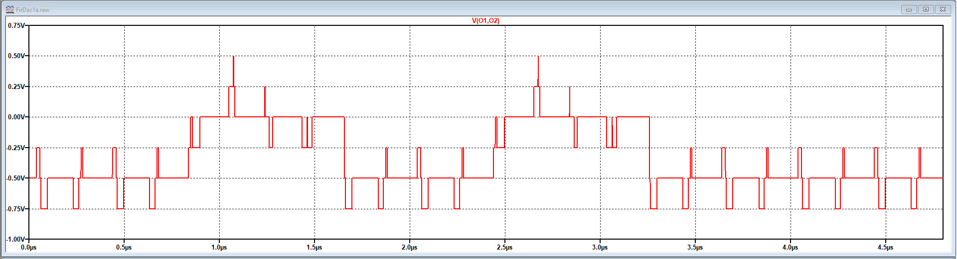

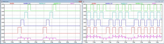

Marcel,
In your drawings it seems that you assume that only the summing points of the four gates have to do with rise and fall time.
Fact is that each individual gate has it's own rise and fall time.
See first image below at the left how the four individual outputs are creating the positive output in lilac, and at the right the same for the inversed output in lilac composed from the four individual signals.
The second image then shows the differential signal from the two lilac signals, the one also shown in posting #83.
Hans

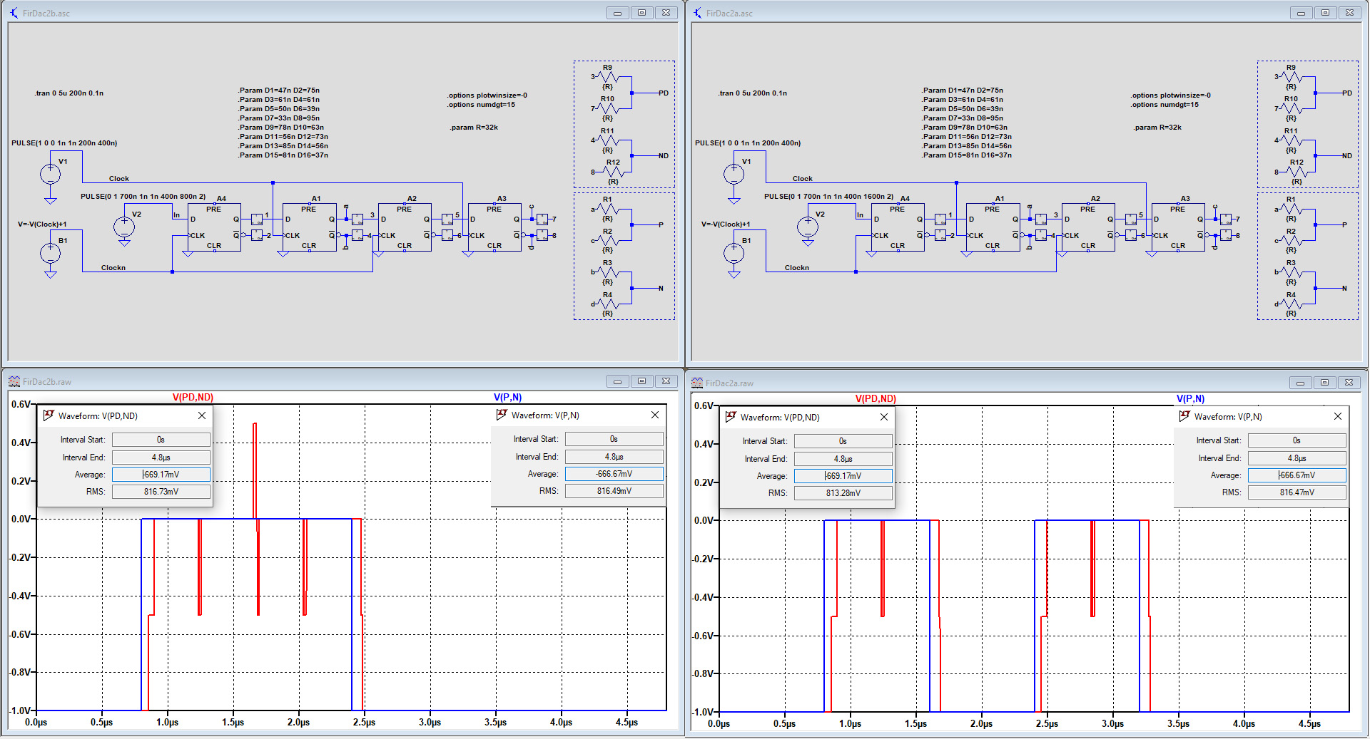

To debug the simulation or my line of reasoning or both, for the case with only flip-flops and resistors and with delays, for each of the two bit patterns, could you list the average flip-flop output voltages (between Q and ground and between Qnot and ground) and the average differential FIRDAC output voltage?
The average output voltage of any of the gated versions should just depend on the percentage of ones and not on the exact pattern (011000 versus 010100), but that should not be the case for the version consisting of only flip-flops and resistors. There are exceptions, for example when the delays of the positive side are all equal to those of the negative side, but the probability of ending up in such a case by chance is 0.
No, I don't believe the results you get for the flip-flops and resistors variant.
You are hard to convince, that's why I show all relevant details in one image.
You see for 01100 and 01010 both the delayed and the non-delayed version in one plot, resp. as V(PD,ND) and V(P,N).
The non delayed versions have both 666.67mV as average value and the aggressive delayed versions have both 669.17mV average value.
Further I have included the LTSpice .asc files plus delay subfiles in one Zip file for you to check.
Either I'm doing something wrong, LTSpice has become mad or you are wrong in your assumptions.
Hans
  • FirDac2a.zip
    FirDac2a.zip

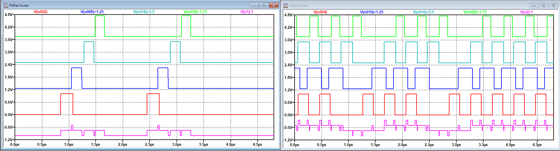

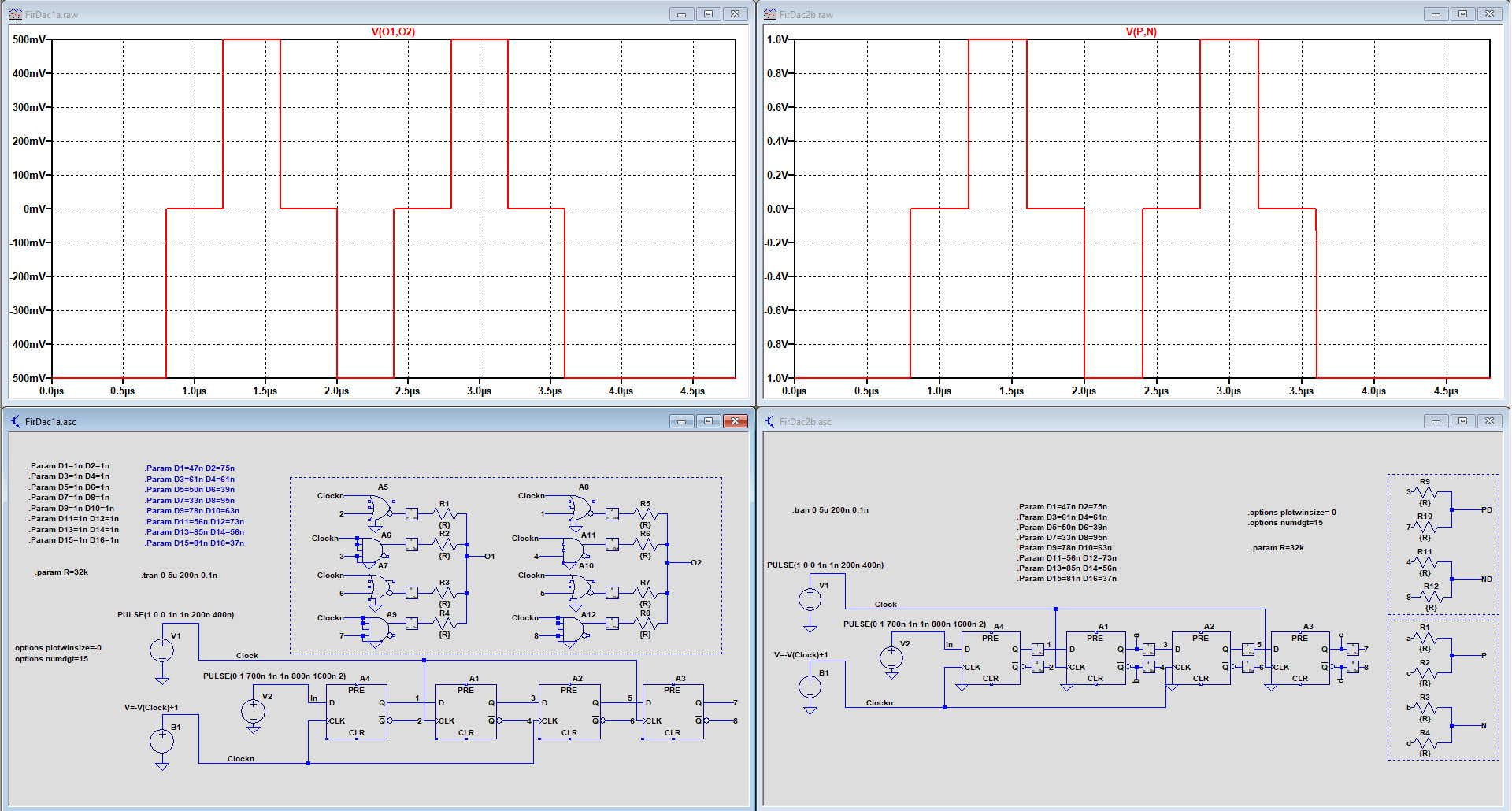

Hi Hans,
You were comparing two bit patterns that each had at least one zero between the ones, namely 010001000000 versus 010100000000. When you change V2 in either one of your schematics into PULSE(0 1 700n 1n 1n 800n), you get two consecutive ones and you'll see what I mean.
Best regards,
Marcel

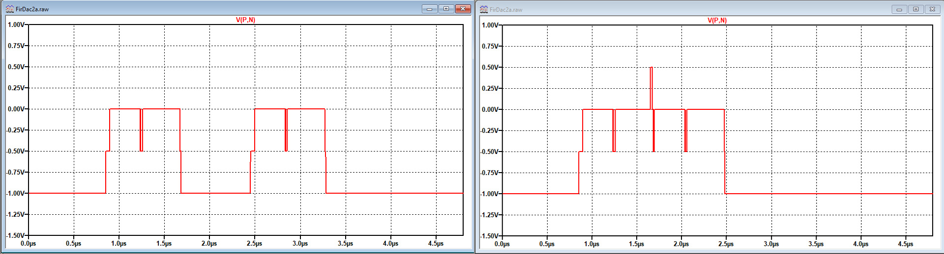

Hi Marcel,
I'm sorry, but I don't get what you mean.
Pulse(0 1 700n 1n 1n 800n) is not a complete instruction, it still misses the period and the number of cycles.
When I take 1600n as the cycle time and 2 cycles, I get the images below from the 4 gated version and from the resistor only version.
The left image without delay for an uncluttered image, but both exactly the same and the second image with included delay.
But isn't the critical Fir Dac issue for what comes out and not the incoming single bit stream that's synchronised by the clock and not sensitive to any rise and/or fall times.
Hans
The default period time is infinite, so PULSE(0 1 700n 1n 1n 800n) just gives you one pulse of 800 ns wide, that is, two consecutive ones when the clock period is 400 ns.
Besides, please have a look at the individual flip-flop and gate outputs, not only the FIRDAC outputs that are linear combinations of flip-flop or gate outputs anyway. It is much easier to see what's going on when you (also) look at individual gates and flip-flops.
What matters is that the average output voltage depends on the percentage of ones and not on the precise pattern. Any circuit I know of will have no problem with 010001000000 versus 010100000000, but 011000000000 is a whole different cup of tea because the flip-flop-resistor version will have two transitions less than on the 010001000000 and 010100000000 patterns.
Hi Marcel,
At last, there we are.
It took a while, but you are right with the patterns now suggested.
So it is not the skewing of the 01010 and 01100 rise and fall times from the SDM, but the effect different patterns have on the gated Fir Dac output were the gates are having different rise and fall times.
That's what confused me.
But I'm with you that the gated RTZ version is superior to the resistor only version, case closed.
