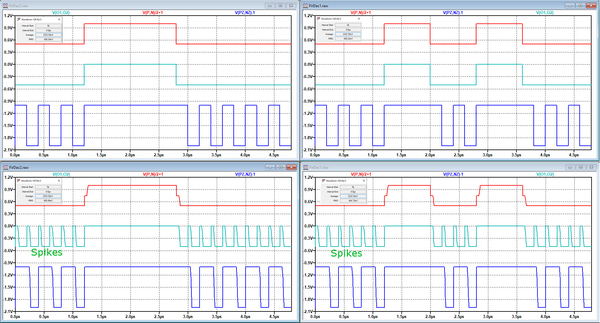

Here's the outcome of my simulation
I have used a reduced 2.5Mhz clock to get a better view on what's happening.
Of the four graphs below in the first image, the left side produces 0011000 and the right side 0010100.

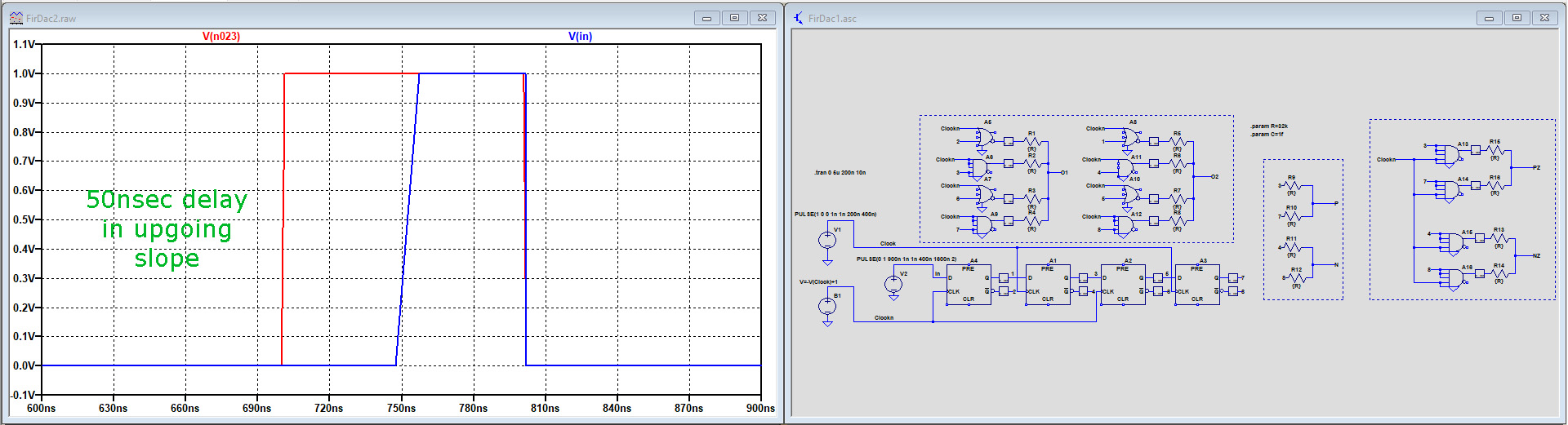

In the upper half, the up- and down-going flanks are untouched with a 50% duty cycle 2.5Mhz signal, but in the lower half all upgoing flanks are delayed by 50nsec, see second image.
This already leads to rather terrible looking signals, and as mentioned before, when up- and down-going flanks are not happening at the same time, one will get spikes with the topology you used, see the teal lines.
These spikes do not happen when taking out the NOR circuits and to get a true RTZ version in Blue with half cycles.
However both versions suffer to the same amount in their average value between 1010 and 1100.
But the big surprise is that in all cases the most simple version, with resistors only connected to the FFs, keep it's average value constant at 333.33mV in all situations as shown in the 4 inserts.
This can IMO only be explained because of the 2 segment FirDac that nihilates the timing differences.
See the boxed part in the middle of image two, ending in the signals P and N.
Also note that this signal was divided by two to make it comparable in level to the other two signals, but in fact it is 6dB larger.
Looking forward to see your comments.
Hans

What are the average voltages? I only see the values for the flip-flops.
Regarding the flip-flops, in a balanced structure, when the rise and fall time difference for the positive and negative outputs is the same, which it never exactly is, they compensate each other. I would expect that when you look at only P or only N, you get the biggest error of the whole circuit.

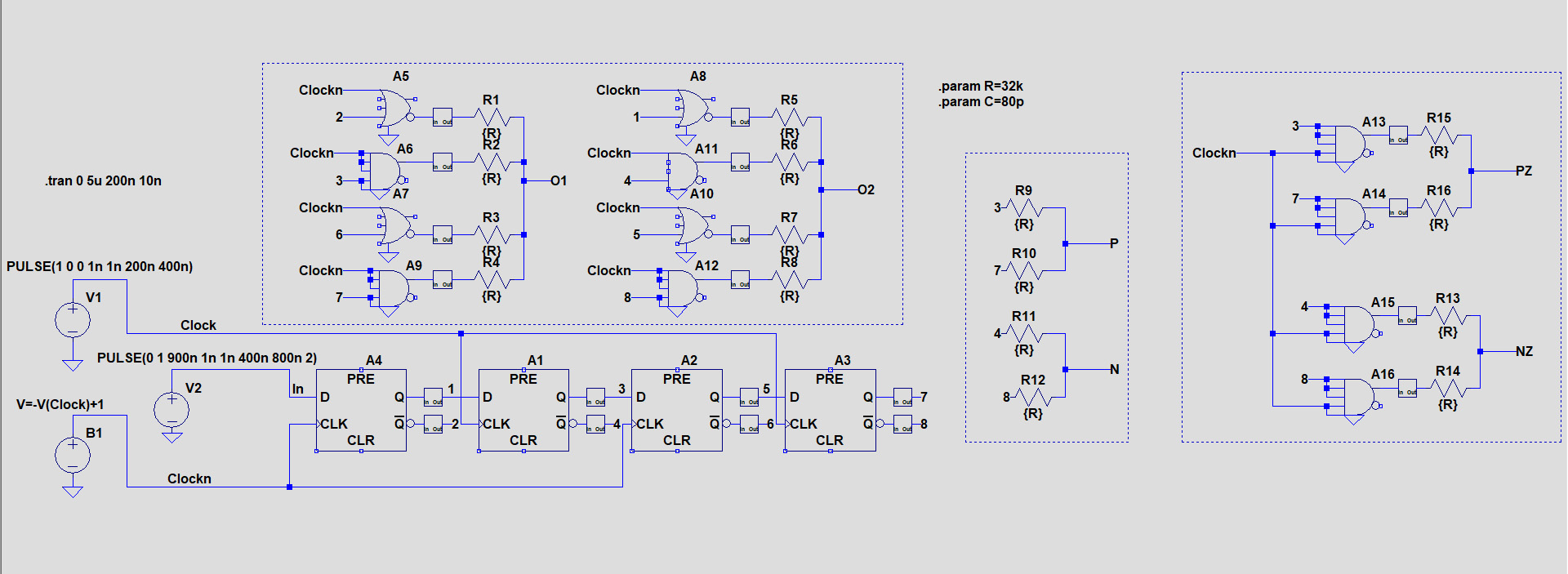

What you see are the differential voltages between resp. O1&O2, P&N and PZ&NZ, please see the encircled boxes in the above circuit diagram for what they are doing.
Also look at the text in the header of the LTSpice images, here you can see exactly what is shown, including the offset that was given not to let the images fall on top of each other.
And no voltages from FlipFlops are visible in the images as you may have thought.
The logic modules from LTSpice are switching between 0Volt and 1Volt with a tripping point at 0.5Volt.
The rise and fall times for the FlipFlops on both outputs are not the same, only the rise time is affected for both outputs with the little square subcircuit that was added to all digital outputs as you can find in the circuit diagram.
I haven’t looked in detail at the individual P or N signal, but I will to cover that part tonight.
Hans
In the upper left corner of each of the four simulation plots on the left, I see that V(P,N)/2 is on average 333.33 mV. The schematic shows that V(P) is the average of the voltages at nodes 3 and 7, which are delayed flip-flop outputs, and V(N) is the average of the voltages at nodes 4 and 8, also delayed flip-flop outputs.
In a balanced structure, when the rising delay is the same for the positive and the negative output, the rise time is the same for the positive and the negative output, the falling delay is the same for the positive and the negative output and the fall time is the same for the positive and the negative output, the error due to unequal delays drops out of the equation. That's because there is always one side going up and one side going down on each and every transition.
Regarding the spikes, the narrow spikes in the green signal should be easier to filter off with a passive RC section than the much wider troughs in the blue signal, so why do you regard them as a problem?
At this frequency spikes with a BW in the 100Mhz range aren’t that easy to filter.
That’s what concerned me.
The wide RTZ throughs in the blue signal are simply the 27Mhz clock that’s part of the signal in all 3 investigated versions when the SDM is running with music.
So this 27Mhz has to be filtered anyhow, but may be less bening as the Spikes in the HF range.
But at the moment I think that both the blue and the teal signal are inferior to the red signal.
Hans

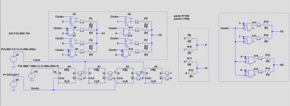

As you already see unintended behaviour with your present simulation testbench, I propose to first find out where it's coming from before adding further imperfections. As an attempt to narrow in on the issue, you could kick out the last two flip-flops, the gates driven by them and the whole negative side to see what that does. Please print the averages that are pattern-dependent, maybe that gives a hunch why they are pattern-dependent.
Adding more imperfections is for later, after debugging the issue you found.
My circuit only works well when the delay of the flip-flops is of the order of the gate delay or more. That is, a low-to-high transition at a NOR gate input is supposed to make the NOR gate insensitive to what happens at the other input before the flip-flop output starts switching. In fact that's why JohnW prefers circuits with more clock phases, to get a more well-defined delay.
Does adding a delay in both directions (unequal, of course) to the flip-flop outputs change anything in your simulation?
