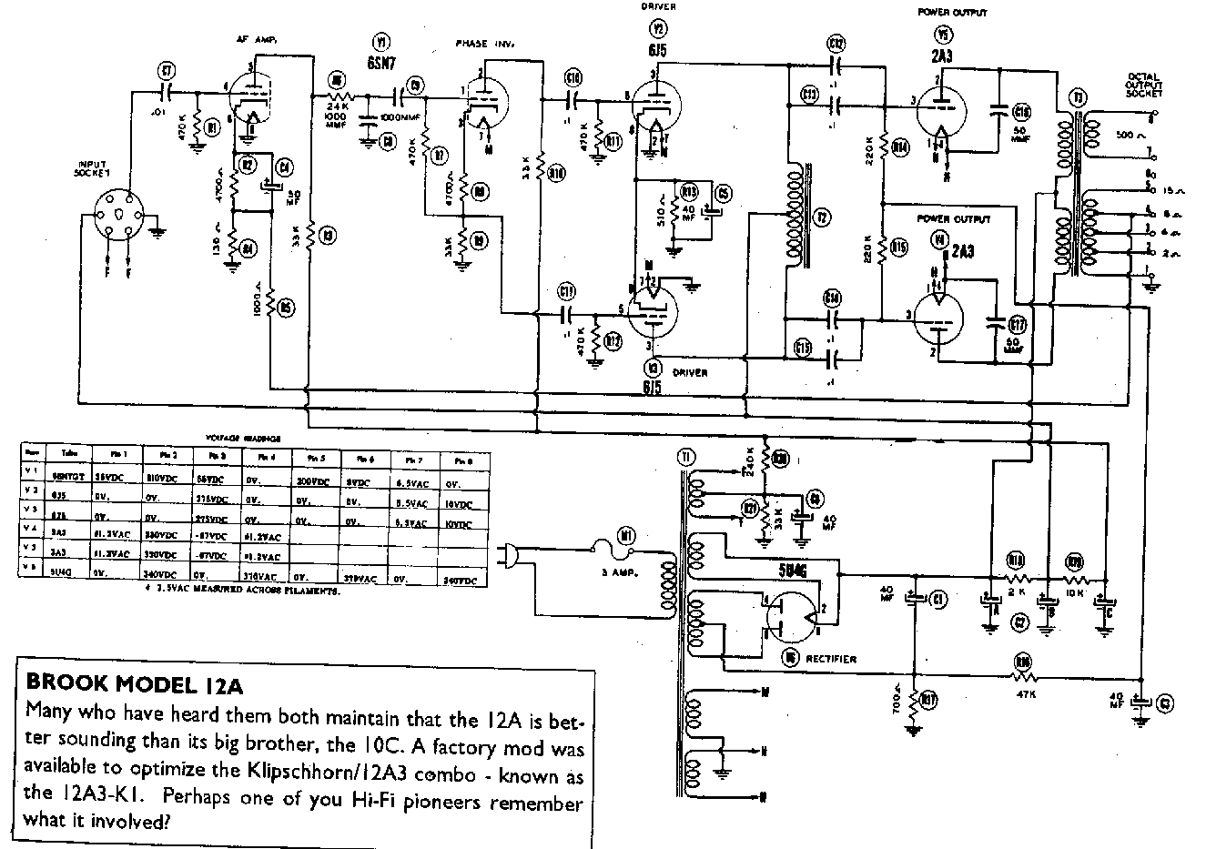

I was reading through an old Klipschorn brochure and it recommended the Brook 12A, which is a push pull 2A3 amp. Some of these sweep tubes in triode mode would be a cool project to make a "cheap" Brook 12A.

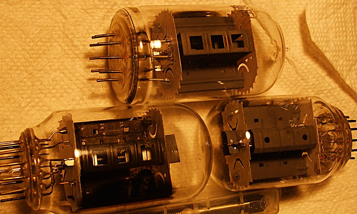

Concerning Screen Diss of the 6GE5...
All the 12GE5 that I have, you cant actually See the screen-grid in the tube. No holes in anode and the slots in the mica at the top dont go deep enough towards cathode to see either-- I guess with that one, its a case of checking the screen-current/volts to see how hot--or not--its getting....
Looks from the pics Ive seen that the 6HJ7 has nice big holes in anode to see whats going on...

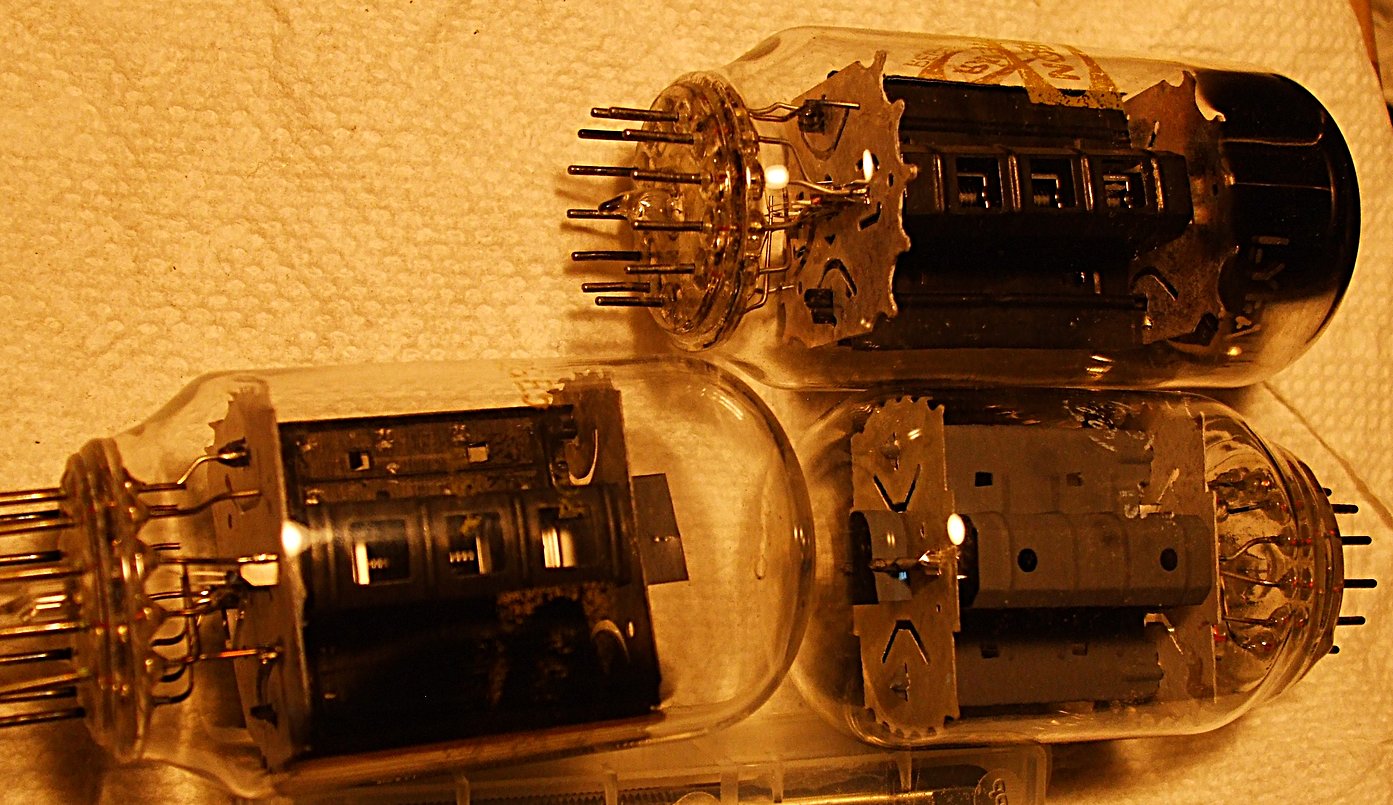

True. Most of the 12GE5 I have here, you cannot see the insides. I do have a few Raytheon 12GE5s though, that have the big square holes in the plate edge, just like the 6HJ5. They also have cooler fins up top on the g1 and g2. And a black plate like the 6HJ5.
I hadn't thought of this before, but maybe the big plate holes on the edge also serve as g2 cooling windows. What you see immediately through them is the g2 support rods. The 6HJ5 has a robust 6 Watt spec for g2. I suspect the 6HJ5 was designed for reliable RADAR display scopes, then got written up as a TV sweep tube for additional sales.
I have a few GE 12GT5 tubes here which do have the big square holes in the edge of the plate. 12GT5 was designed by RCA, so maybe that is spec'd in. It is a very similar tube to the 12GE5 otherwise.
Pic below, top right is the Raytheon 6HJ5, bottom left is Raytheon 12GE5, bottom right is GE 12GE5:
2nd pic has 12GT5 at top.
