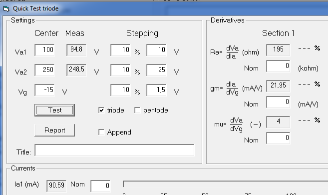

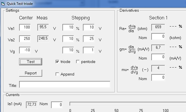

Do you think its something to do with the simulation transconductance...?
The prog recons 10mA/V and there's no input box for that, only the other values like Mu, Rp etc...

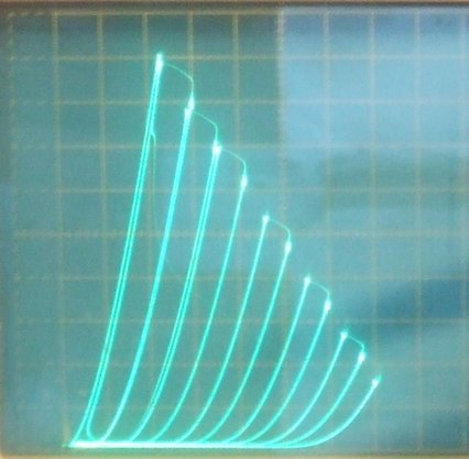

Just to make sure we are looking at the same chart, which one are you looking at?
7v steps for g1, 50V/div horizontal, 50mA/div vertical. LTspice sims show the same results

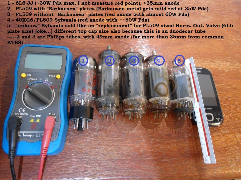

This thread is about the 6GE5...Right before I left Florida I had wired up a test amp using a newly designed driver board that resembles the circuit in the 6L6GC in AB2 design. I also had some tag boards wired up in octal, novar, noval, and Compactron pairs, and I have some 6GE5's........I wonder which boxes all that stuff is in. I have nearly finished building the first workbench, and most of the wood was cut for the second yesterday before the rain came......I'ts been far too long since I melted a tube or two.

Serves for my plasma tweeters and my PP amp: very versatile tube (like most sweep tubes)! The huge plate permits high Pda (~60W on some types) unless it have Barkhausen plates: the Barkhausen fins goes red with only 35W 😡 .

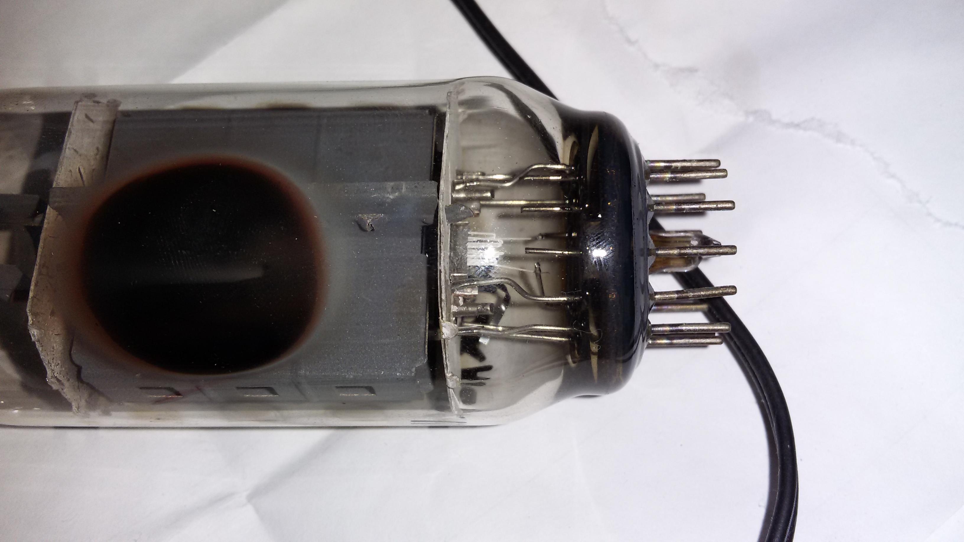

NOTE: The "#5" tube is an duodecar used in some colour TV replacing some PL509-sized 12-pin tube. Magic? Or crazy service technician (error)?
(please excuse some potential errors)
I think tube #5 must be a "crazy service technician (error)". If you post what pins are connected to what, we can probably decode what tube it actually is.
Likely one of: 6JE6, 6JS6, 6HF5, 6LQ6, 6LG6, 6ME6
I take some minutes messing with that tube and...I think tube #5 must be a "crazy service technician (error)". If you post what pins are connected to what, we can probably decode what tube it actually is.
#pinout is equal to 6KD6:
1 and 12 = filament (obvious for compactron 12-pin tubes)
2 - cathode
3 and 11 - G2
4 and 10 - G3
5 and 9 - G1
6, 7 and 8 = i.c. (internally not connected)
plate is at top
Because of this pinout maybe that TV servicemen tried to apply it in place of 36KD6, an PL509-sized tube, in a crazy attempt, maybe... or some color TV used this little sweep tube (an little mystery for a young guy like me)?
#is Sylvania brand (...YLVA... is barely visible with typical Sylvania font), with 3 medium-sized slots
#has some 36K.../40K... markings; the second missing letter has some vertical "at left", like M, L, D, B etc letters, so it can be 6KDx, 6KMx, 6KBx, etc...
#don't have more markings, is all erased

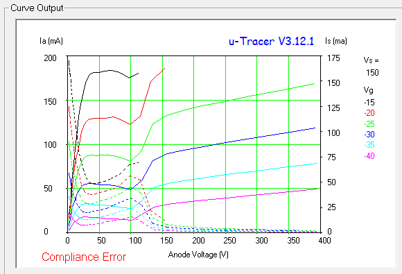

When I have some time I can measure them at µTracer (now I curious to know).

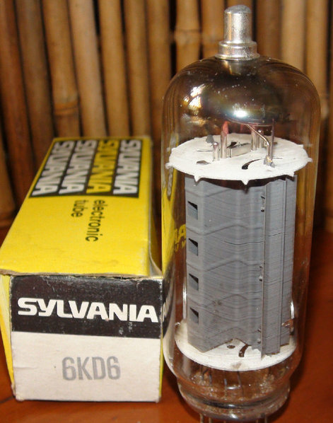

Well the pinout connections match the 12GW base for 36/40KD6, however the top plate cap size is too big for KD6. And the plate size is too small for KD6. See 6KD6 pic below. Pin 7 is likely a heater mid connection.
Some other bases like 12FB, 12FY, 12GJ, 12GU, and 12JA can also meet the pinout by using the undocumented "IC" connections. But none of them have a 36/40... tube version.
Also, bases 12GD, 12GH and 12GM using IC pins. Base 12GM has pin 7 connected to g2
A mystery, unless someone soldered a different plate cap on the tube.

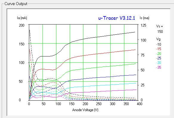

Tomorow I finally will have a spare time to use the µtracer, but it measures only to 200mA, so I can need to extrapolate/estimate the real high current knee.

You might try the heater on 36V to see if it lights up correctly. ( try 6.3 V first!) If it were 6.3V, then maybe: 6JS6, 6HF5, 6LG6, 6LB6, 6KE6, 6GY5 or possibly 16KA6
Measuring the heater current at whatever V(htr) looks like normal heater brightness could give a clue.
Also, could measure the plate knee current with 150V on g2, 0V on g1, and 60V on the plate. Then find it in the table: (although there is probably significant variation from tube to tube in the same type) (or could also measure the g2/g1 Mu by varying g1 by -1V and counter varying g2 by +Mu V to get the same current)
Then there is always just looking at the pics on Ebay to see what looks like the exact same tube.

Yesterday I had time to play with the tube and ...
I bet in Tubelab alternative: despite the presence of 36Kxxx / 40Kxxx faint markings, the filament is orange with 36V (and 500mA), and to reach the nearest nominal current standard is necessary to apply 26V (and thus gets 450mA) . With this current the cathode have normal appearance/bright.
I trace the tube with the μTracer and the result indicated an anomaly, possibly gas, which was confirmed with trying to measure current saturation with 70V at anode and 140V in g2 (fixed PSU's, so I could not use the exactly values suggested by smoking-amp). The measured values are only 160mA at anode and 100mA in g2, with bright internal glow of death (between cathode-anode). At least the μTracer allowed to have an idea of μ and other parameters. Since the tube are gaseous and used, the mystery remains 😀 ...
