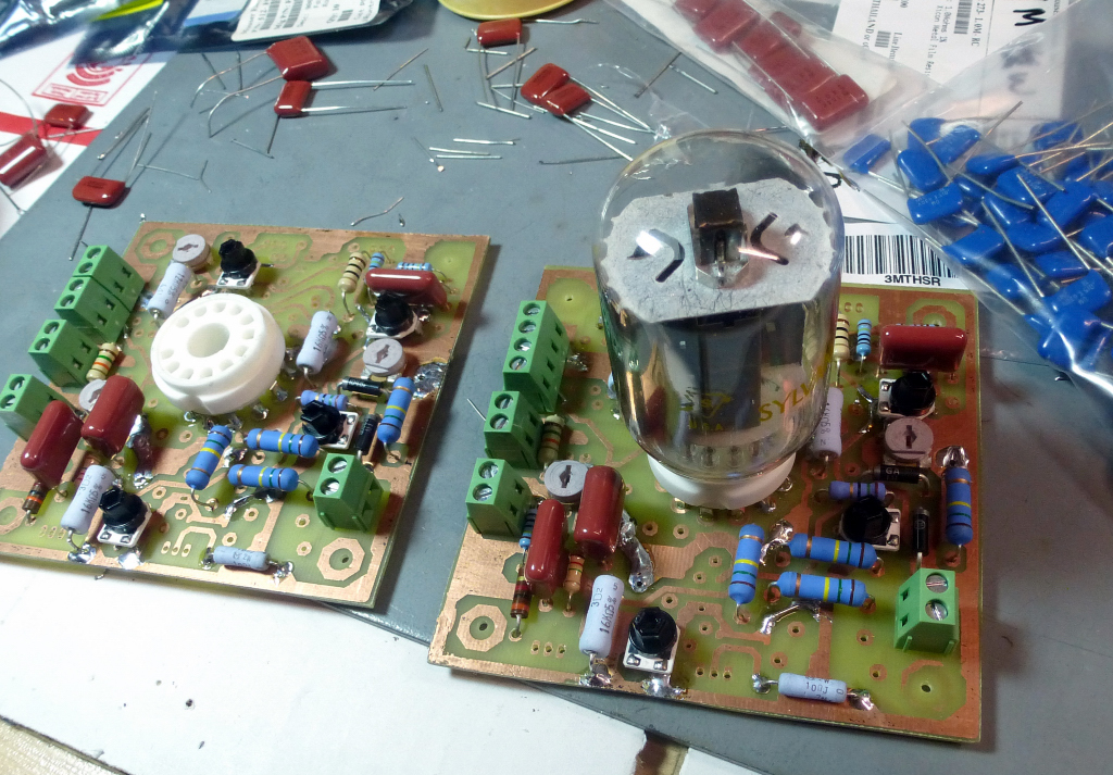

This is a picture of the first PC board I cooked up in the new location. Yes, there is a 6GE5 stuck in one of the boards. I made it just for you guys.........and the 28 other tubes that will work in it.
A single board can be used for SE, or a pair for P-P. 6GE5 triode testing should be a piece of cake. It will be Tuesday before the Mouser box brings me the stuff I need to finish populating it all, but there are a few things I can test soon. Stay tuned.

They are not so nice, but functional PC boards. Each had a few broken traces, but these were the first boards that I have made in a couple of years. I jumped the broken spots with wire and moved on. I often make these for prototypes because they are fairly cheap and quick. Often there are no bad spots, but sometimes there are a few. I have been told that these home cooked PC boards will eventually fall apart, so don't bother....BS.
Boards that I made in the 60's and early 70's on brown phenolic have indeed come apart. Everything I have made since G10 / FR4 (epoxy fiberglass) was invented is still functional despite 40 years or so in Florida humidity. My personal TSE amp (Tubelab amp #001) still has the has the home cooked proto PCB in it. It is over 10 years old and has 85 year old output tubes!
There are two ways to make these. The easiest way is the toner transfer method. That is what I did on these boards. You design and layout a PC board in your computer. I use Eagle, but there is freeware like Design Spark available.
Print it on a "toner transfer sheet" (some people use old magazine pages) using a laser printer, then iron it onto a piece of copper clad blank board, then soak in water. The water soak removes the paper transfer sheet, leaving the toner image on the board. Etch the board in ferric chloride (still available at Radio Shack......if you can find a Radio Shack.
There are dozens of Youtube videos demonstrating this, but I will make one once I set up for video.
Super simple one-off PC boards can be made by drawing the pattern directly onto copper clad board with a Sharpie, then etching.
There is a photographic method that involves using pre sensitized board at about $10 for a 6 X 9 inch piece, and it does result in a higher quality board with better resolution, but I only use it when working with small SMD stuff.
I have been buying the dual layer standard eurocard size (160mm x 100mm) blank pcb boards from radioshack. I also have the ferric chloride I got at the shack. About a year ago or so when I heard radioshack was going out of business I asked the guy at our local one what was up and he said they are going to remain in business so that's good.
I have not tried to directly draw on the boards with a sharpie method. I have tried the toner transfer method for a power supply board. I didn't use old magazine paper although I heard this works great. The stuff I used was from staples and was hard to get off the board after I ironed it on. I heard the magazine paper is easier to get off so I think I will try that next. I too use eagle but only the freeware which limits me to half a eurocard size (80mm x 100mm). I think my problem is I am not that good at doing the layout and trace size etc.... I used the automated routing method and that was okay but the traces were small. I guess like anything if I keep trying I will get better. I personally like P2P better but I would like to still be able to make functional pcb's that have a nice thought out layout.

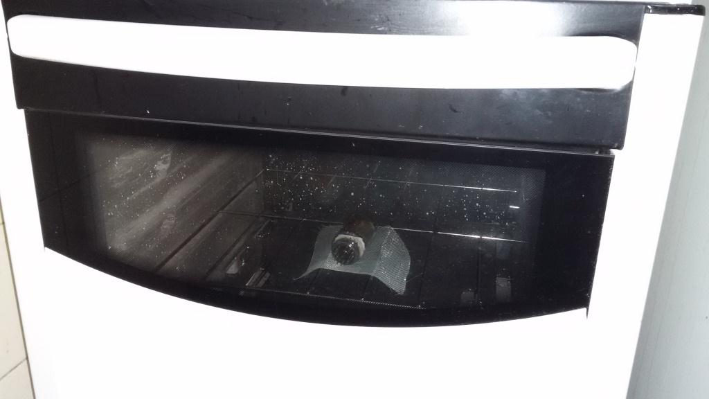

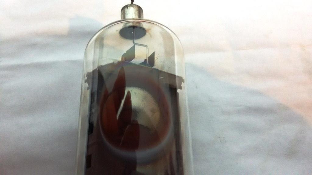

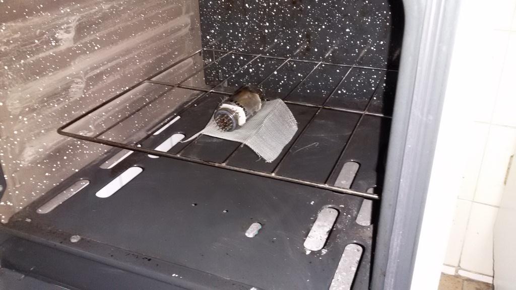

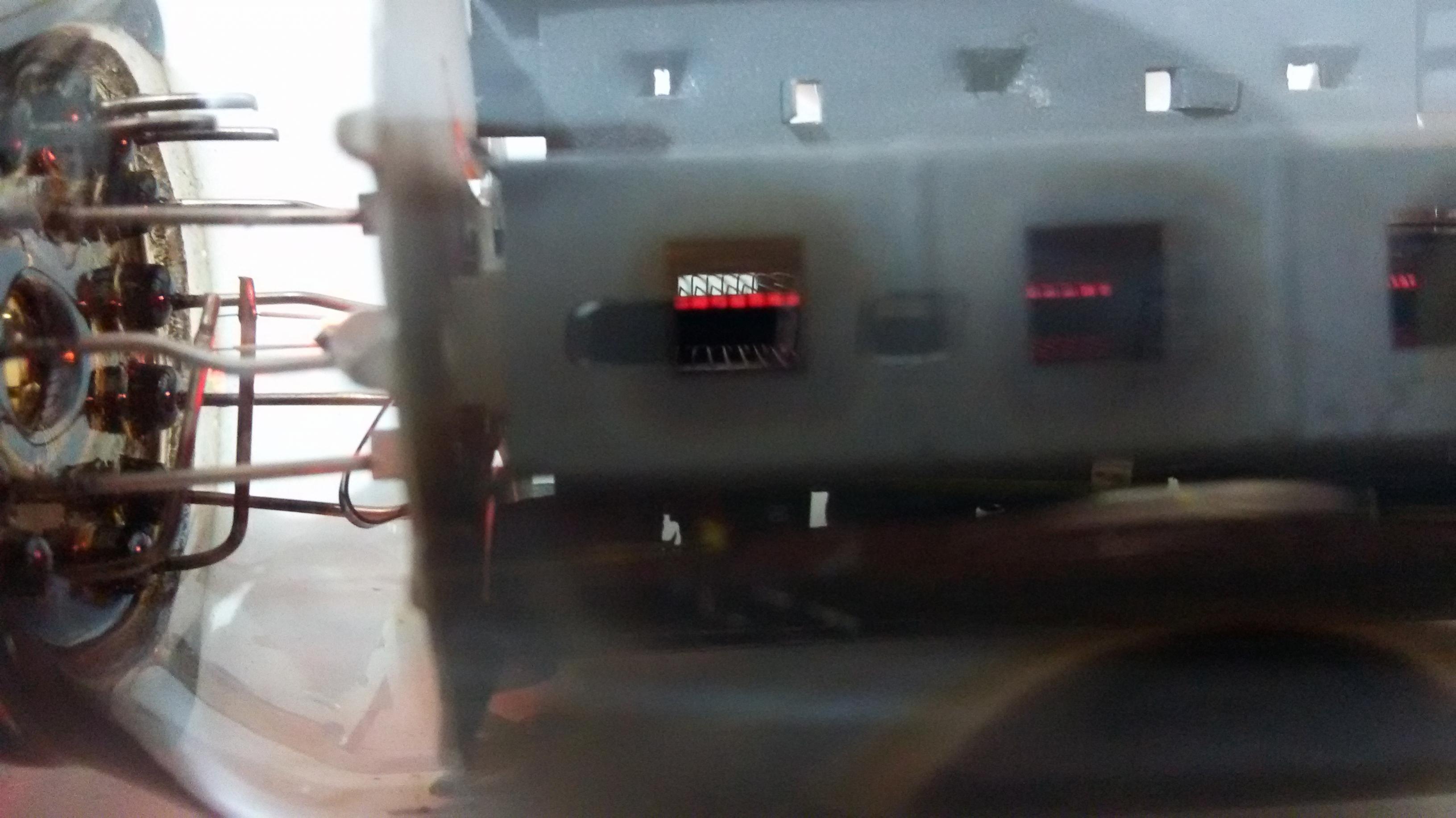

baking tubes?!
Honey, what we will have for dinner today? 😀😀

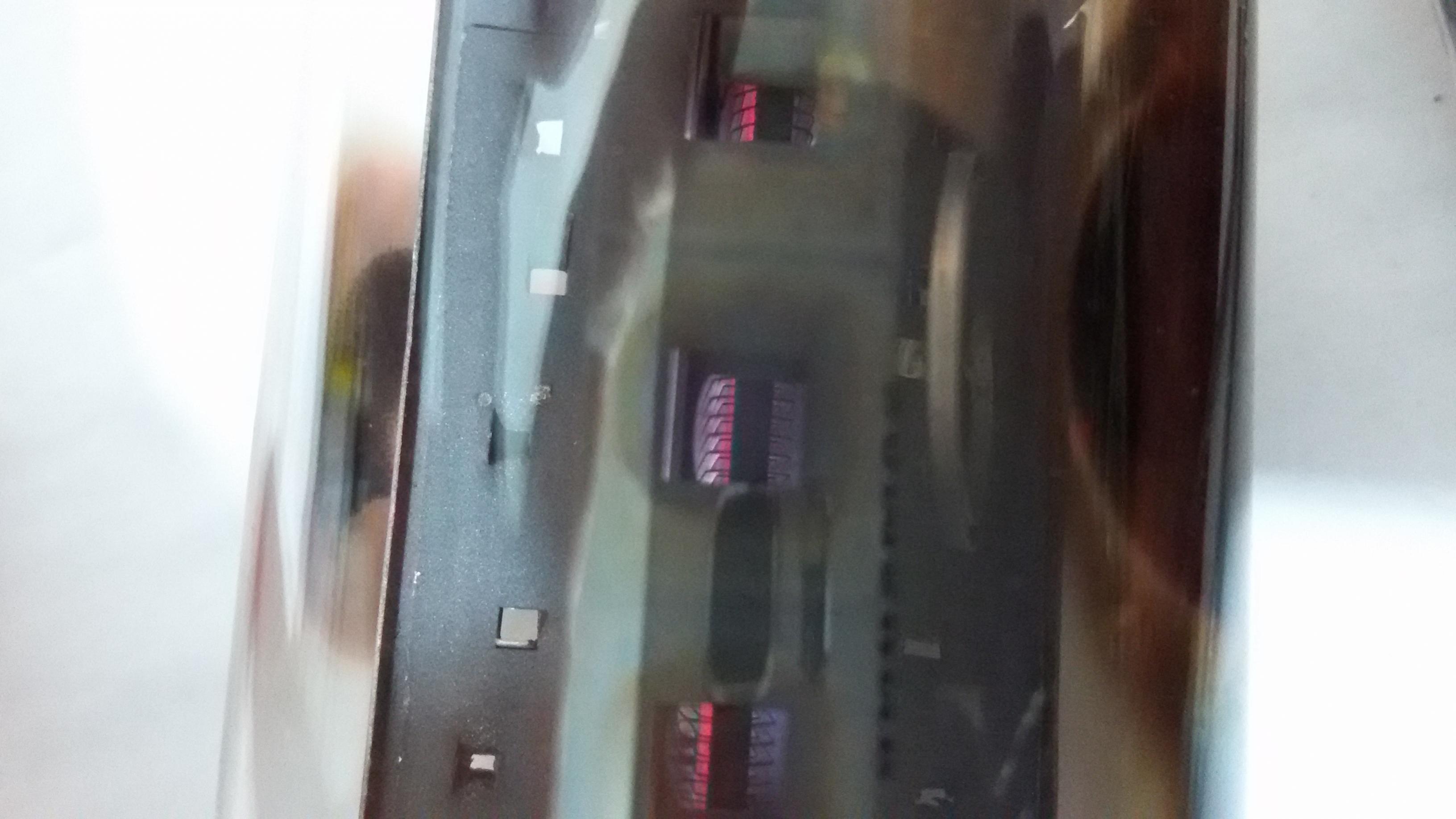

This works partially. Visually the getter was working a little, but gas remains at somewhat lower quantity (ops, I don't have the BEFORE photo, thanks to my haste 😡 ). These tube has very low and falling emission, and only works with pulse operation like µTracer, at DC this tube barely pass 50mA now even if connected as diode with 350V😕! (even the µTracer results become a little poorer...)
The internal photo without gas is without DC applied.
The internal photo with visible bluish-white gas is with DC applied.

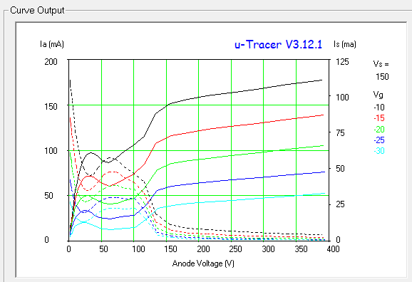

The µTracer results...
Next time... hammer it!
(probably I need to post it at baking topic...)
Alas, before I measured higher current (the almost 300mA total cathode current at DC) maybe due to gas!
I admire your efforts at resurrection, but even Frankenstein wouldn't be able to bring back life to that one.....
Time to give it a decent burial!
