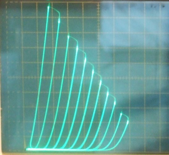

Here are the triode curves for the tube from Hell:
Pic1:
10 mA/ div Vert.
50 V/div Horiz.
1 V grid steps
You can throw out those 300B's now.

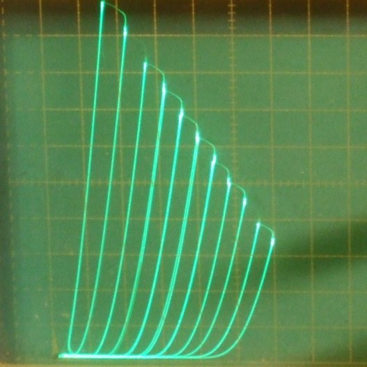

Some comparisons:
Pic2 is a 36MC6 in triode (selected)

Mu looks like around 31
Rp looks like around 1000 Ohms at 40 mA
From Mu = gm x Rp
gm = Mu/Rp = 31000 uMhos at 40 mA
On my datasheet here, I see Mu = 28.5 at 20 mA, and Mu = 31 at 40 mA
Thats measured off the datasheet curves.
