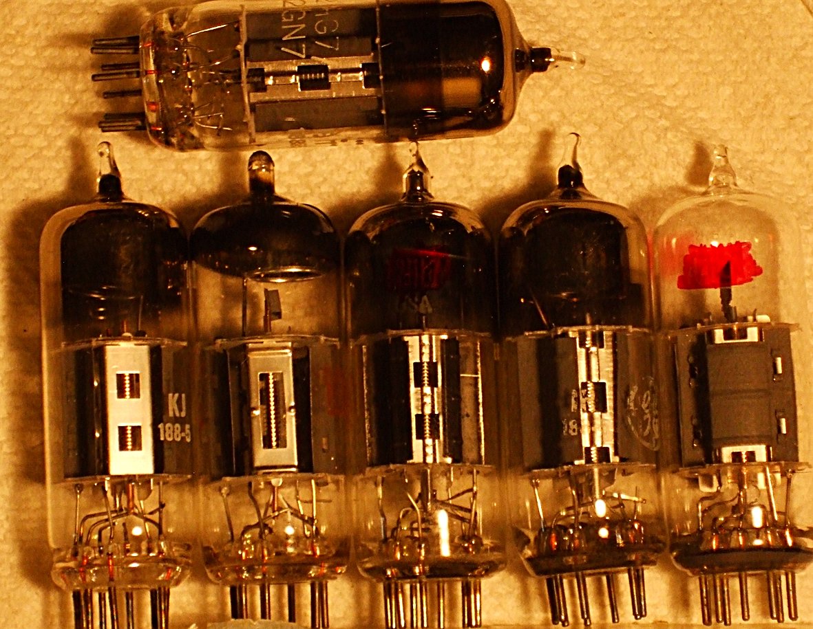

Here are some pics of the "tube from Hell" and pretenders for identification purposes.
On the left are the GE from Great Britain followed by a Triad from Japan, these test as a 12GN7. Notice the odd plate edges.
Then the next two in the middle are the real thing, a black plate Raytheon and a grey plate GE. (the black plate Raytheon had poor triode curves, can't say yet if that is always the case, the grey plate Raytheon and a black plate Sylvania had excellent triode curves)
On the right is an RCA with 11HM7 guts. (these type are going to get tossed)
And across the top is a real GE 12GN7 for comparison. (identical in appearance to the tube from H, but at least labeled correctly)
The back side of the plates have two or three strips of metal crossing between the plates on all. Except the 11HM7 guts version has a solid shiny metal plate across (it's the exposed beam plate) which is then covered over by the getter flash on the glass. The 11HM7 guts only extent back 1/2 way across the tube diameter, so is considerable smaller. (test example started thermal runaway on 10 Watt test scale on the Curve Tracer.)
So most of the imposter tubes are 12GN7 type, maybe 10%, which are still useful tubes and so far can be readily identified. Maybe 5% are 11HM7 junk. A few Triad tubes turned out to be one of each type, and then one with a non frame grid. Can spot that by the smaller (and copper) grid1 support rods.
