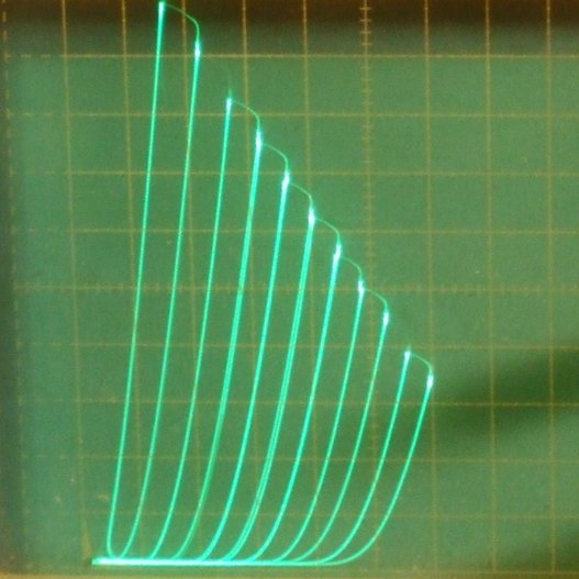

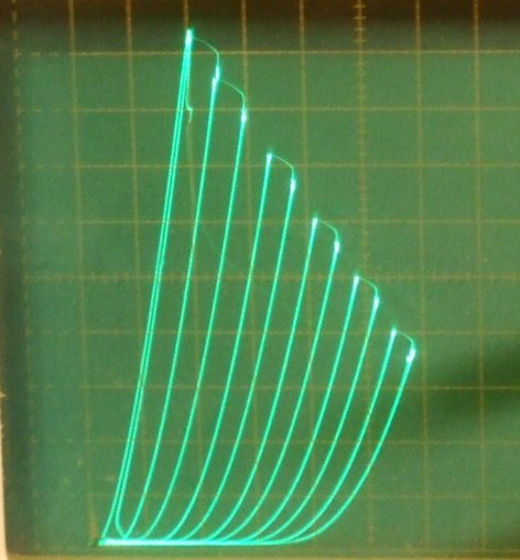

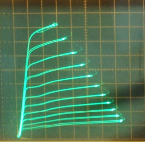

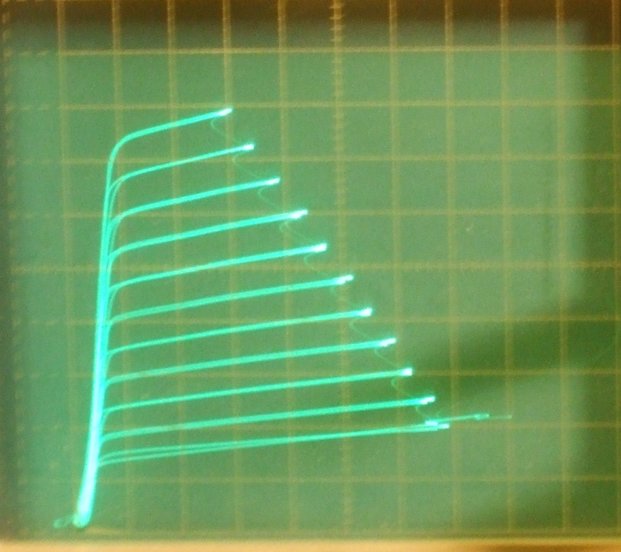

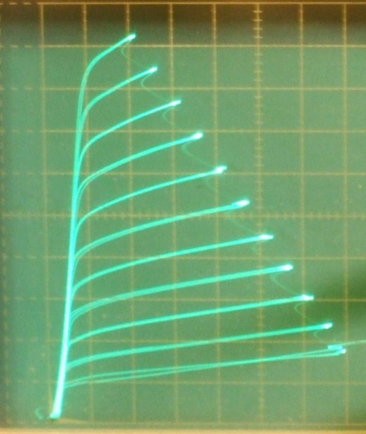

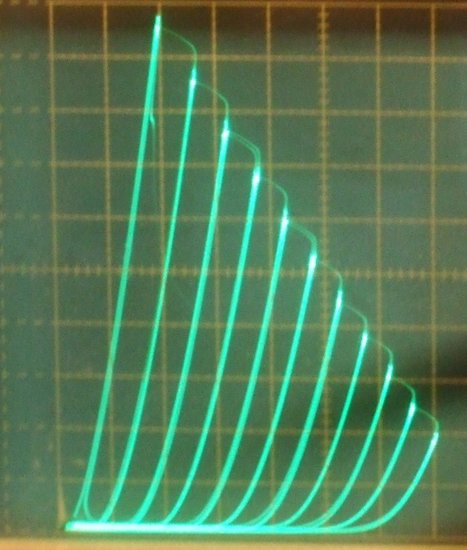

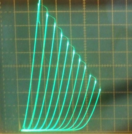

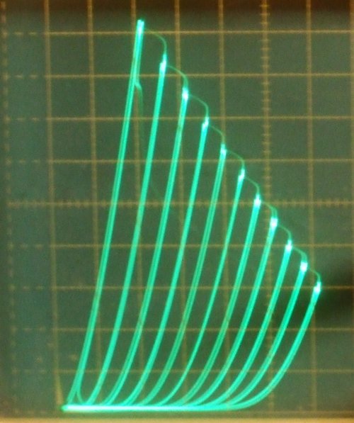

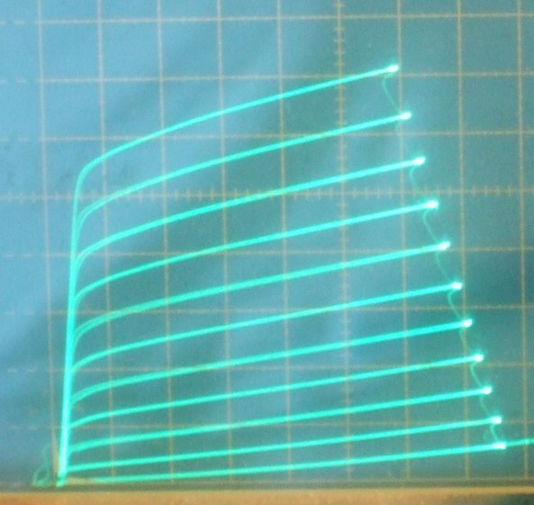

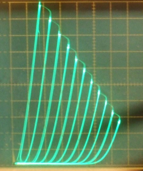

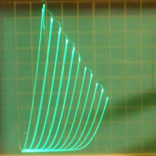

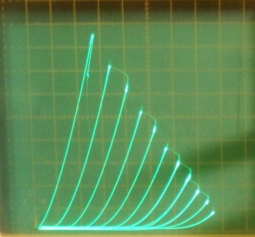

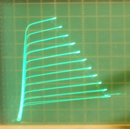

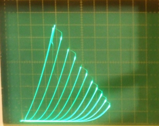

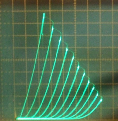

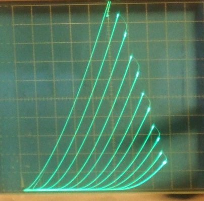

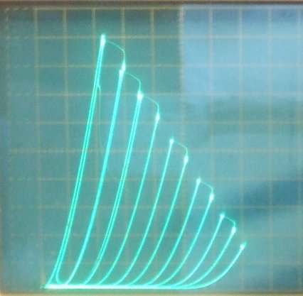

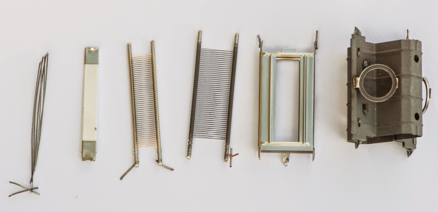

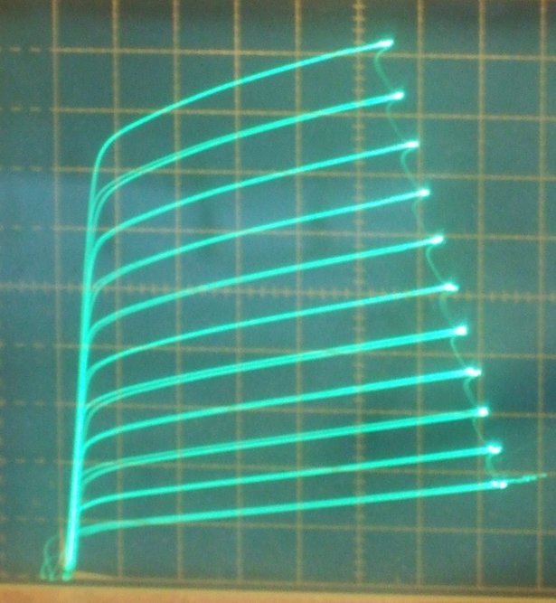

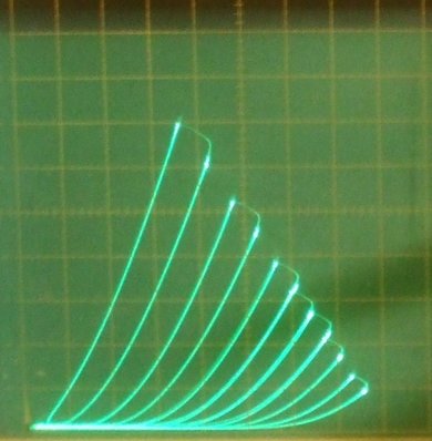

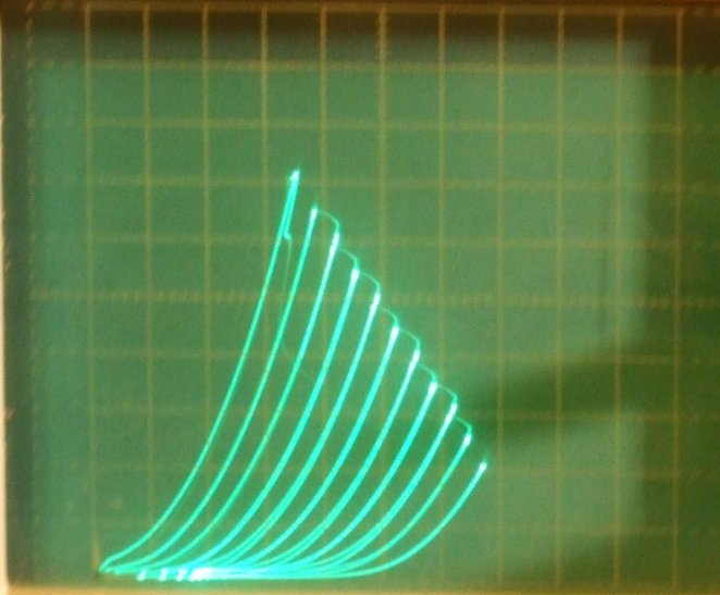

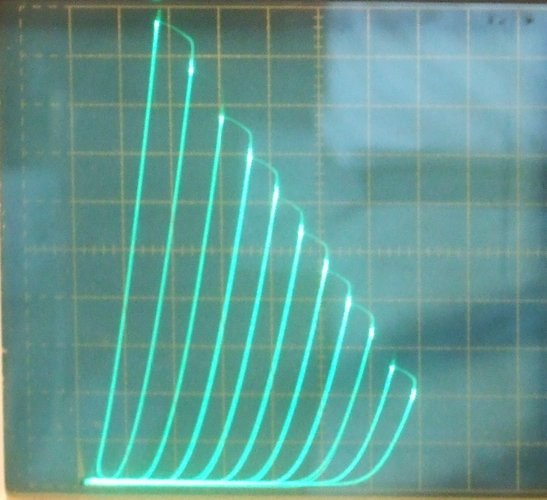

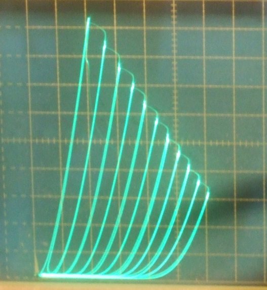

When I was quite young I had created a guitar amp design that was basically a Fender Champ with a 6BQ6GT TV sweep tube in place of the 6V6 and a bit more B+. It rocked and was quite loud. Note that the 6BQ6 and the 6DQ6 have the same pinout as the usual 6V6 and 6L6 types except that the plate is connected to a cap on the top of the tube. Note, these are NOT electrically equivalent to any of the common audio tubes, but that didn't stop a 12 year old kid from making (and blowing up) guitar amps. 6V6 and 6L6 types were rare, and cost money, but 6BQ6's and 6DQ6's were free, from inside a discarded TV set, which were quite common in the early 60's.
Of course I didn't understand little things like bias or impedance, bit I never understood why the amp was quieter and tended st smoke when I plugged in the bigger 6DQ6 tube. Years later I would figure all that stuff out......
Now much later I have revisited some of those tubes from my youth, the old TV tubes, and the then dirt common 807's, which I never knew at time WERE 6L6GB's in disguise.
I also found out by cracking open a few, then looking them up, that these 3 tubes contain exactly the same guts. The little ones just have smaller wings on their plates. The little guys ROCK too.....that board makes 75WPC!!!!
The little guy is a 6GF5's, the middle tube is a 6GE5's and the tall guy is a 6DQ6.
