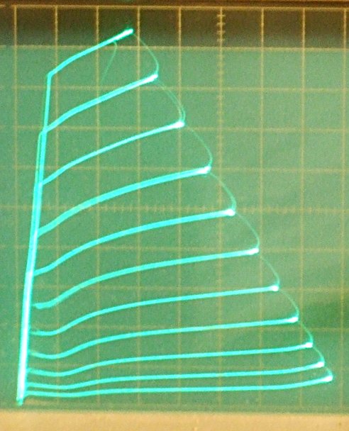

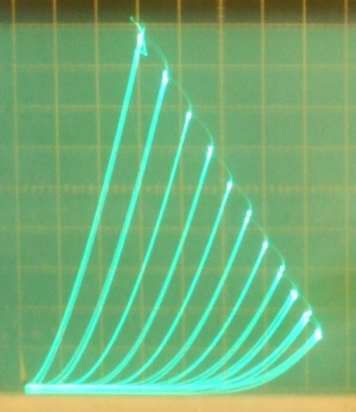

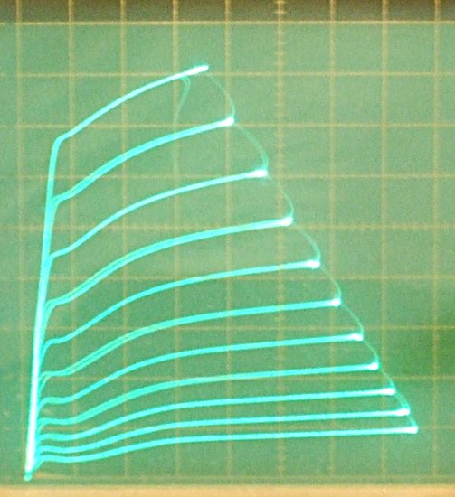

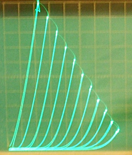

I traced the curves for an RCA TFH with the 11HM7 like guts, so attached are triode and pentode curves for that. 10 mA/div Vert and 50V/div Horia., 0.5 V g1 steps.
Then I went looking for a real 11HM7 here, and darn'd if I couldn't find the ones I had seen before that look just like the odd RCA versions. I did find a GE 11HM7 which doesn't look like the previous 11HM7s, and instead looks like the TFH versions made in Japan! Curves attached for that one too. Took 165V on g2 for the real 11HM7 in pentode to match the pentode curves of the RCA TFH "11HM7" variant with 120 V on g2. Not the same tube obviously.
Finally, attached is the original Raytheon gray plate TFH triode curves for comparison. As it turns out from testing a bunch of the TFH, the Raytheon gray plate triode version is unusually nice. But the other TFH are not far behind. Better than the RCA TFH "11HM7" triode curves (or real 11HM7 in triode) for sure. Even those are fairly decent compared to most triodes around.
The one issue about the RCA TFH "11HM7" look alikes is that they have half the plate size of the normal TFH, and red plate at 10 Watts diss. So I'm going to return them still for "real" TFH tubes.
Man, once you have a curve tracer, you will never believe stories like "black plate this or that sounds better than grey plate that", or whatever. Only when I see the actual tube curves will I believe an individual tube is good. There ain't no such thing as consistency concerning most tubes.

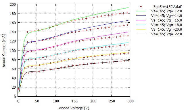

This motivated me to do a quick trace of the 6GE5 and created a Spice model.
Would be great if someone can test them as I ran out of time. They seem to fit well to the sample I have which measures 113% despite the saturation at high currents.

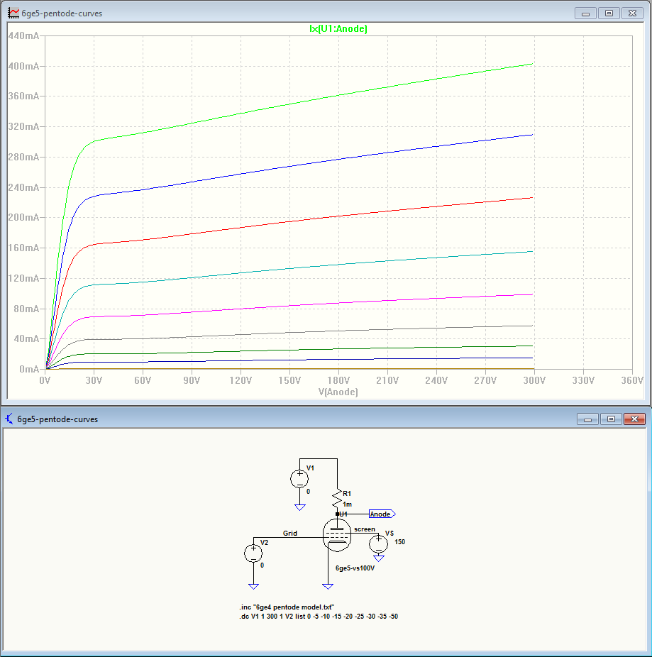

While uTracer's curves look ok, Ip is way too low when the pentode model is used. Vg2=150V, Eg1 from 0 to -40V.

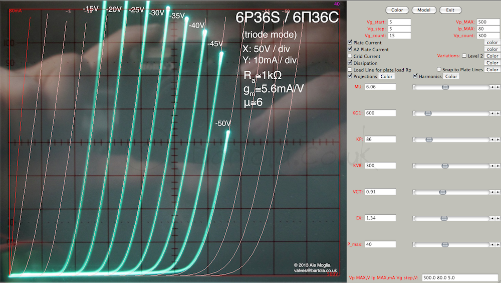

I guess the soviet union didn't have too much TV production? The 6P36S seems to be a real performer though. I'm going to buy 10 of those soon.
Those triode curves for that 6P36S do look quite nice. No wonder it is in demand for DIY in Eastern Europe.
Ebayers seem to be equating them to EL500/6GB5, but the datasheets don't look the same at all. Does the 6P36S use 2 Amps or 1.38 Amps of heater current?

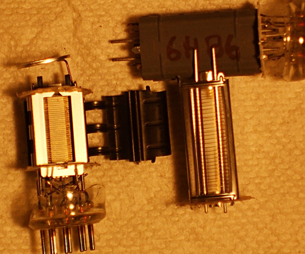

One of the TFH had a crack in the glass, so an autopsy was in order.
Left side is the TFH, right side is a 6HB6 for comparison. The wires you see are the g2 wires. The g1 wires are too small to see, but there are 4 g1 wires per g2 wire for TFH, and 5 g1 wires per g2 wire for the 6HB6.
Some measurements:
TFH: cathode 4 x 15 mm active area, 32 g2 wires, 4x32 g1 wires
6HB6: cathode 3 x 25 mm active area, 29 g2 wires, 5x29 g1 wires
The datasheets for these do not give DCmax current or Ipeak
So using the 6BQ5 and 6GK6 as reference, which have the same size cathode as the 6HB6 rated 65 mA DC max and tyically 3.5x that for Ipeak at 225 mA
Then for TFH, using the cathode area ratio 60/75 gives 52 mA DCmax and Ipeak at 180 mA (the heater current ratio is also similarly 0.6/0.76 )

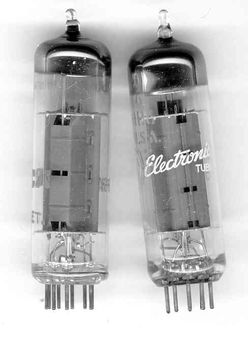

There was some speculation in the 6HB6 thread as to why there was so much difference between two versions of the same tube. I have several hundred 6HB6's, obtained from Radio Electronic Supply several years ago when they were 35 cents each.
At a casual glance they appeared to be of mostly two versions. The plates in the two versions look exactly like the plates in vintage 6BQ5's from RCA or Sylvania, and none that I have seen have the flat plate shown in your picture. Maybe there are 4 or more versions of this tube.
My tubes are stored in 2 or three cartons that haven't been opened in a couple of years. I looked at, tested, and played with only a few samples when I got the tubes. Guess I need to crack open a few more boxes when I get a chance.

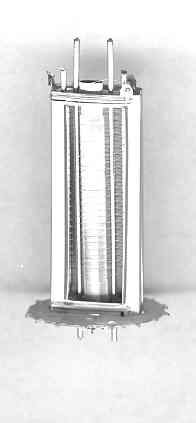

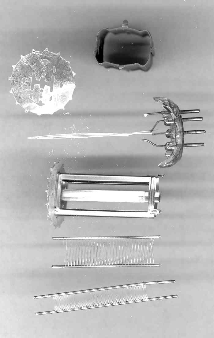

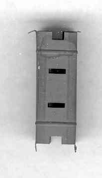

Here are some pics of the 2 types of 6HB6 I have seen. Most of the ones I have are the right side (GE) type. The guts pictures are from that type. I only have a few of the left type, so I haven't "modded" one yet.
Based on a small sample, most of my tubes are like the ones on the left, GE made. Some are Sylvania which have a different plate structure.
