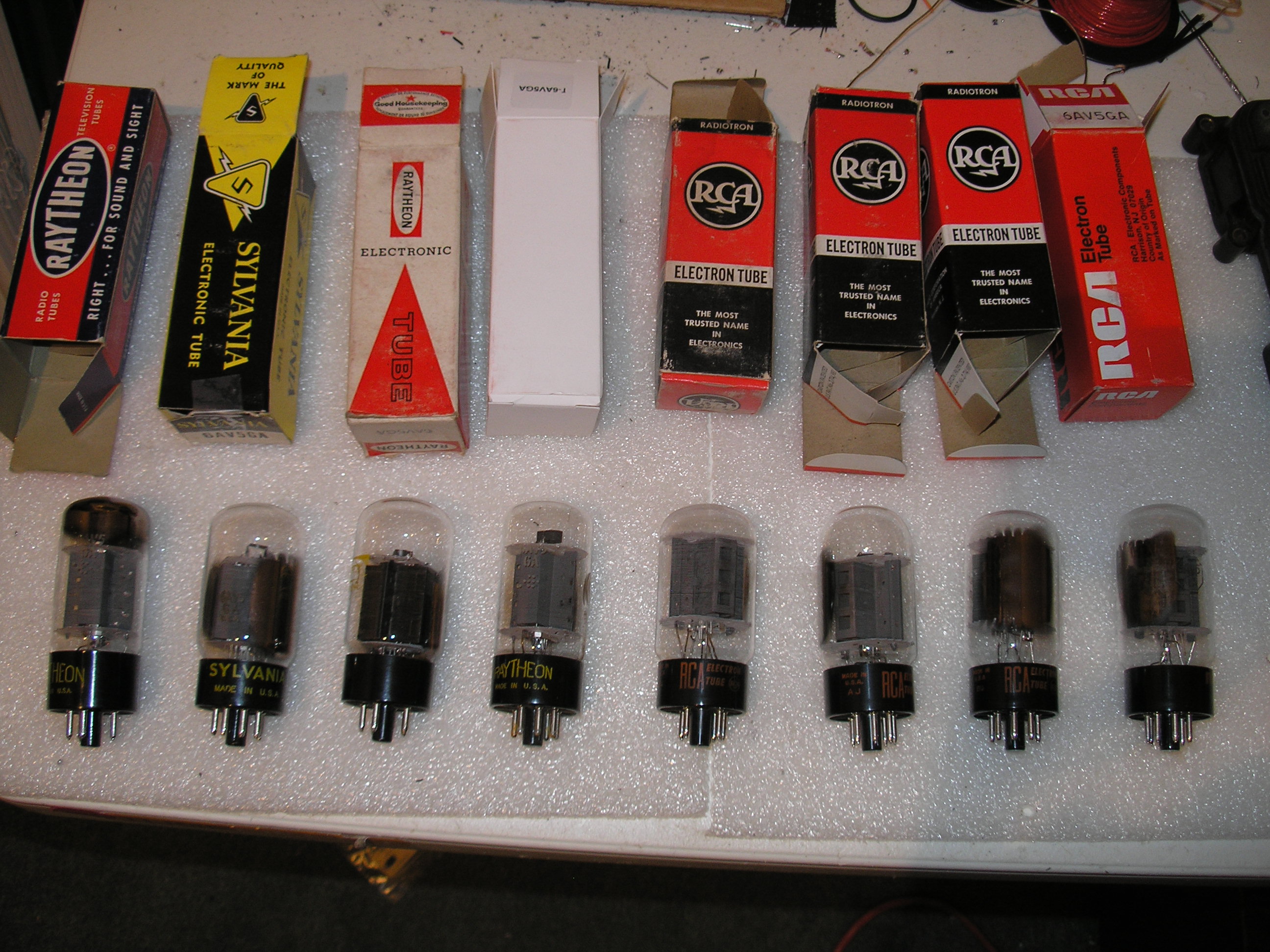

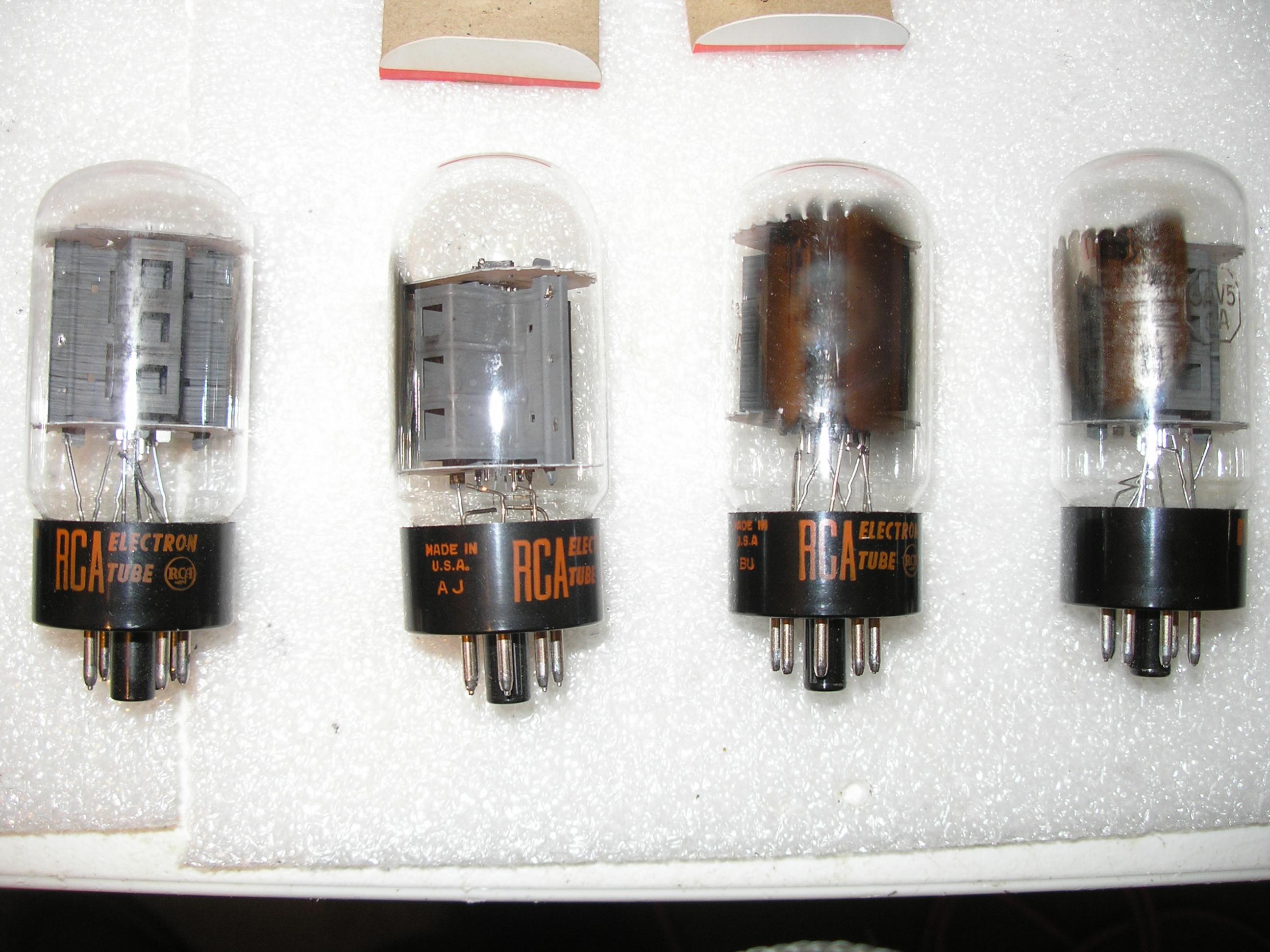

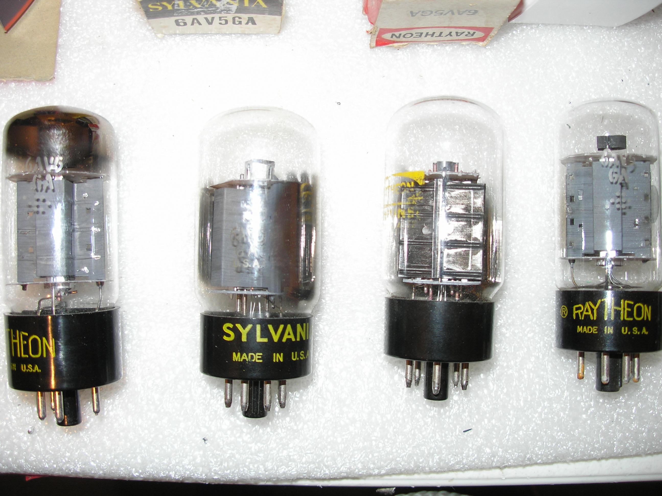

Here are some pics of the 6AV5GA's I got. Four look to be the same type RCA. The other three appear to all be different variants. I can post better pics of the individual specimens if anyone is interested. I have not had the chance to do anything with them yet, I haven't even looked at the roll chart in my Hickok 539b for test settings. I have to see what kind of iron I have laying around too, I don't have much and will need to order some.
Looks like the Raytheon and Sylvania may be the original 6AV5GA guts. The RCAs look more like a 6GT5 than the 6GE5, with those big square holes. Pretty much the same thing anyway, just RCA's similar version of the 6GE5 it seems.
Would have to measure the plate size to see if they can handle more than 11 Watts. The 6GE5/6JN6 // 6GT5 have 1.25 inch between micas and a 1.25 inch wide plate. An older 12BQ6GA I have here measures 1.25 inch between micas, but 1.125 inch across the plate (and 1 inch from plate side holes to holes). (12GE5 is similarly 1 inch across holes to holes)
Hard to see why one would be rated 11 Watts and the other 17.5 Watts. The 6AV5GA is rated 210 deg. C for the glass. The 6GE5/6JN6 and 6BQ6GA are rated 220 deg. C glass, and the 6GT5A is rated 240 deg. C glass.
6HJ5 (24 Watt) has a 1.5 inch long plate and 240 deg. C glass.

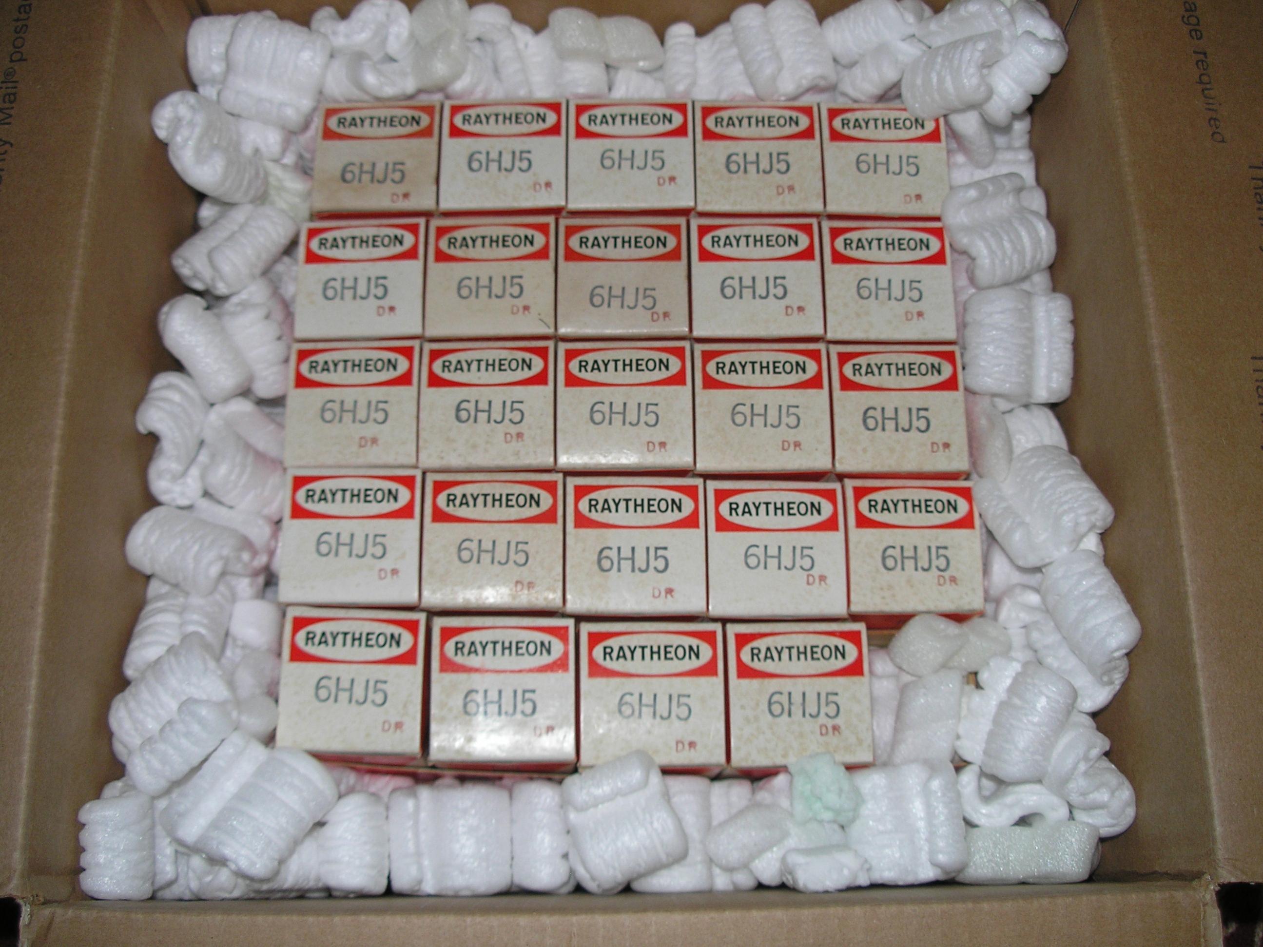

Be patient. I went through the whole procedure and my tubes arrived today🙂 After I sent payment they were very fast to ship. Packaged nicely as well.
Yes they are the Raytheon w/ black plates. Every Raytheon tube I have ever had with black plates has tested very strong and consistent and I usually like the results. Those guys know how to make tubes. I have a dozen or so black plate 12AX7's that test really high for transconductance and sound AMAZING in a guitar amp. I don't use any other tube for the first gain stage in my guitar amps anymore. I also have about 50 or so 6SN7GTB that have black plates. I noticed that every Raytheon tube I get the flashing always looks different then any other tube manufacturer.

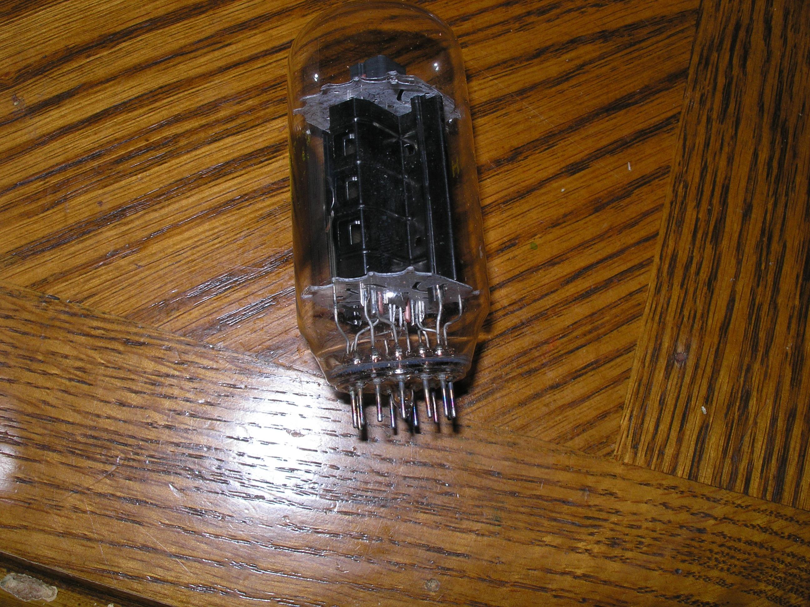

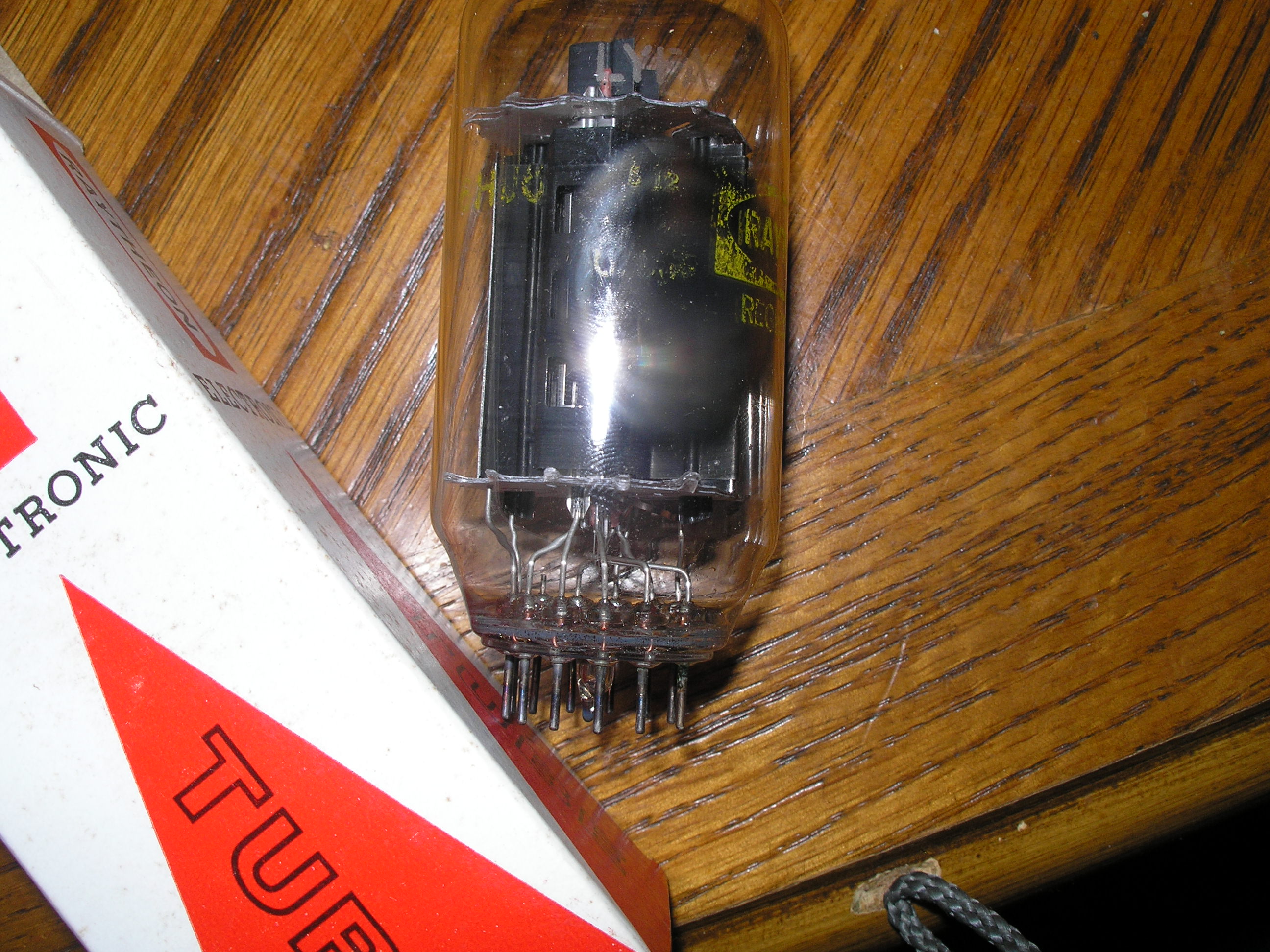

Back to the 6HJ5. Here are some pictures. They appear to be made really well, doesn't surprise me from this company. I can't wait to try em out.
You are right--The invoice came an hour ago....
Looks Very nice, All yours look to be same batch--the 'DR' on the box....
At the mo, I could only afford 10 tubes, With shipping to UK, works out to $65. Still pounds to dollars, thats a $4 buck tube there, and a £4 quid tube shipped with current exchange-rate Good price Cant get a bag of fish and chips for £4 round here!....
We see what mine turn out like too--Be about a week--maybe more.....

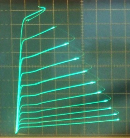

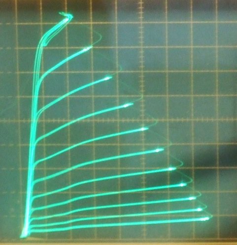

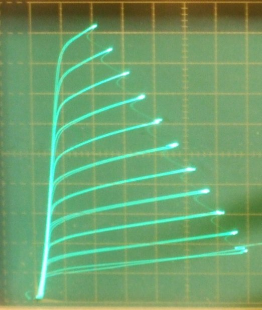

I just tried a 6HJ5 on the curve tracer here in triode mode with HV on the "plate+g2". I can get up to 1000V without any flashovers. I don't think I would want to rely on that for extended operation though. The 6HJ5 has got 2.8x the current capability, 2x the gm, and 1/2 the Rp of those wimpy 300Bs, so no need to use such high voltage anyway. 250V to 275V for B+ in triode mode will probably work fine. (+50V to +500V peaks, a 2X safety factor versus 1000V) An Edcor CXSE25-8-2.5K SE OT ($88) ought to work for SE. Or GXSE15-8-2.5K. ($38)

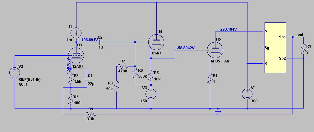

I have never built a SE triode amp. Should I bother with global feedback? I need lots of gain especially if I want to use a little feedback, say 3db. I would like to use the tubes I have on hand which are tons of 12AX7's and 6SN7's.
This is something I just came up with. Output iron is Hammond 1627SE although I will probably go with Edcor. R8 is a 100k trimpot to adjust bias. Simulation shows just about 10 watts out @ 5% THD. The 6HJ5 is running @ 85mA. Total gain of amp is 18db.

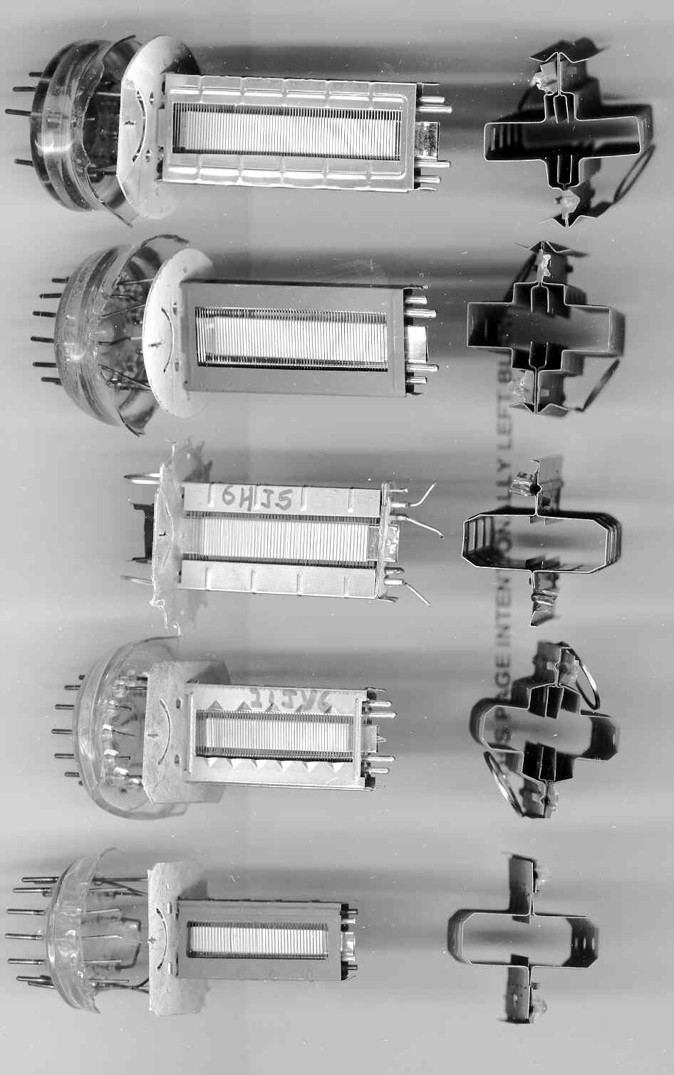

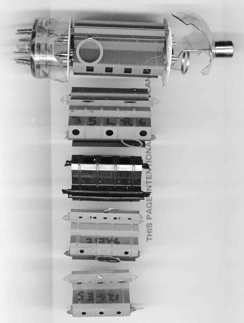

"how does the 6GE5 compare to the 6HB5?"
The 6HB5/21HB5 has a 34 mm long plate (same as 6HJ5) and the 6GE5 has a 28.5 mm long plate.
The 6HB5 cathode is 5 mm wide by 29 mm long, and the 6GE5 is 4.37 mm wide by 25 mm long. (6HJ5 is 6.67 mm wide by 32 mm long). So the relative cathode areas are (followed by plate length, DC mA rating and Watts diss.):
6GE5 109 28.5mm 175mA 17.5W
6HB5 145 34mm 230 mA 18W
6HJ5 213 34mm 280 mA 24W
The 6HB5 has 9 grid wires per 8 grid wires of the 6GE5 or 6HJ5
and finally, computing gm (@ max DC/4) per cathode area (followed by gm (@ maxDC/4) /maxDC):
6GE5 52.8 33
6HB5 70.9 (x8/9 = 63) 39
6HJ5 43.3 33
300B --- 33.65
2A3 --- 31 (based on 100 mA max DC, not specified in data)
These are giving a measure of gm per unit area at the same current density.
Lower #s should be more linear (for the same grid wire spacing). So theoretically the 6HB5 would be less linear. However, check the traces below, a bit hard to confirm. A little feedback, and they will all be the same, with the 6HB5's 18% extra gm per area to fix it.

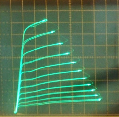

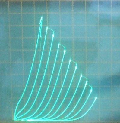

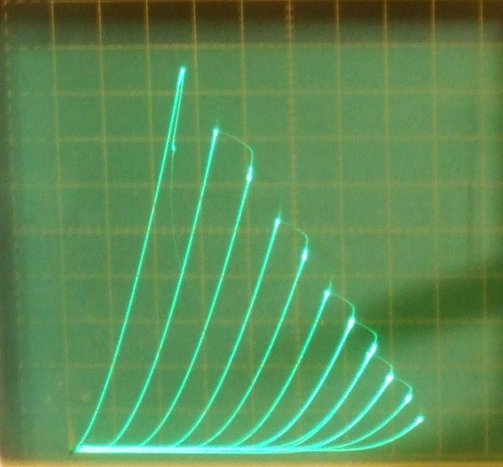

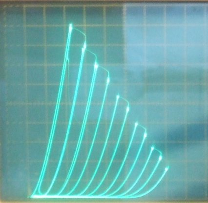

Some pics of plates, then cathodes. (bottom to top: 12GE5, 21HB5/21JV6, 6HJ5, 35LR6, 36MC6)

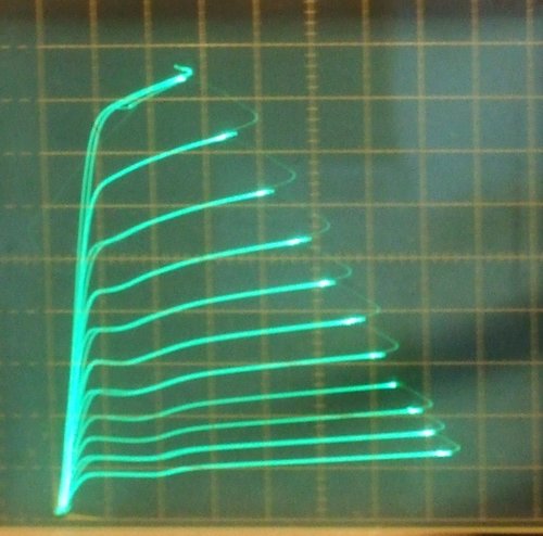

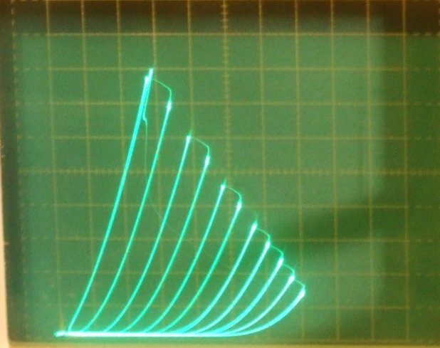

And, finally some curve traces to try and decide: 12GE5 pentode and triode, then 21HB5 pentode and triode, and 6HJ5 pentode and triode. Probably need an FFT analysis to decide linearity between them.

ALL of the 6HJ5's that I have seen are just like yours. They all seem to be Raytheon's regardless of brand. The 6HD5's are also all Raytheon's even though they are all Motorola branded. Same tube, minor pinout difference, hard to find, but sometimes cheap.
Most "tube friendly" speakers don't need GNFB when driven with a triode SE.
The schematic you show is similar to some amps I have built including the TSE, but I tend to use a mosfet where you have the 6SN7. Sweep tubes generally don't need much positive G1 drive so the 6SN7 will probably do OK.
