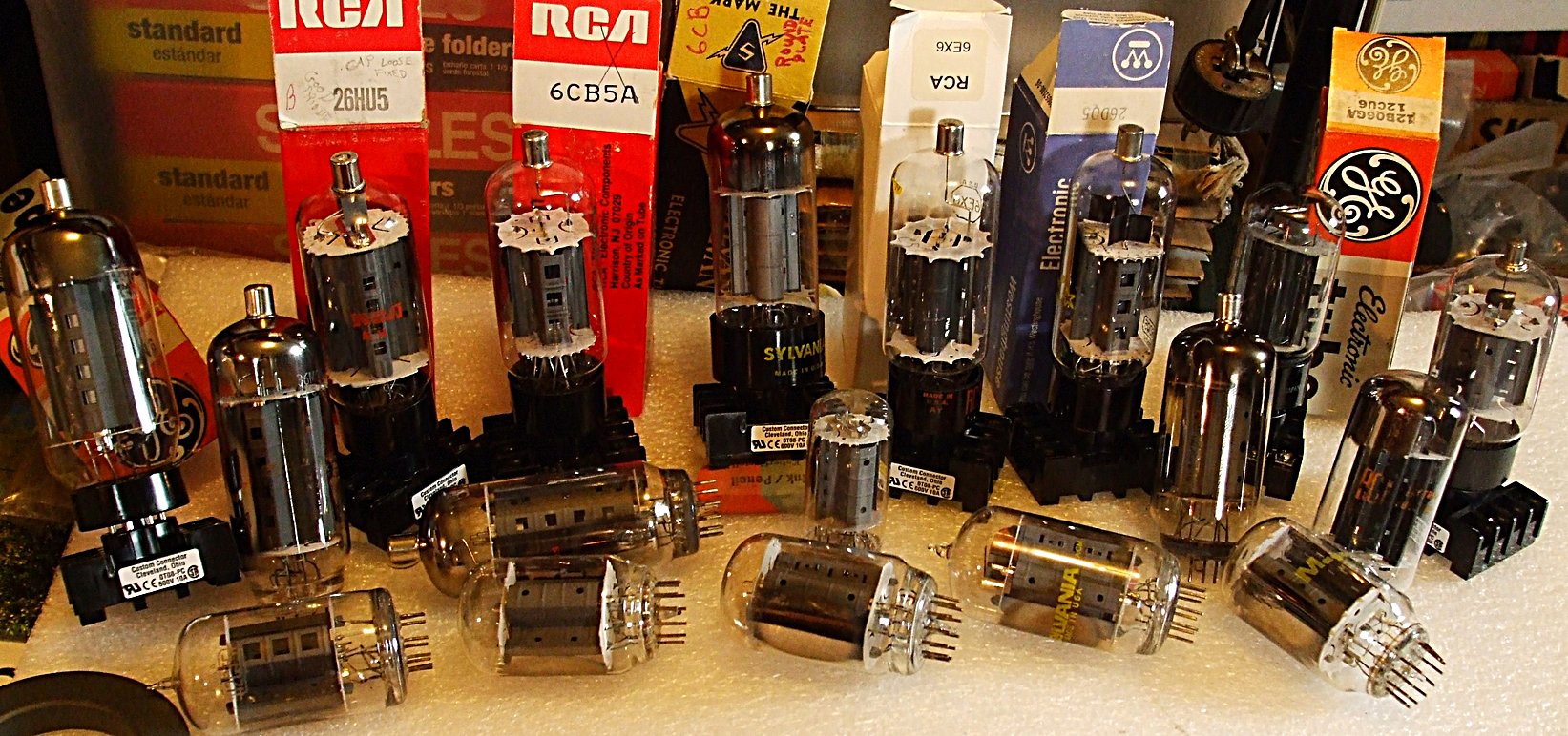

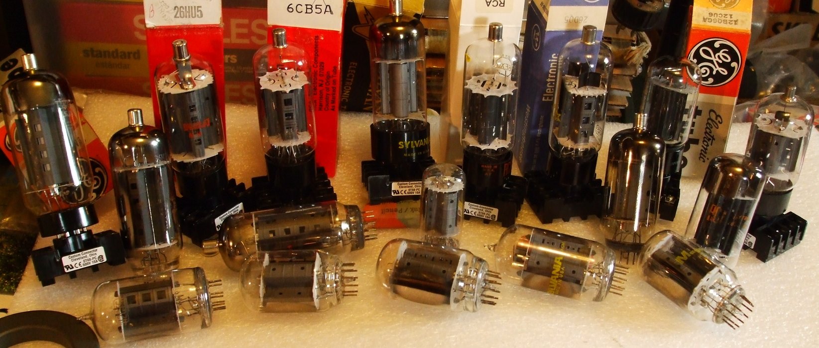

Back row (black octal bases) L to R:
36LW6, 26HU5, 6CB5, 6CB5 (round plate), 6EX6 (round plate), 26DQ5, 6L6GC, 12BQ6GA (=6AV5GA but with a top cap)
Middle row compactrons L to R:
36MC6 standing, 26LX6, 6GF5 (the midget standing up center), 21LG6 standing, 6HJ5 standing
Front row L to R:
12GT5, 12GE5, 21HB5, 17KV6, 38HE7
Any of these should make a good amp for cheap. 9 Watt (6GF5) to 40 Watt (36LW6) tubes, your pick.

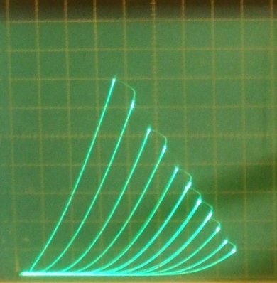

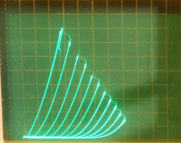

The 6/12BQ6GA was nominally the same tube as the 6AV5GA, but with a plate cap on it. Looks like both of them got 6/12GE5 guts eventually. The 12BQ6GA I tested here looks just like a 12GE5 internally. Curves are near the same:
1)12BQ6GA // 6AV5GA 20mA/div Vert., 50V/div Horiz., approx. 7 V steps
2)12GE5 " "

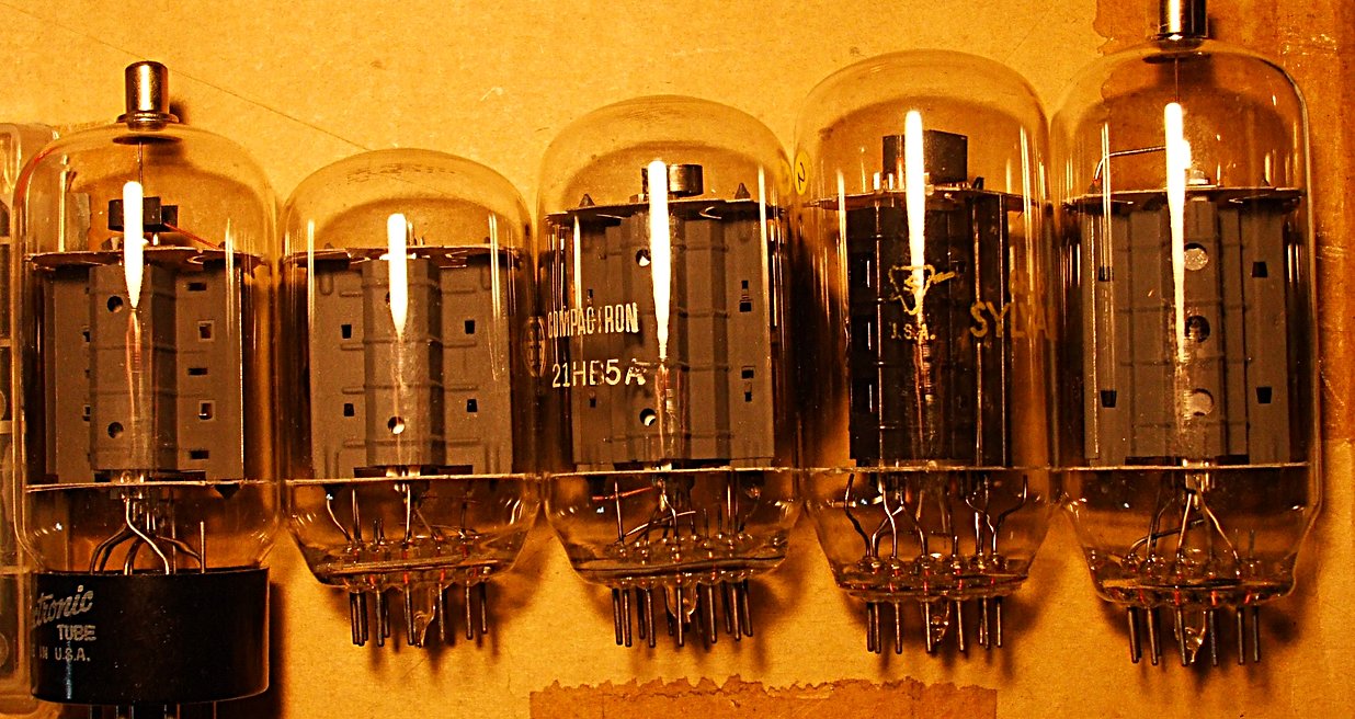

Here is a pic with a 12BQ6GA on left and a 12GE5, 2nd left, for comparison,
then 21HB5A, 6HJ5, 21LG6
Obviously the 12BQ6GA is a late model, with the same guts as the 12GE5. The later 6AV5GA tubes should look the same too.
Although the 12BQ6GA and 6AV5GA are nominally rated 11 Watts and the 12GE5 17.5 Watts.

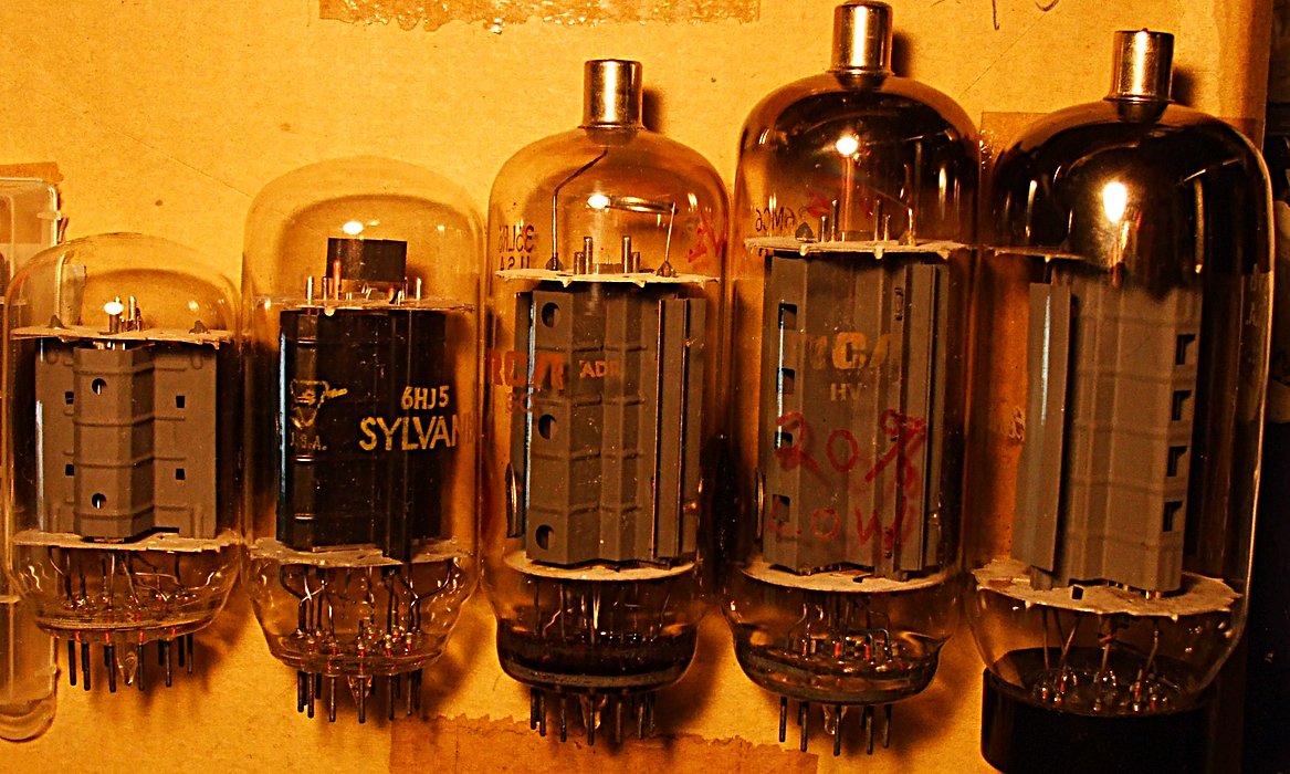

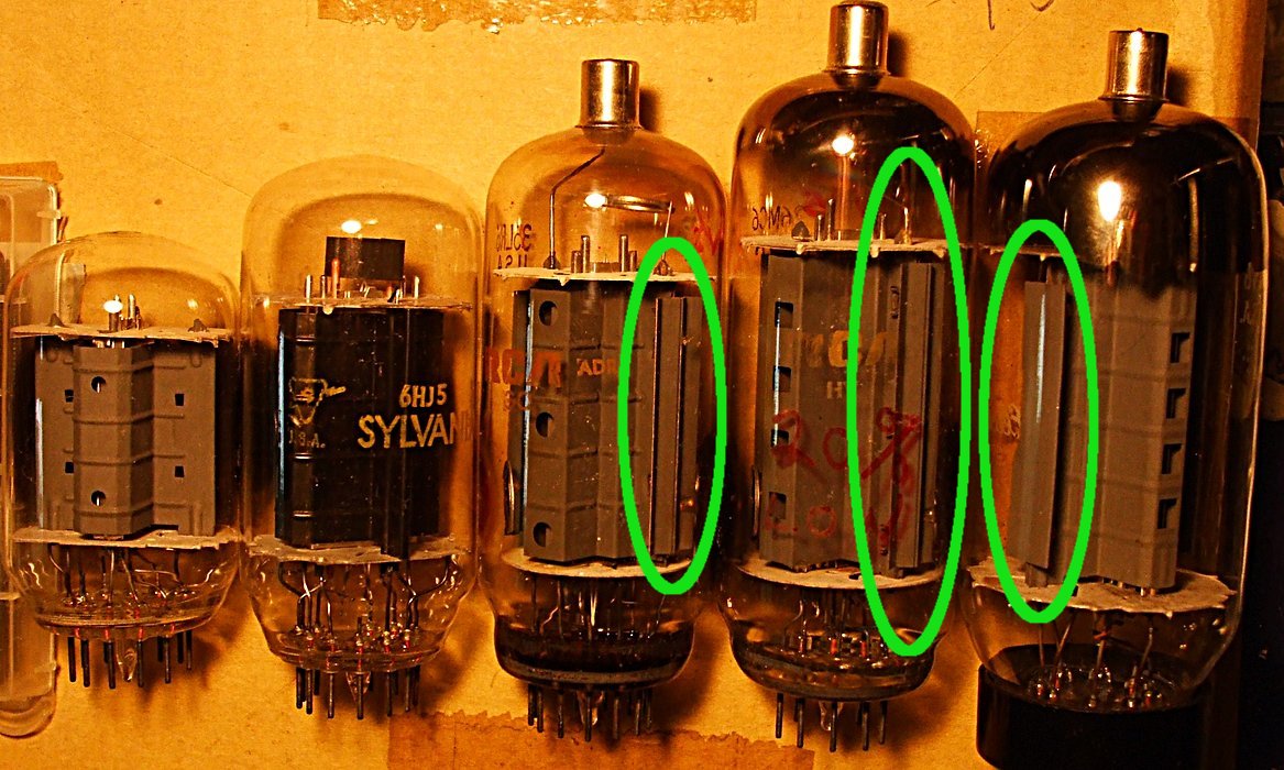

2nd pic is L to R: 12GE5 18Watt, 6HJ5 24 Watt, 35LR6 30 Watt, 36MC6 33 Watt, 36LW6 40 Watt
Those pretty much cover the various Sweep Tube sizes. Notice the plates start springing "Winglets" on the edges for the larger ones. A bunch of 30 Watt tubes have the same plate size as the 24 Watt 6HJ5, like 6HF5, 6JS6, 6JE6, 6LQ6. And the 18 Watt 21HB5A too.

I see the "winglets", so they just add those to the plates to dissipate the extra heat....interesting and smart.
