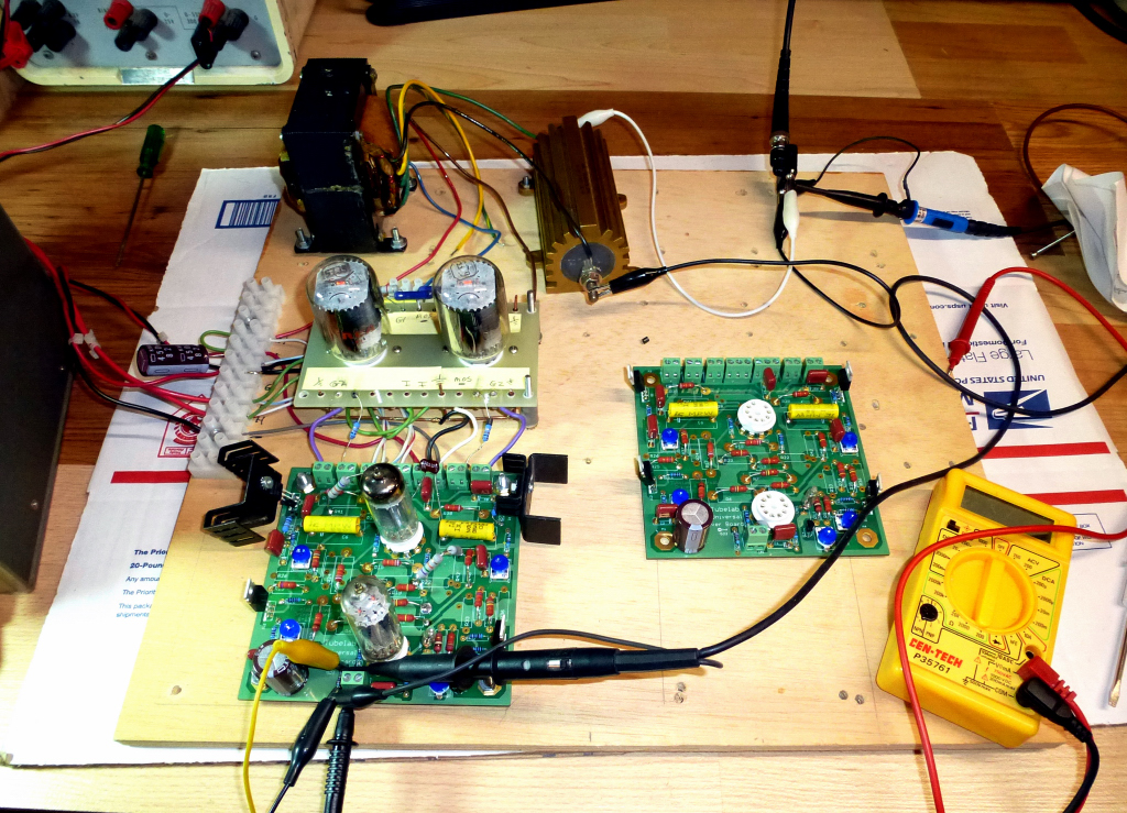

Today marked the first time that any tubes have glowed in this new house......they were 6GE5's. I had 5 X 6GE5's that were "NIB".
Out of 5 tubes there were 3 different constructions. There were two RCA branded tubes that were made by RCA, An RCA branded tube that was made by GE, An RCA branded tube that was made by Sylvania, A Sylvania that was made by Sylvania. All appeared new.
I had discovered a breadboard that I had made in Florida that had 6GF5's in it (tiny sweep tubes) It was set up for dual drive (G1 and G2 driven simultaneously). I remember having problems with it, but I hooked it up and tried it. There was a lot of distortion and getting equal currents between the two output tubes seemed impossible. The current wandered all over the place.
The 6GE5 has exactly the same pinout as the 6GF5 so I plugged in the pair of RCA tubes. The breadboard worked flawlessly. The idle current was easy to set and stayed put where I set it. The board made 50 watts into a 6600 ohm OPT with 450 volts of B+ at 2% distortion. Cranking the audio generator to max produced about 75 very distorted watts. No hint of redness, screen grid glow or other anomalies were seen. SO.....
MORE POWER.....I have 450 volt caps in the board, and the power supply is already set on 450 volts, so I put my 8 ohm load on the 16 ohm tap to give the tubes a 3300 ohm load. More power? OH YEAH, I get 90 watts at 2% distortion, and 99 watts at clip.....
OK, I'll bump the voltage knob up to 475 for just a minute to see what happens. I get 100 watts at 2.5% distortion. A minute turned into 5 just to see if......yes, there is a pale red glow on the plates. OK, I have reached the limit of the 6GE5.........but wait....there's more......
The Sylvanias have the big boxed plate like those killer 6AV5's had, so crank em up. 108 watts at 2.5% distortion, not a hint of glow after 10 minutes at this power level. Diming the audio oscillator produces 120 watts of pure square wave.......I turned off the power before I blew up any caps......450 volts remember. My meter reads 476 volts.
Note that this was an existing breadboard with a unique dual drive circuit. I would expect that a conventional G1 driven 50 WPC amp with these tubes, or the 6AV5's would be easy. Best bet would probably be an OPT in the 4000 to 5000 ohm range with about 450 volts of B+ and 150 to 175 volts on the screens. Alternatively you could use a 3300 ohm OPT with less B+.

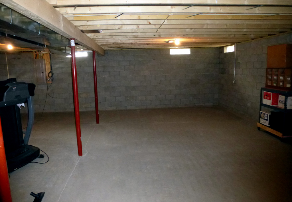

Pictures:
#1 the "lab" in March
#2 the "lab" yesterday
#3 the "lab" today
#4 6GE5 in the hot seat

Great to see the "lab" up and running.
So far it's just a little piece of my big dream for a new lab.
In Florida everything (lab, construction, listening room, and some storage) was all stuffed into a 10 X 10 foot room. Now I have a 1500 square foot basement. There will even be a gym in here. I also have a 850 square foot mobile home next door for storage.
The financial situation has made a big turn in an unfavorable direction, so I have been building my lab for near zero budget. I am now working on my third workbench and so far I am still under $100 total. I took today off from the table saw for some tube time. I think it's the first this year, although I may have plugged in something back in January in the other house when it was too cold to work outside.

I would say the results for the 6GE5 are good indeed. Hopefully you can try and hook em up to the SE boards for triode operation. Probably a pain in the butt because of the different sockets. Vinylsavor seemed like he is pleased with the results he got in triode operation.

Unfortunately the last experiment (not involving 6GE5's) blew both mosfets on the driver board. I wired something up wrong, and both mosfets are now shorted. I'm not exactly sure what went wrong yet.
I need more, and better light in that basement. I grabbed both LED light sticks in our local Walmart last week, but one didn't work. Road trip tomorrow to another Walmart to get more. 4 foot LED light stick, 1850 lumens, 19 watts, $25. 4 or 5 more should be about right.
I can't do conventional G1 drive experiments until I get the dead power supply fixed. Autopsy revealed that one of the 1960 vintage electrolytics has spilled its guts. They probably all need replacement. It was left in the unheated storage building last winter.
