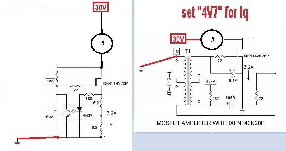

Dan, ditch the ammeter in line with anything. If you must test the upper and lower independently to verify proper operation use this attached circuit. Instead of an ammeter, put a bunch of low value power resistors in place of where the "A" is in the attached. I used 4x0.47R parallel for example. For the lower gain test, verify bias voltage is as low as you can get, apply power. Slowly bring up the bias until you measure 28VDC D-S. Connect per the schematic attached, I used this to verify, it works. The circuit as drawn in the begginning of this thread works perfectly, no need to add all these extras. I built the amp exactly, with exception of a pot in the upper Mu, it works.

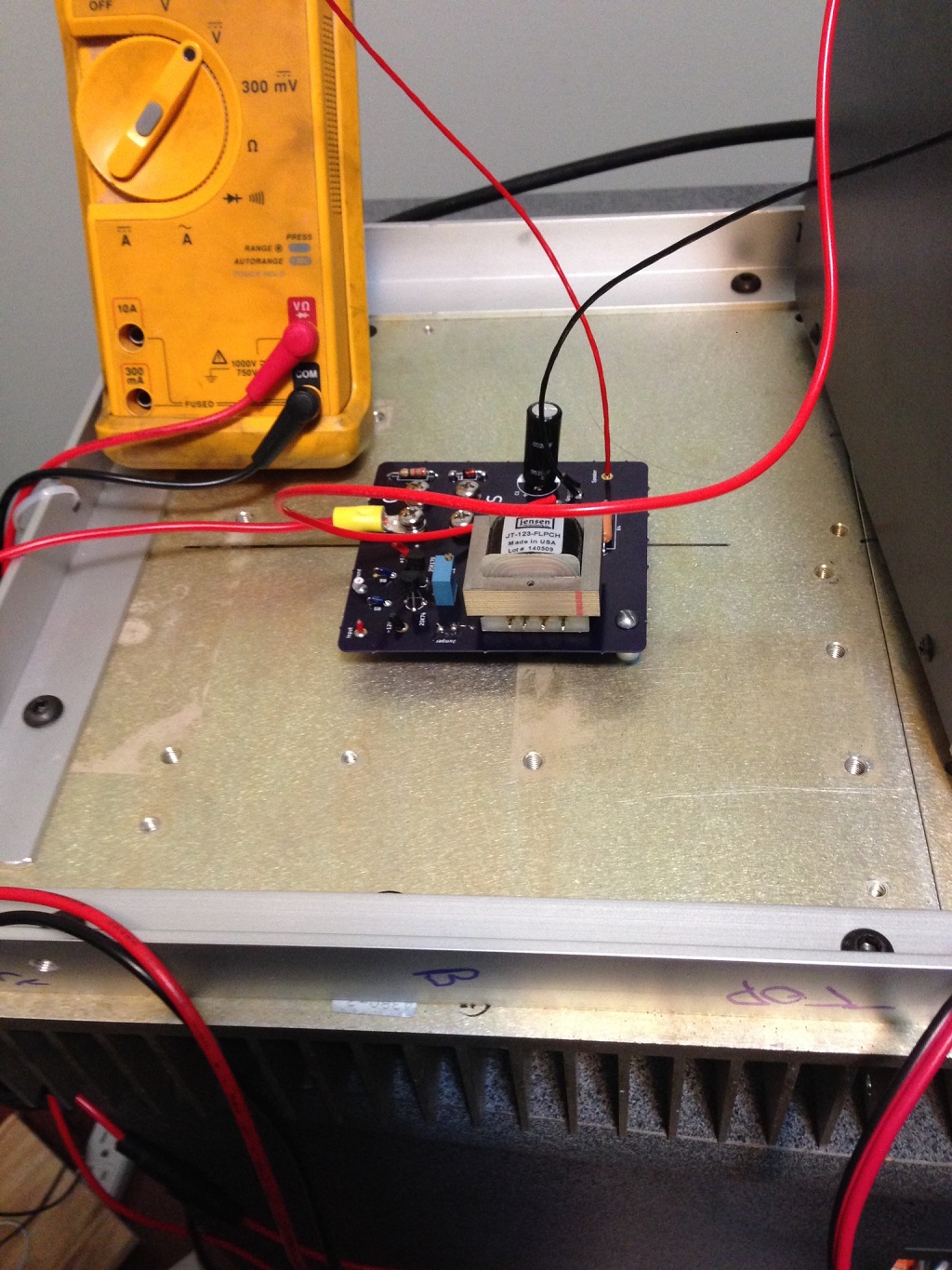

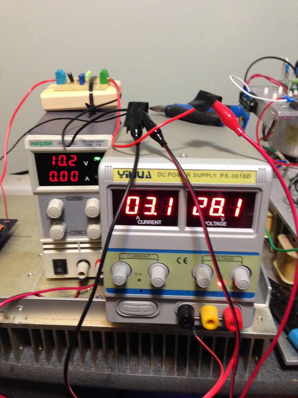

Back to basics. With the ammeter removed the CCS works perfectly with the 4R0 test resistor. I'm monitoring current with Dirk's Ohms law suggestion. Resistor voltage drop (around 1.37vdc) across 0.407 Ohms. About 3.36 amps.
Next step is add the lower half with an external power source feeding the bias.
Going to leave the ammeter out of testing the whole circuit and adjust bias for a Vds of 28v on the lower MOSFET.
Dan
Added the lower half of my circuit with no bias. Blew the 4A fuse and toasted both MOSFETs. I now know my CCS has no design flaws and works perfectly. After reviewing the lower half of my circuit I"m going to do any future testing with two labs supplies. One for the 28V and one for the bias. Not the CCS.

Tried a 220R5W D to S. It seemed to help quite a bit.
Dan
Excellent, seems like all is well. Yes, when testing the lower end without the CS, I noted a runaway as well when trying to set the bias, its extremely sensitve. Make sure you note what that bias voltage was, as thats what you'll use when you connect the CS. Now connect it all up, with fuse, and maybe a light bulb in line with your transformer primary....and keep the ammeter away!!

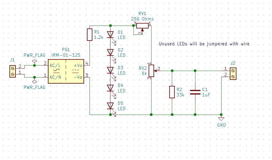

The Mighty ZM has 'inspired' me to do some tinkering while I'm waiting for more parts. This circuit also got me thinking on whether or not these 1W or 2W DC power modules are 'easier' or 'cheaper' when it comes to supplying low ma bias circuits...................

For a specific voltage supply that only requires a few ma they could beat the cost and complexity of getting your own small VA transformer, a bridge, some caps, etc. They are a nice option.
