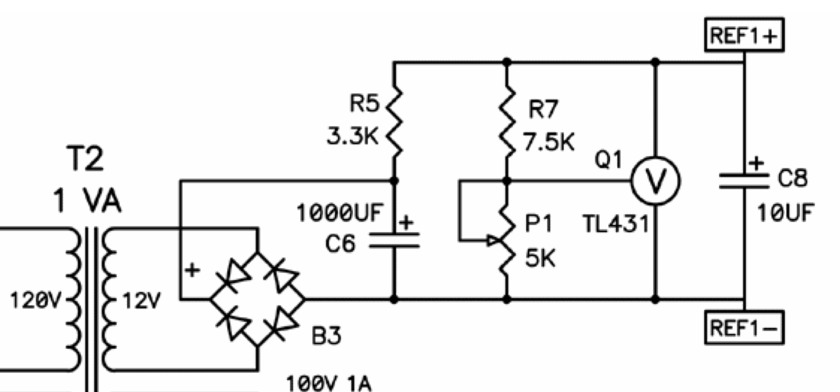

To adjust a similar circuit I used a variac transformer, I gradually increased the voltage and controlled the voltage and the current across the transistor.
hardly - if Papa published circuit..........
you're having some methodical omission here, circuit is working
Good point. I find when troubleshooting it’s wise to boil down the problem to it’s simplest form. After implementing ZM’s cap and zener trick I’m going to strip the PS down to the bare main 60vdc supply. When it’s time for bias I’m going to use one of ZM’s greenies fed by an external lab supply. You can’t get much simpler than that. More details soon.......

Original Mr Pass are verified and simple , work like a charm :
two resistors, two caps, trimer and TL431 50w Single-Ended BAF2015 Schade Enabled
One more complicated news : I don't see benefits of " innovation" with 20 resistors in CCS ,
four resistors for two channels is show in original schematic 🙂 Best regards
