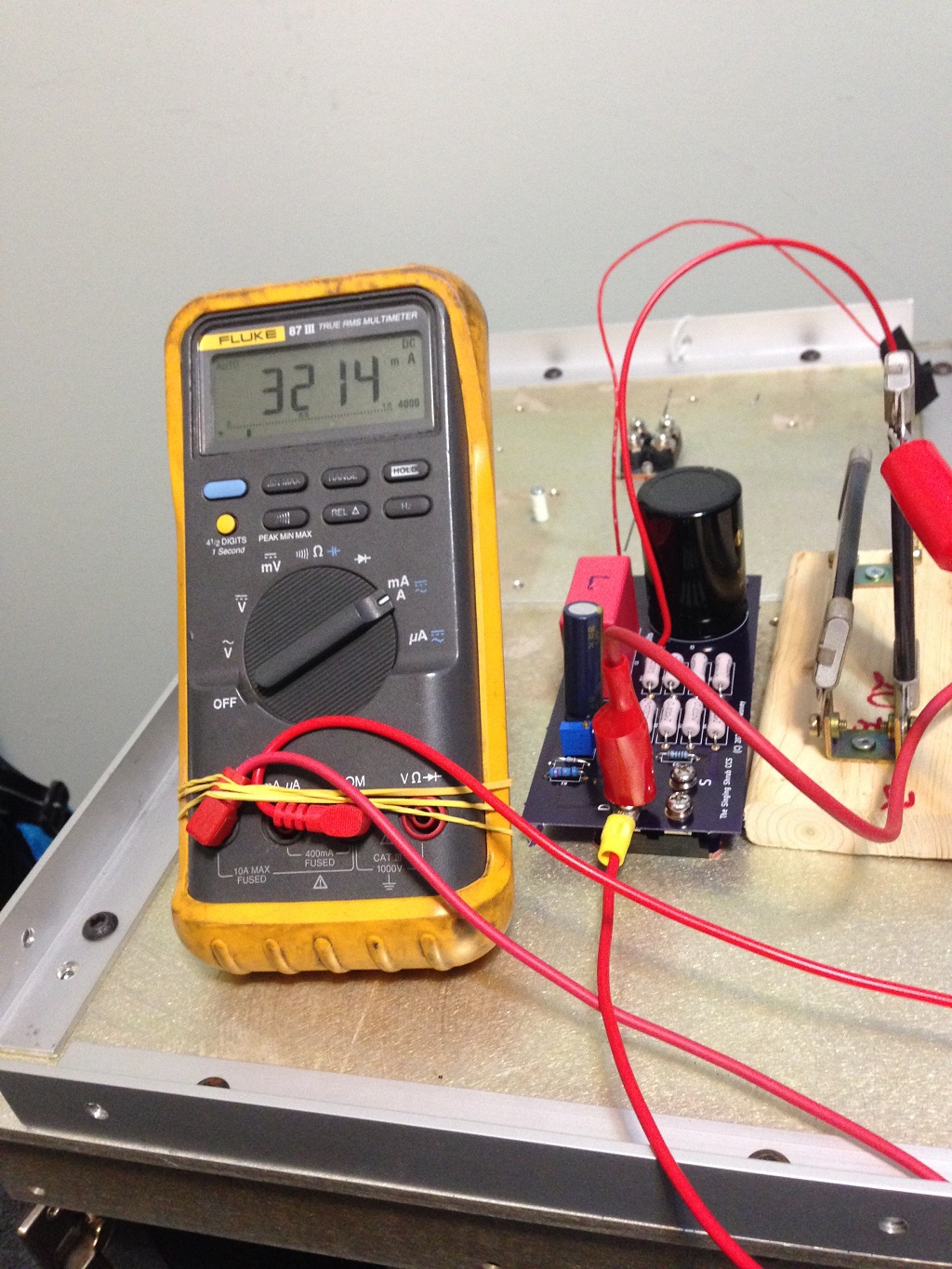

Back to some basic testing before I try ZMs suggestions. Seen below is my rail voltage and my CCS happily supplying my 4R0 test resistor with 3.2 amps.

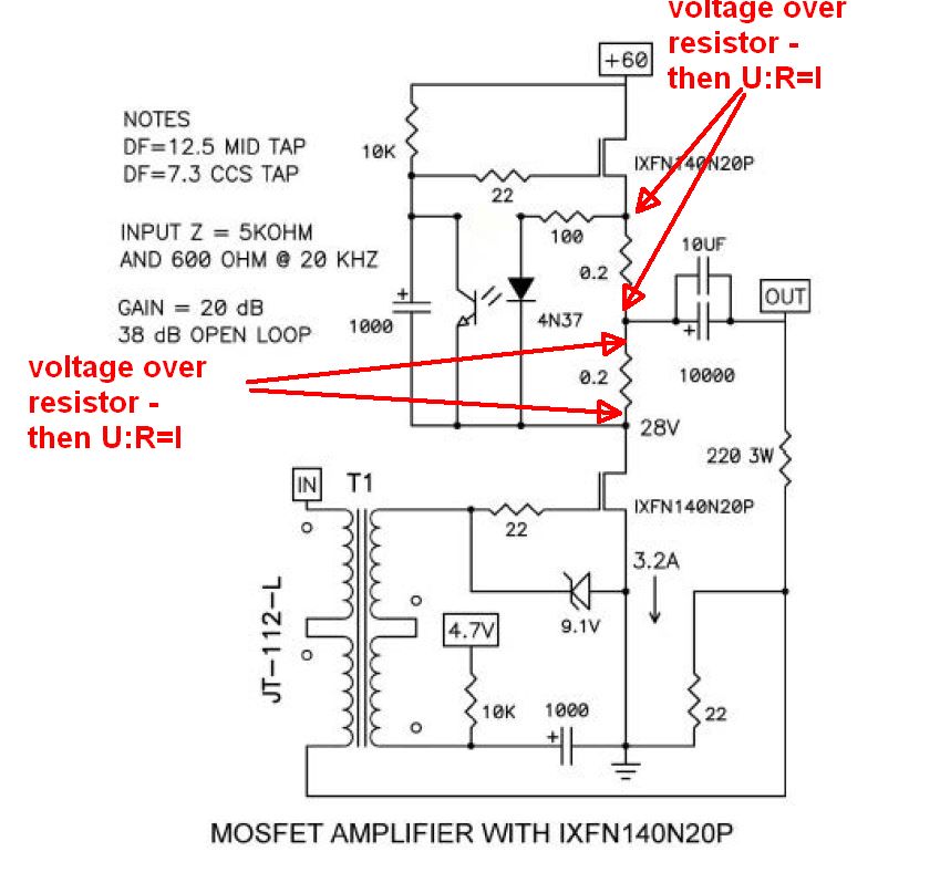

A suggestion if you are going to test the lower circuit:
Do not measure current with a meter in series in the circuit. Measure the voltage drop across the 0.2R and convert to Ampere. All of your previous fried CCS Mosfets have occurred with the Ammeter in series and then removed. Time to try something different.

Am I safe assuming once a CCS is ‘set’ to deliver 3.2 amps to the test resistor that it will deliver that same 3.2 amps to the lower mosfet? My ammeter seems to indicate that is the case when in series with the entire circuit.
The last time I adjusted bias I did so to reach a target current (3.2A). After I did that I measured Vds and it was 27.6vdc.

It should if it is functioning properly. It is a "Constant Current Source".
When you set the lower Mosfet operating point, you should be adjusting for Vds, not for current. The goal is to set Vds to 28V. You can monitor the current by measuring the voltage drop across the 0.2R (0.64V). If the current starts to go above 3.2A that you had set the CCS at, then there is something wrong.

It depends on how your lower MOSFET is biased. The less it conducts, the lower the voltage drop in your CCS resistors, so the upper Vds will be higher while the lower Vds will be less.
Edit: the node voltage between upper and lower should be higher, not the upper Vds

when you are in ballpark, with iterative settings of two trimpots (one in CCS, second bias of lower mosfet) you're fine-tuning both Iq and output node voltage potential
what is not clear enough - is id you had some massive oscillation in Mu part of amp
if you mounted protection zenner and that G-D cap, you're preventing in good amount possible BadaBoom of Mu mosfet
even if Mu Iq is pre-set just roughly, if you start with 0V of biasing voltage for lower mosfet, gradual setting procedure should be safe; voltage across lower mosfet starts from huge, decreasing as you open it more, while Iq is rising...... while voltage across uper mofet starts from low, increasing with gradual opening of lower mosfet, same as Iq
if you connected everything by the book, you really don't need pre-set of Mu Iq...... all you need is just verification that biasing voltage for lower one is starting from 0V

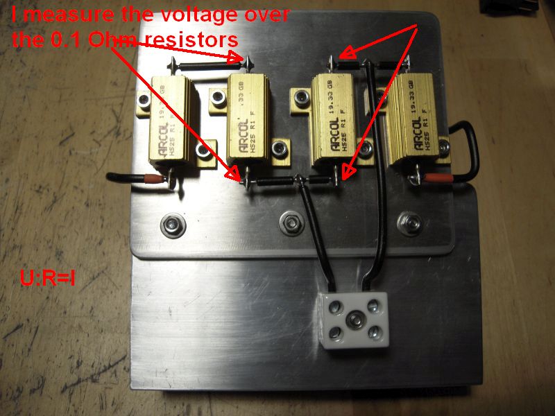

I fully agree with Ben (#1445) and also with pinholer (#1447).
I measure the current = voltage over the 0.2 Ohm resistors (I have used 4 of 0.1 Ohm).
I also made the same experience like pinholer - depending on the bias of the CCS- mosfet you can get a big 'inbalance' of voltage between the upper and the lower MosFet. 🙄
And I also made the protection - zenerdiodes onto the gates of the IXYS-Mosfets.

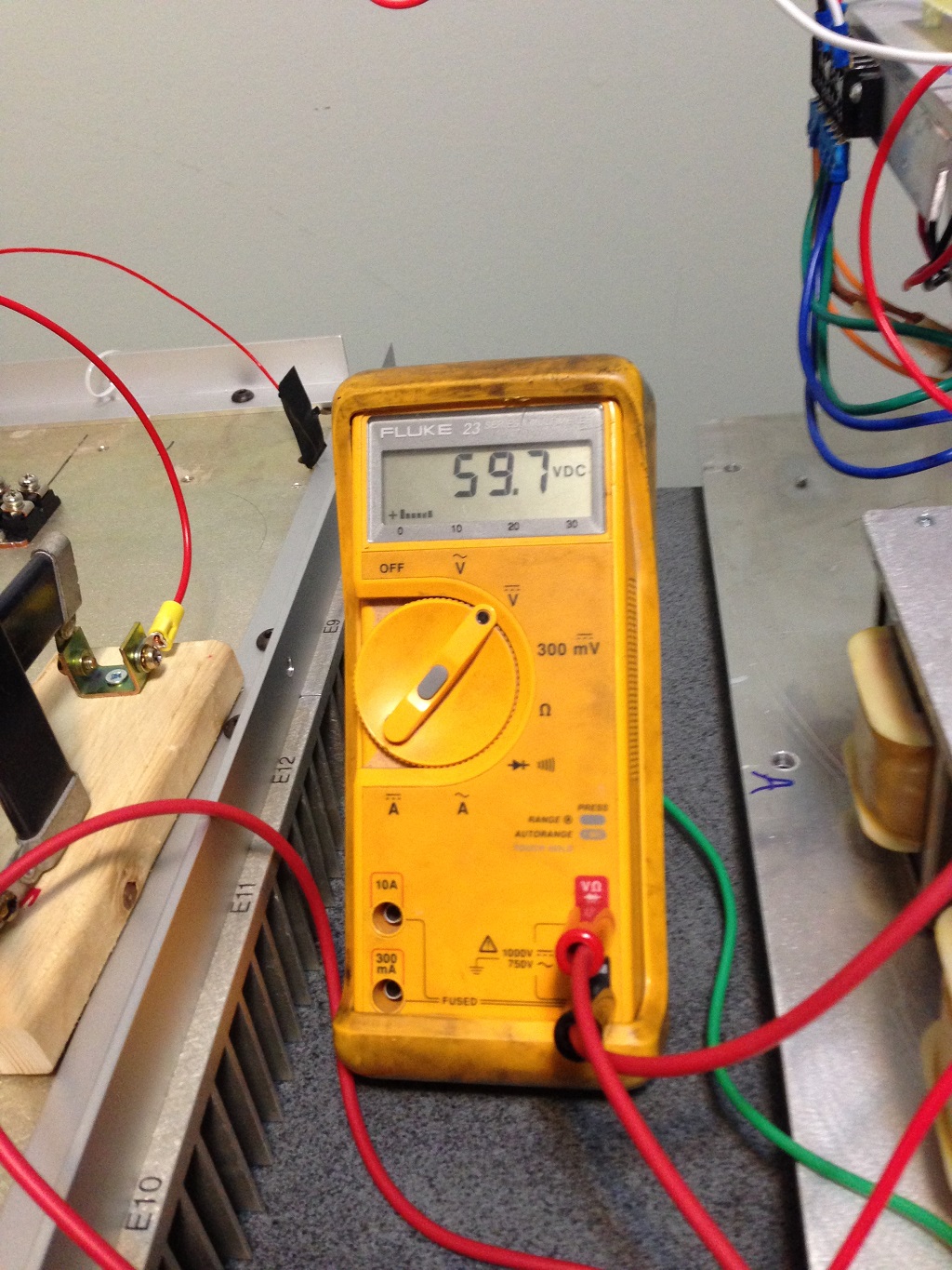

Dan 🙂
Just for fun here. In resistor test mode. Vds is 41.7Vdc and Vgs is 4.04Vdc.

I tried your suggestion but the numbers were a bit off.
Calculated R with the eight resistors is .407 Ohms.
Measured voltage drop of 1.370V/.407R gives a higher calculated current (3.366A)
than was being measured 3.250A. I suppose 100mA is an acceptable error.
I dare to say my CCS is functional and doesn't differ from Pa's original design in any meaningful way.
Dan

Installed Zener, Cap, and 4A line fuse. Didn't seem to like the cap. It wouldn't 'turn on' till I took the cap off.
One odd thing. I setup my usual test circuit with the CCS feeding the 4R0 resistor and drawing 3.2A. I jumpered out the ammeter and current immediately goes down to about 400mA. 😕
So in this particular setup the meter is a 'load' or 'resistance' as seen by the circuit.
Dan
