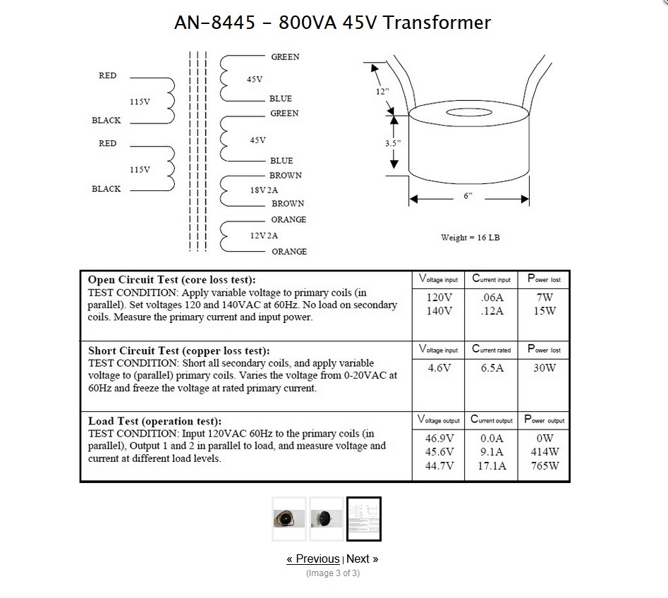

First the power supplies. First I am using two 800VA Antek 8445's as the toroids here. Here's their drawing.
attachment.php

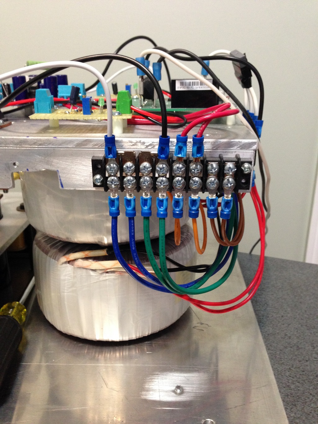

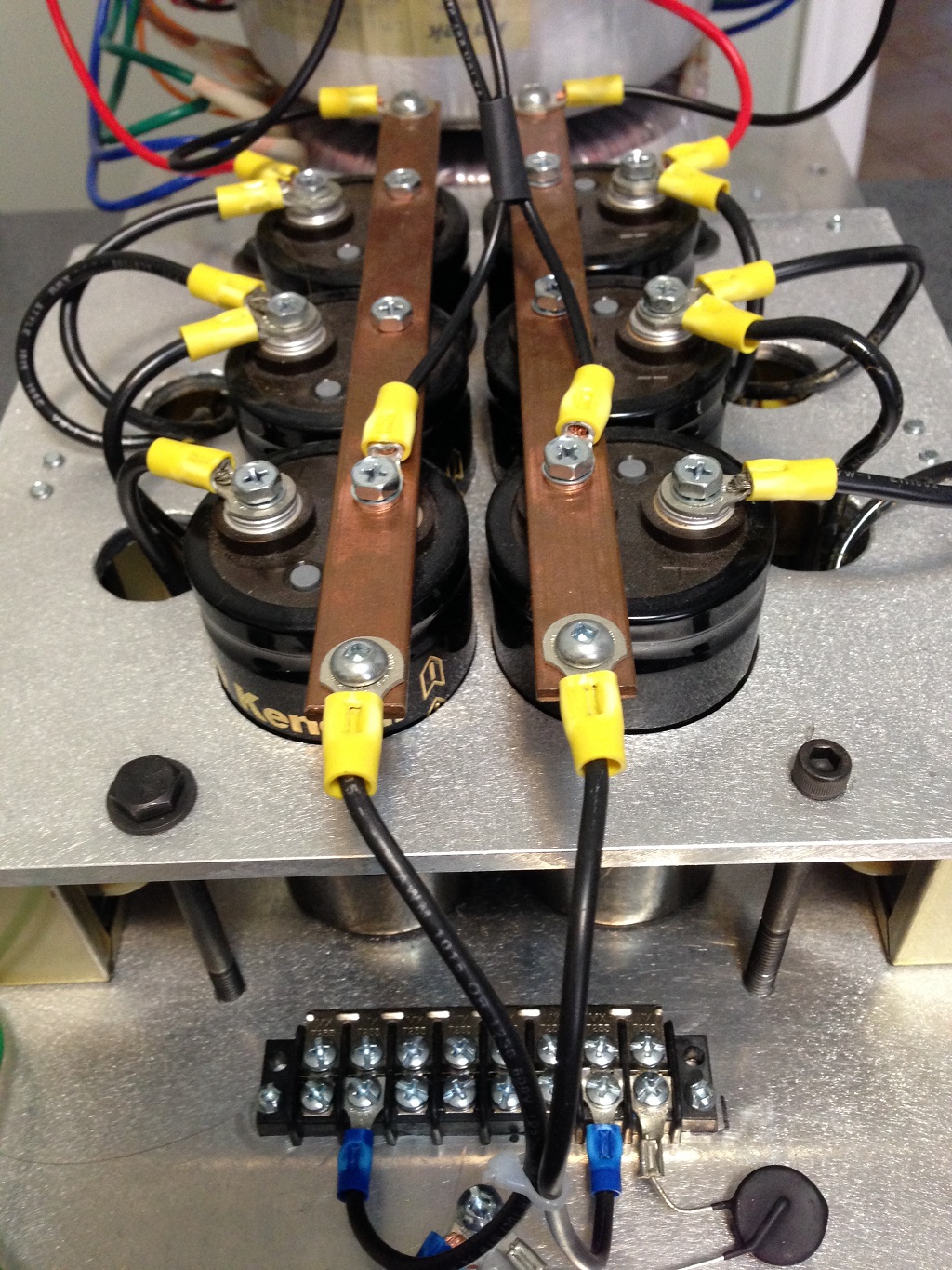

Here's a pic of the terminal strip for the secondaries. Each toroid has their own separate one.
attachment.php
With the wires detached in the picture both toroids produced the correct secondary voltages (49VAC, 19VAC, and 13VAC). As you can see the Blue/Greens are paralleled to feed each bridge rectifier.

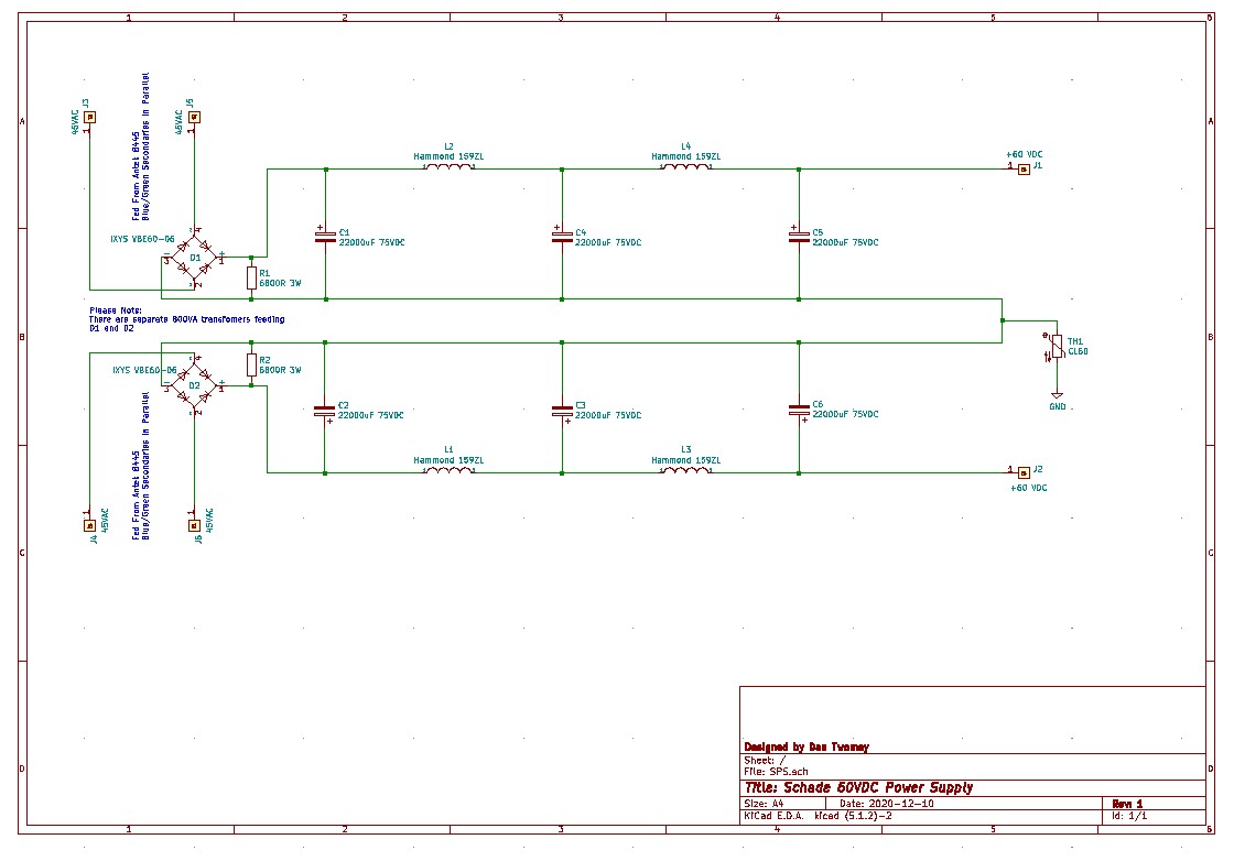

Here's a schematic of my main PS.
attachment.php
As you can see the two negatives are tied together and then tied to chassis ground through the standard CL60 thermistor.

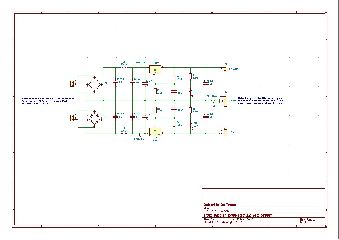

Next is the +/-12VDC supply I need for my input buffers. Here's the schematic.
attachment.php
The bipolar supply here takes it's 13VAC, one from each toroid's set of orange wires, as you can see in the pic of the terminal strip. Also, you can see that the ground (J4) is tied to the ground of the main PS.

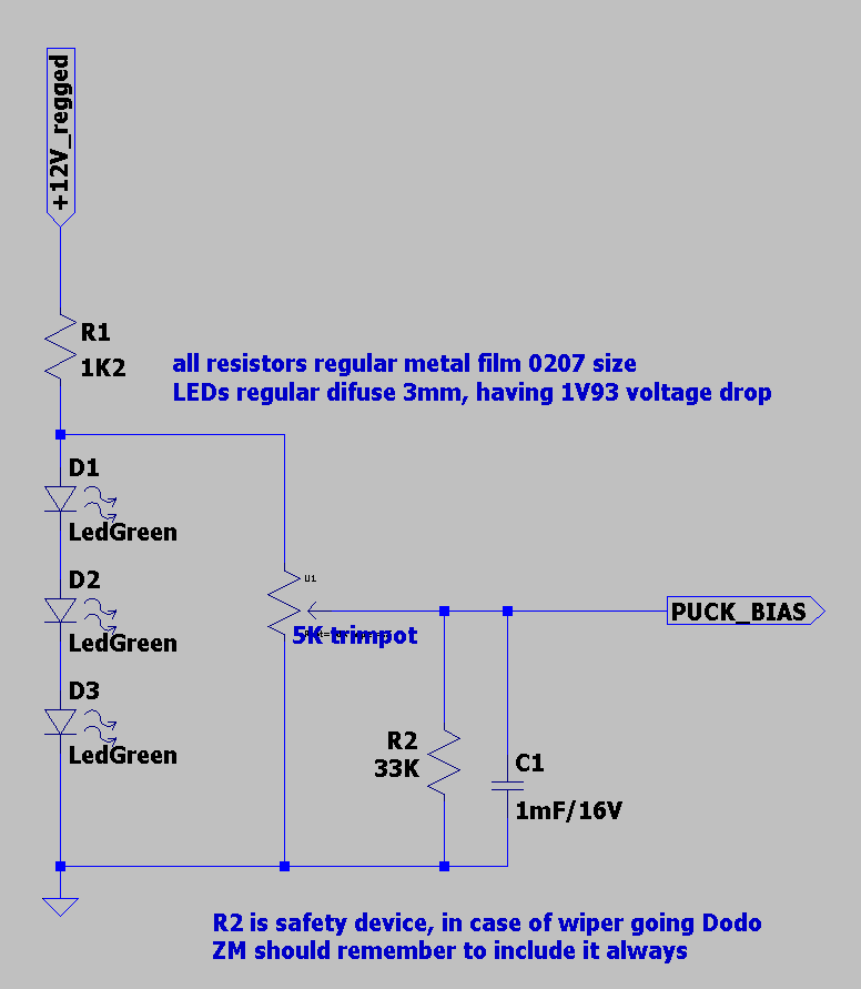

And last but not least the Great ZM's bias circuit I'm using.
attachment.php
Both separate bias circuits take their supply from the +12VDC side of the regulated bipolar supply.
So in closing of Part 1 of this post I'd like to point out that ZM's bias circuit produces a perfect and accurate range of voltages for the bias.
Also, the bipolar supply works perfectly producing a +/-12VDC.

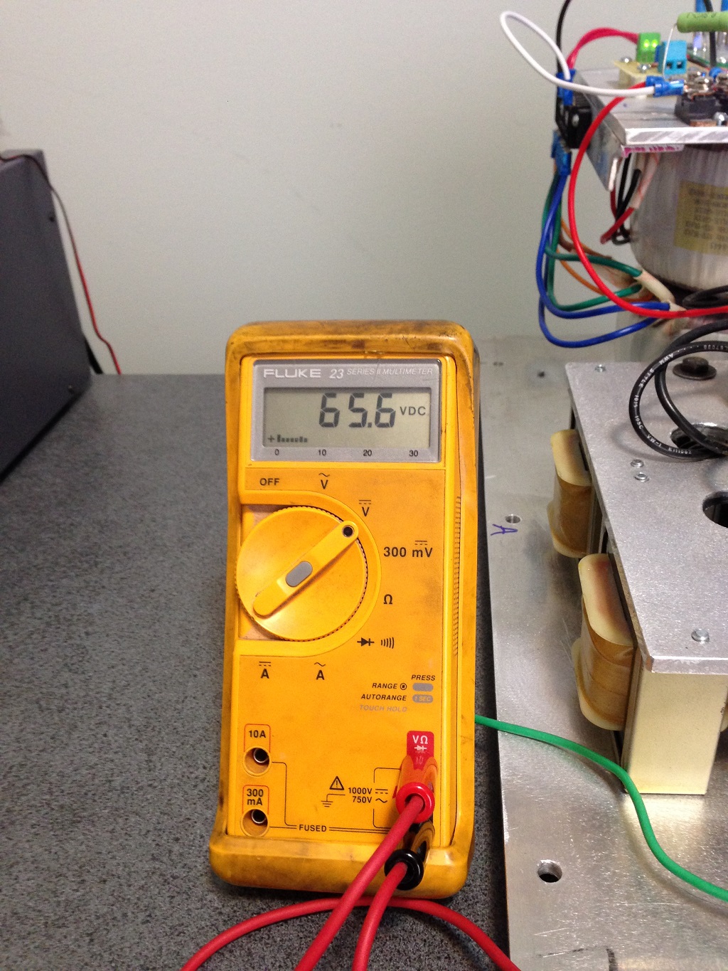

And finally, the main supply produces 65VDC unloaded as seen here.

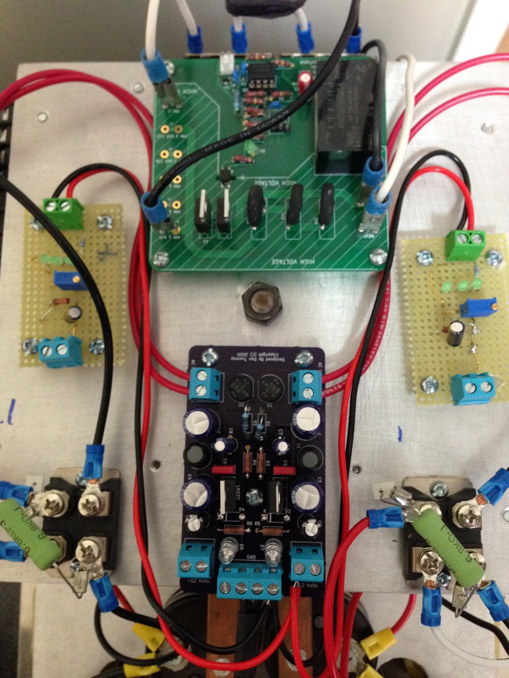

An extra pic of the top of the toroid tower! You can see ZM's bias circuits and the bipolar supply in the middle. Also viewable are the two bridge rectifiers on each corner with their bleed down resistors.

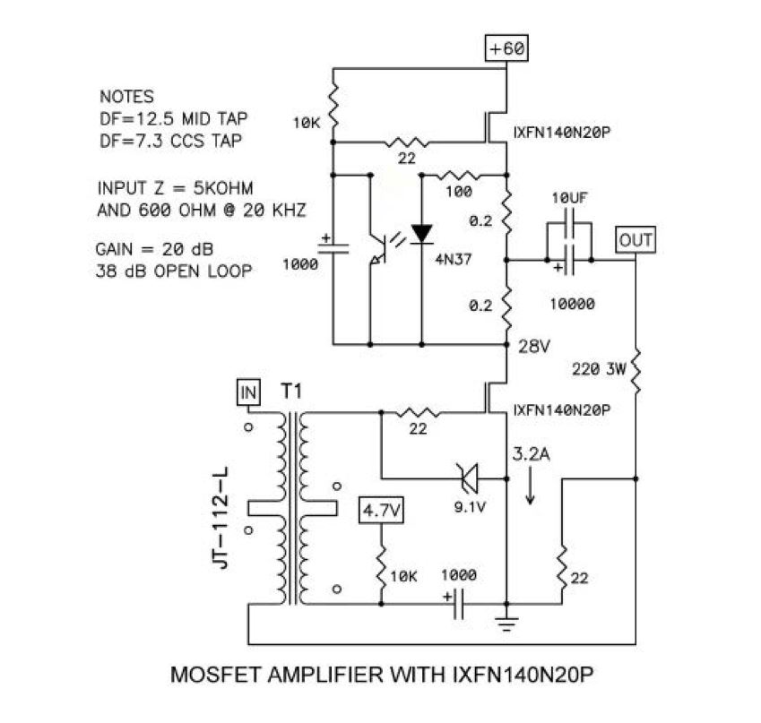

Part 2
If you refer to the original drawing here.
attachment.php

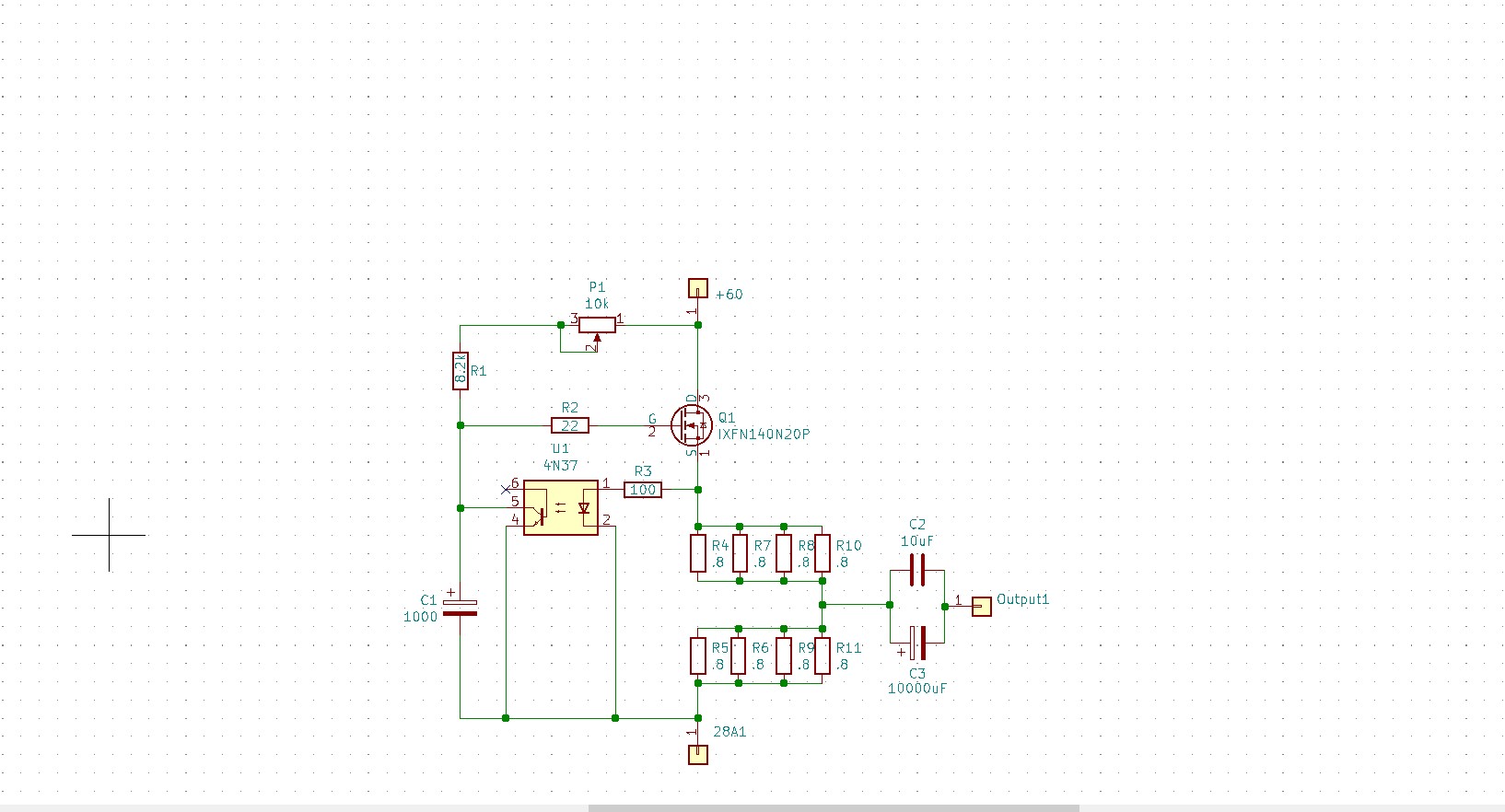

You'll see where I've taken the top half and created my own CCS.
attachment.php

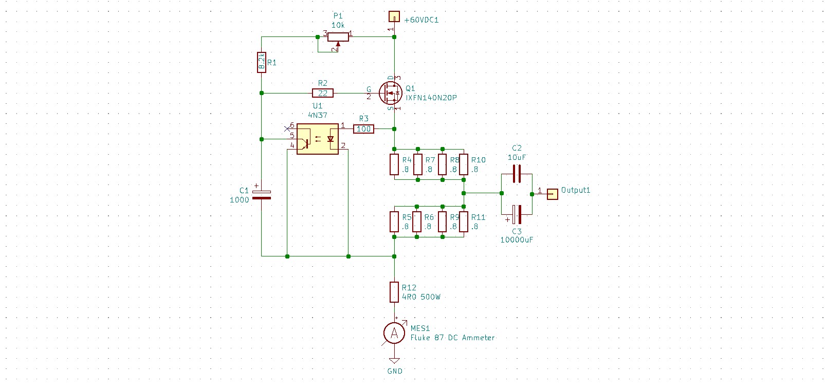

Next is a schematic of my CCS test circuit. The main power supply feeds the 'D' screw with the 60VDC and I take the output of the CCS to a 4R0 500W resistor then through my Fluke meter to ground. This test setup works perfectly with the pot adjusting current within a reasonable range. I adjust the CCS to produce 3.2 amps DC through this resistor.
attachment.php

Part 3

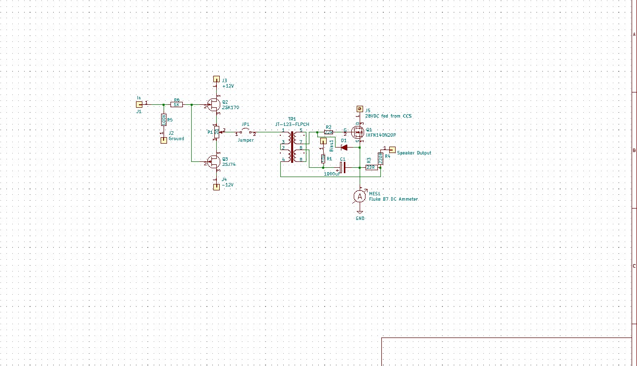

I now add the bottom half of the circuit as seen here with my Fluke meter in series to measure the current through the circuit. I adjust the bias voltage to get very close to 3.2A DC through this circuit. ZM's bias circuit seems to work perfectly adjusting the current up and down at will. The CCS is now perfectly feeding this circuit with no issues other than a little heat!
attachment.php
Dan
Part 4
Now the scary part that I've been through three times already. I get the entire circuit up and running as far as I know as it was designed to do. I get the CSS half to produce a perfect 3.2A through a test resistor before I feed the bottom half of the circuit. I connect the bottom half of the circuit to the CCS and use the bias to carefully adjust the current through the second MOSFET to the desired 3.2A. Everything looks perfect. Both MOSFETs are producing heat and all voltages check out.
Then disaster strikes. As soon as I remove the ammeter from the circuit and attach it directly to ground it instantly eats the CCS MOSFET.
Design flaw or defect? So far I'm scratching my head! 😕
