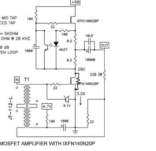

I am still using the scaled down version of the BAF Schade amp. But with regard to motorboating i think the problem remains the same for mine and the original version.
Currently i have put 10k from input to ground as suggested by Nelson. Most of the time this is working both with LuminAria and BA3 preamps. But sometimes one channel suddenly starts motorboating....especially on big changes in volume.
I find it a pity to have to add a buffer between these preamps and the BAF Schade. We should be able to control the problem without.
Nevertheless the buffer option should exist as many preamps simply would not cut it with regard to impedance.
I am puzzled by the discussion about DC flowing through the secondary of the input transformer. As far as I can see for this circuit there would only be 0.47 ma which is not exactly huge.
Am I missing something?

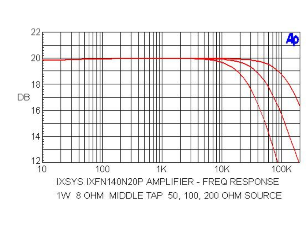

What if you lowered the input resistor to 9k?
Since i have built versions with very different mosfets i came to the conclusion that the motorboating problem is more likely to occur with high transconductance devices. Maybe i am wrong...(and it was just coincidence)
But in any case it is probably advisable to build something that is stable, particularly if you build a 50 watt version...
When motorboating occurs this might damage your speakers. Even with my low power version that idles at only 1.2 amps the peerless woofer on the Boenicke W5 clones moves +- maximum (more than 1cm excursion).
Of course we can lower the resistor value but i do not feel totally at ease with it.
ray
Depends. What circuit are you talking about? If you're talking about the original unbuffered BAF amp, that's not why I asked the question.
And I was asking about the primary.

Do you remember Papa write us about 220R 10 watts resistor if needed.Since i have built versions with very different mosfets i came to the conclusion that the motorboating problem is more likely to occur with high transconductance devices. Maybe i am wrong...(and it was just coincidence)

If it's not stable enough you can put a 5 or 10 watt 220 ohm
resistor from Drain to Source to stabilize it better. I don't think you need
the complexity of a servo.
Where does the 220 ohm stabilizer resistor go?
Does it connect like the attached pic?
thanks,
Vince
That will do it. If your supply is quiet, you can also do D-S
on the current source (gives more bias instead of subtracting
some bias).
