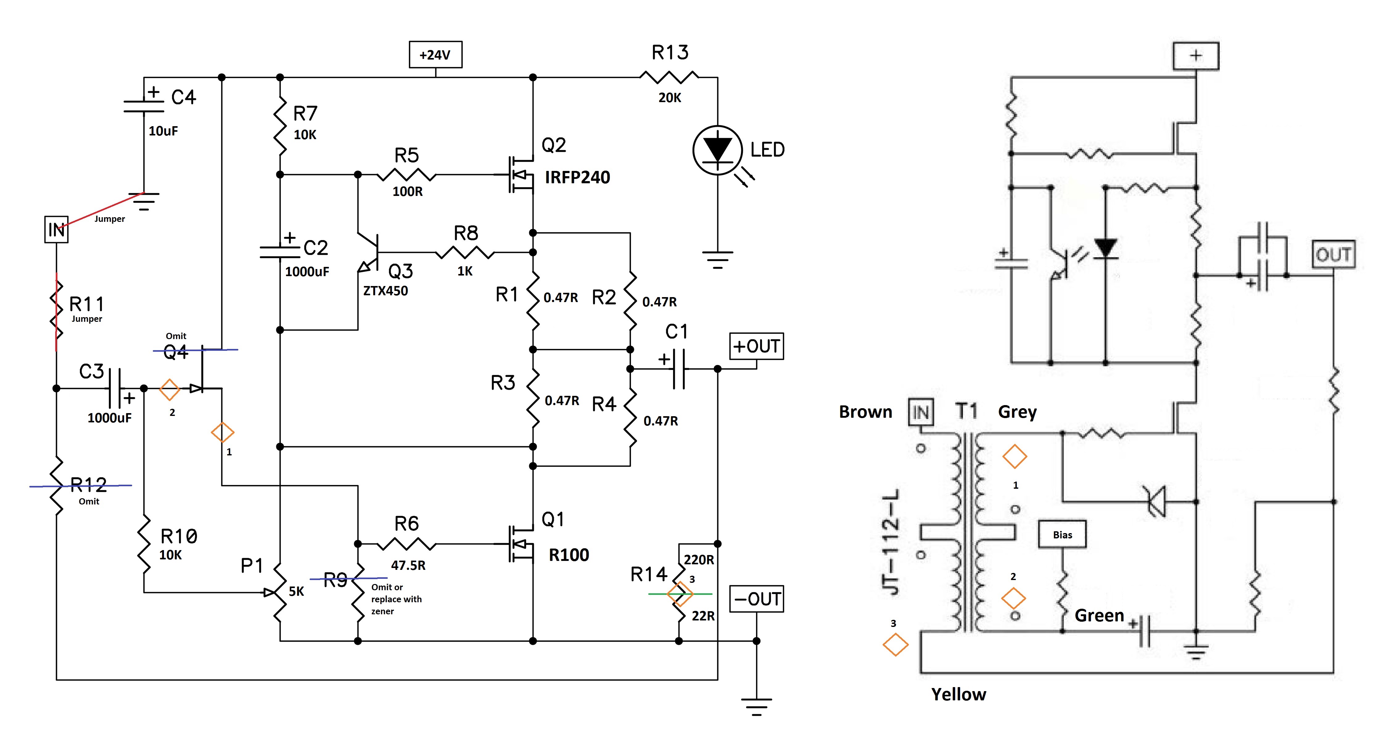

Here is a scaled down version of the 50w Schade circuit. I built it into a pair of ACA chassis using the ACA boards and a Semisouth R100 for Q1. It runs about 1.2A bias at 24V. I don't have a distortion analyzer so I cant provide those numbers, but it does sound nice.
The ACA circuit and board must be modified by omitting Q4, R9, R12, and R15. Jumpers must be installed across R11 and from In to Ground. R14 must be replaced by the two feedback resistors standing vertically off the board.

Take it you didn't use the opto-coupler?
Did you have to change R1 & 3?
Nope, no opto-coupler. The ACA circuit does the same basic thing though.
Didn't have to change any of R1-4. In fact I built it with the standard ACA values there first. Sounded fine. I only changed them to bump up the bias a bit without resorting to R15 and to tap the actual midpoint.
The circuit is quite flexible and will work nicely with many options for Q1 that can plug right in. IRFP240 included. For those who want more power the ACA board should bolt right into the larger deluxe chassis in the store. That would allow much more voltage and bias.
