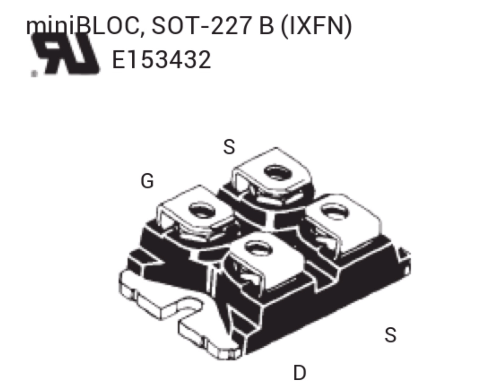

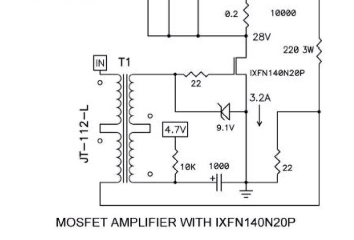

I have a question about the IXFK 120N20P. Is the tab insulated or is it the drain. The datasheet has confused me.

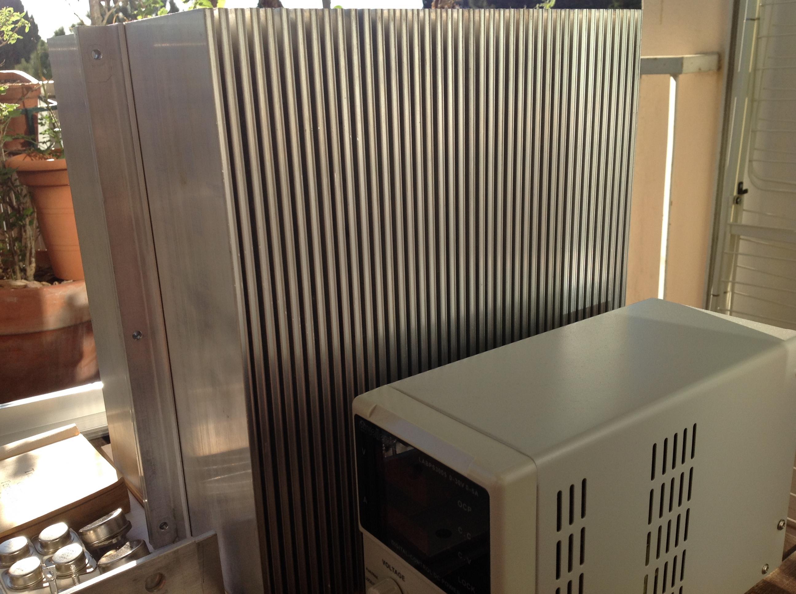

I'm in the process of testing my first prototype, but the heatsink is getting to hot and affecting the voltage readings. A household fan is helping to keep it cool at the moment.😱

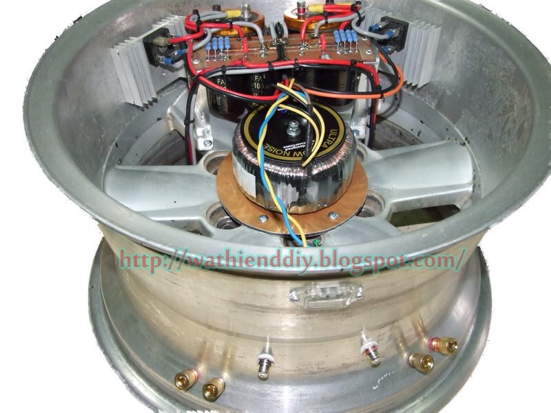

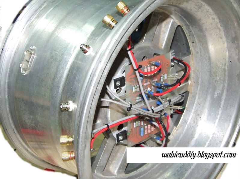

I get by chance some big heatsinks to experiment but it's not that fearless " car style " class A build by great Diyer 😀

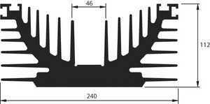

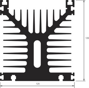

The heatsinks I am using came from a computer UPS power supply and I thought they would keep the two mosfets cool enough without any fans.
It seems the 10K resistor and 1000uf cap on the bias supply make it very slow to react to changes, so bear that in mind.
Those heatsinks of yours look good, any spares ?

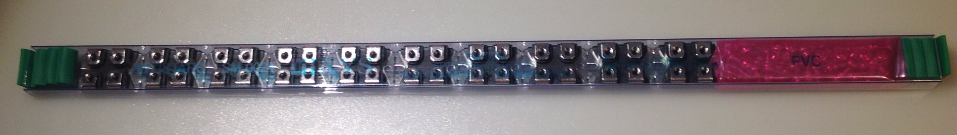

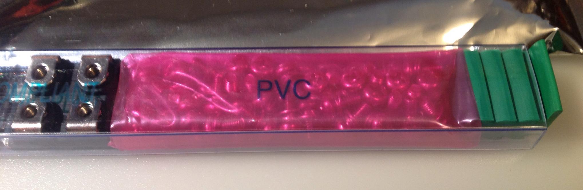

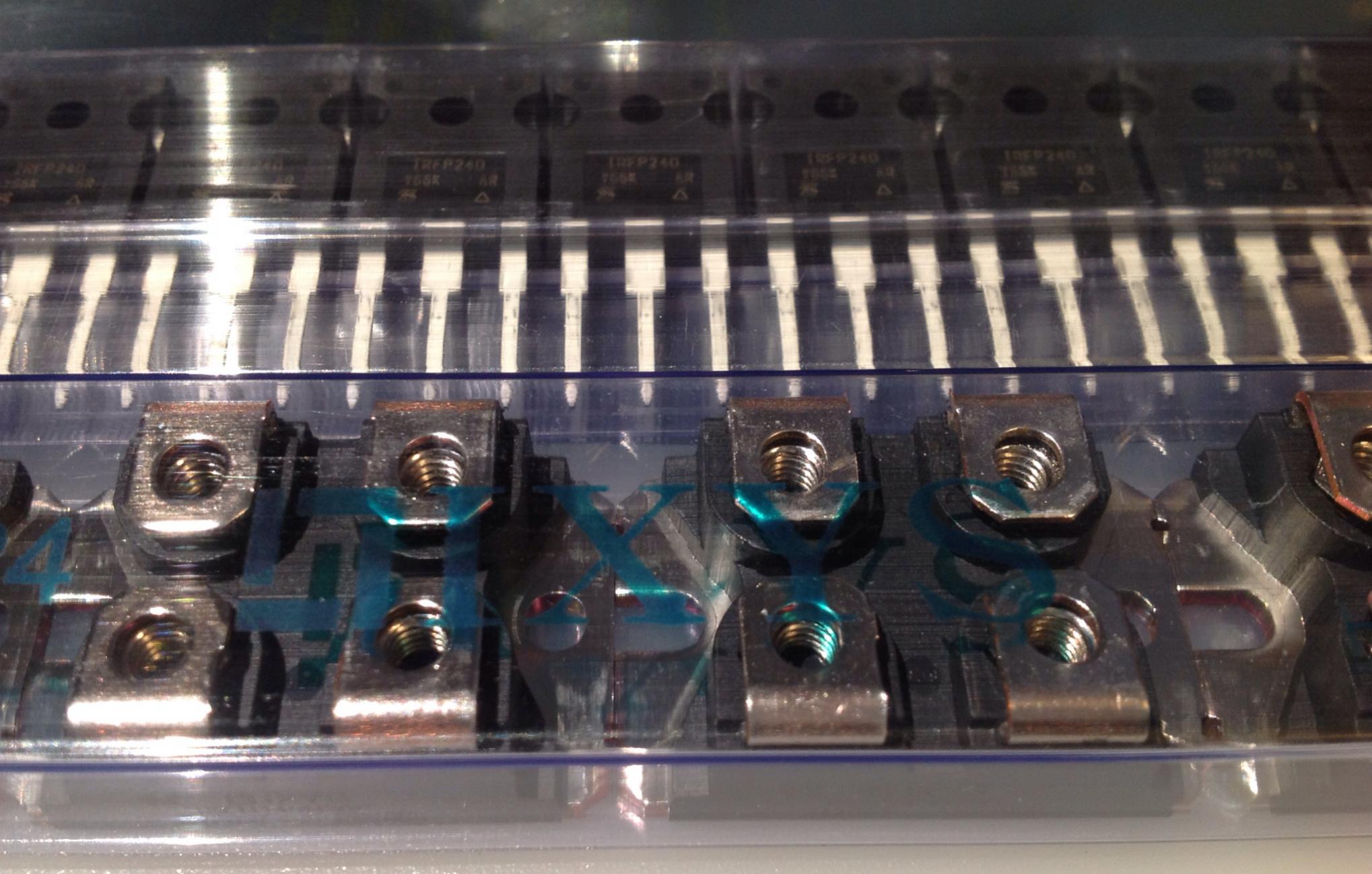

Share my joy of received IXYS today
They are example of spectacular quality made semi's.
Vive le Papa Diy !
