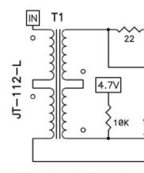

My first prototype is up and running.😀
I had tried to get it all on one breadboard, but on first test the input transformer was picking up hum.
So, I now have the power supply on one (the original) board, and the circuit + heatsink + input transformer on the new board.
Setting up the bias needs a steady hand on the adjuster pot, but 4.64v is the setting right now.The test voltage takes a while to stabalise, so only adjust the bias in small steps and wait till the test voltage stabilises,it can take several minutes. 4.7v is a good starting point.
Sound quality in mono with an old speaker seems very good, and can't wait to get the second unit finished and listen in stereo.

My input transformer primary and secondary winding have 4 market dots like on schematic.
Think i do connect them that way.

Do your heat sink run burning hot
Do your heat sink run burning hot?
Not at all with my computer fans running.😀
Without the fans as the heatsinks got hotter I found the bias kept needed adjusting to compensate, so I thought fans were a better option.
Ok thanks Pre65
guess with 3.2A my heat sinks are not over sized.

I would use SMPS definately. This is single-ended class A. Current is constant from power supply.
The schematics I have seen here have a variable current source, so actually
the draw is only constant on average. The draw will vary temporarily
from 0 to about 2X bias current, depending on the "gain" of the current
source.
This means that your SMPS needs to be rated more than twice the bias.
You can fix this by using a constant current source, but you get an efficiency
and performance hit.
