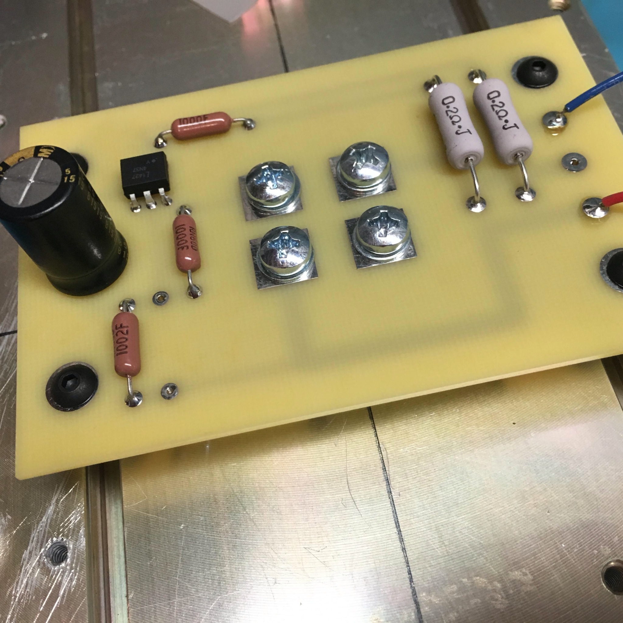

Are the .2 ohm resistors 3w power resistors? I'm only assuming because of the resistance value.

@ Vince
Mr Rothacher CCS circuit photo show power ones.

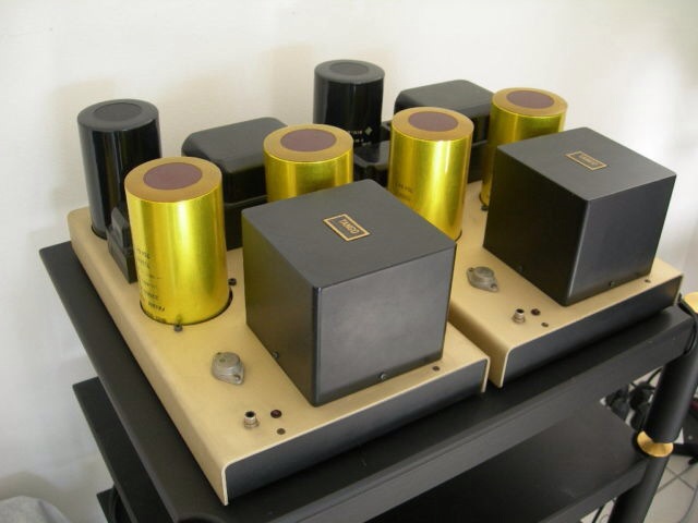

Last days i was lucky to afford 2 caps like big can's 100 000 uF , rated max 80 V.
After add them with other smaller ones for total capacity around 200 000 uF each channel.
They are in customs now hope get them at my home next week.

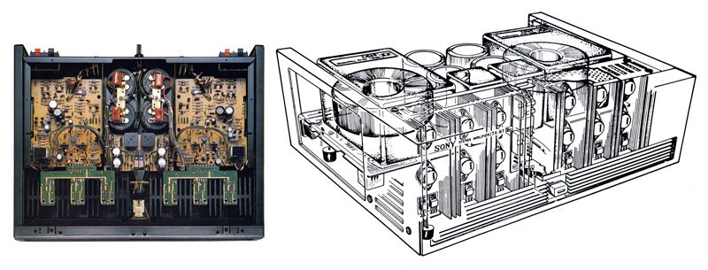

Better bass and fortissimo garantie with single-ended amp
On the photos Hiraga's with one power transistor...my suggestion but with lot of heat sinks
Awesome. I've a set of 8 100000uf 30V caps here that I intended for a Pass amp at some juncture. Theyre just a bit too huge to fit in anything!
Smaller caps first + one 100 000 uF for each channel is always too huge for your chassais ?
I'll post a picture later on. They're big. I reckon it'd look like a small motor block if I used the lot.
That said I've no idea what the physical size of a 80V 100000uF cap is! That'd be a whopper I imagine...

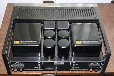

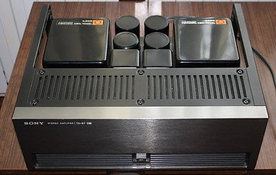

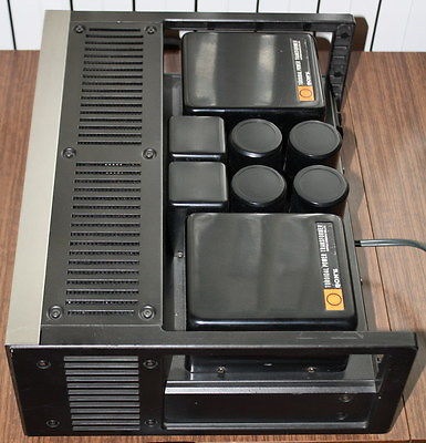

Sony Vfet Amp is it? Nice.
Yes is Vfet amp from Sony TA-N7.
High build quality we can transpose to Schade 50W

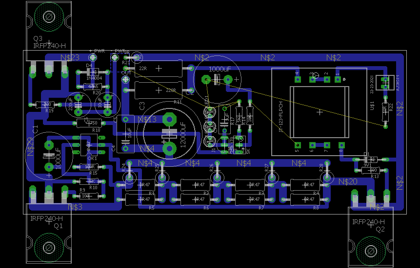

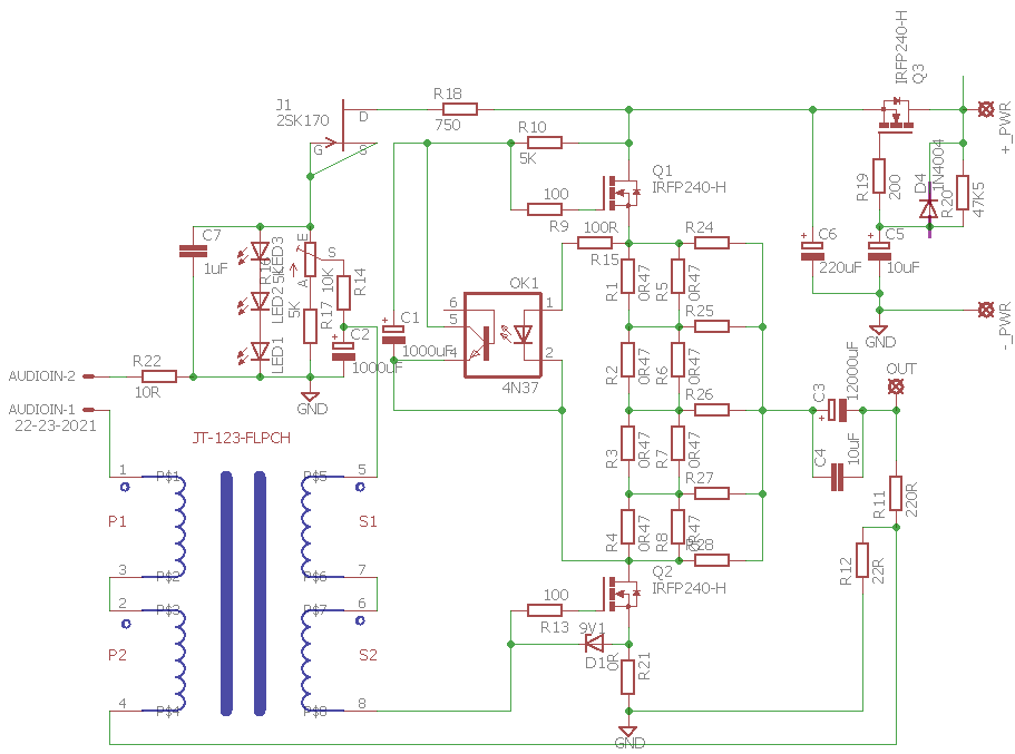

PCB
PCB, where I kinda stopped - basically a one sided design - I reckon I can improve it quite a bit by two siding it.
Comments welcome!
I did go to the point of matching it (i think) to the ums spec at some point, just for learning. Not sure if this board is that, but it's easy enough to do.
Note, I also included a circuit for the bias, and for a reg to feed the amp itself.
edit - the resistors r24 -28 are intended as jumpers to set the mu level
Comments welcome!
