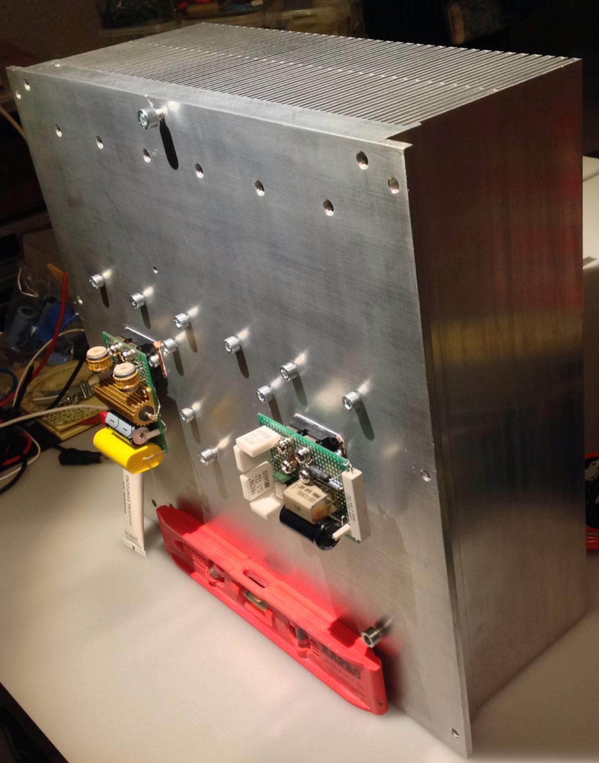

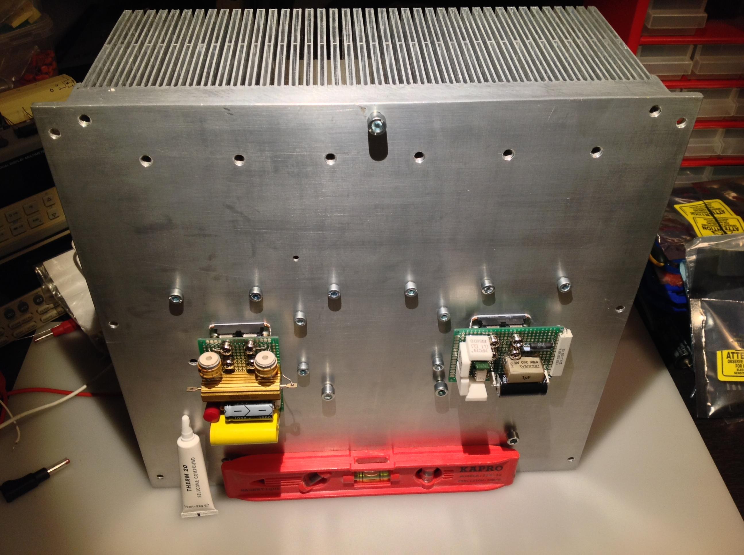

Nice heatsink you got there
33 lbs = 15 kg of weight one piece.
Hope try with them powerful Tokin SIT´s
Greetings 🙂
impressive 🙂
though ..... you'll need two of these books ......... one under each heatsink , with pages constantly flapping , to push some forced air through fins , simply because those heatsinks are made for that 🙂
only in case that heatsinks are soooo big , their loss of efficiency in natural air flow conditions could be still irrelevant
Hope that's the case here , easy to check with temp. thingy
Thanks Zen Mod
Keep a large comfortable open space and distance from the floor make breath the two heat sink's in the natural convection way.
Hot air particles " jumping " always up and we get moving them all the time.
With fans is more efficient, but silence is the best music friend.
I am confident about capability, but I do temperature test.
It's " never too much heat sinks " example for sure.

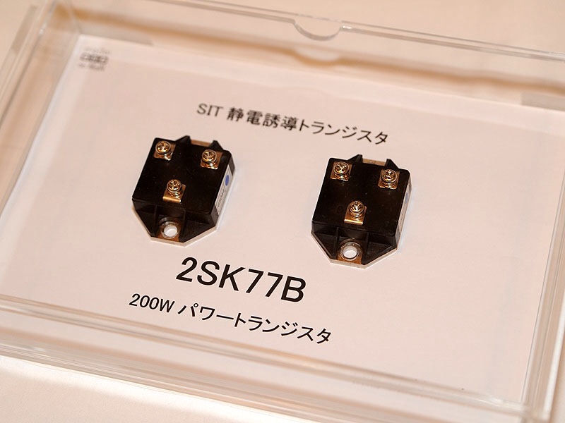

Schade 50 are simulation of Digital-Do-Main 2SK77B.
Please any news , article or audio show from busy Mr Pass about this triode semiconductor amp in the future ?

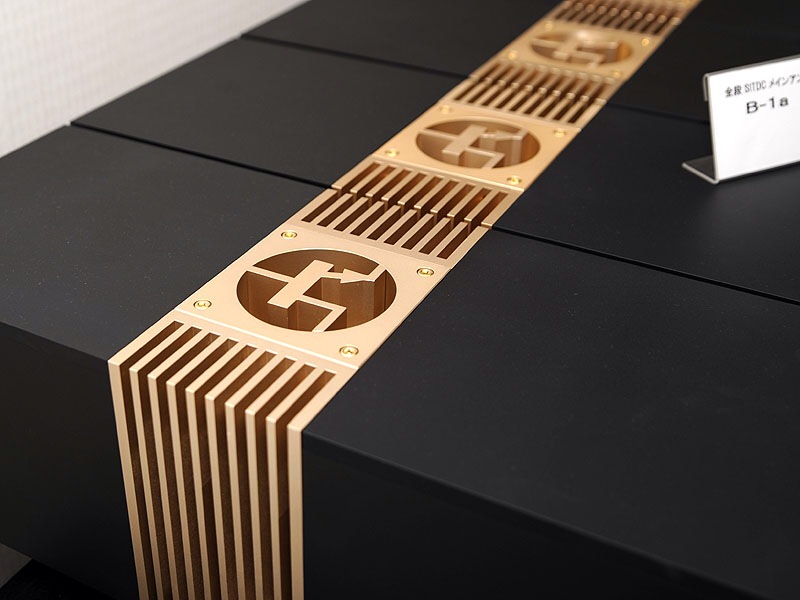

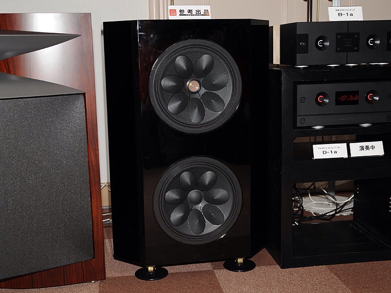

Happy , can you post link to origin of these pics ?
just curious about their plans of re-producing these gorgeous drivers
Hi Mighty
Oops,sorry I don't save any Digital-Do-Main links for this audio product show, was happening in Japan.
Start with research: Digital do MaiN - Wikipedia
I am curious too , such exotic drivers
RCA LC1B
, though I think these on do-main pics are further customized , besides fact that lower ones are working as bass only
RCA LC1B, though I think these on do-main pics are further customized , besides fact that lower ones are working as bass only

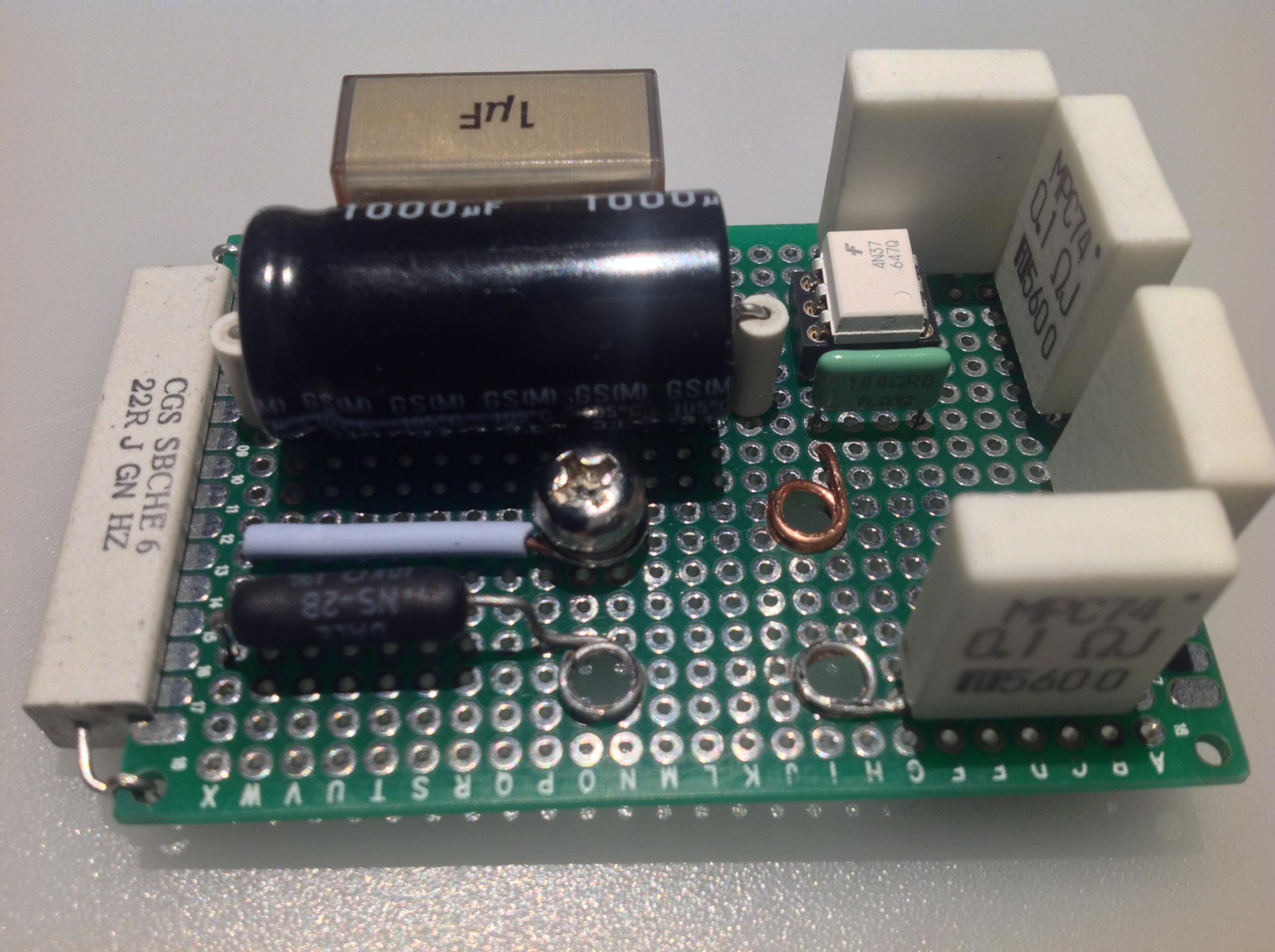

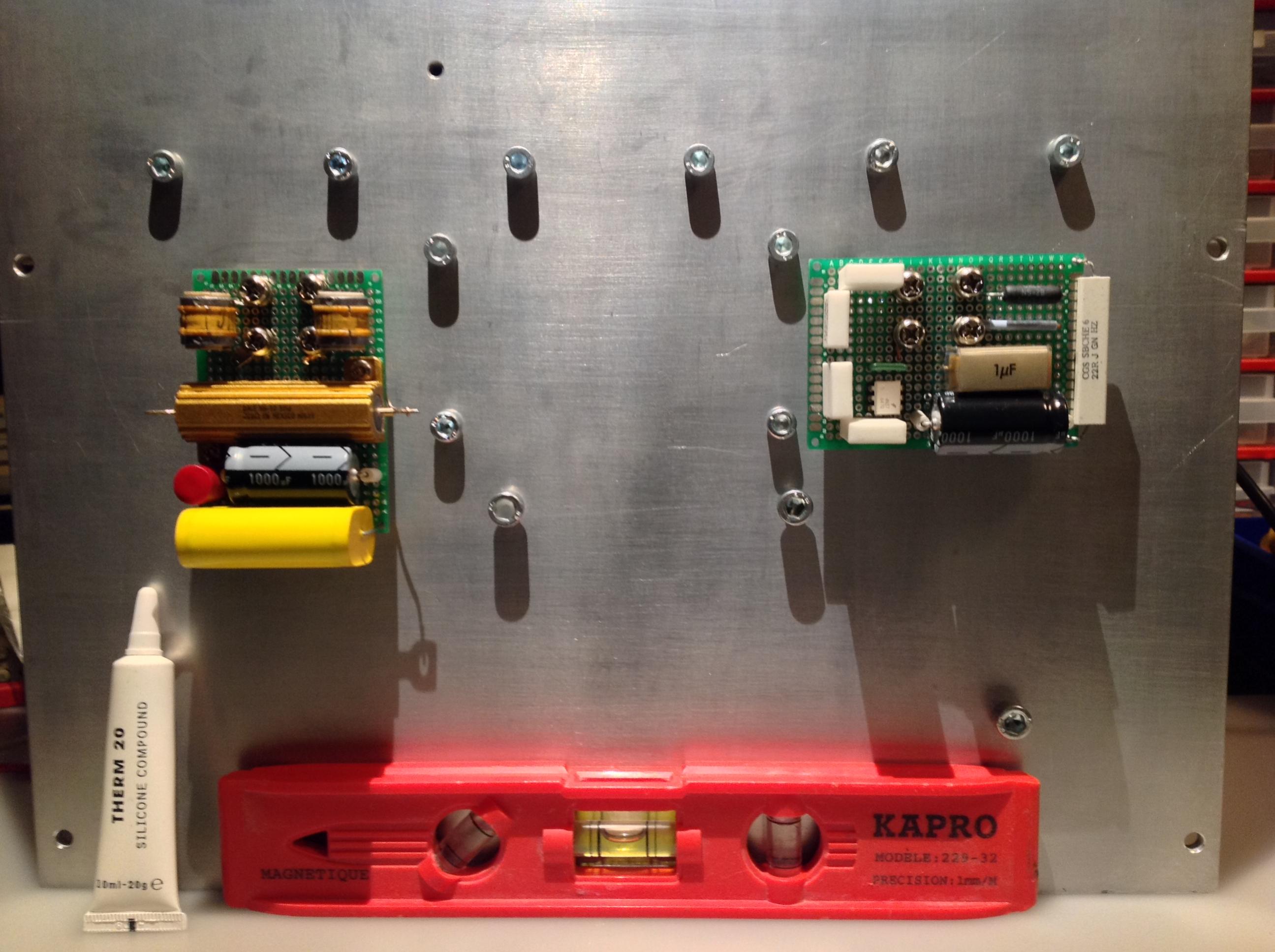

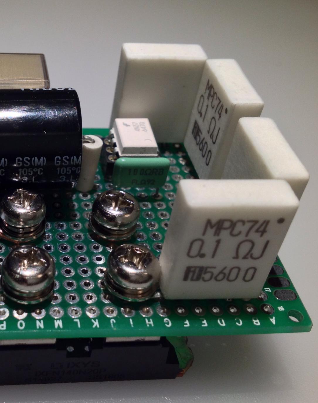

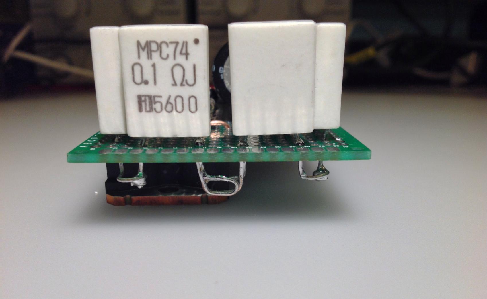

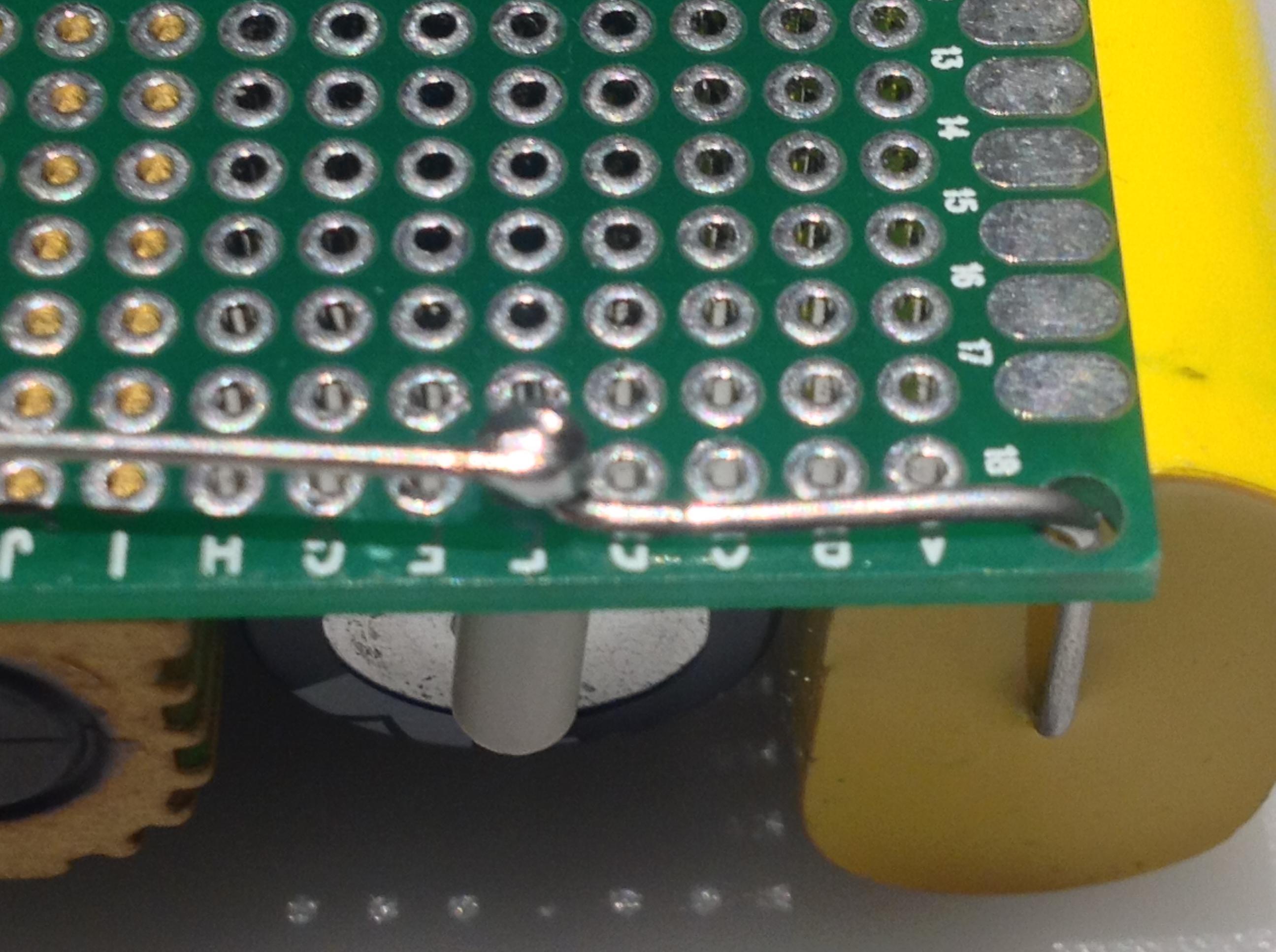

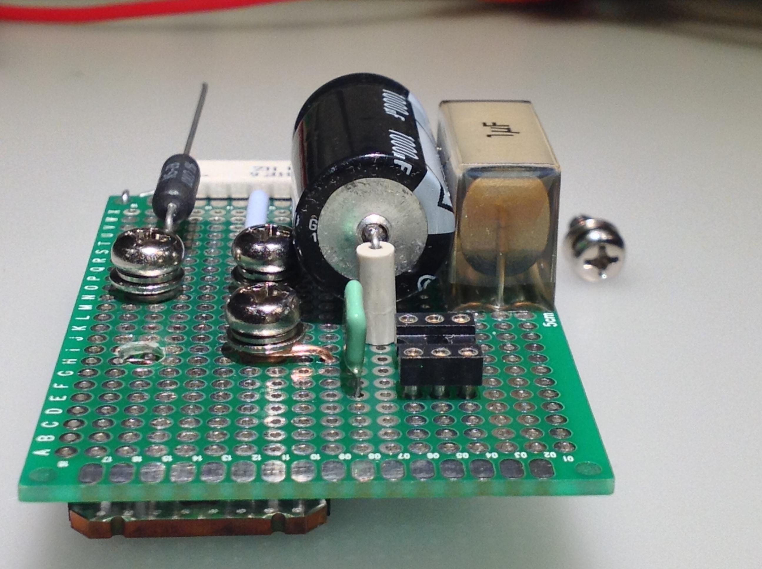

Audio signal board prototype with CCS on the heat sink, all connections are point-to-point 😀
looking good
though , slightly too clean environment
Thanks Vdi_N and ZM is worth of the good time on work bench.

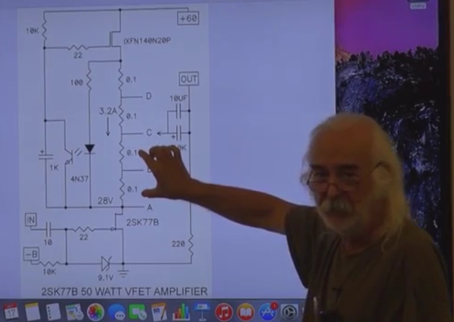

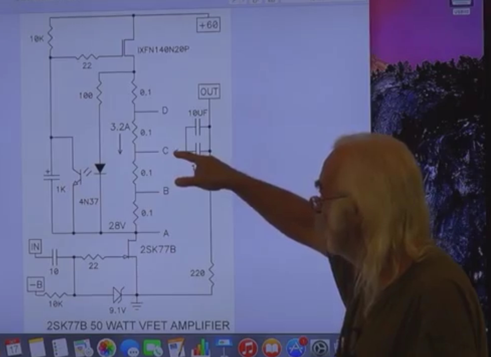

Mr. Nelson Pass at BAF 2015
Me watch again Papa video about 2SK77B amp & his simulation with IXFN
- 50w Single-Ended BAF2015 Schade Enabled
