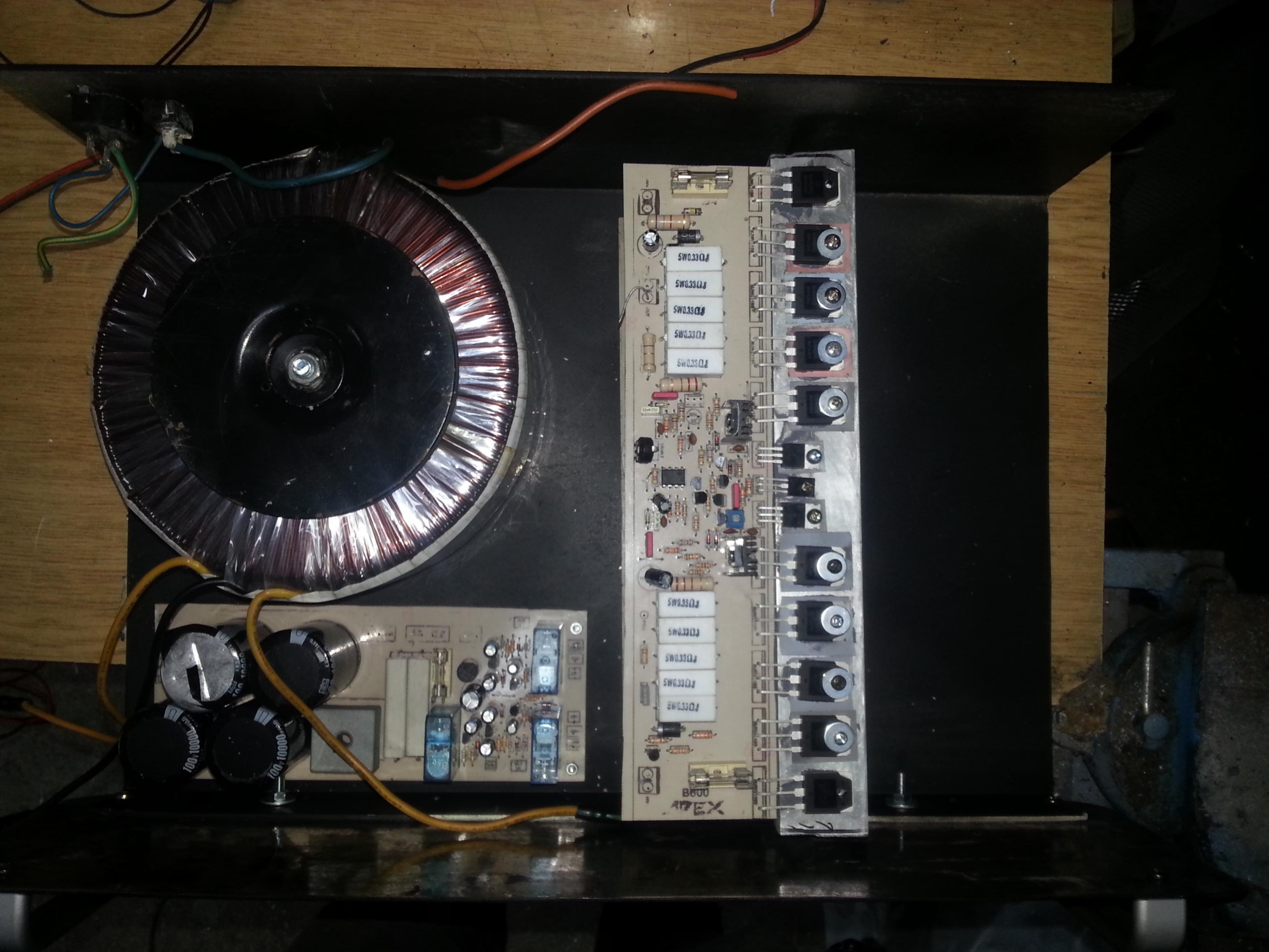

500W PA amplifier with Limiter
sir my amplifier has output when i test with multitester but when i load 3 speakers it will drop and no audio output,, where is the trouble for this amplifier sir,, good pm....
what are the impedances of the 3 speakers?
assuming they are 8 ohms, when paralleled, it is equivalent to 2.67 ohms. this amp is not designed to run at this very low impedance, so probably the over-current protect triggered the audio cut-off.

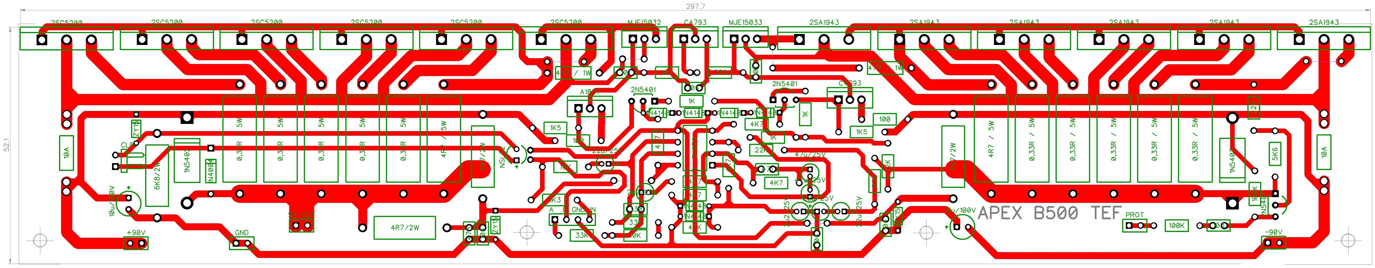

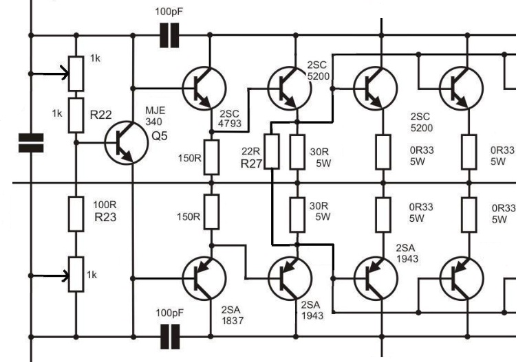

B500 TEF
Dear Mr Mile,
I redrew your APEX B500 layout and make it according to your TEF schematic design.
Whether this layout is correct?
For power supply I use 65-0-65 vac.
Is it safe to operate in 2X65vac ct with 6 pairs of 2SC5200&2SA1943?

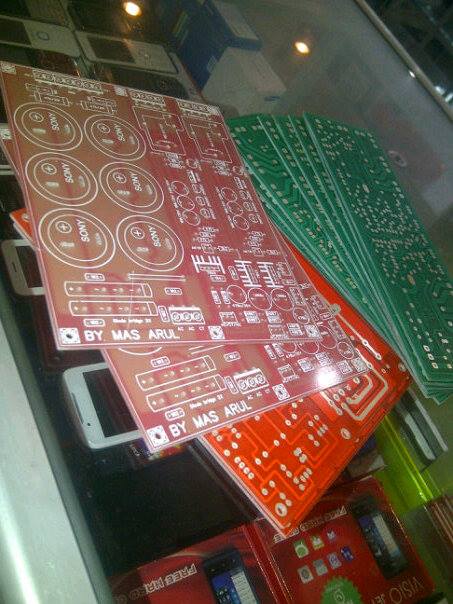

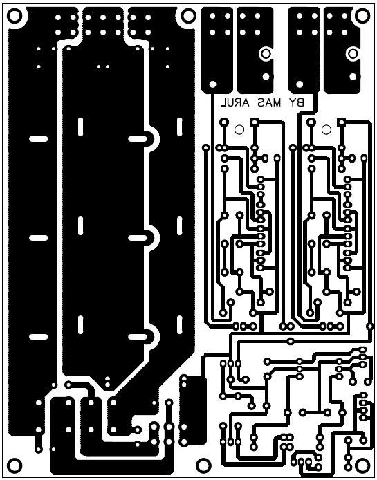

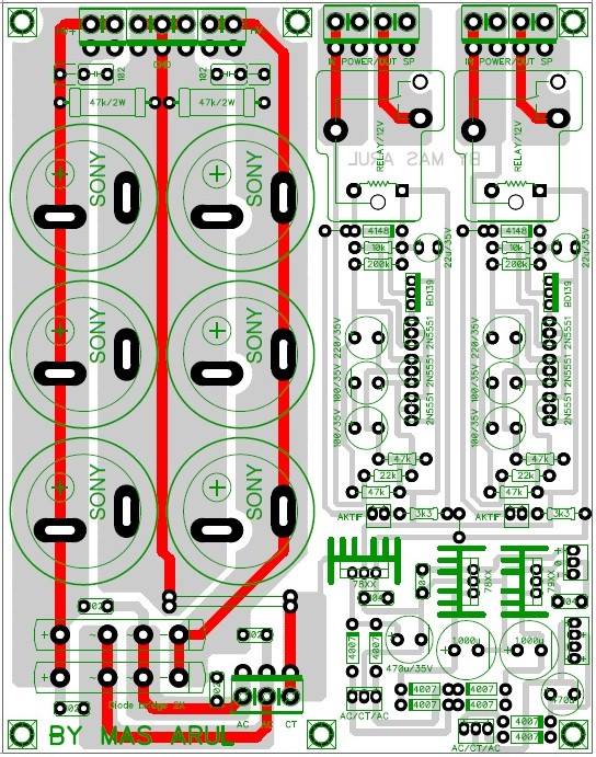

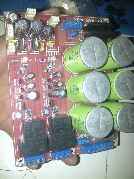

ab class psu
