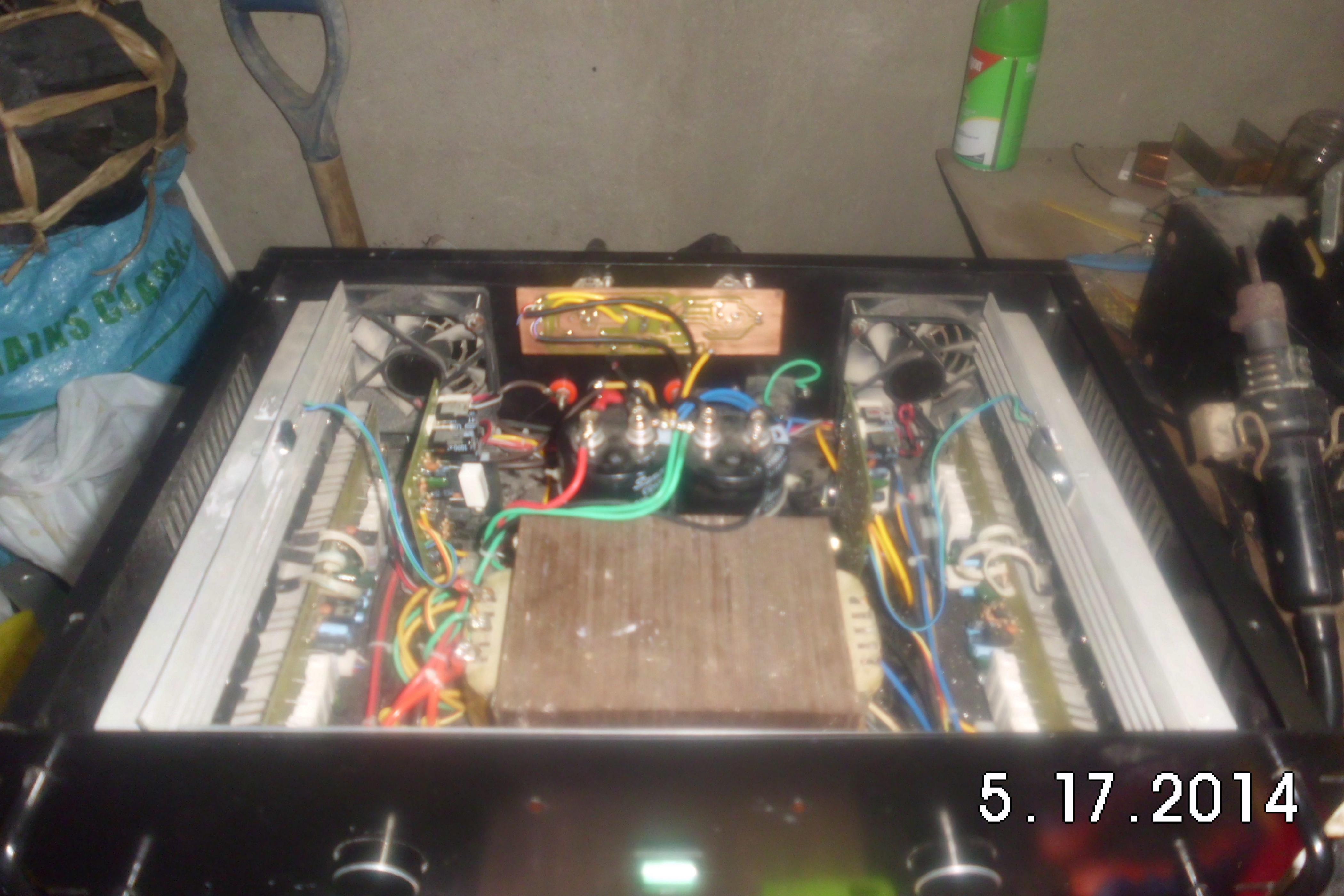

how can i post picture in here. i've already finished my b500 but i cannot post pictures
you can post pictures by uploading your pictures from your harddrive to our server...
you can click the box at the lower left side, "post reply" then "attach files" then select your pictures into the pop up window, click upload pictures and wait to complete...

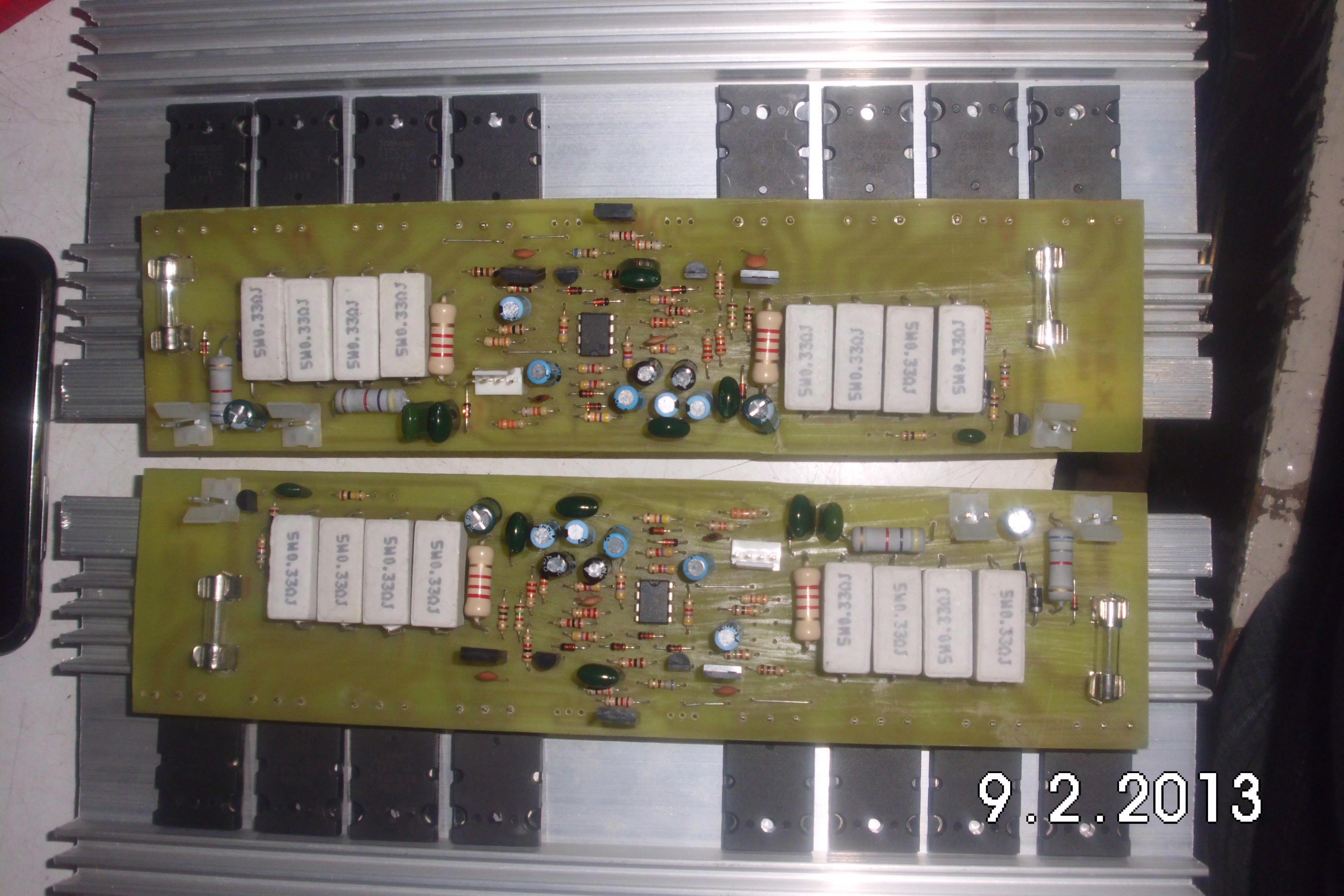

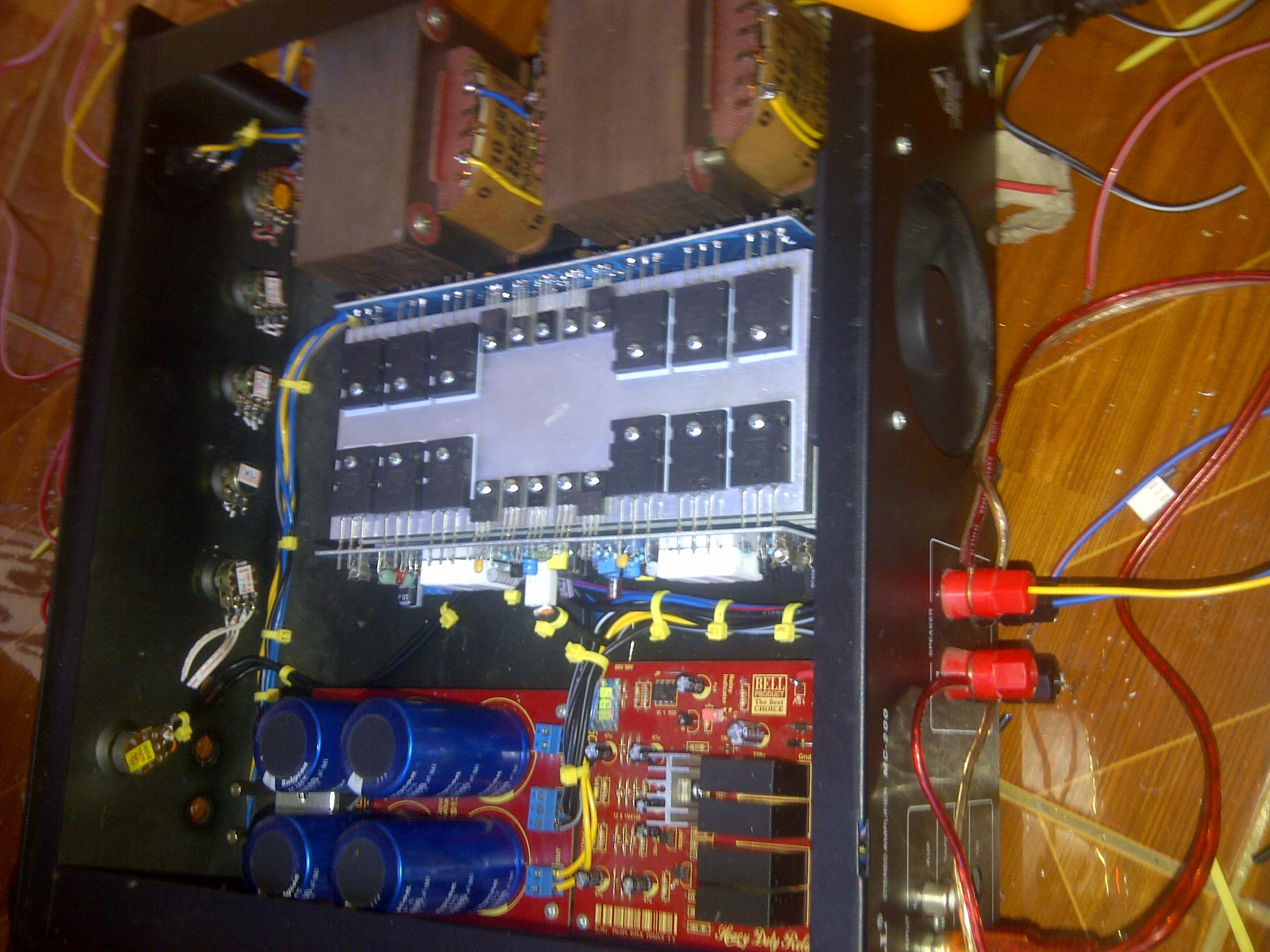

i have finished the two amps.1 question is,when i bridge the two amp using the circuit given in bridging,all the transistor in the 2nd amp got busted then my speaker smoke.what could be the problem here?

1. what is the impedance of the connected speaker and its corresponding wattage?
2. what is the voltage of rails?
3. what is the fuse amperage?

8 ohms 200 watts. +/- 70 rails,10 ampere fuse each rail.

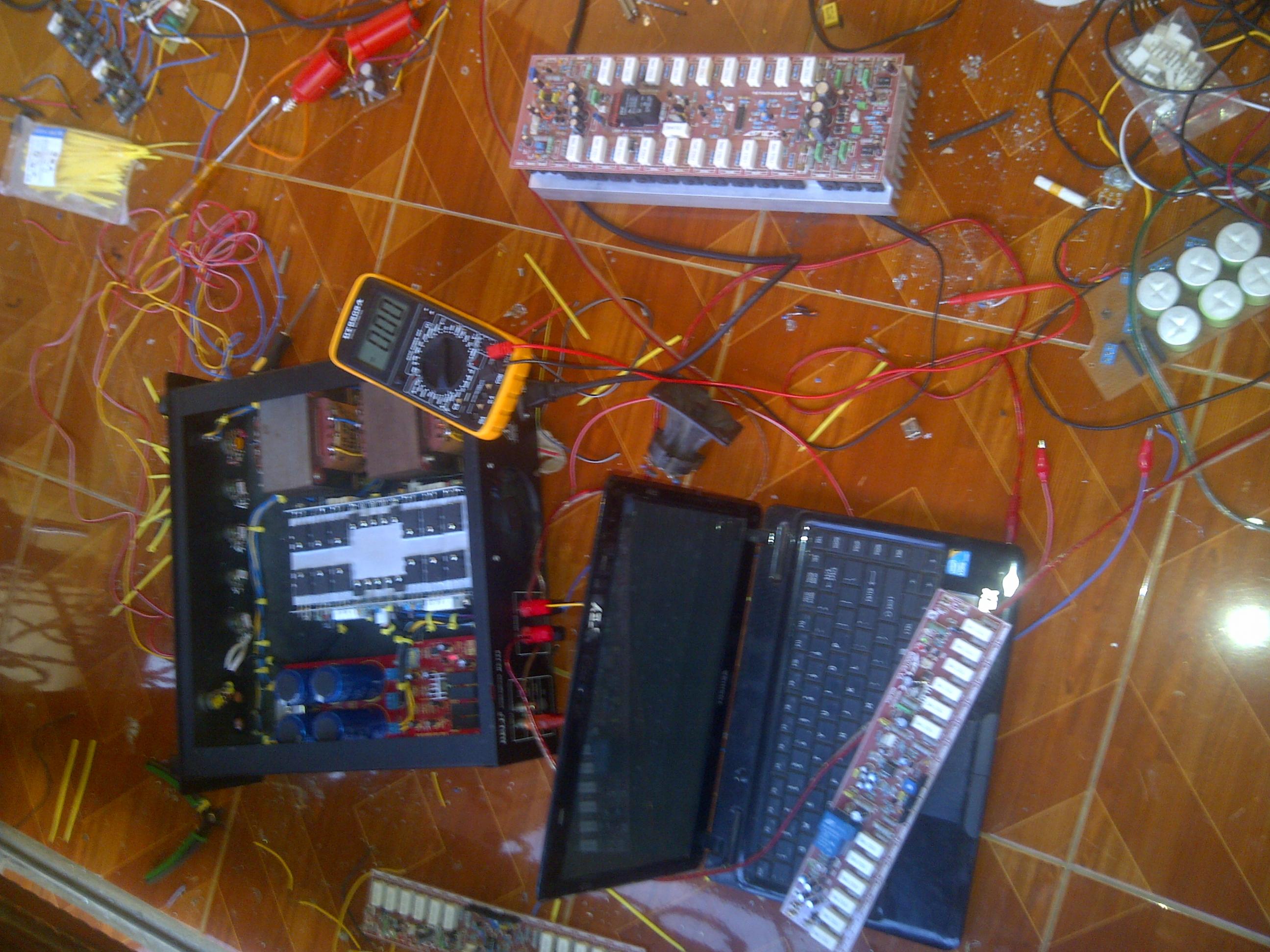

now i'm afraid to try it again.how can i test it without damaging my spkr?
you complete all your testing BEFORE you connect a speaker.
You soak test your new tested amplifier BEFORE connecting an expensive speaker.

Rails at +/-70 could be the allowable max. When the rails sag due to load, you will get around 900 watts for bridging theoritically.
Is your speaker rated above 900 watts? It is also possible that your power transistors are fake... In cebu, they sale fakes. When i buy i checked the markings. Fake ones have faded and fatter letter markings. Original have sharp, clear, and thinner markings...
Also for testing, it advisable to use bulb in series with the transformer primary winding.

did you abuse your speakers?
your output trannies smoked when your speakers fried....
did you do idle current testing? how about output offset voltages? what were they?

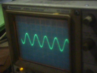

pls elaborate what is a soak test?
using a dummy load and a signal generator
you can run your amp at various power levels,
this way you can see how hot your heatsinks go.....
it is better that your amp fails into a dummy load
than fail into a speaker, masakit yan bai....
a scope would be better to monitor clipping,
or you can build a clipping indicator if you do not have a scope...

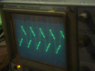

sir ajt
i'm trying to learn how to use the scope...i used the tru RTA software as sig gen
thru usb sound card.in the pics i set the tru RTA sig gen in 1khz in low volume,the 2nd pics is in high volume.sakit na sa tenga coz don't have a dummy load.can u give a diy dummy load circuit..plsss...

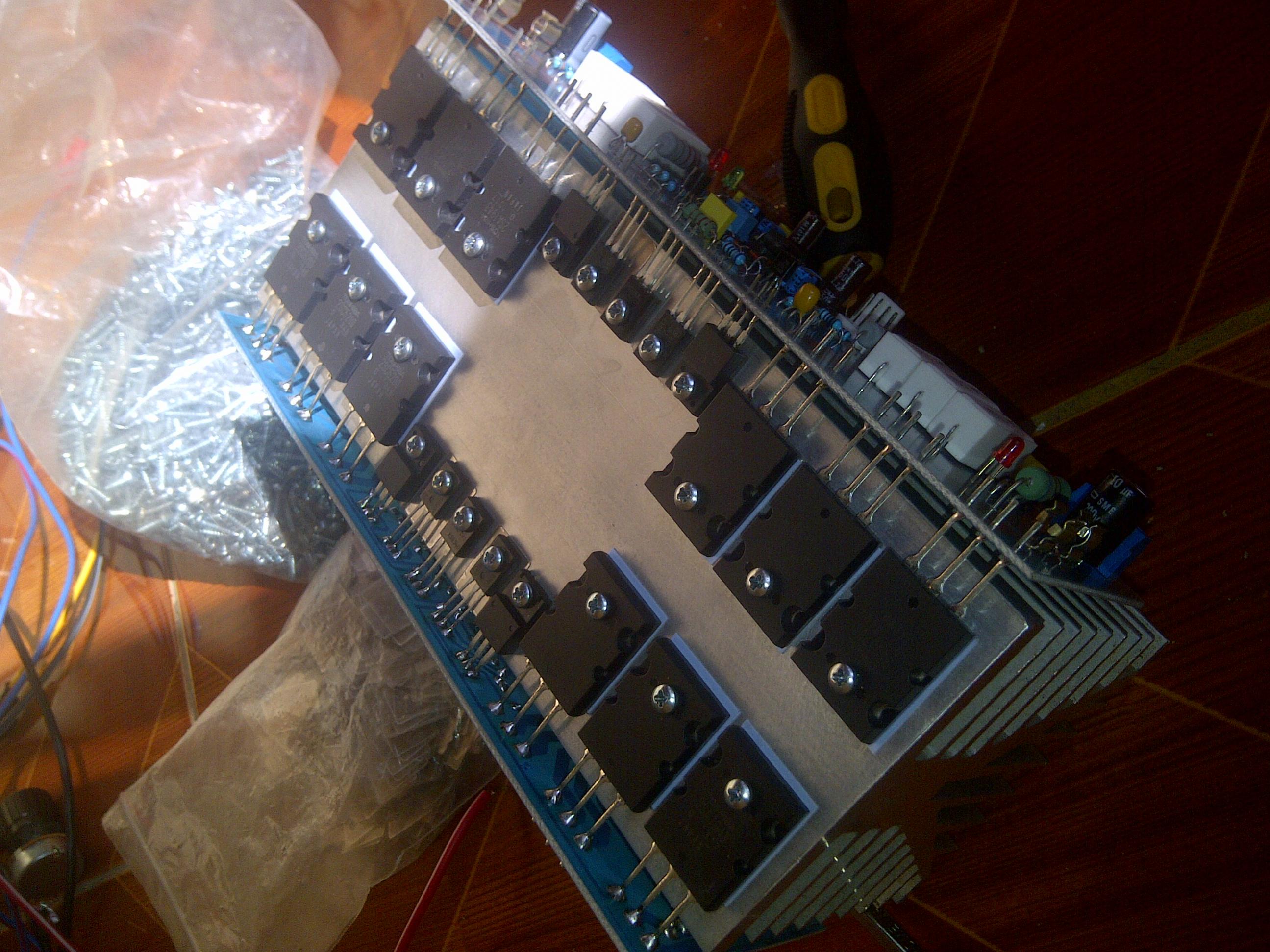

gud day,, i finish my b500 circuit but when i test to connect the supply my drivers are hot but the final transistors are ok,, is that ok sir,, i have no heatsink for my drivers,, my supply is 54 volts dc
the current variations in the drivers are generally MUCH lower than the current variations in the outputs.
This results in less temperature variation in the drivers.
But that temperature variation can be reduced a lot by fitting a heatsink.

sir ajt
dummy loads....https://www.google.com.ph/search?q=...uzuASusYGoBQ&ved=0CAgQ_AUoAQ&biw=1366&bih=653
