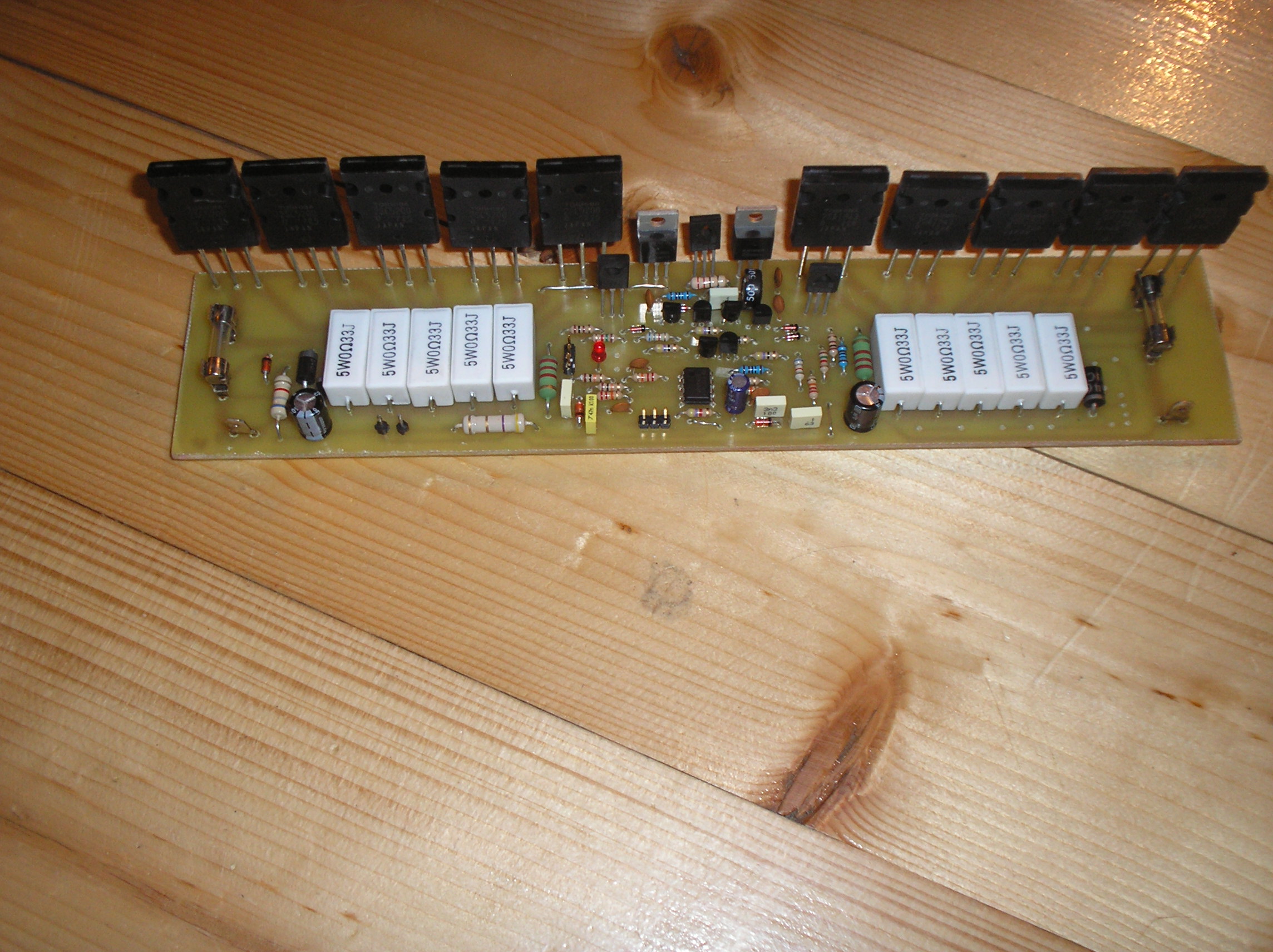

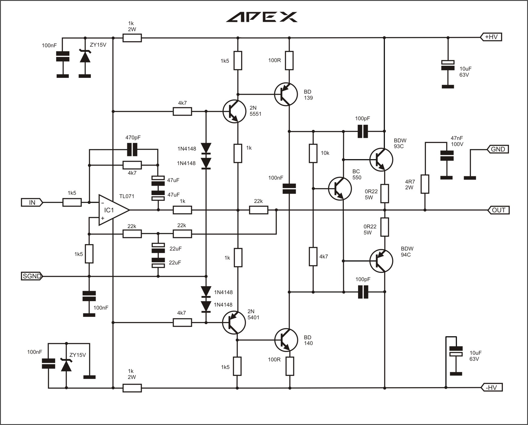

sir can i replace ne5532 with 4558..?? why is it my driver getting hot
yes...although in my case i replace 4558's with ne5532...😉

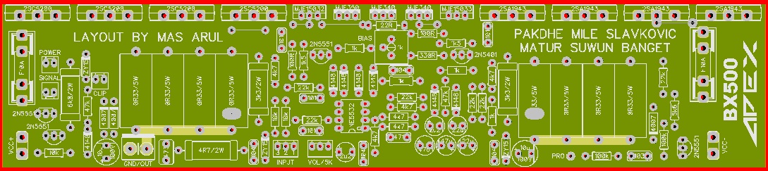

so her in b500 sir there is no volume for this amplifier..?? where can we put the volume trimmer here,,
if you mean input volume control, then yes you can use one, single or dual 10k's will be okey...can be purchased here...10K Audio Log Pot 16mm
sir apex my driver c and a getting hot,, whats the reason for this,, can i try this amplifier without output 2sc5200 and 2sa1943,,?? my supply is -+52volts dc
how hot? is it painful to touch?
