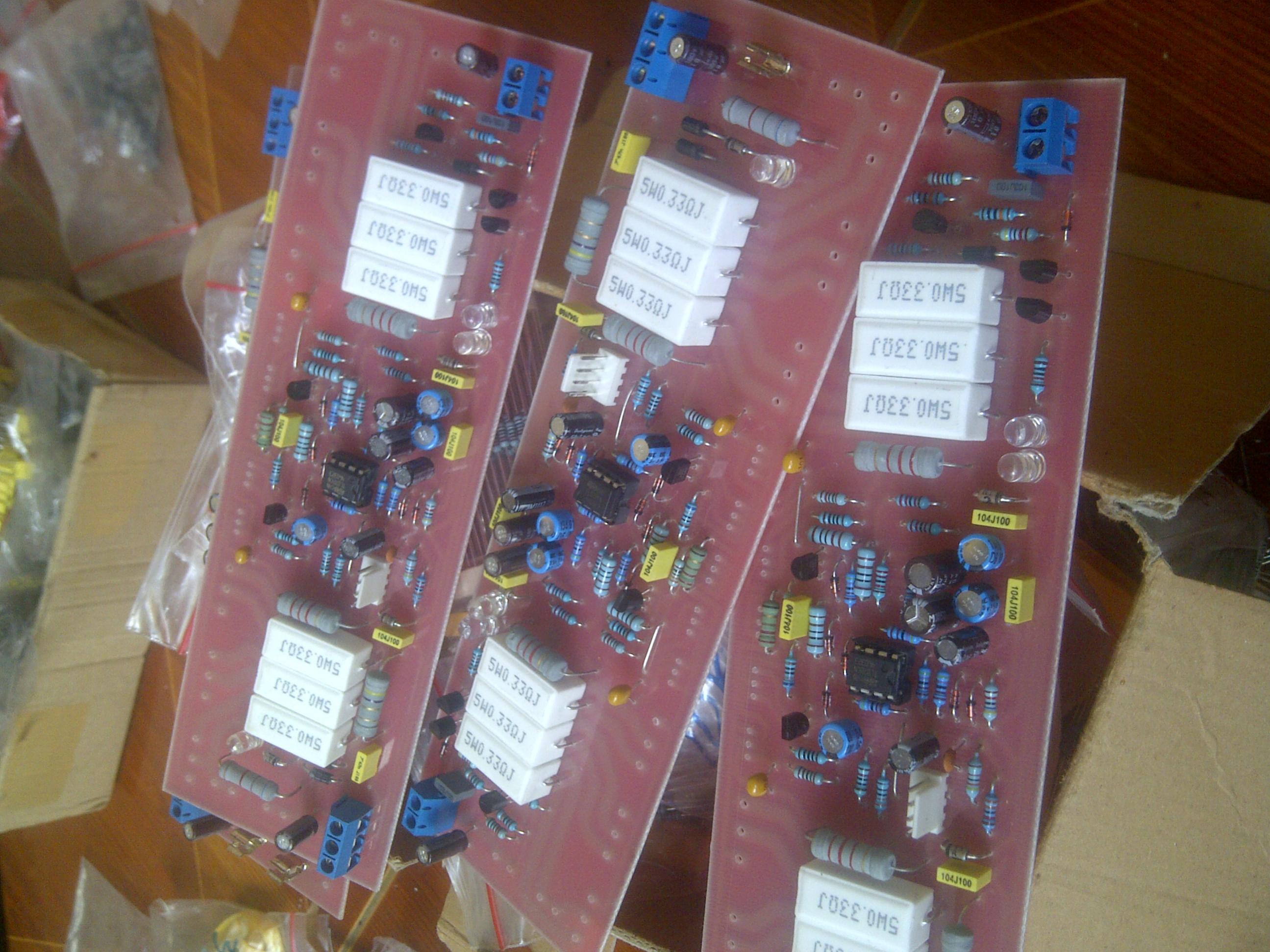

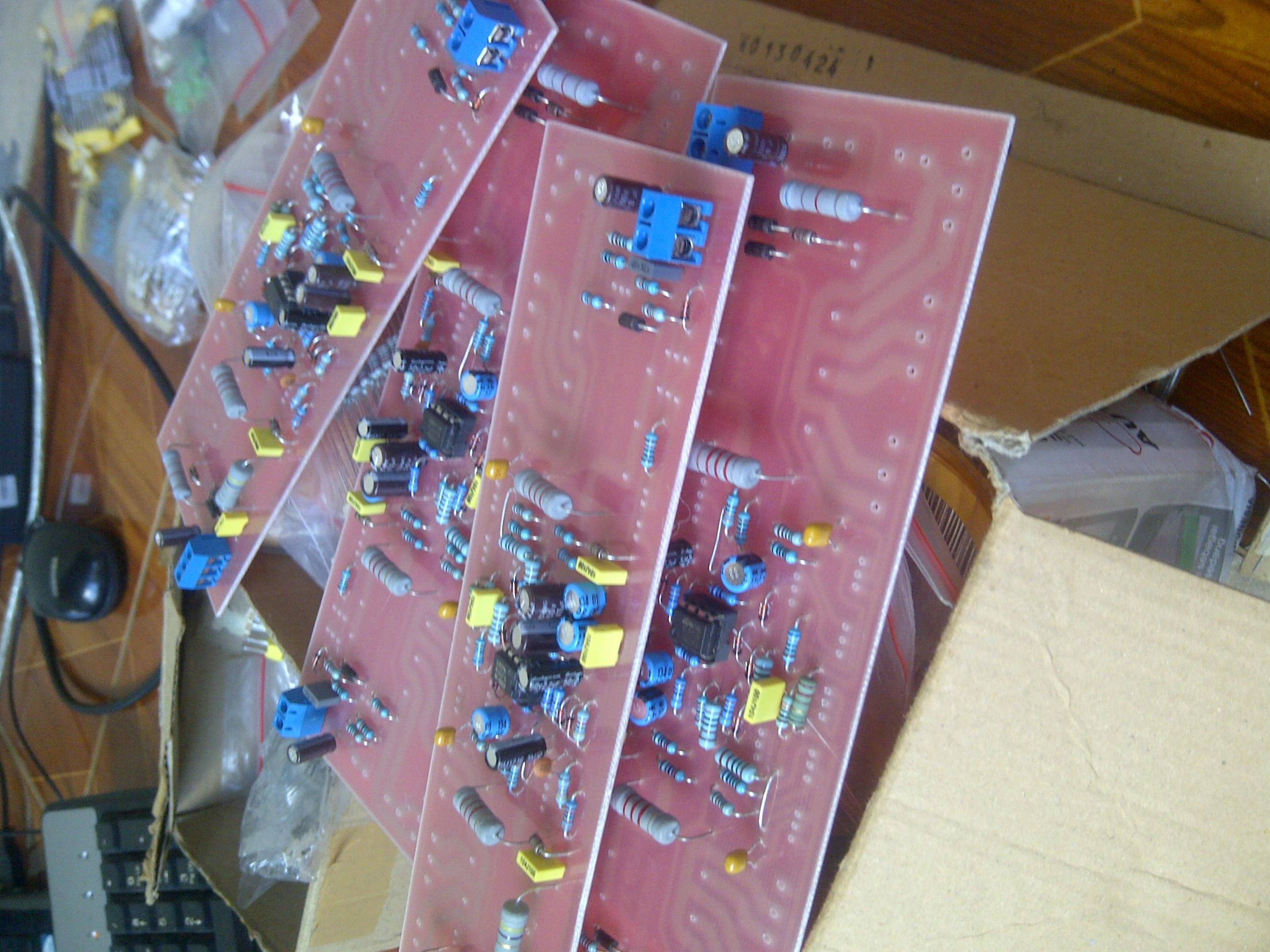

sir can i replace mje drivers to big ones like c5198 and a 1941 as a drivers..??
if you have them already on hand, yes, but if you are going to buy, then the MJE's are better to use...there are now local on-line shops, like deeco and newport electronics, even alexan or e-gizmo can be source of parts, apart from element 14 and rs philippines...
ok sir,, this cant affect the performance of the amplifier..??
can i power this amplifier sir with 87 volts dc..?? how many output like 2sa1943 and 2sc5200 do i need
how many pairs are you using? the 2sc5200 is not that robust above rails of +-55volts....
+-87Vdc (174Vdc total rail to rail) or +-43.5Vdc (87Vdc total rail to rail)?
sir i dont understand about the rail but all i know is my transforemer is 65-0-65 ac.. is this ok for this amplifier sir..?? how many output or 2sa and 2sc i need...
a 65Vac transformer will five you about 90Vdc to 95Vdc
a 65-0-65Vac transformer will give about +-90Vdc to +-95Vdc (190Vdc total across the supply rails).
ClassAB will blow up your 1943/5200 transistors.
Try ClassG, or ClassH, that may allow your transistors to survive.

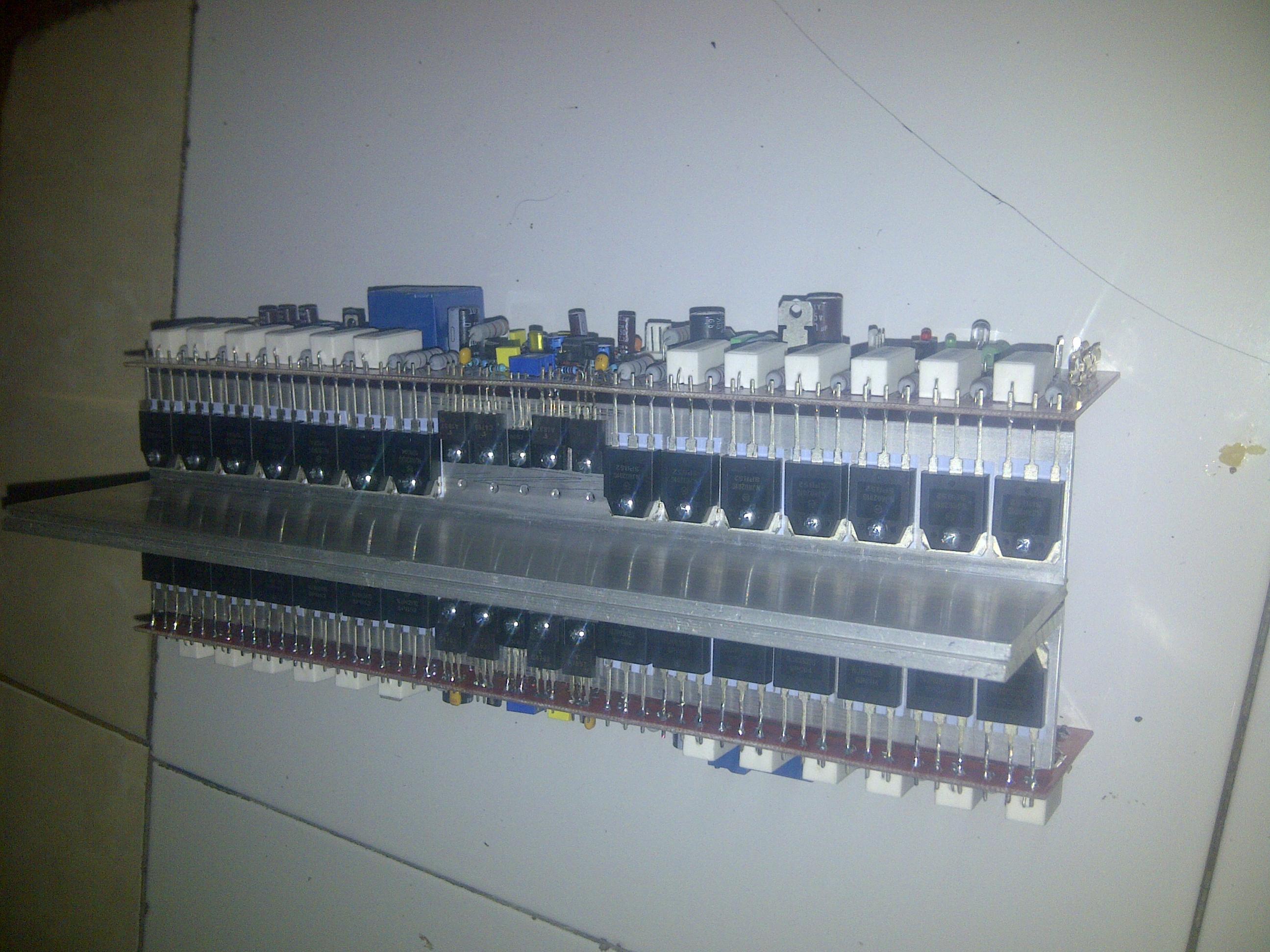

sir ajt i'm using the original pairs of output 4 2sc and 4 2sa.. but i didnt try yet to supply the 85 volts dc coz i want to ask first before i try the transfoermer
For B500 2x60vAC max, but I suggest 2x55vAC for safety operate.
best to follow designer's comments,
raising the rails while giving you more power,
does not necessarily give you more spl.
using lower rails makes your output trannies
live a little longer than with high rails...
