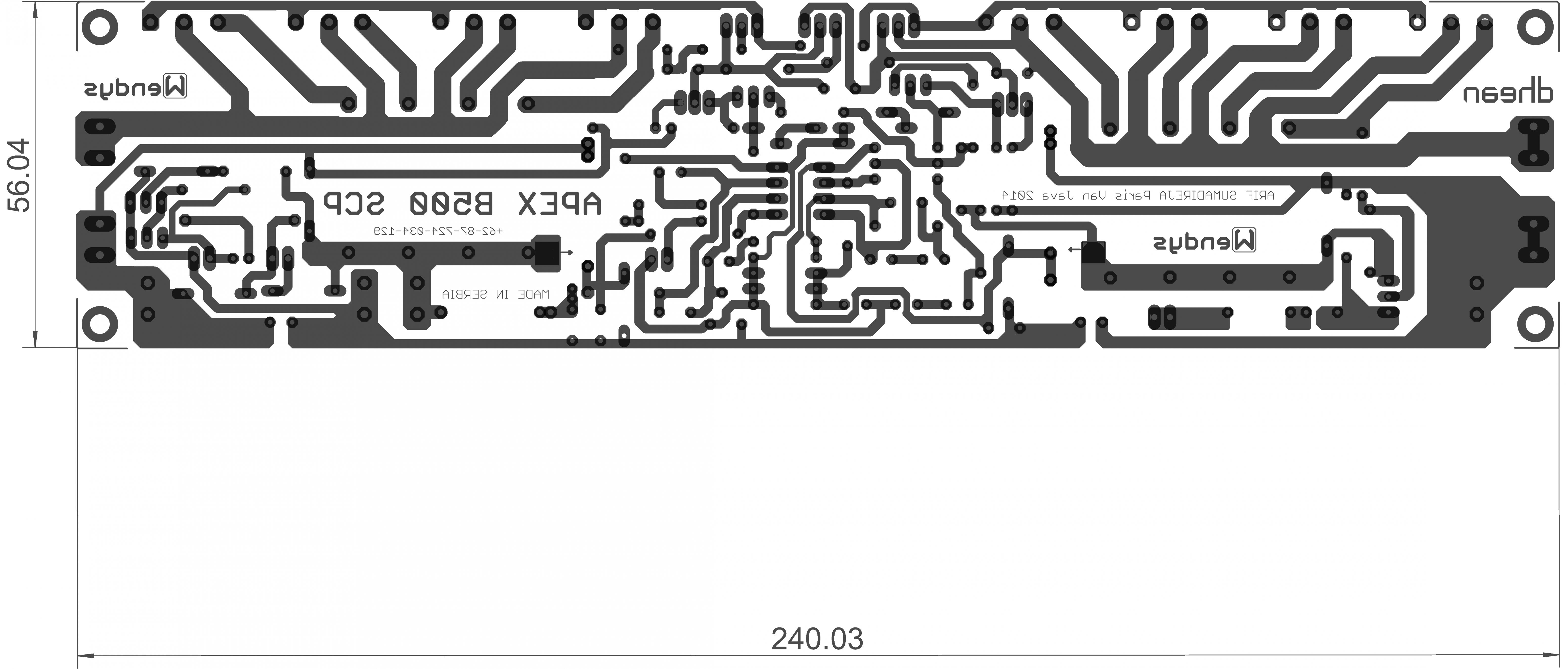

may be useful .. pcb B500 scp (signal, clip, power indicator) already tested ok ... thank Apex Audio ..
Nice work
black bottom
sorry sir... like this...???
arif smd
Sorry Arif, but traces are grey so no
home etching is possible .
Did you have this traces in black ?
Thimios.
arif smd
Thats it!sorry sir... like this...???
arif smd
Thanks .

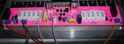

I think Mr. apex made amplifier girlfriend or wife is a pink out
or for birthday..
