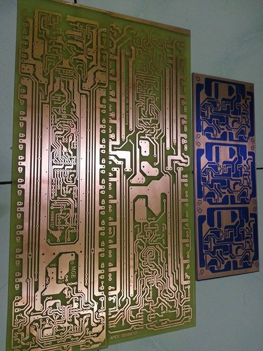

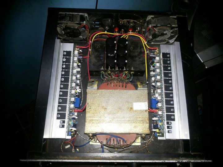

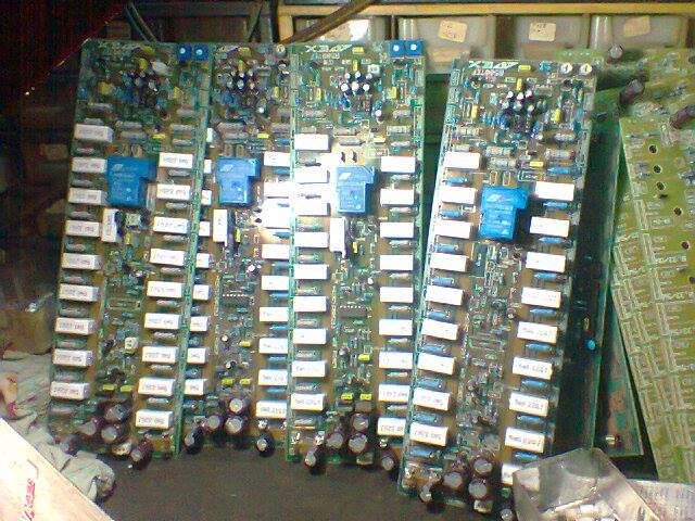

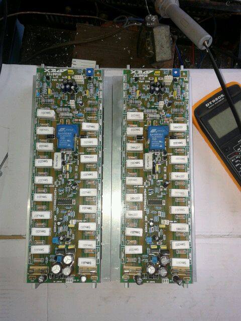

sir I m talking about the TEF version of APEX B500 which has 7 pair output transistors,,.
.and I want to use 50 v ac i.e 70v dc...and yes it is not possible to connect a 2 ohms speaker ...it burns everything...thank u for ur valuable answer....I just built it for 500watt rms PA amplifier..in 4 ohms speaker..

Hello to all
please
can anyone tell that
I want to use b500 tef with 2x60vac trafo on 2 ohms
its a must need for me because i want it be more than stable on 4 ohms
please tell me the no of output tranees to be used as i have plenty of 2sc5200 pairs and transformer ratings
If you have a 4ohms speaker then you design the amplifier to drive a 4ohms load.
One criteria I use is that the amplifier MUST BE ABLE to drive a resistor test load that is half the nominal speaker impedance. This is not a stability requirement. It's about current capability into reactive loads.
I now design to drive 1/3rd nominal load resistance for a very short period. Just long enough to see the sinewave on the scope. This would be the equivalent to driving a 1r3 test resistor for a 4ohms amplifier.
The total Pmax of the output devices should be ~ F times the maximum power output of the amplifier.
F = 4 for mosFET devices
F = 5 to 6 for BJT devices.
eg using 2pair of 250W devices (MJ15003/4) total Pmax = 4 * 250W = 1000W
For BJTs F= 5 to 6.
Max Power = 1000 / 5 = 200W
This depends very much on the temperature de-rated SOA of the devices and the temperature of the heatsink that you will typically use, as well as how severe the speaker is in stressing the output stage.
