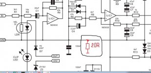

500W PA amplifier with Limiter

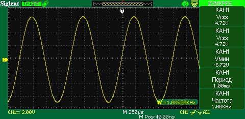

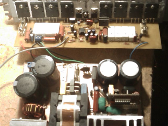

decided, DC at the output of 5 mV.

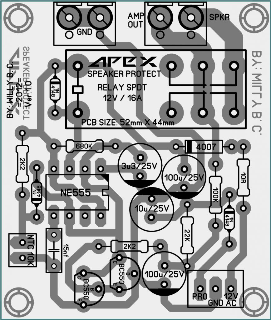

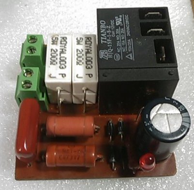

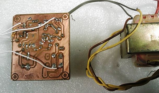

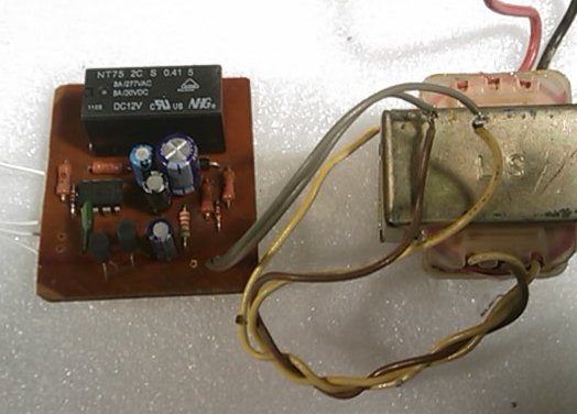

Thank, apexaudio. Testing protection NE555, sstart, very good! PCB in Sprint-Layout.
