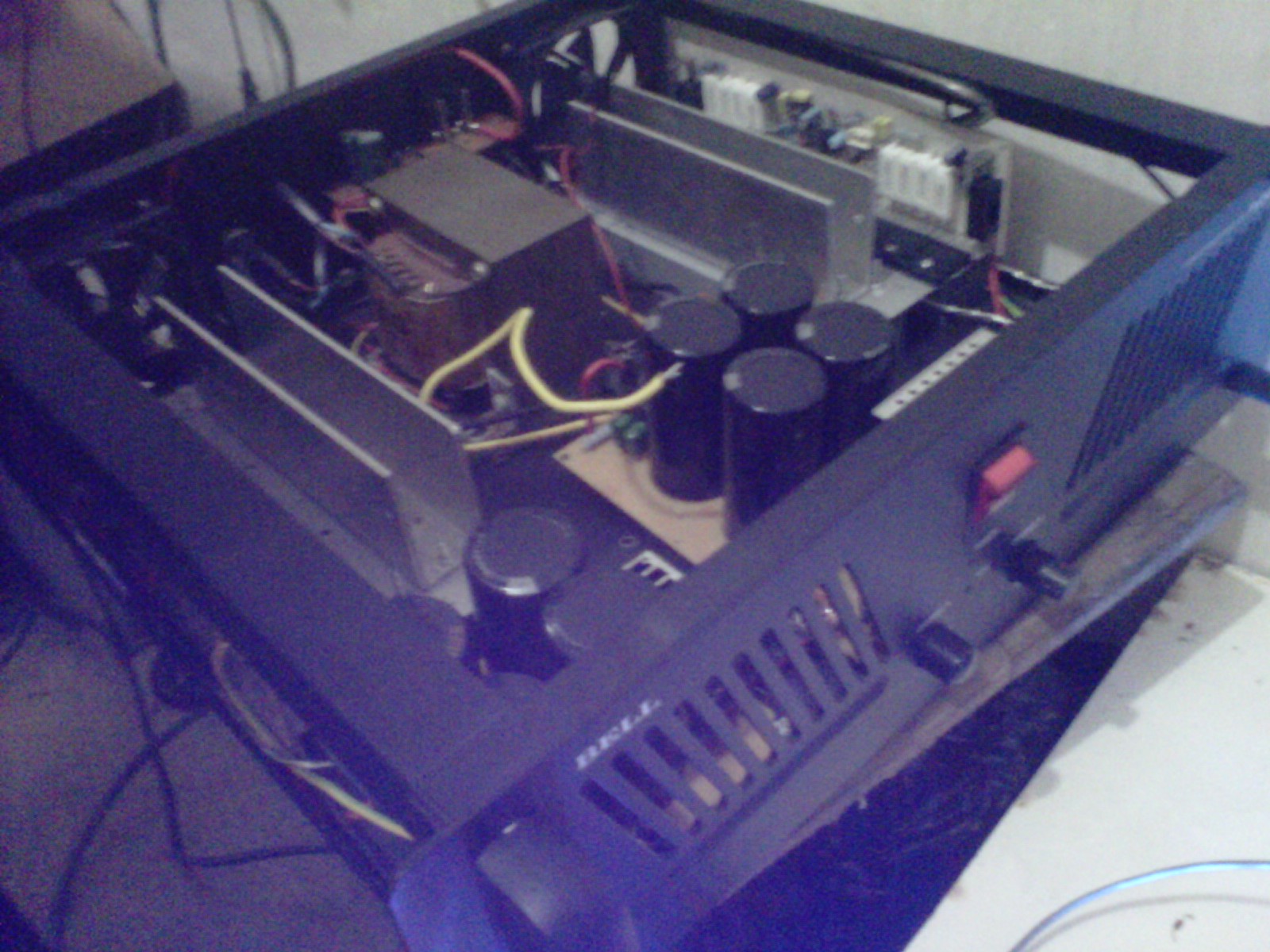

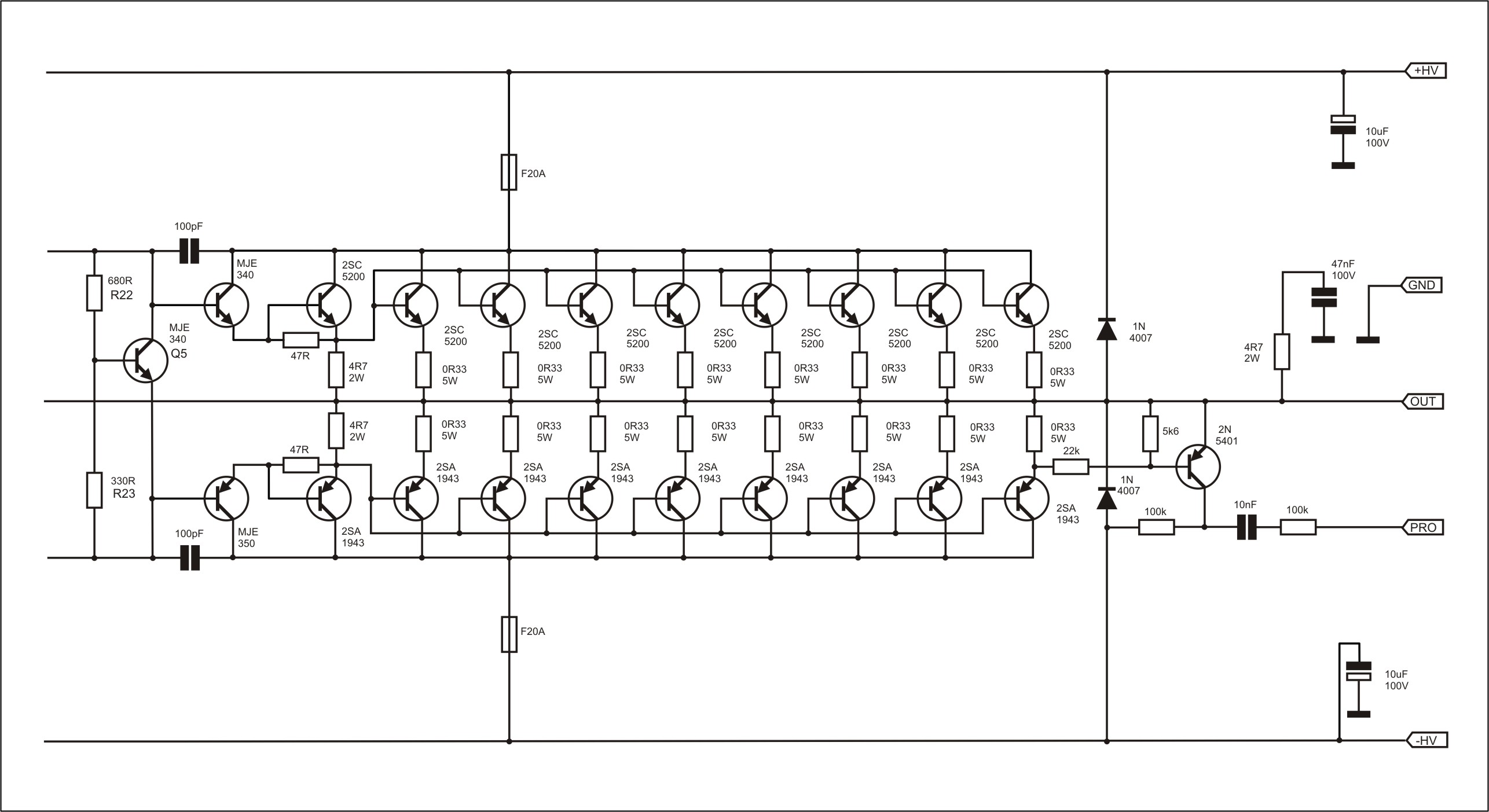

500W PA amplifier with Limiter

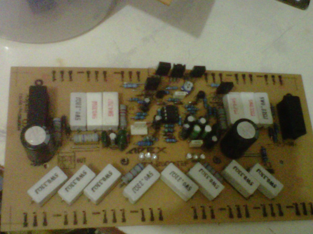

APEX B500 TEF PROJECT.

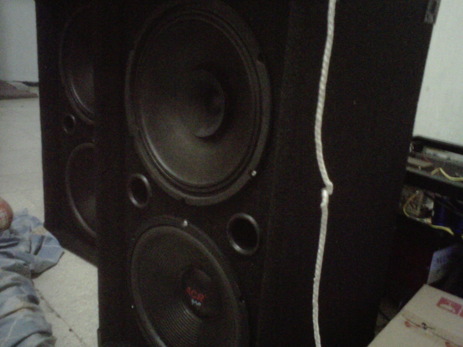

ONCE AGAIN THANKS TO SIR APEX AND SIR WILLY MY B500 TEF... GREAT SOUND ...

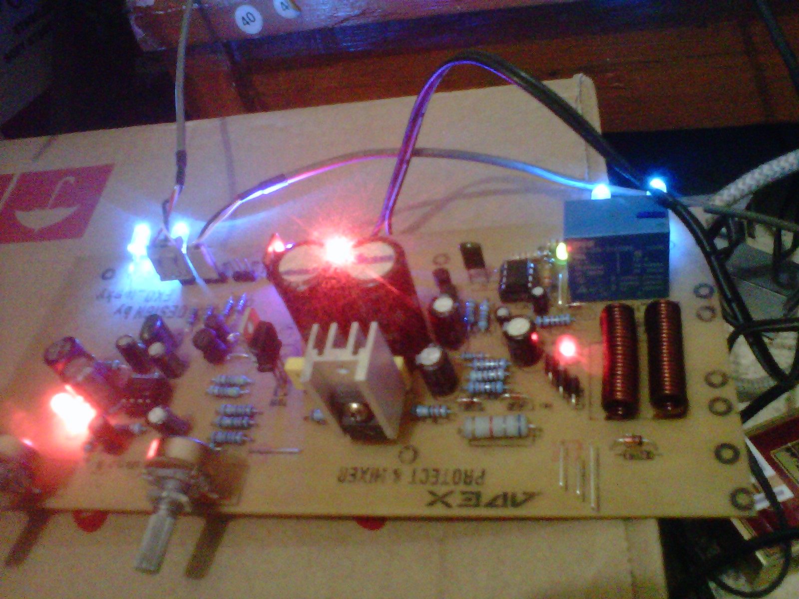

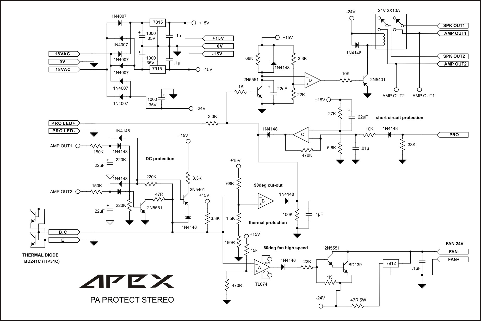

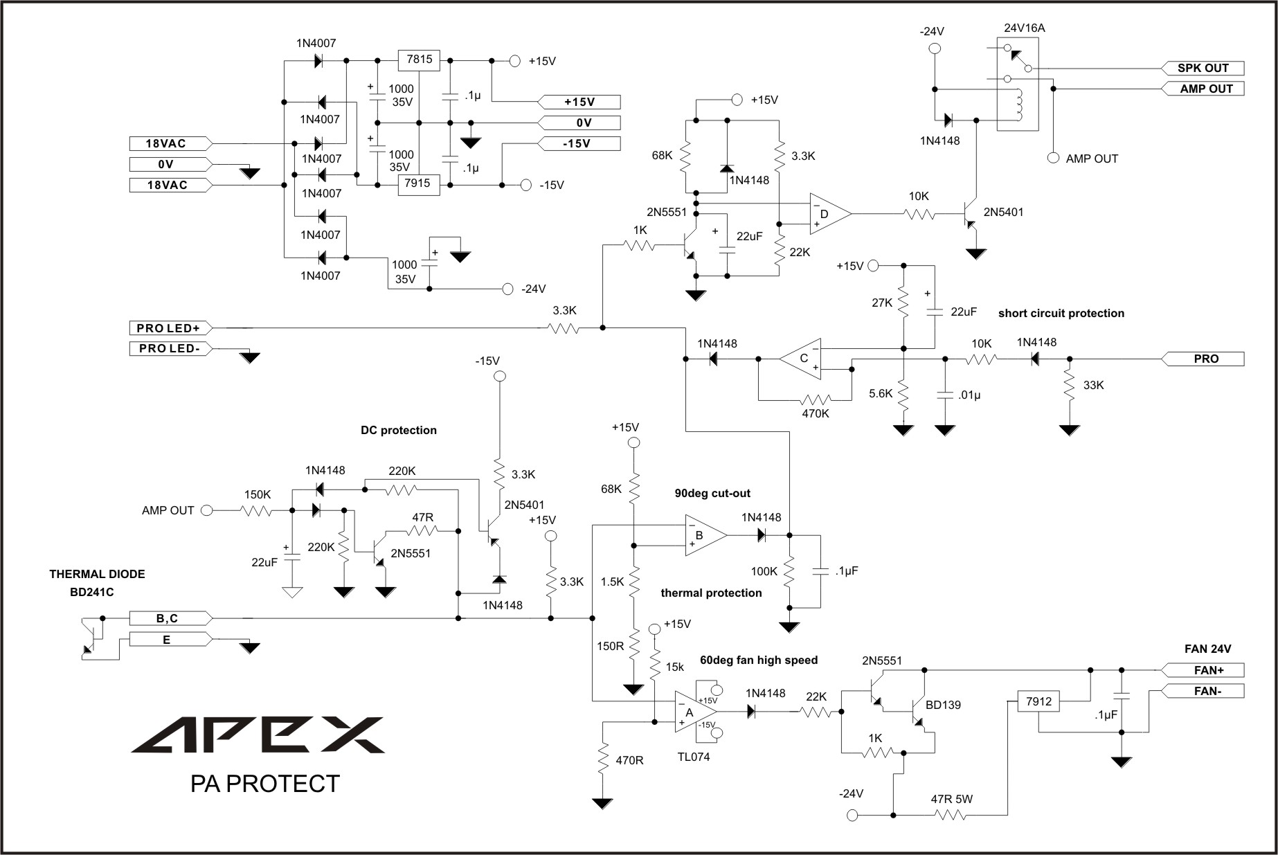

Sir if i use apex protec in b500 how to mount tip 31 on heatsink if i change bd 241 with tip 31? do i have to use an isolator like usual or not because i read it function as temperature sensor

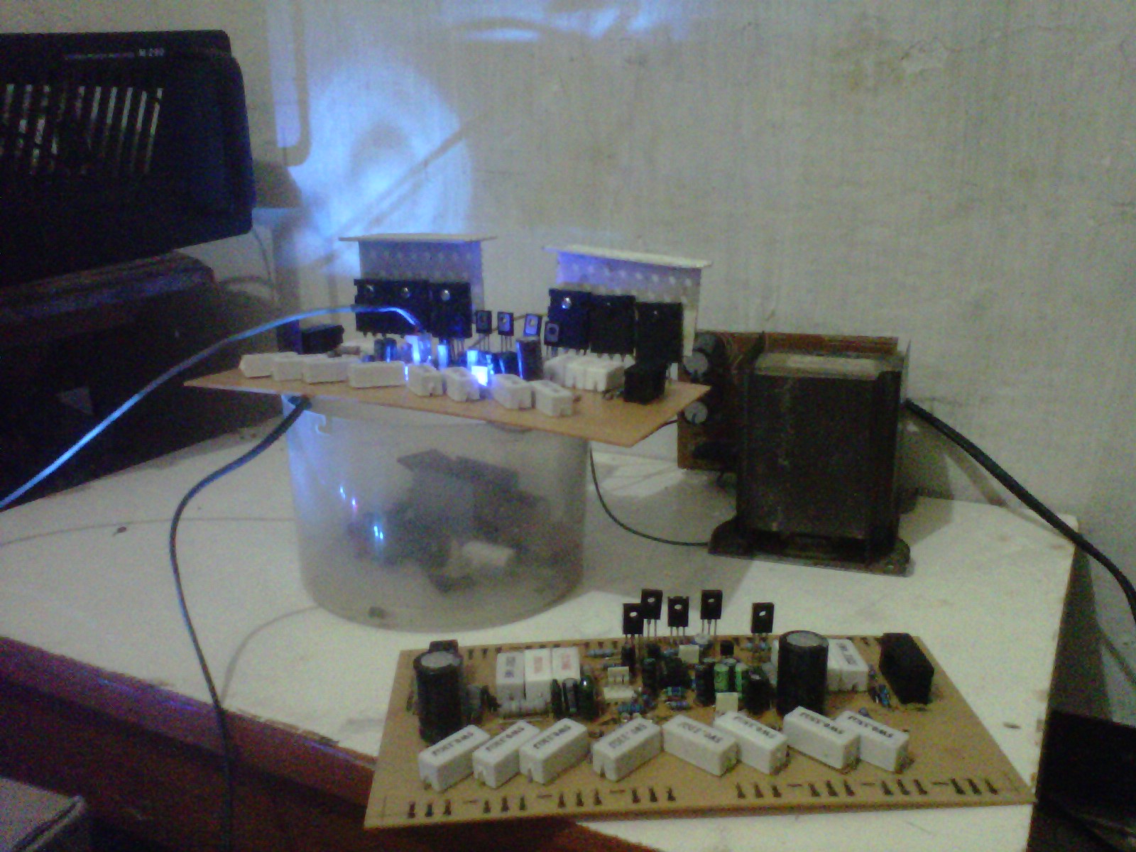

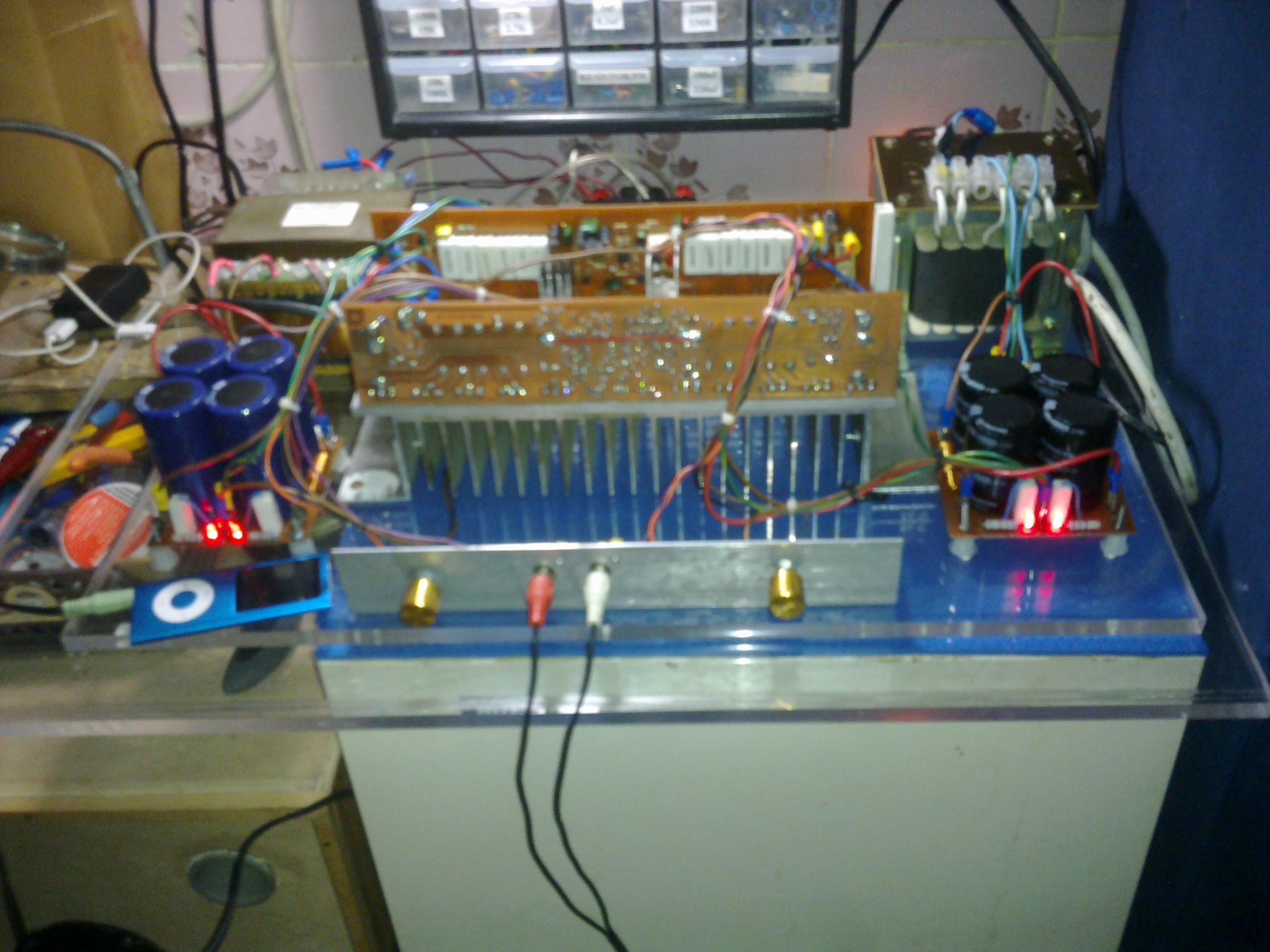

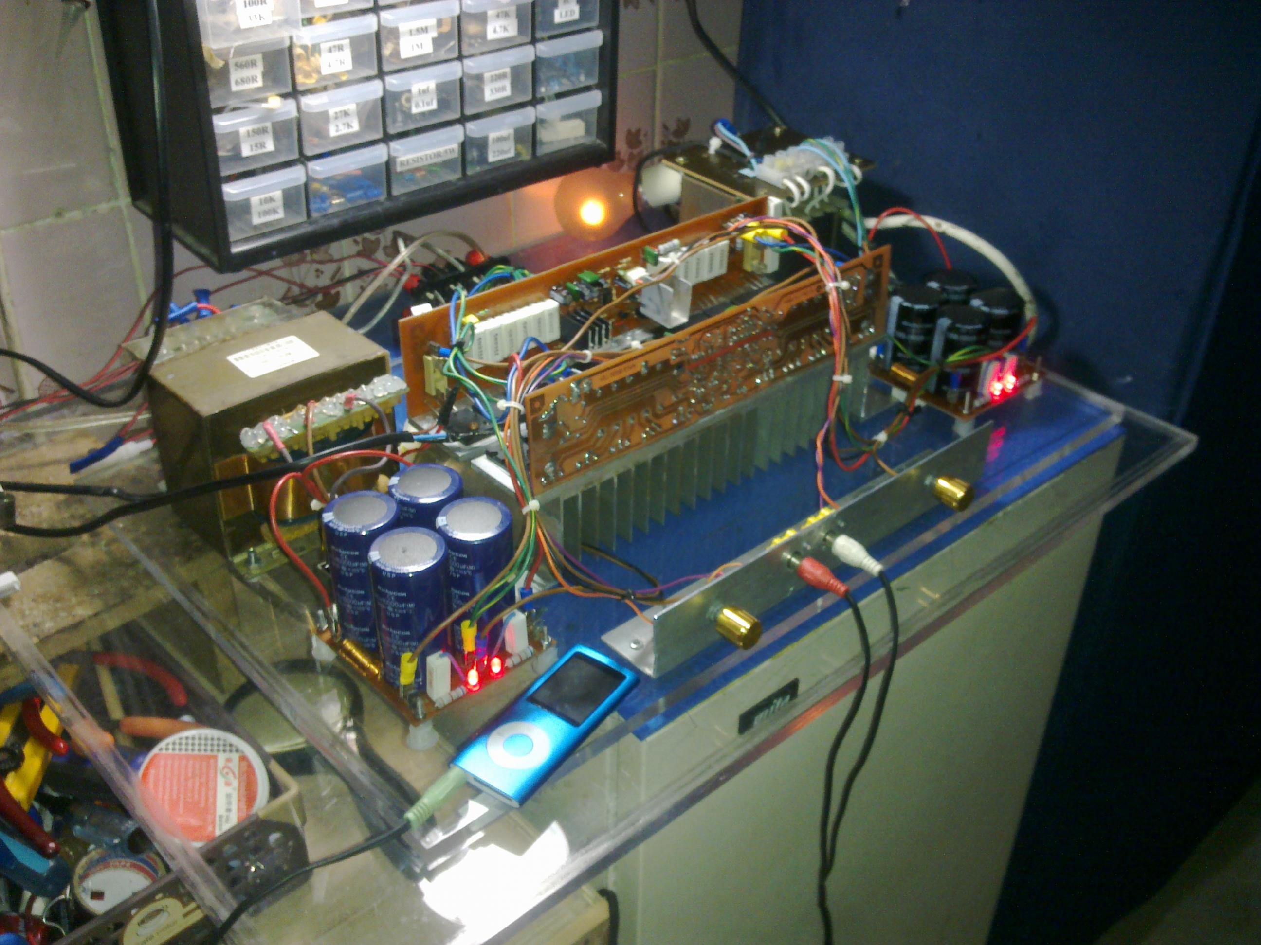

This is the best amp that I have ever made .. 🙂
I changed the layout slightly to match with my box amps and PCB that sold in the market.
photo by 6TR final apex b500TEF
combined apex protect and mixer for the front panel.
thanks mr. mile and fellow DIYer's
regards.. 🙂
