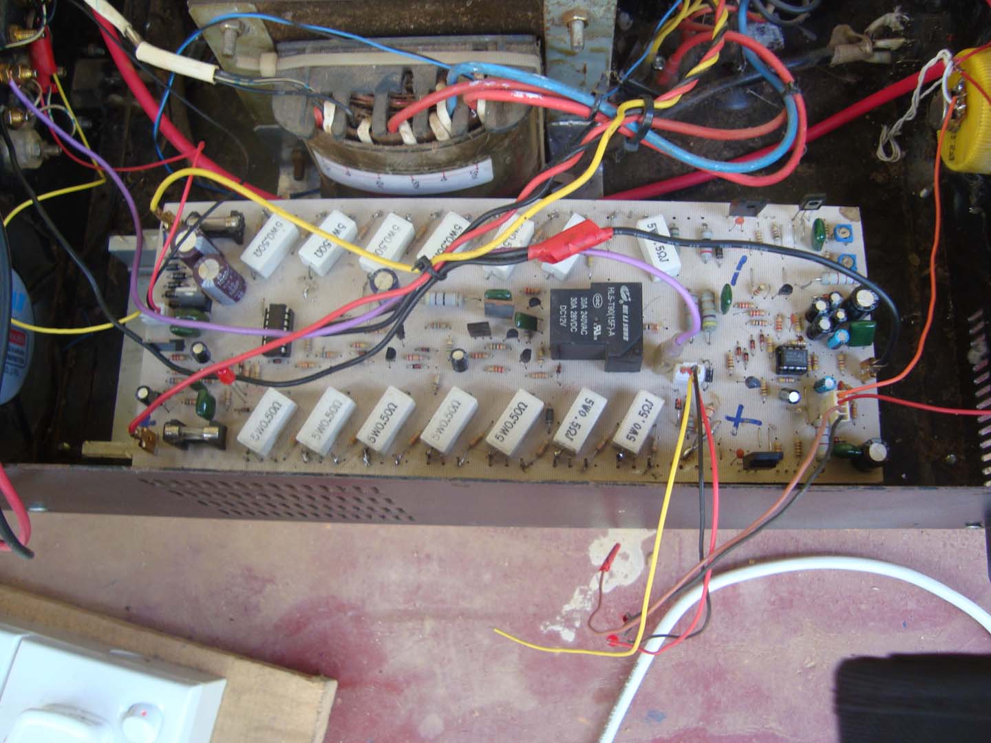

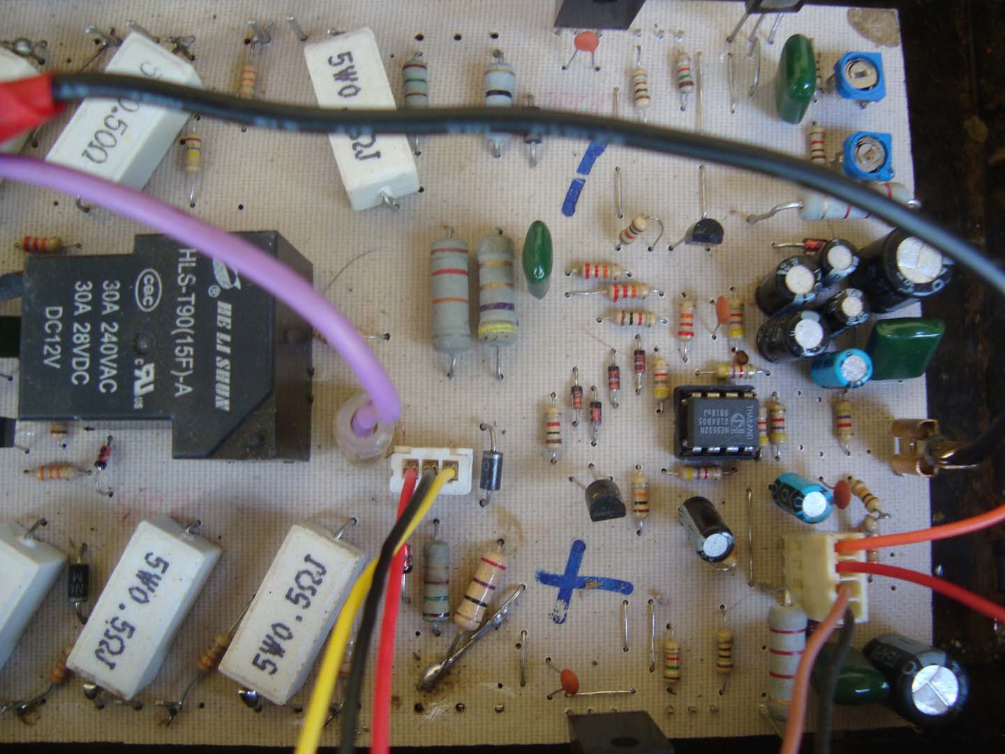

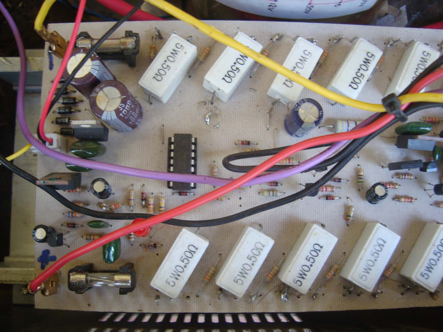

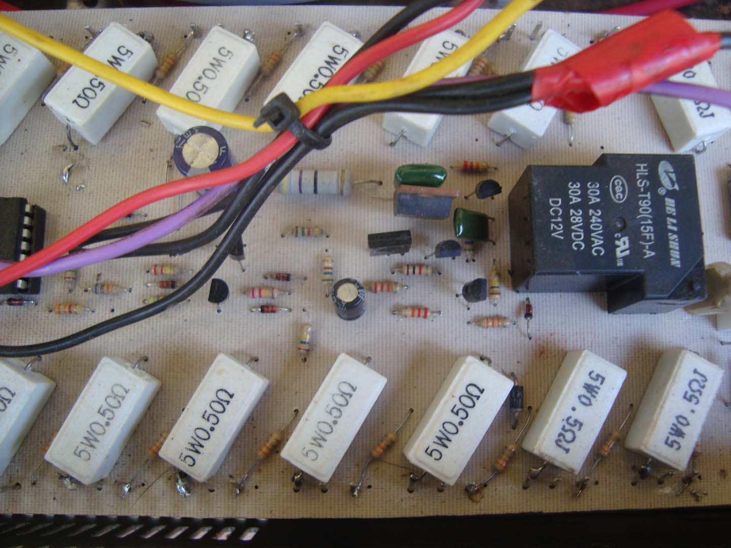

i have made b500.when i supplied -+24v the is ok.but when i supplied -+55v the + fuse blown.what could b wrong in here?
try to follow this as mr.apex said (try this one you can adjust bias with different value of R23 (use 1k trim-pot), and use 10R instead fuses, set bias to get 1V on 10R, measure value of trim-pot resistans and replace trim-pot with same value resistor or two to get same value). hope it can help :)

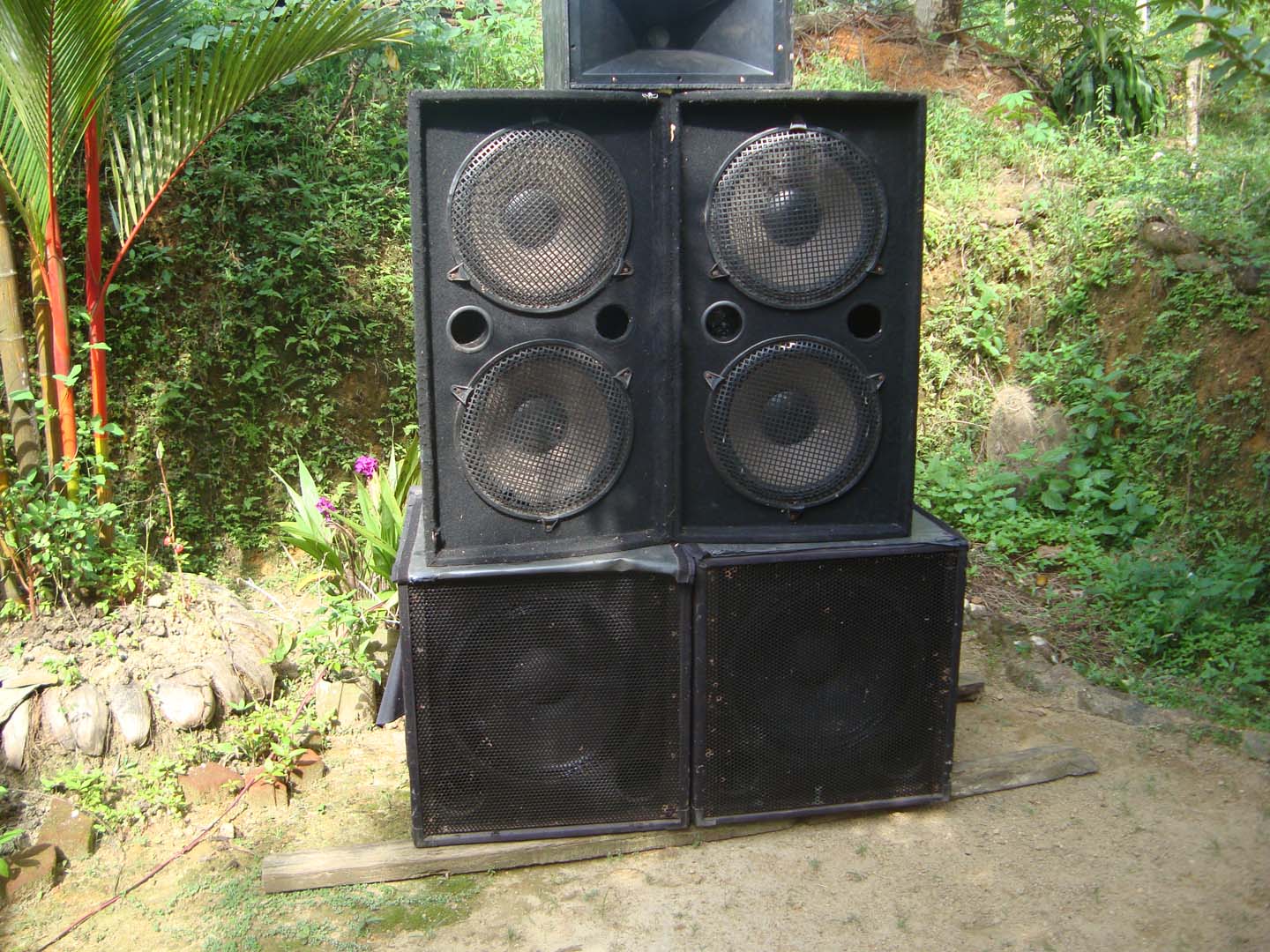

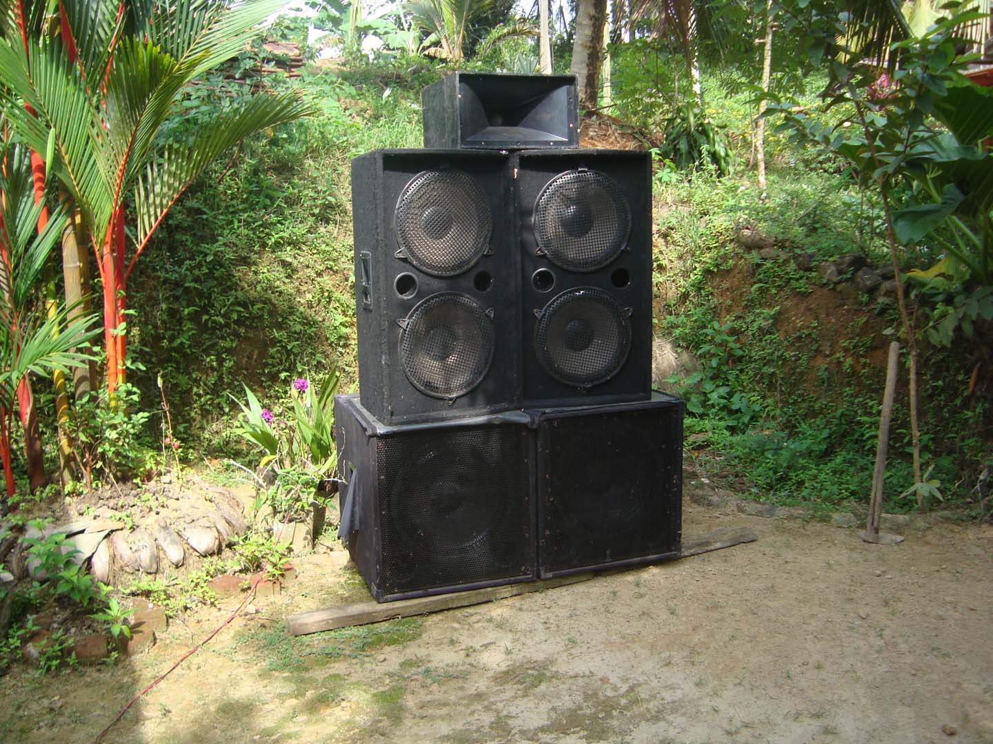

b500 tef tested with p.audio ,challenger c18el 1200w one sub and one top per channel,(300w per speaker in top)
powerful sound,
for diy members pls try to buy 15 inch speakers or 18 inch speaker, without good speakers u cant hear the powerfull sound.
useless of making powerfull amps.
powerful sound,
Nice work, I suggest some of my speaker box design for more powerfull sound.

Toshiba 2SC3281/A1302 have been obsolete more than 13 years. Virtually all these parts still available have been fakes for many years. Perhaps you have no clue what you really have and so it would not make sense to compare them with anything unless you really can test them at high power. At 500w, you are playing with fire using bogus components.
Wingshing and Mospec (Taiwan) make fair clones, however. You can use them though Vceo is only 200V compared to 230V. Who is the manufacturer marked on your transistors?
If the Toshiba 3281/1302 parts are genuine, they will be worth more to you as collector items to sell, than any 500W amplifier!
=) thanks for the reply, this one is toshiba made in japan.. i have four of this..=)
