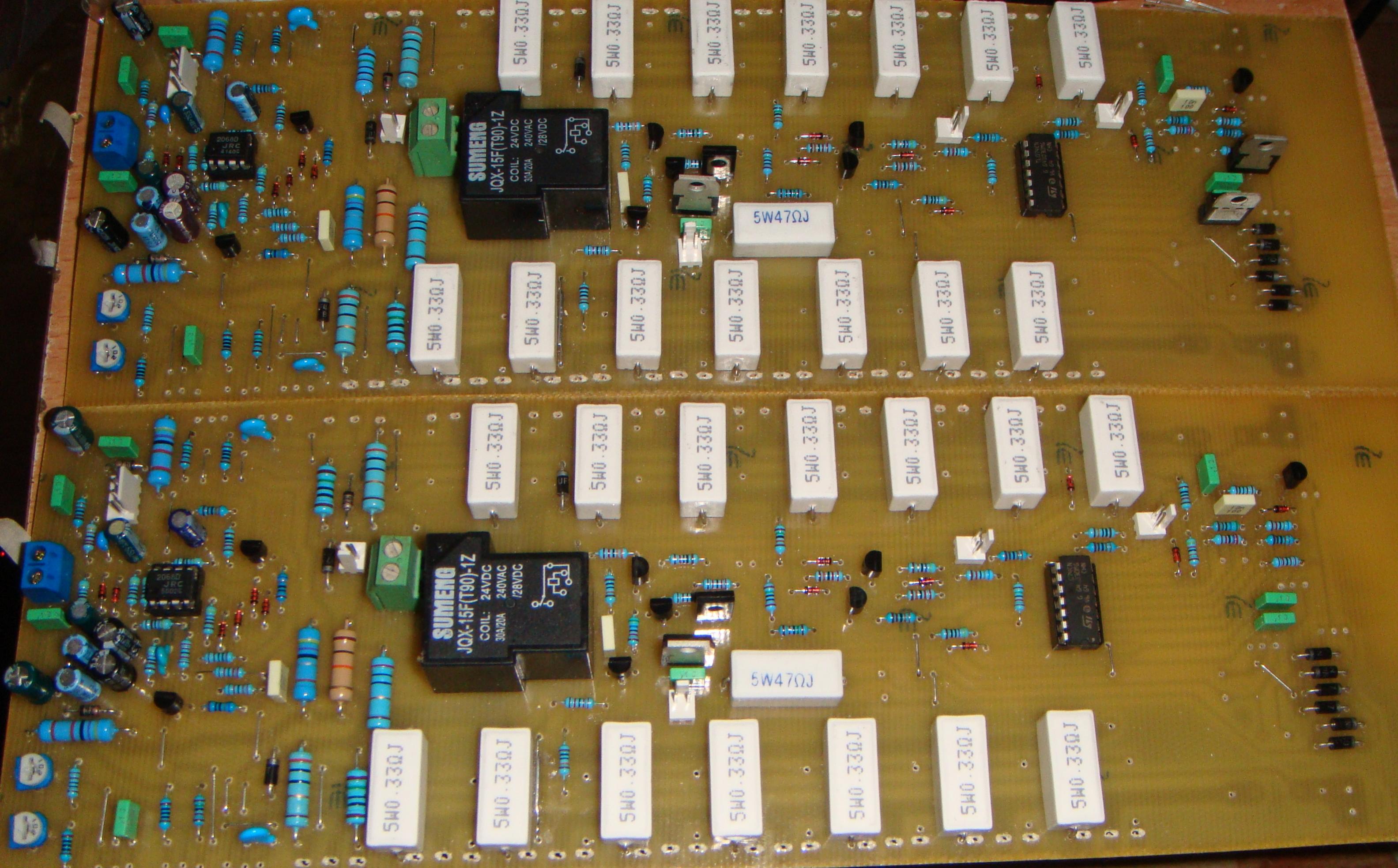

MY B500 TEF, ON GOING

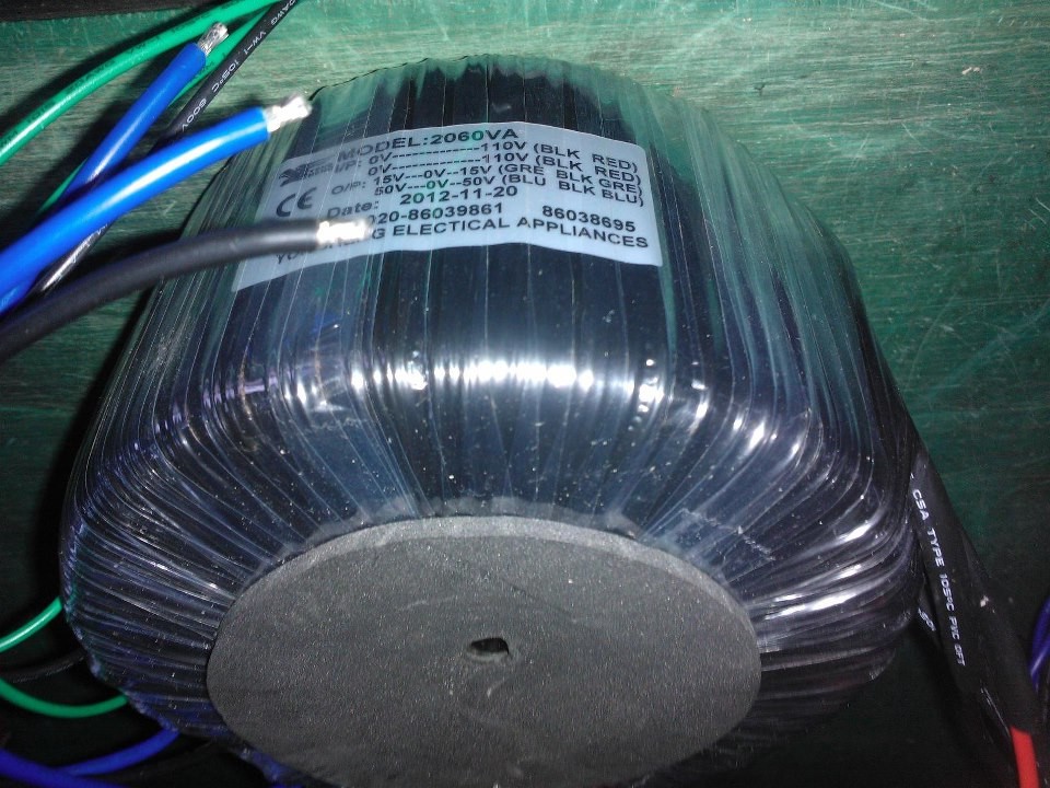

Hi.. this is my on going B500 TEF based on Liem Poo pcb.
Hope anyone can check also for any errors. My Power supply is 2x50Vac @20amps toroid. Ne5532 is replaced with NJM2068.

Nice work,
Regards

Thank Sir Mile for compliment...
May i ask what is the maximum VAC to be use if i will use MJL21193/94 or MJL4281/MJL4302.. and what components need to change like R24 & R25 in the original circuit.
Many thanks & Regards
