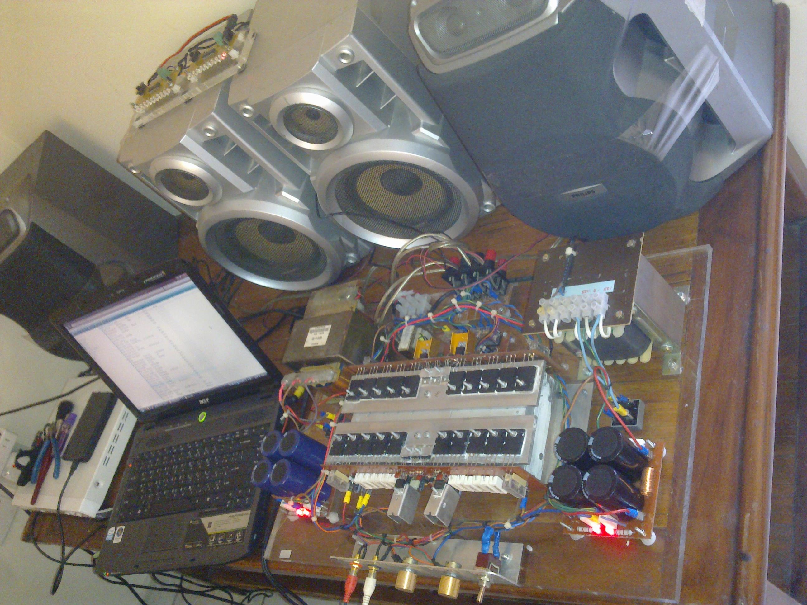

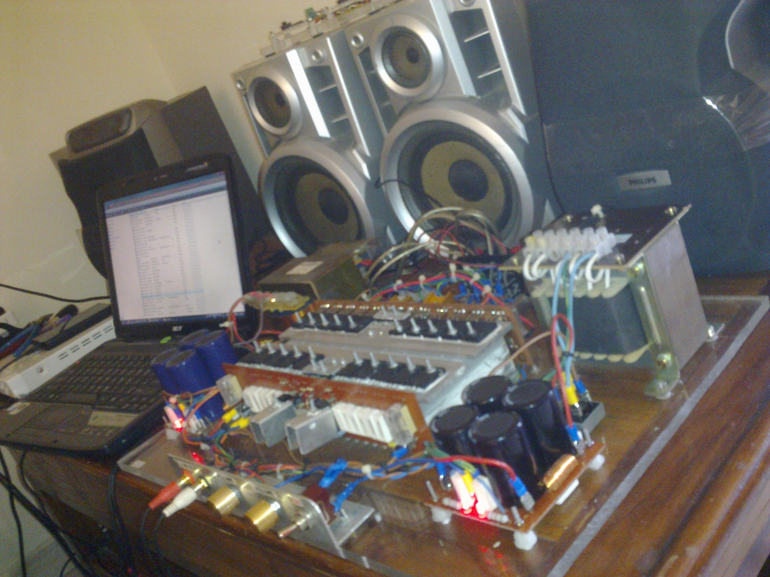

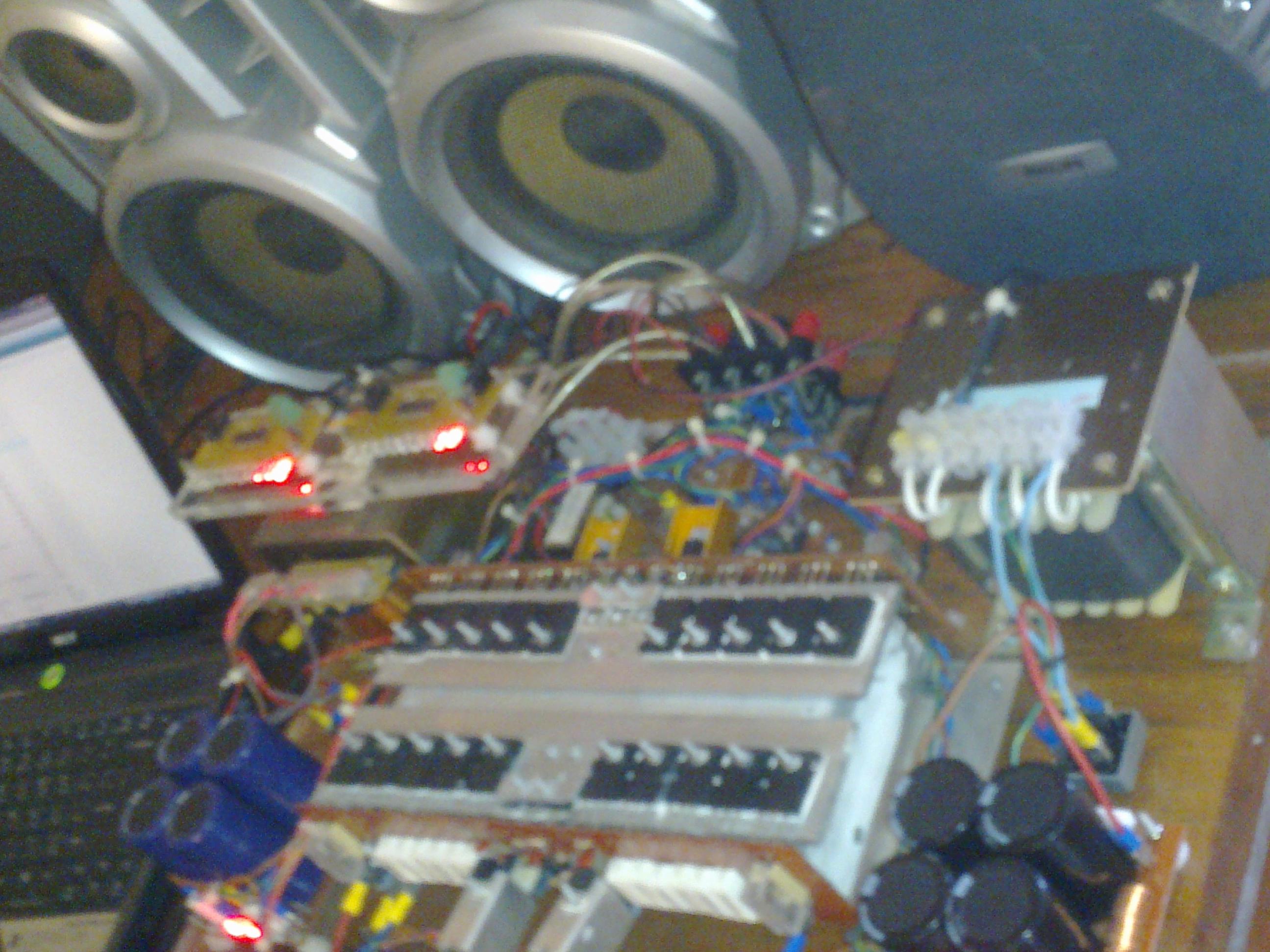

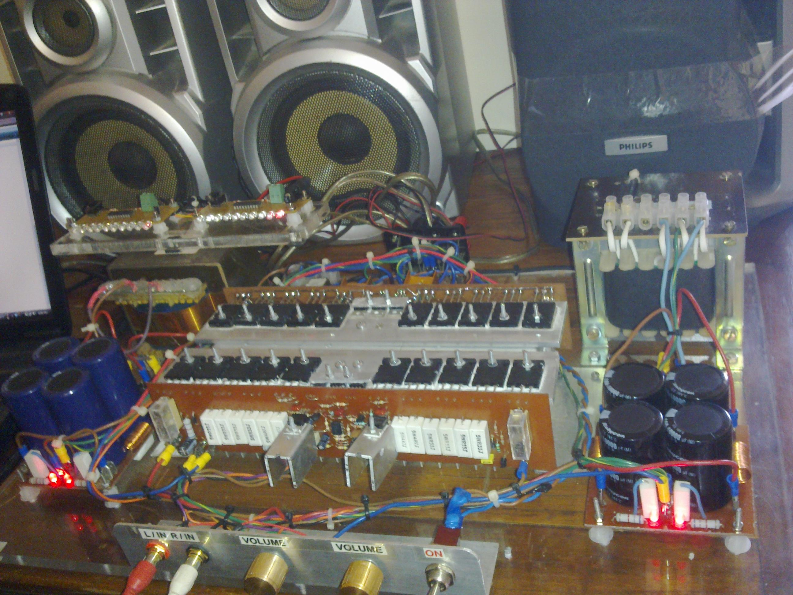

Done checking componet and voltage measuring found out 100r resistor change value to 1mr and finally my b500 is working fine now thanks to mr.apex and to other here.
Its sound really good :)
Sent from my MyPhone A919 Duo using Tapatalk
Congrats Kabayan... My B500 TEF..in action..once again thank you so much sir apex and sir willy.. very loud and very clear sound..thank you...
