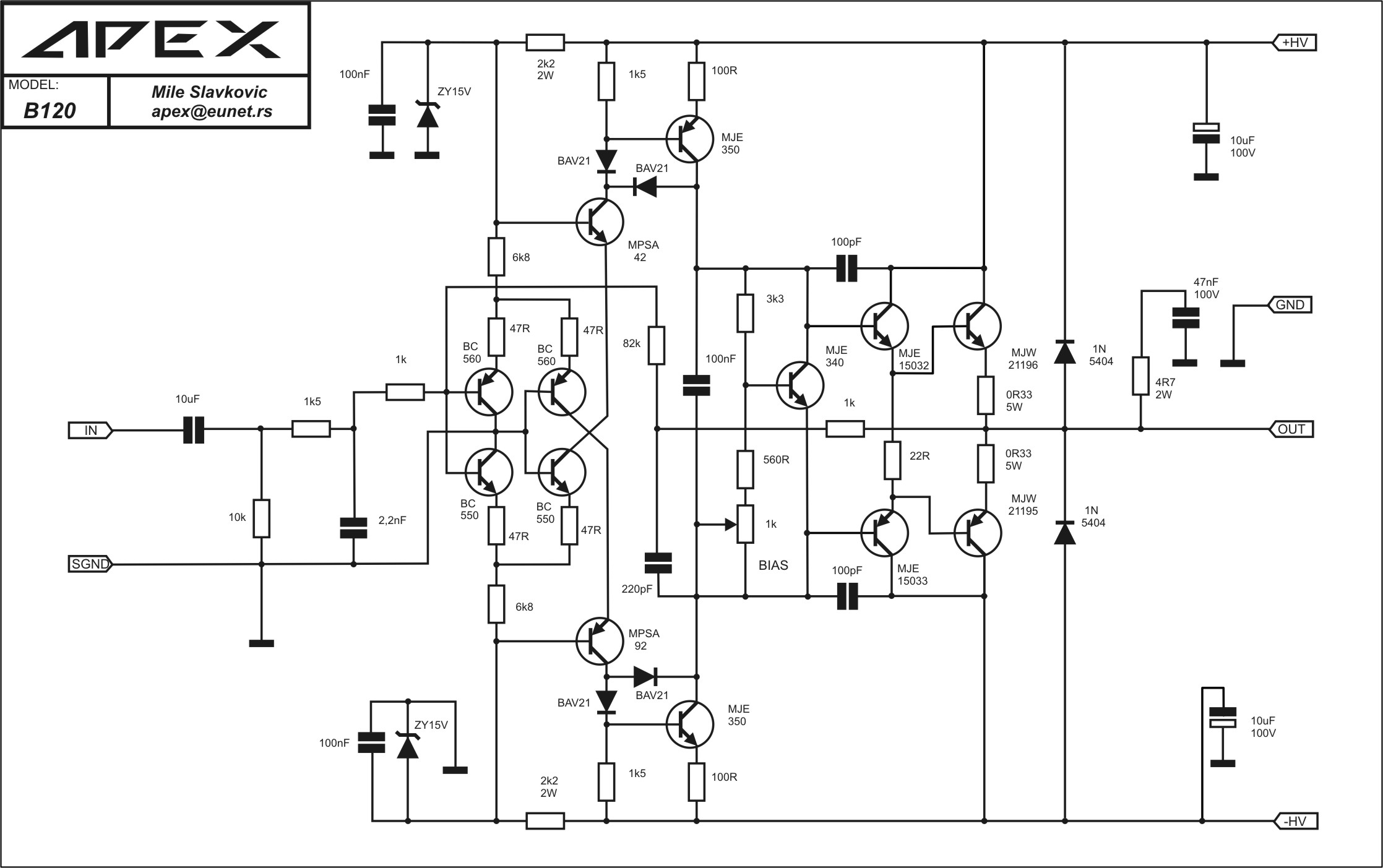

500W PA amplifier with Limiter
For start B120
This circuit (B600) have better low end response.
You have some osscilation if 4,7 ohm is hot.
thanks for ur answer sir, i never get some answer on my indo forum, so i join to this forum and i hope i get some answer here.
Ok sir mybe that right, but what can i do for my problem, i so confuse, if i connect the speaker, this not problem. can u give me some solution? For little info, i use darlington for this amp.
Please check 🙂
why not test??

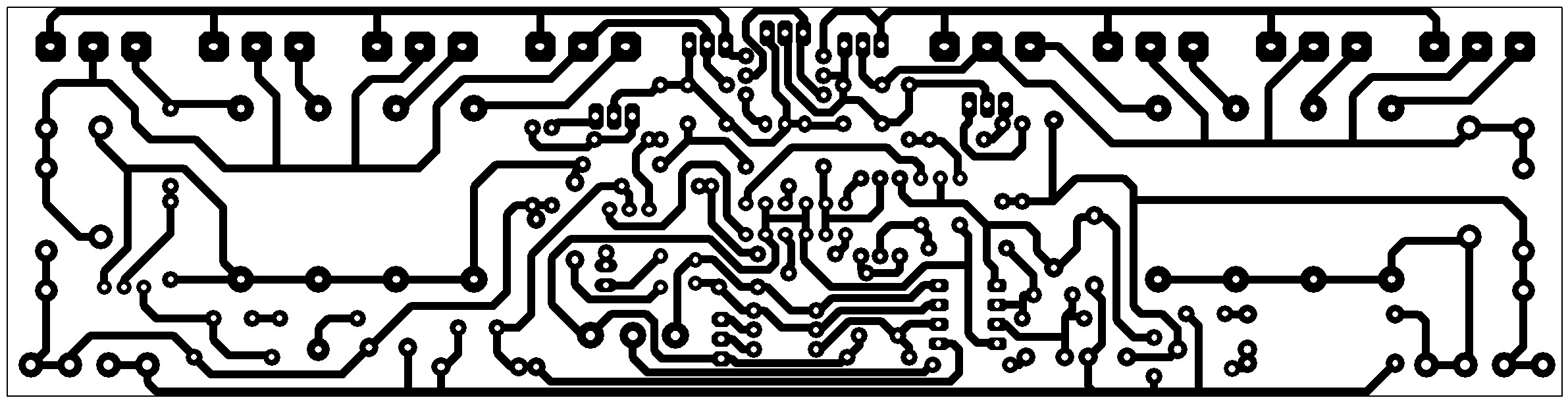

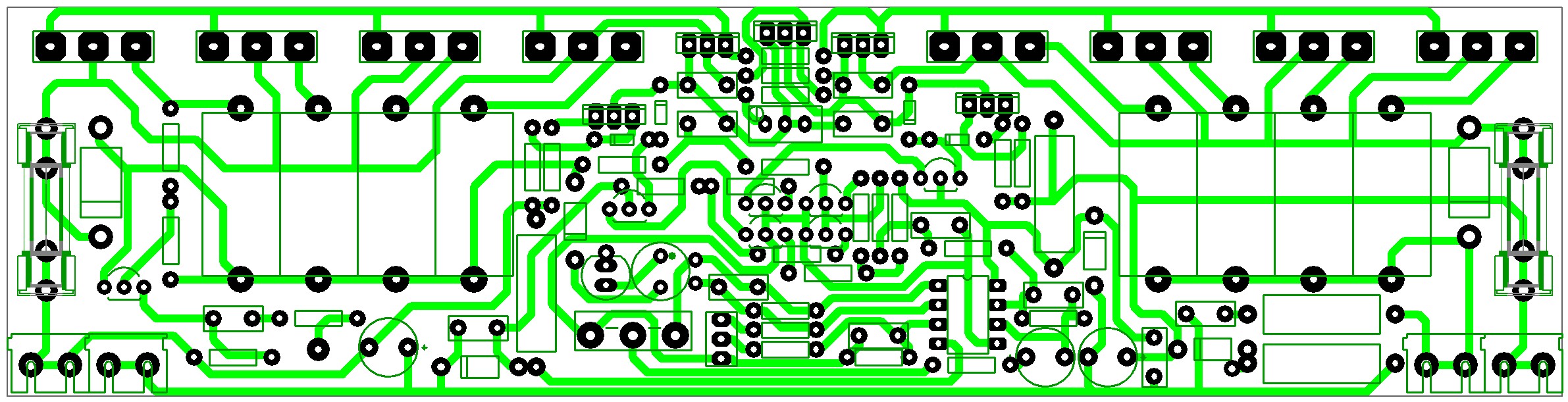

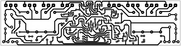

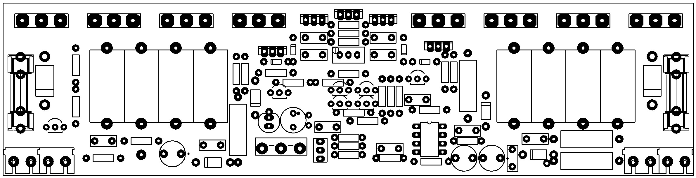

Hi Mr Daman, I try to design layout for this one. I can send you the .dip 😀
B600 circuit not tested.
Hi Dear Sir Apex,
Thanks for sharing...
I'm building B500 right now & not finished yet...
but today I saw the new B600, so here we go 🙂
I try to make a layout for this B600, need some check for error
I attach the top & bottom too 😀
PCB size 50 x 200mm
we need two jumpers here for Clip Led & OUT
Regards

Nice work, look like APEX 🙂
Regards
With another Apex user i found this problem too. So, this not a big deal problem for me. I just remove the RC from zobel network. I dont know what effected cause while i remove it. But this what i need to prevent damage if i forget to connect my load.
