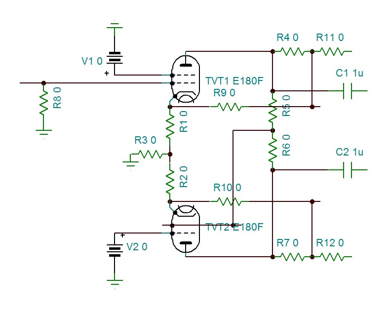

baudouin0, two remarks to your schematics:
1st: I suspect V4 as a negative (-70 Vdc) voltage source is drawn upside down.
2nd: Assuming you're feeding the LTP tail with -70 Vdc, are you sure that a BC846 will stand it? What's the expected cathode voltage of both pentodes?
Best regards!
V4 is OK are voltage is shown as -70 not 70 so that's correct. Your quite correct I'am not using a BC846 in the real design its a MPSA42 from memory. The voltage rating is not critical to the simulation.

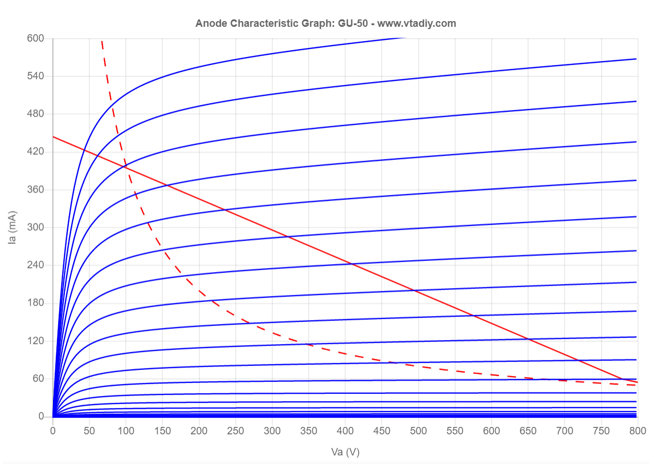

I will resume some points here, trying to use 12HL7 as a driver.
Attached the loadline of the GU50 with 900 V B+ 30 mA at idle, 8k1 Raa, -43 V g1, 270 V g2, 30 V g3.
So as written before:
Class AB1:
GU50s will swing from 900 down to approximately 160 V when g1 will go from -43 up to 0 V. That's a gain of 17, (that's also the same as the Baby Huey).
The shunt feedback total resistance must be at least 10 times GU50's Raa in order not to interfere with them (and not to waste power through them), so at least 27 kOhm.
Considering the same 47 kOhm and 16 kOhm ratio, it could go down to 12 kOhm and 3,9 kOhm.
A reasonable working point for the 12HL7 is something less than 70 mA, so the voltage drop across the shunt feedback resistor would become 840 V.
Again not possible.
It seems that the only way is to decouple the shunt feedback signal through a capacitor and feeding into the PI. The easierst way to do it seems to me to split the plate load of the PI into two resistors, and connect the capacitor there.

Let me sketch what I have in mind and see if it can work.I'm not sure what you're intending really. But if you want bootstrapping, you'll need to split the 16 k into two 33 k ones to keep DC load resistance the same.
Roberto, honestly I wouldn't think about Schade at all in a musical instrument amplifier. You surely don't need high fidelity here, not even in an amp for the bass guitar. In contrary, some minor distortion will enhance the overall sound.

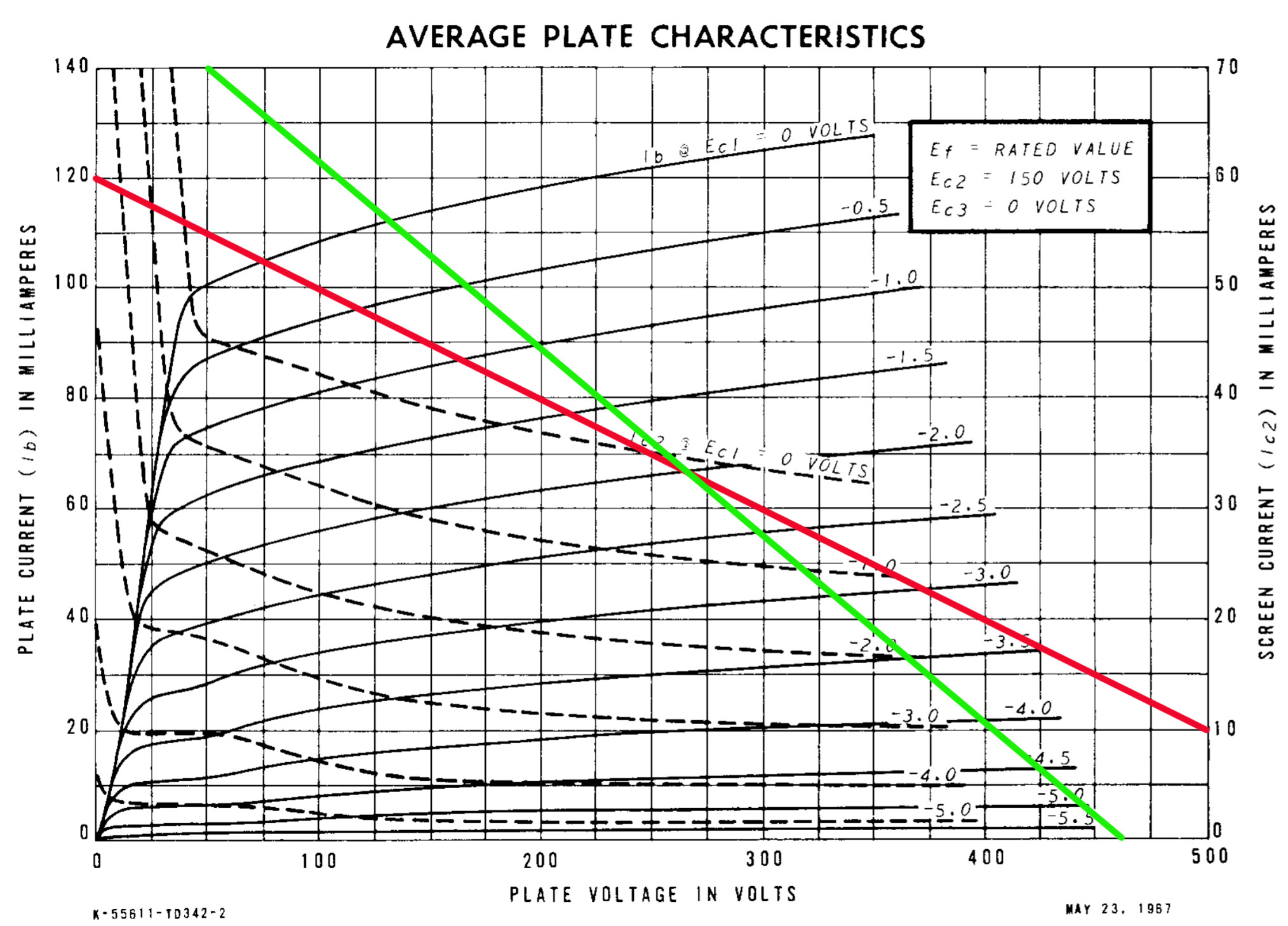

smoking-amp kindly suggested me the 6GF5 vertical deflection output pentode, which curves are apparently same as 6GE6: http://www.r-type.org/pdfs/6ge5.pdf
I'm searching a way to linearize it.

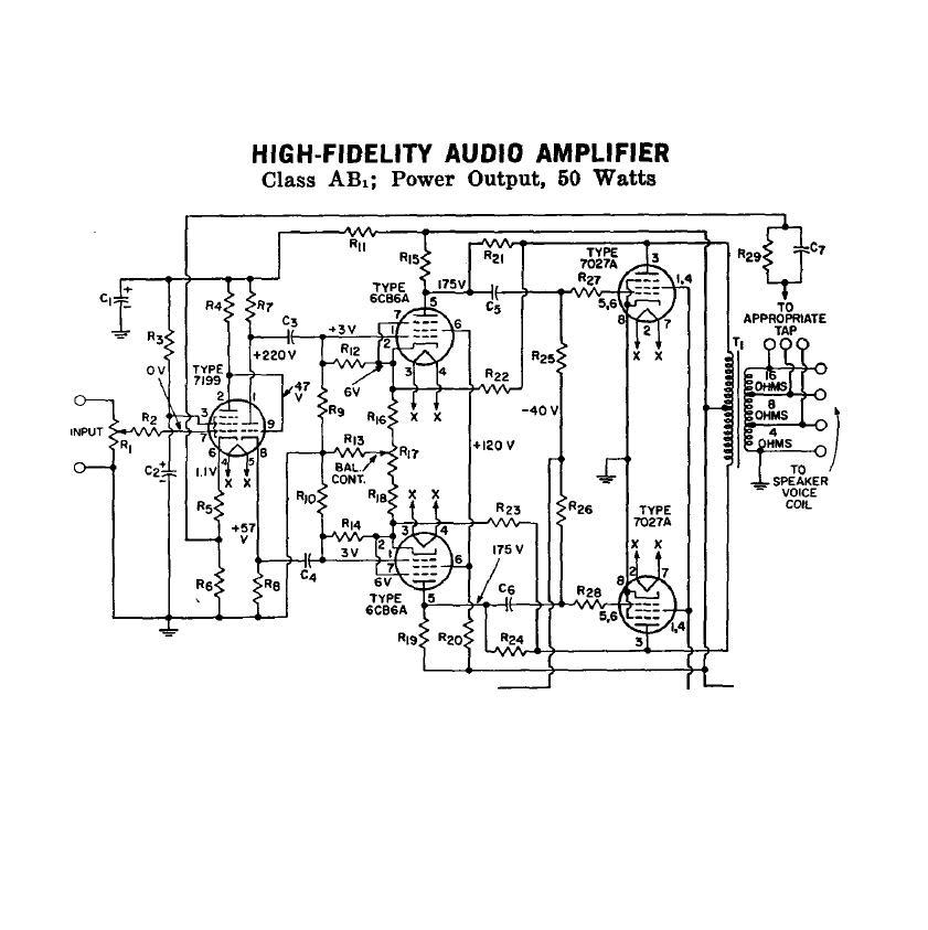

Hi kokoriantz,
I've searched your schematic, and I've found this variation:
