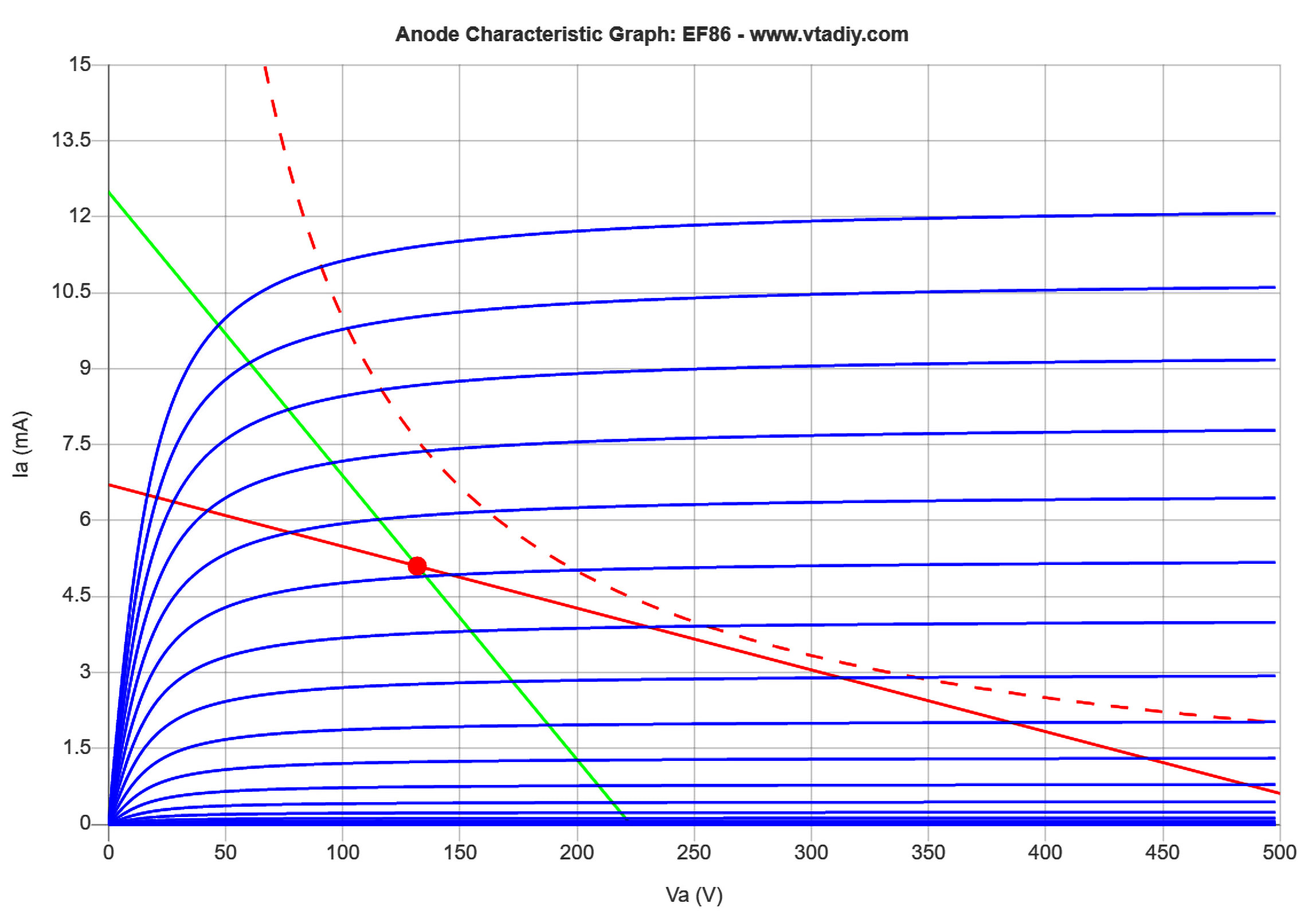

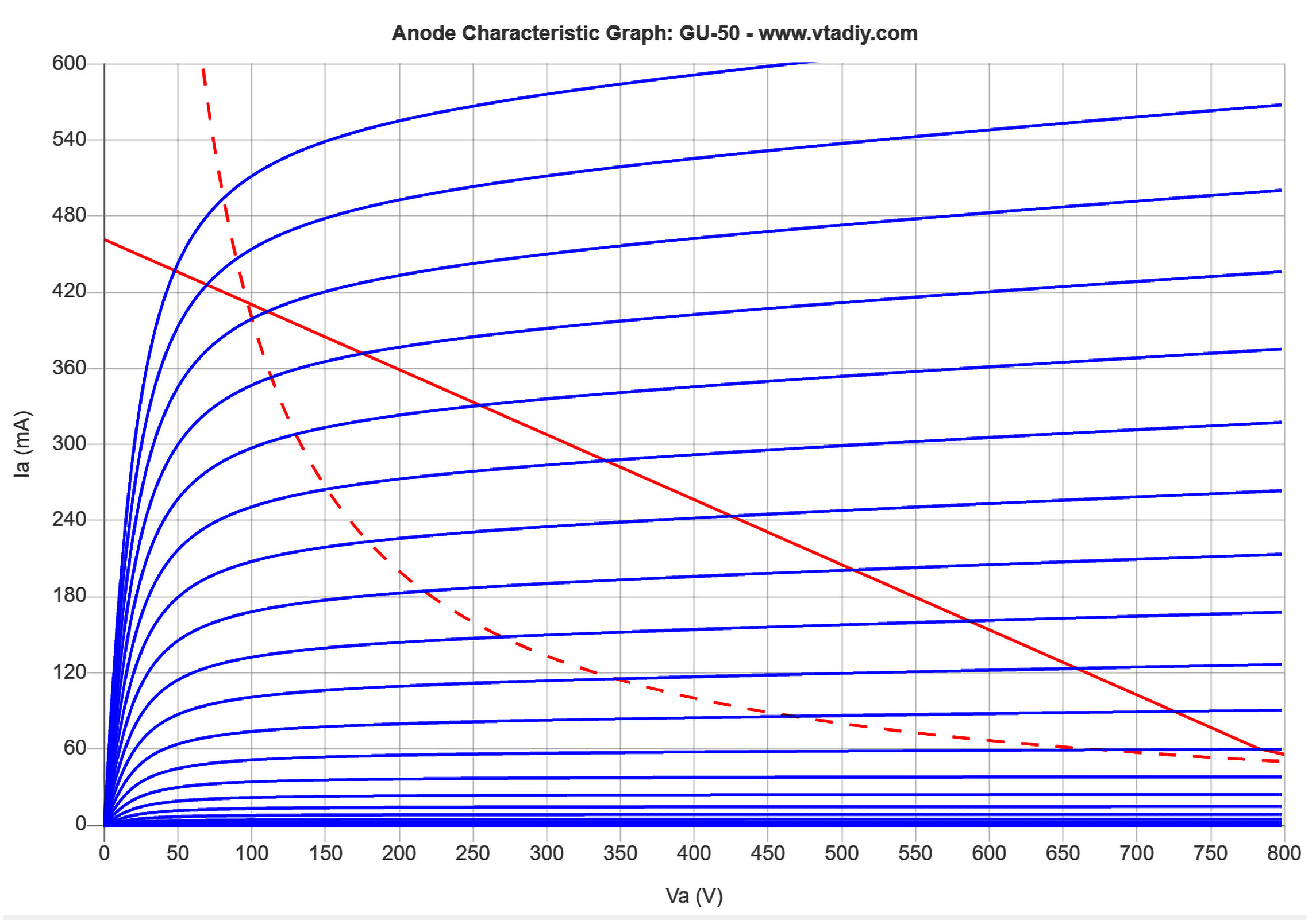

Hi, I've played a bit with the EF86 pushing it to its limits.
In attachment you can find the loadlines.
GU50 as before: B+ 900 V, Ia 30 mA, g1 -43 V, g2 270 V, g3 30 V, Raa 8k1
EF86 B+ 550 V, Ia 5,1 mA, g1 -2,4 V, g2 180 V, Ra 68k shunt 12k & 3k3.
This way the EF86 can drive the GU50s into AB2... but... I still need to drop (900-550) = 450 V that must be constant even when varying the current.

Thanks brightcity, your configuration is a triode to split the signal, then a second triode for each side of the split signal? I excluded that configuration as I would like to keep it straight phase inverter then mosfet drivers to have the ability to bring output tubes into AB2.

I need the AC component to stay fixed, while the DC component is reduced by 450V independently from the current flowing through that added component.
Your solution doesn't accomplish those things.

I've also drawn the loadlines of the GU50s for 20% (for instrument amplification version) and 43% (for Hi-Fi) UL connections.
