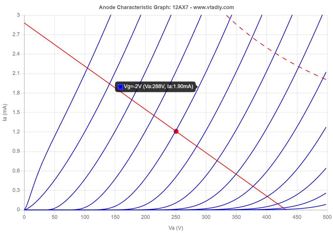

I would like to do some calculations to check of things work, and get some confirmations on them. They are based on this post by Mona: EL84 Amp - Baby Huey
I've followed the reccomandations of having 280 V on g2, 150V on g3, 870 V on plates and a load Raa of 6 kOhm, even if it is constantly above the 40 W dissipation curve. This can be acceptable due to the fact that GU50s sere constantly forced ventilated, that half od the cycle are off and that bass instrument is played more with pauses rather than notes.
GU50s will swing from 870 down to 87 V when their grid will go from -46 up to +20 V. How dare is it to bring this amp in AB2? How can this be calculated?
That's a gain of 11,86.
Feedback is 470 kOhm / (150 kOhm / 2) = 6,27.
So on the 220 kOhm there will be 11,86 / 6,27 = 1,9 times the signal on g1(GU50) = a(ECC83).
The anode of the phase inverter sees (220 kOhm + (470 kOhm // 75 kOhm)) / (1,9 + 1) = 98,2 kOhm and the 1 MOhm (bias reference) in parallel.
So a total dynamic load of 89,4 kOhm.
Another option is to have 470 kOhm on the plates and the shunt as 220 k Ohm and 68 kOhm:
Feedback is 220 kOhm / (68 kOhm / 2) = 6,47.
So on the 470 kOhm there will be 11,86 / 6,47 = 1,83 times the signal on g1(GU50) = a(12AX7).
The anode of the phase inverter sees (470 kOhm + (220 kOhm // 34 kOhm)) / (1,83 + 1) = 176,5 kOhm and the 1 MOhm (bias reference) in parallel.
So a total dynamic load of 150 kOhm.
That would allow a better working point with 1,2 mA and Vgrid = -2 V circa, with a loadline from 423 V to 2,9 mA circa, swinging from 105 V when Vgrid = 0 to 380 V when Vgrid = -4 V, so totally 275 Vpp.
The gain of the stage is 275 / 4 = 68,8.
GU50s need (66 Vp x 2) x 1,9 = 250 Vpp, so we have some margin on the phase inverter.
The voltage drop across the 220 kOhm resistor of the feedback will be 220 kOhm x 1,2 mA = 264 V, so there will be 600 V on that side of the 470 kOhm resistor. This is not acceptable by the 12AX7, so this configuration cannot work.

EDIT:
uploaded 12ax7 loadline considering the second case.

That's what I said in #10: A 12AX7 won't do here as PI and driver simultaneously, cause it has enough gain, but can't provide the swing. A voltage amplifer between the 12AX7 PI and the finals is mandatory, preferably constructed around something like 12BH7, 6SN7, 6CG7 or similar.

Sorry , I am wrong . The 220k is in series. But then ,the feedback ratio is only 3.7% . You can adjust it to 10% by increasing the 150k .
Besides , you need to adjust the operating current . 1.25 ma ×(470k+220k)= 862 volts. To have it about 250v on the anode you need about 1ma.
Thank you Kay! Do you think a EF86 would do both?
But.. is it ok to supply the PI from the plates? When One side is at 2 x Iccs the other side is at 0 current, so there's no voltage drop across the anode load and shunt fedback resistors, so there will be 870 V on PI's anodes, isn't it?
If so, can it be a solution to connect the voltage supply to the central point of the 75 kOhm resistor (so split it in two 38 kOhm), and insert two coupling caps between GU50's plates and the 220 kOhm shunt resistors?
